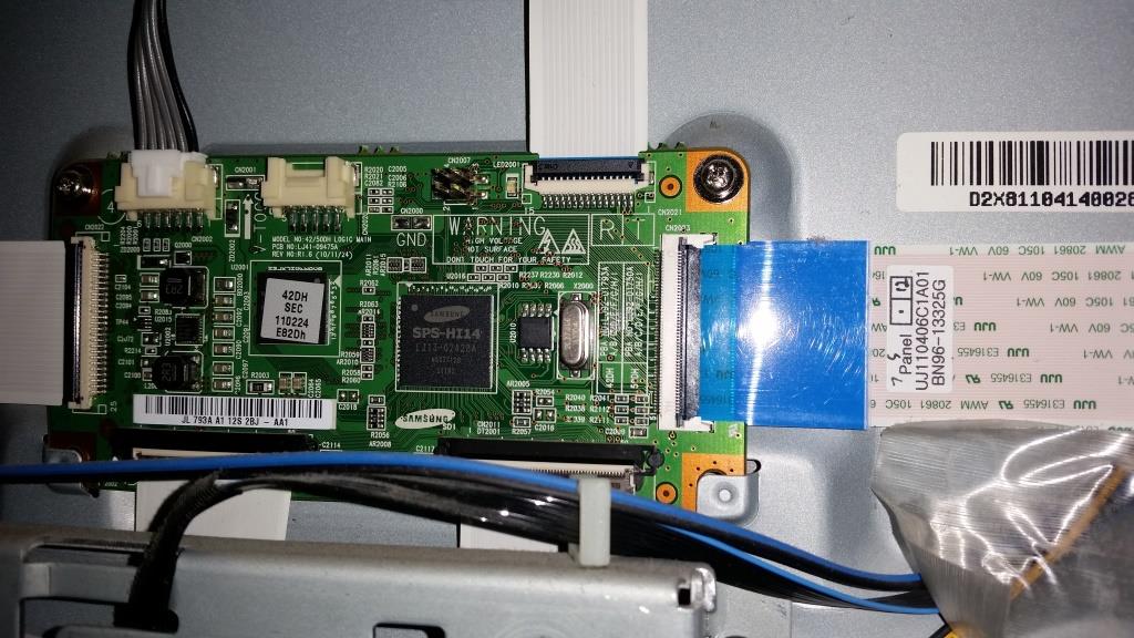

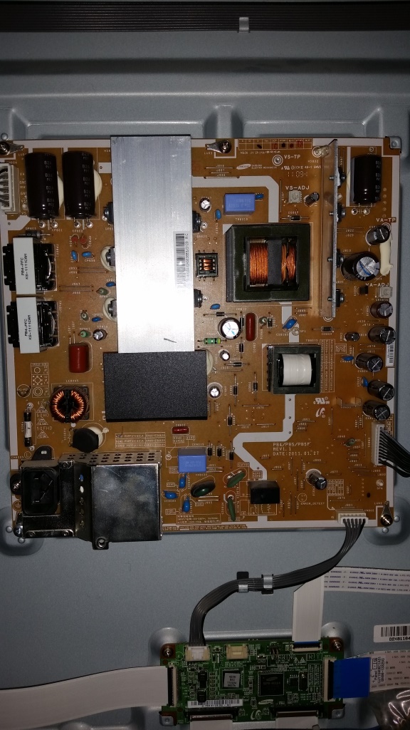

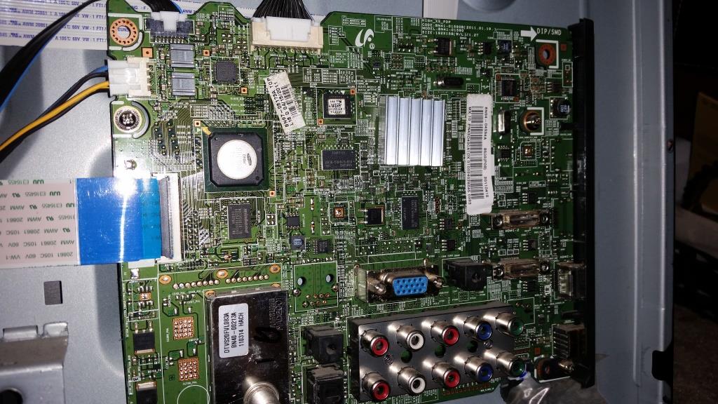

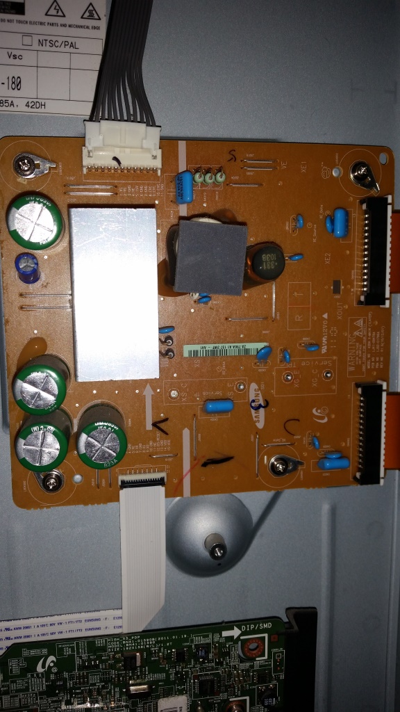

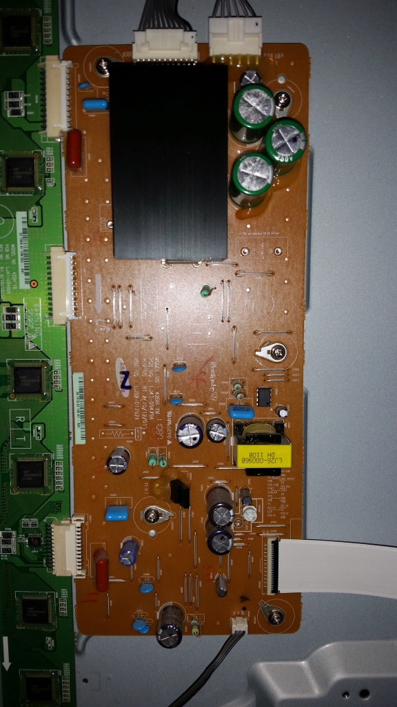

    Hi all, I have a Samsung PN43D490A1D Plasma. Shut off randomly one day. Does the standard clicking but of course no bad caps. My first thought is X Main but want to ensure I'm not just taking $90 stabs at this thing. I have soldering tools, multimeter, and most common tools at my disposal but don't know a ton about circuitry. Pictures are below. Please help me take a smart organized approach to this troubleshooting.

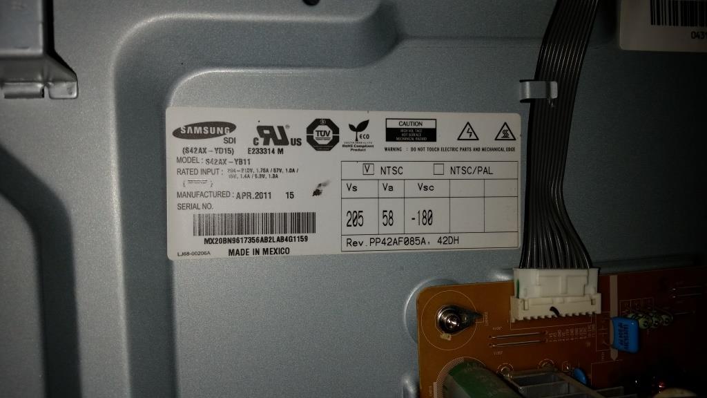

    your second picture has the power supply voltage listed and you can find key location on power supply board to test them but first get a service manual for TV. Thanks and good luck, hope you are eating popcorn soon.

              Ok so did a continuity test I found on Just Answer and here it is...X Main connected to Y main. Test continuity from Vs to GND on Connecter from Y main to X Main at X Main. Showed a short. Remove Connector going to X main. Test Again...OK. Went to X Main. Removed board from TV. Test from VS pin to GND pin on incoming connector with everything removed. Short. My guess is bad X Main.. What's everyone's thoughts? Seems logical to me but just want to be sure...Any other tests I can perform to check if another component is frying the X Main? Any way to repair the X Main?

                  Re: Help Samsung PN43D490A1D
                  the connector in pic 2 is not fully seated. . .two of the caps on pic three look alittle puffy as with few in six. cant see the ones on the ps well. you should esr test or replace all of them.

                    I'd guess that the connector was not fully seated because the OP had just pulled it to do a test. Also, I don't see any bad caps in those pics.
                    Like I always suggest with this era of Samsung plasma, I'd pull both the Y-main and X-main boards then check the components on the heat sinks for shorts.
