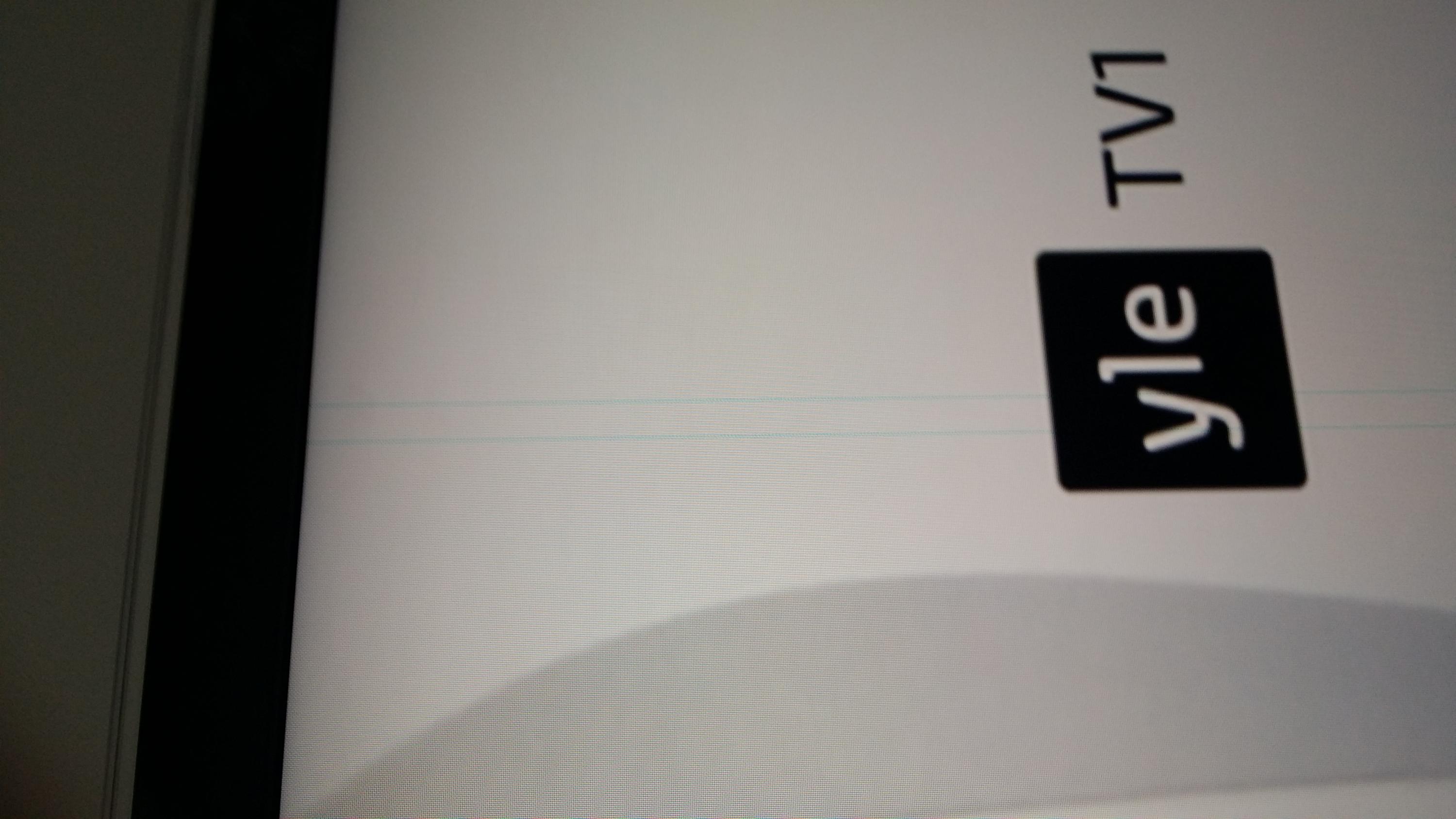

Hi! I have about 3yrs old 3d tv and suddenly there is 2 vertical lines 1 pixel wide of dead red pixels. Is it panel fault or something else? Blue and green colour are visible but no red on those lines...
samsung le46c755 2 vertical rows of dead red pixels

Re: samsung le46c755 2 vertical rows of dead red pixels
Probably Tab-Bond failure....TELEFIX
PLEASE DO NOT EMAIL ME PRIVATELY FOR REPAIR ADVICE. QUESTIONS BELONG ON THE FORUM! -
you could try pressing down on the affected tab that goes into the panel can put a shim underneath the metal frame. However if this does fix the problem it will eventually get worse to the point where it's rendered useless for that whole array of pixels will be dead. It's unfortunate but just part of the game with LCD panelsDid I leave the soldering iron on?Comment
