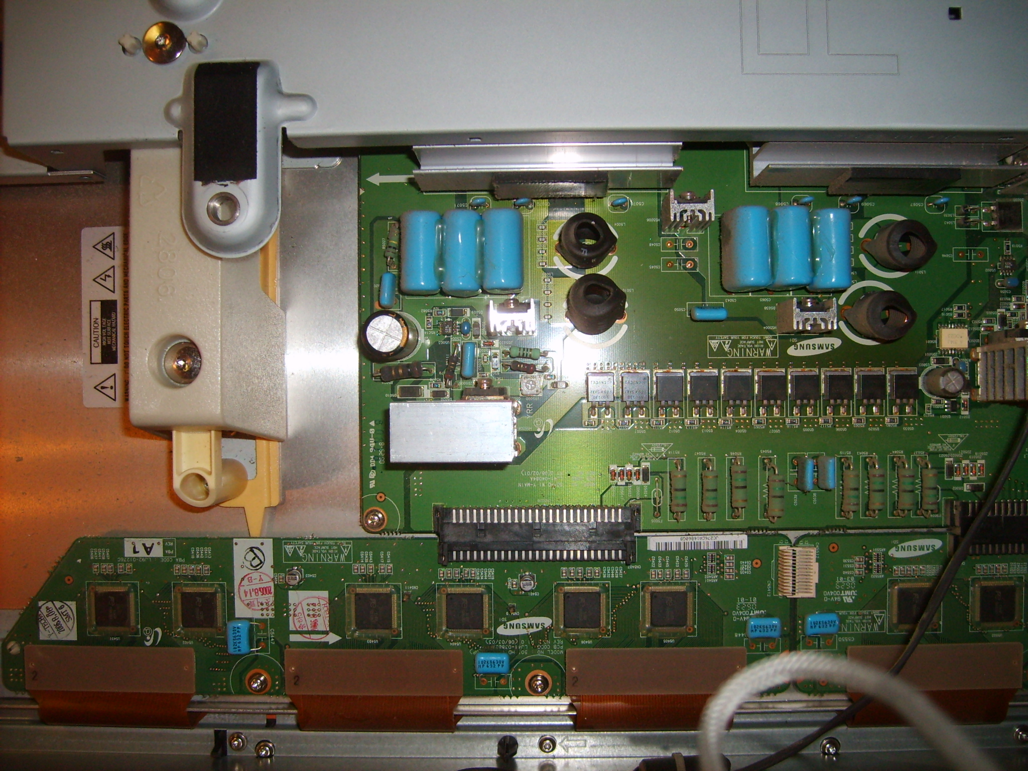

          Check The F and G boards and found pin 4 labeled 35 Volts. But on board E, pin 2 is labeled 30 Volts. Check a lot of stuff but only thing I know is TV screen does not Light but can use remote and enter service mode and just get a blinking Green power on light on front panel. Screen does nothing but stay black. All Boards with LED green lights seem to turn on. Main signal board has two green lights lit, power supply one green lit, logic board has three led lights, power side green and two leds on left side one lights then second lights and blinks and first one turn off. Check for broken screen none, checked power supply, checked Logic board, and check EFG boards, checked X and Y but have power and all boards are ready to light. I want to thank every one for there dedication and Help. Got any Ideals?

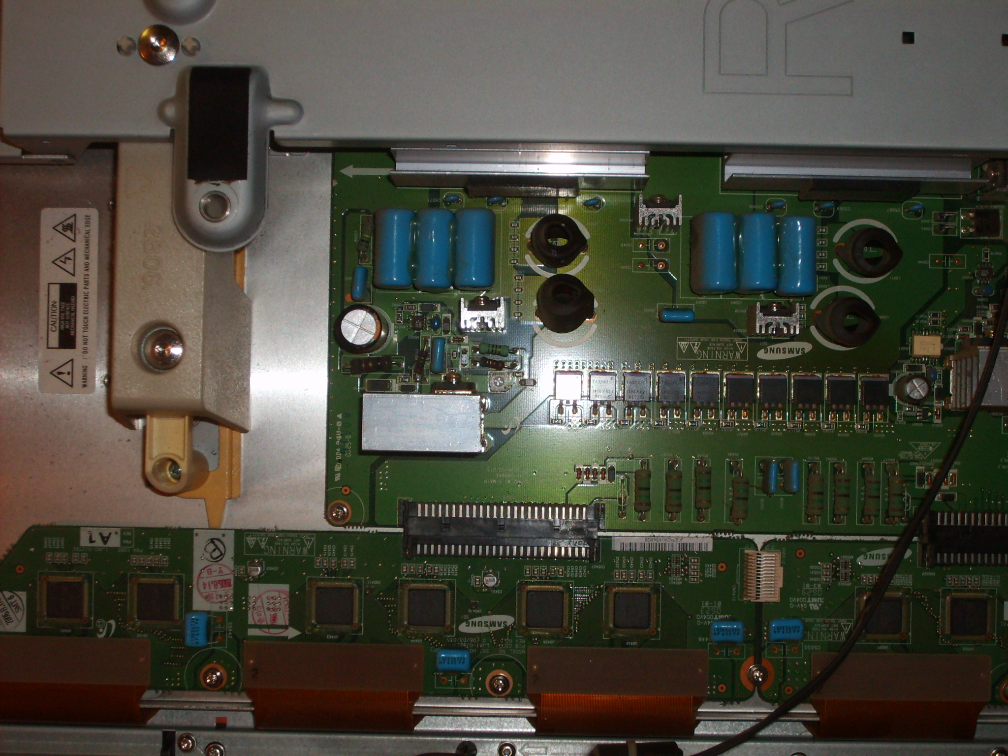

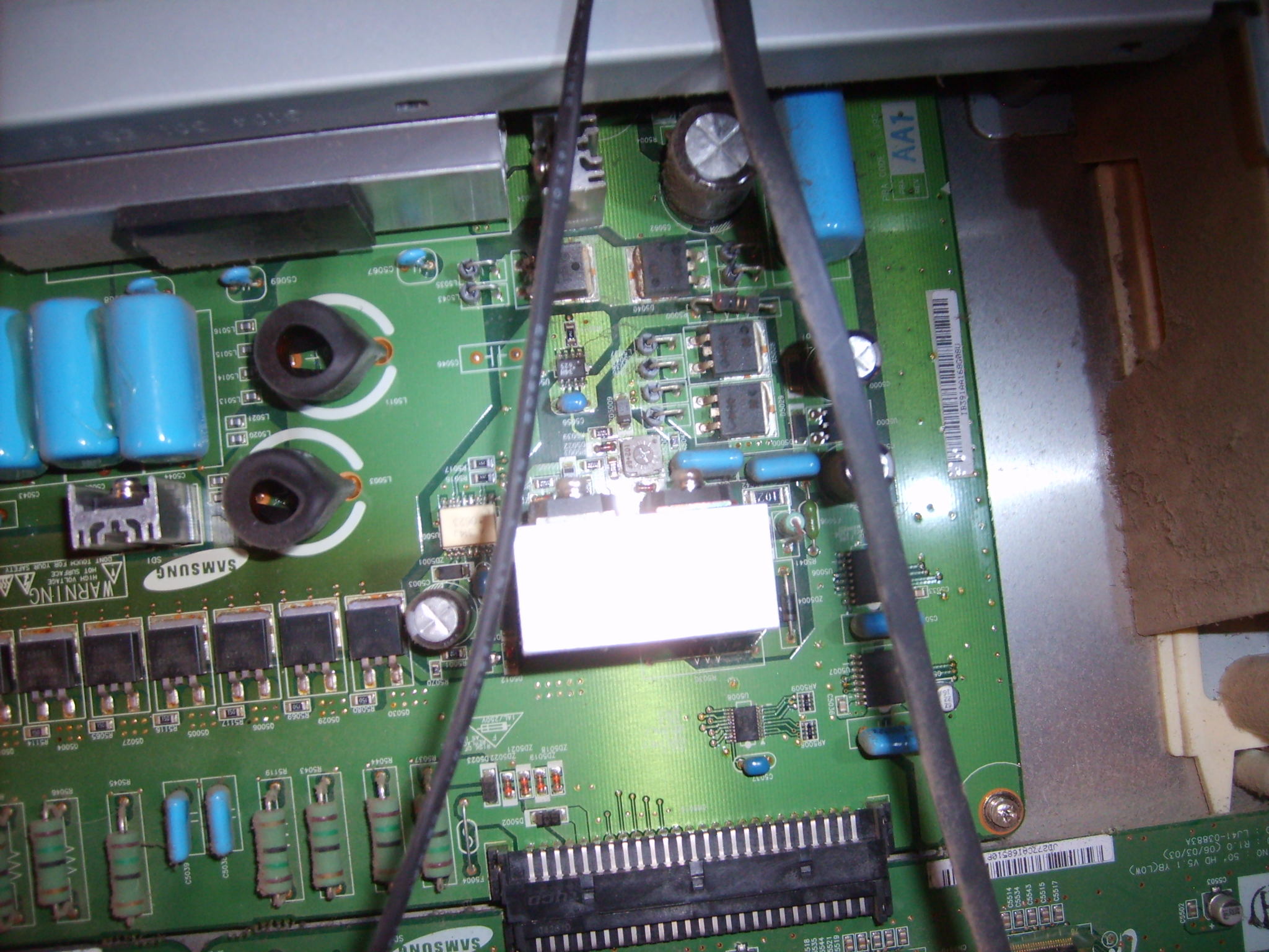

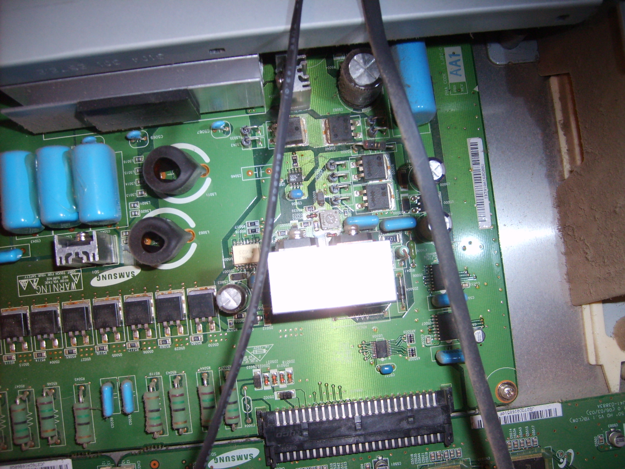

            I was examining the Y main board and found two Voltage adjustments caps dose anyone know how to check and adjust these voltage board # are (VR5000 or V85000) and (VR500 or V8500) have added picture too! If voltage is off 2V maybe shut down start up process?
            Does any one know how to check and adjust these voltage levels? Thanks from jhd2112
              Re: Magnavox 50MF231D/37
              I would avoid touching those as they set the waveforms and without the service data or an oscilloscope you may never get them back to being correct. If you msut touch these, get a fine nikko pen and mark the position relevant to the trimpot case.
              I don't know enough with these to point in any direction other than to check the buffers for shorts, check voltages, check all transistors to see if shorted, check all fuses on the sustains including those small green picofuses
