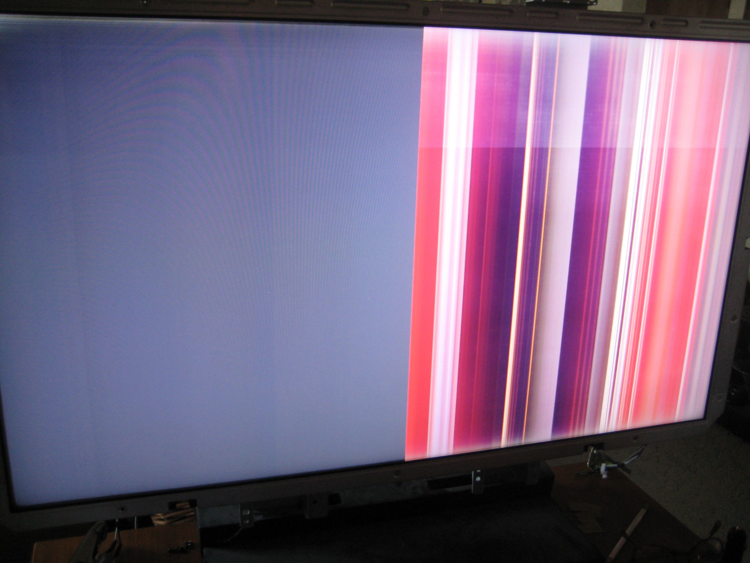

    Sony KDL40v-3000 bad panel?
    More information and a different question than my recent thread about this LCD:
    https://www.badcaps.net/forum/showthread.php?t=44342
    I have sound, and now see the picture below (somewhat white, on the left), IF I disconnect the left t-con cable to the panel. With both connected, or only the the right disconnected, the entire screen is grey.
    Same result with another t-con I have.
    Can I be fairly certain it's the panel?
    Thanks.
