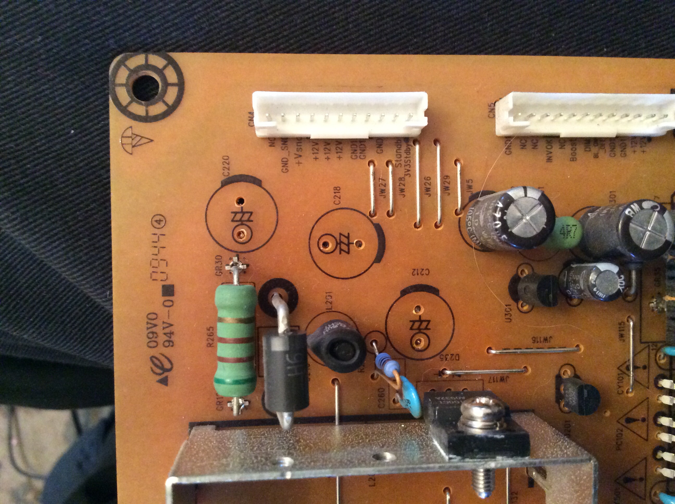

    37PFL5604 Main board PLHL-T845A cap layout
    Hey folks, does anyone have the capacitors values for the 3 caps I have missing on this board please as I can't find them anywhere.
    Thanks in advance
    Soltys

      Re: 37PFL5604 Main board PLHL-T845A cap layout
      Who took 'em out!?
      Are you sure that on that version in that set--that its supposed to have caps in those positions?
      --Has the obvious flow-soldering of the pads been disturbed?
      Quite often a maker will use a PSU in multiple models and there'll be considerable differences in some cases as to what caps/other parts are installed on a bare board.
        Looking at the circuit, I would say 25V either 470uF or 680uF @ 105C.

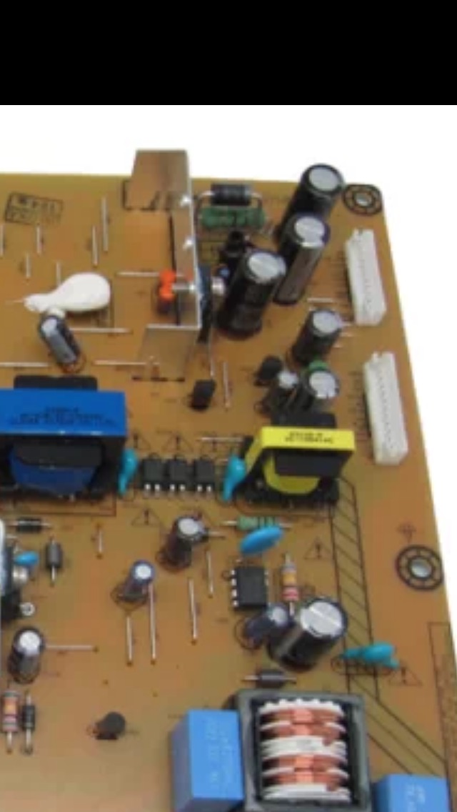

          Yes they have definitely been removed as its visual and comparing it to pics of the boards for sale but I can't make the values out on the pictures
            As you can see from this image
            • Soltys
              • Feb 2015
              • 17
              • England
              Got them now, was a 470uf 35v and 2 x 1000uf x 25v
