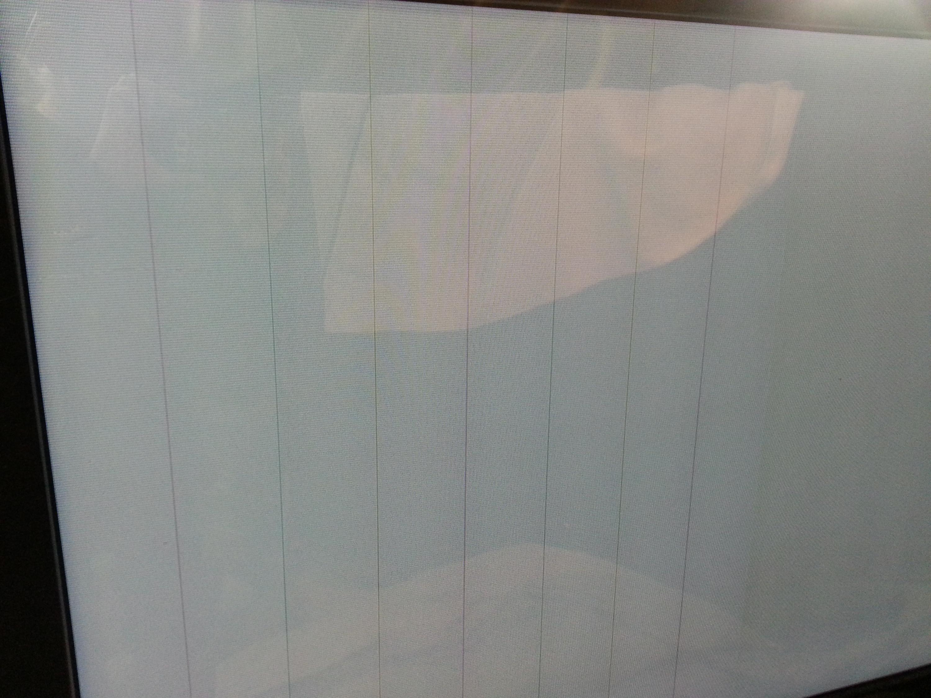

    I have acquired a Samsung HP-T5054 plasma tv that I have been working to repair with the help of information ive found in these forums. However it seems I have fixed one problem and ran into another that I cannot seem to find an answer to.
    The problem started as a black screen and then a pop according to the previous owner.
    Symptoms:
    power cycling constantly
    no image
    Findings
    Tv powered on with y-sus unplugged
    Upper Y-buffer had an obvious bad IC
    Fix:
    Replaced both Y buffers
    Replaced 88N30W (Q5302,Q5303,Q5305,Q5306), RJH3047 (Q5100-Q5103), K2837(Q5200, Q5500) and B20NK50Z (Q5501)
    Results:
    Tv powers on with image but image is distorted, hence the current problem
    Current Problem:
    Tv powers on but the image is faded on the right side of the tv, the left side of the tv has vertical lines evenly spaced. Every once in a while the screen goes pink and the power supply whines as if there is a problem. I tried another X-sus in the tv but the problem still reoccurs. The tv also shows a weird pattern when shutting down or turning on.
    Voltages appear to be within spec.
    Pictures in the next post. Any ideas?

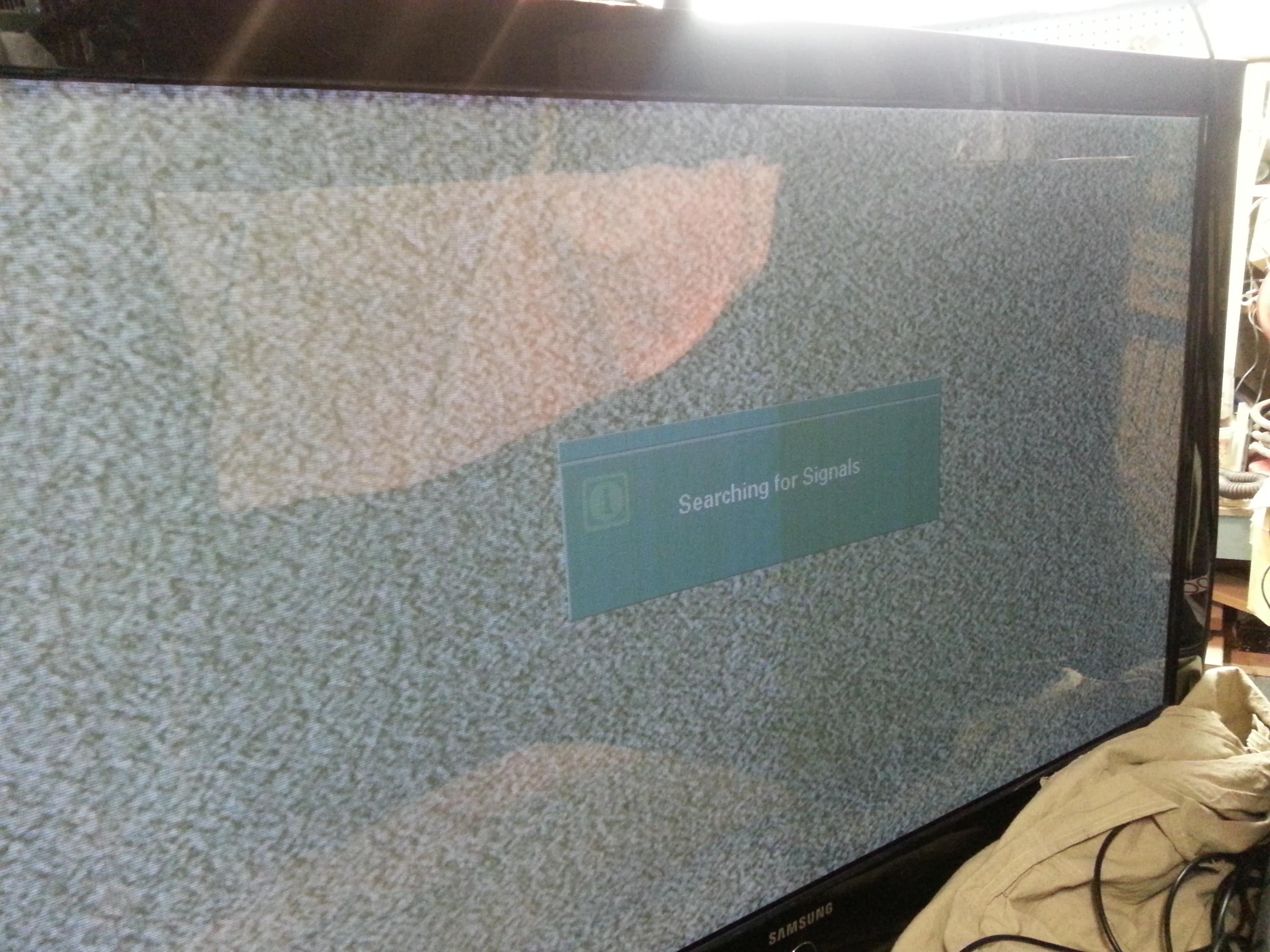

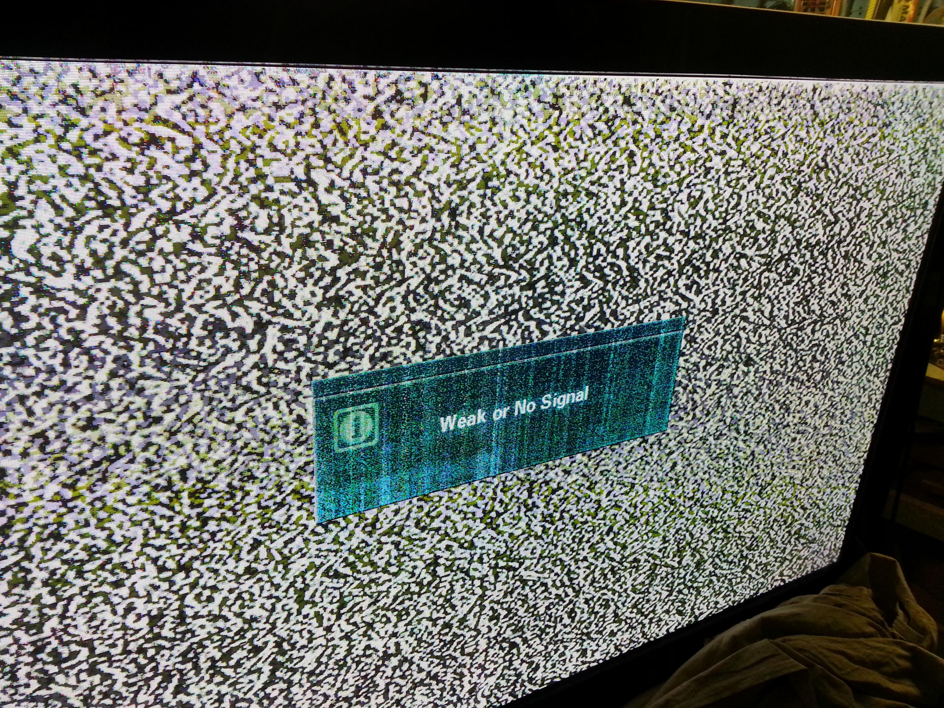

    • dustman1747
      • Feb 2015
      • 33
      Re: HP-T5054 Samsung Plasma Screen Issues

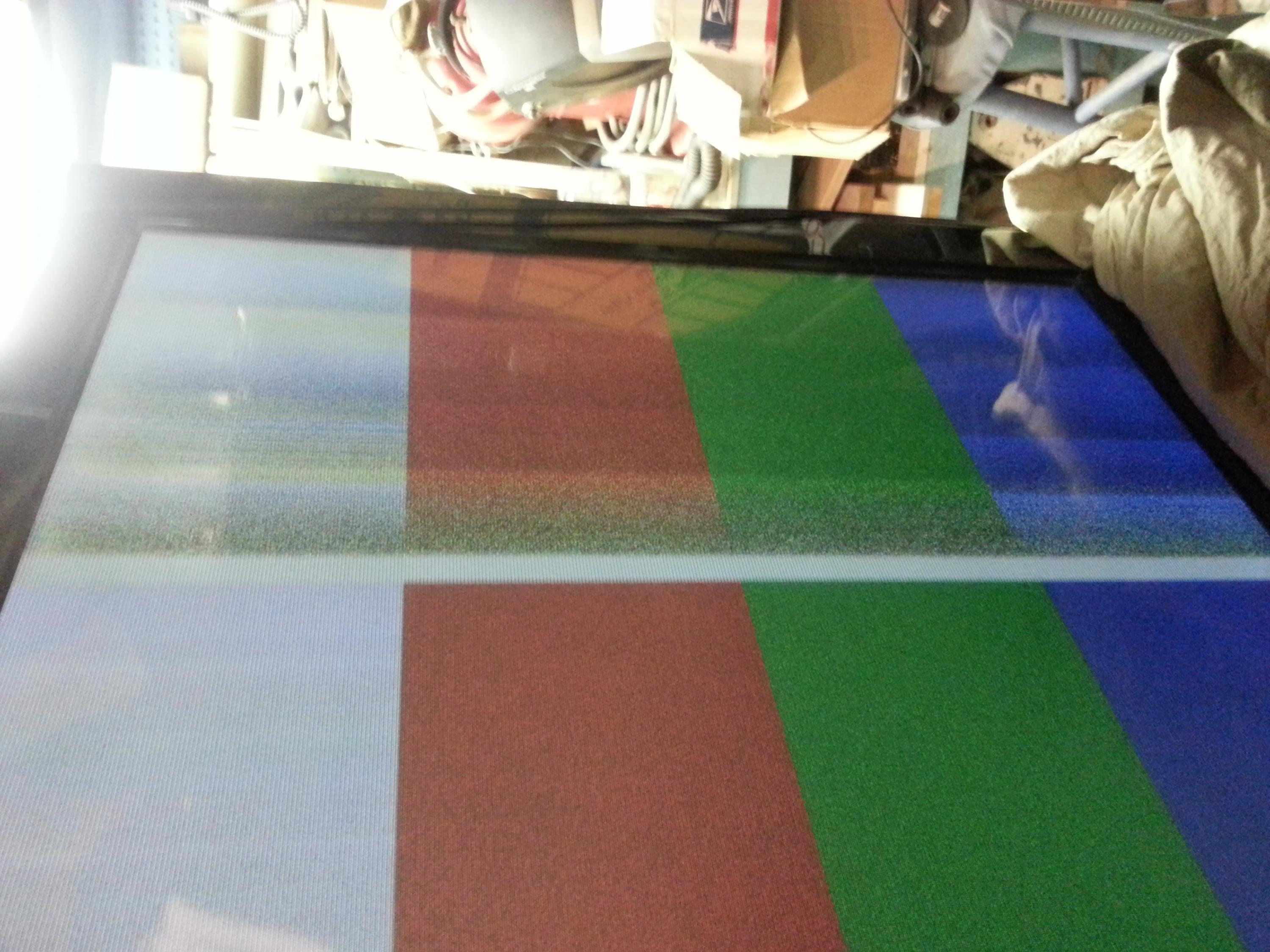

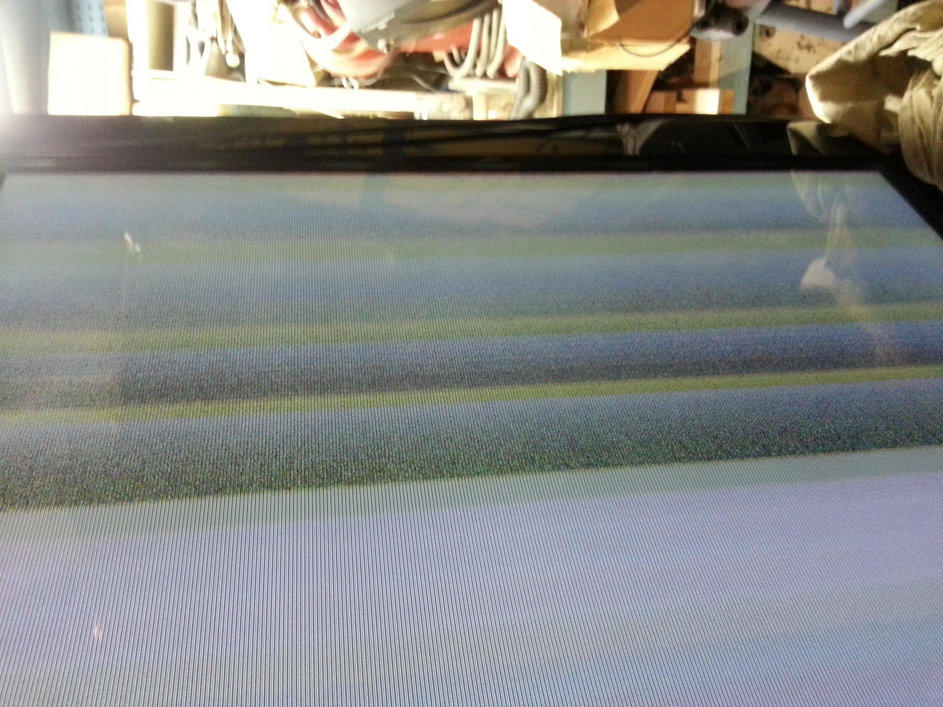

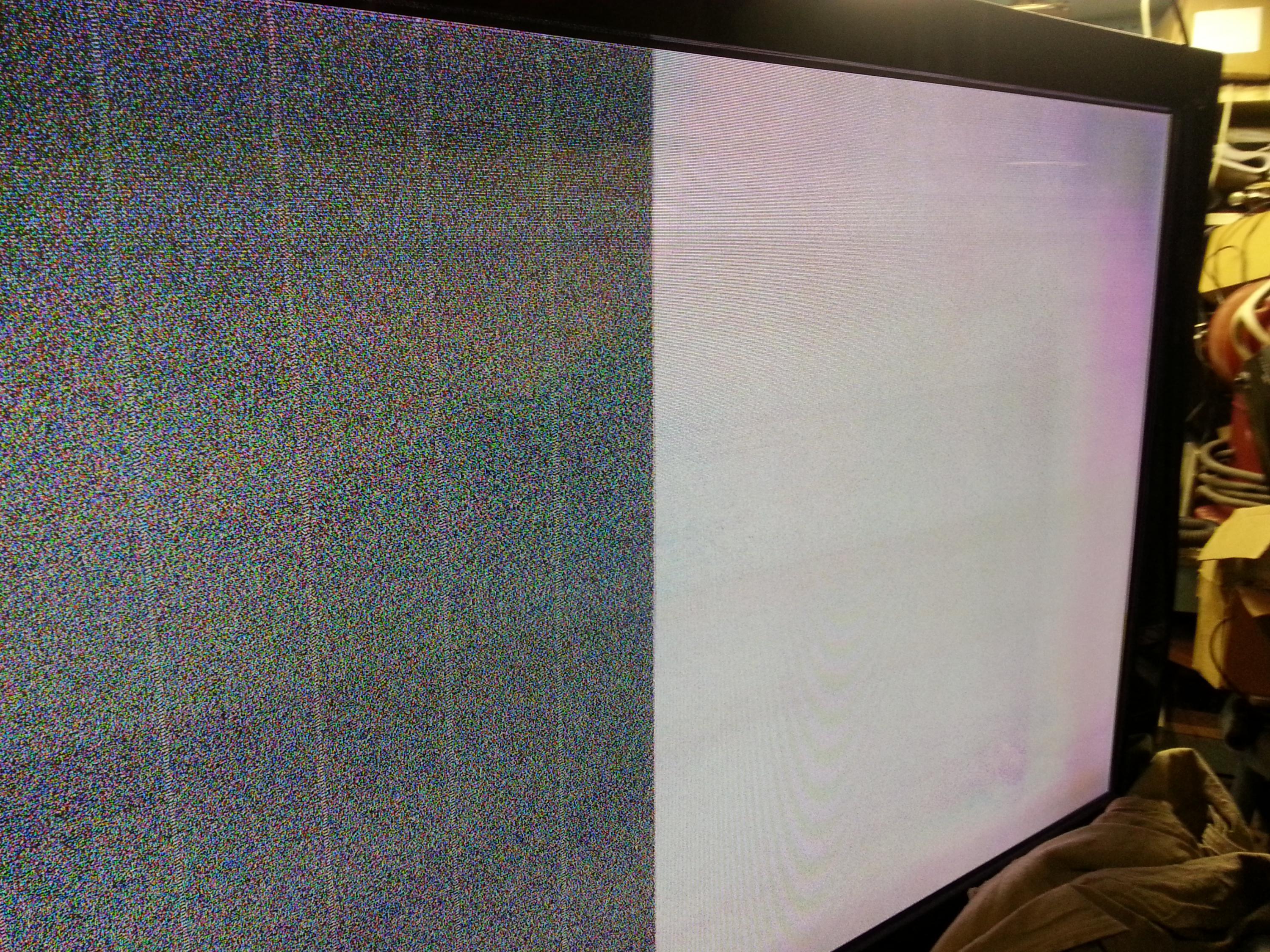

      1) With X-sus plugged in
      2) Shutting down:
      3) Without X-sus
      4) Right side is darker
      5) Vertical lines shown on test pattern
      6-7) Weird colors and distortion on test pattern
      8) Pink distortion the sometimes shows with X-sustain plugged in
      • dustman1747
        • Feb 2015
        • 33

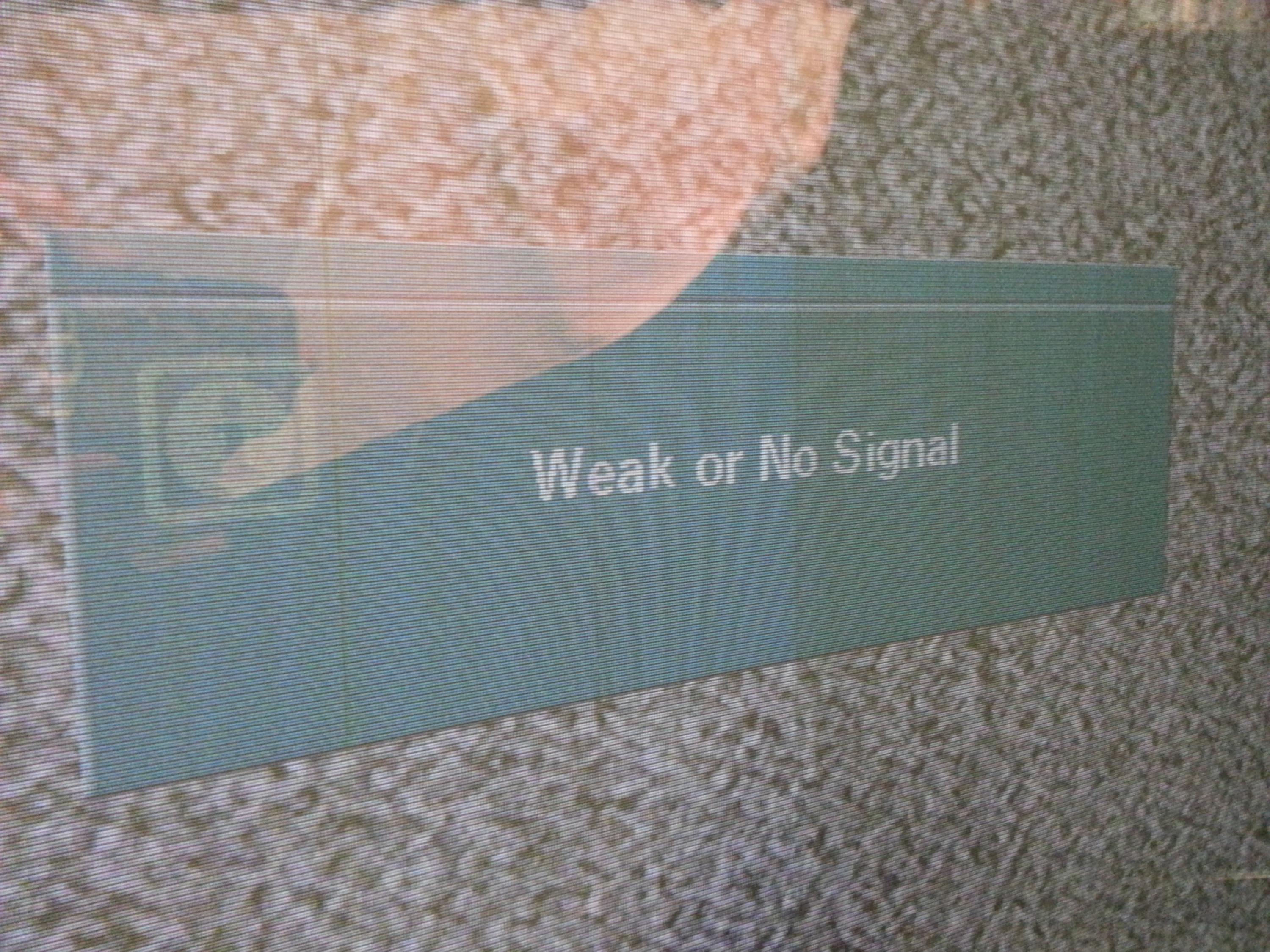

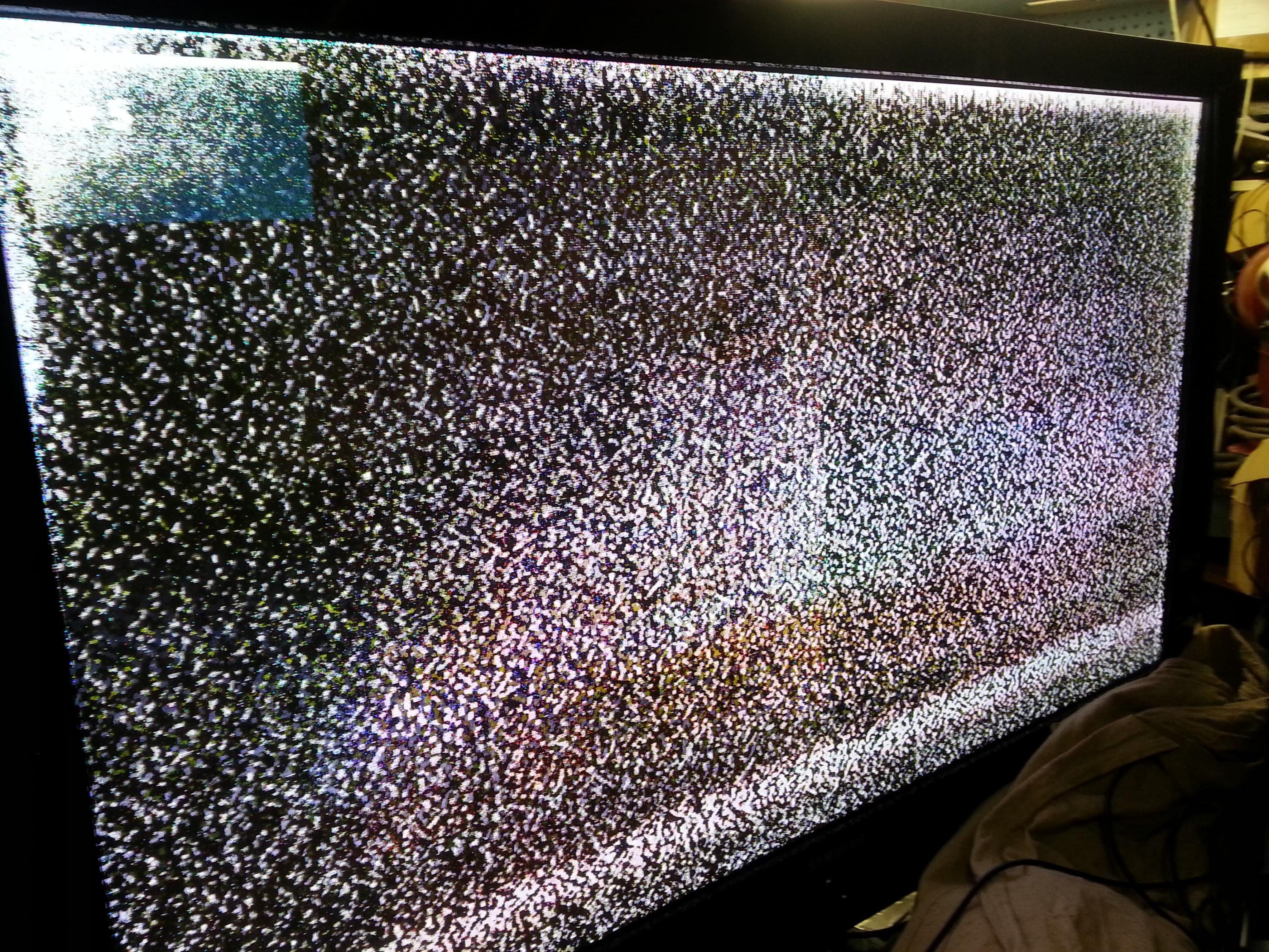

        With X-sus disconnected panel displays no signal indication and static.
        With Y-sus disconnected the tv the relay clicks and the tv try to power on about every 10secs, no image
        With both disconnected the tv appears to power on and stay on, no image
        • freakaftr8
          • Oct 2012
          • 3743
          your having the exact same problem I am having with the exact same model. Even though you replaced all the bad MOSFET transistor is on the Y sustain board there is still something wrong I replaced my whole Y board and problem solved
          normally I never give up on repairing a board but however I had to on this one it was getting too pricey. Even though the MOSFETs tested good apparently they're still bad

                  yes that screen distortion is caused by the Y sustain. I've tried changing out control boards on mine with the same result. Somehow the why its not sending the control board the proper information so the control board is distorting the left hand side of the screen even though the right hand side is still messed up its a different distortion.
                  you mentioned in your first post that you swapped out all bad MOSFETs. But you did not swap out the two K2837's? I found those causes distortion problem as they are not powering the other bank of MOSFETS properly. these act as a controller

                            I was playing with the X-sus ribbon cables to the panel. It appears that if:
                            2 are plugged in the TV stays on and Vs is stable
                            3 are plugged in the TV power cycles as if the protection circuit is tripped
                            3+ plugged in the TV turns on shows pink blur and the power supply whines from being overloaded. Vs drops to about 196V.
                            Still sound like a Ysus problem or could it be Xsus or even the panel?
