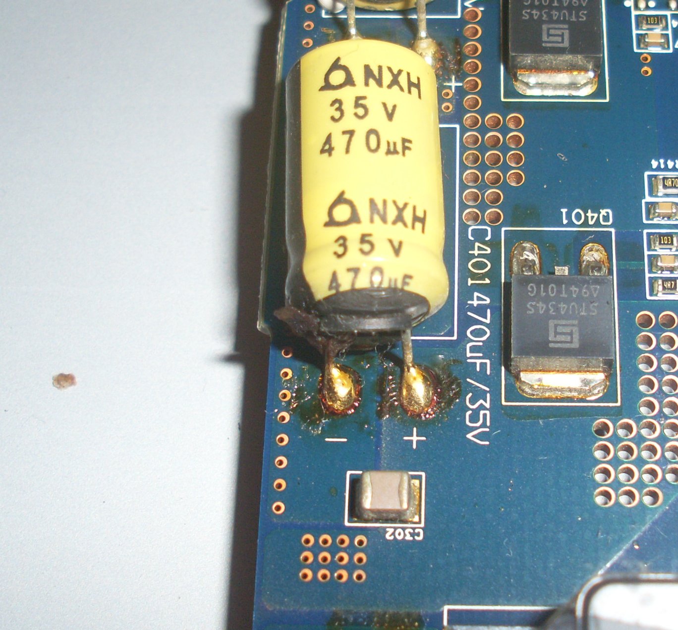

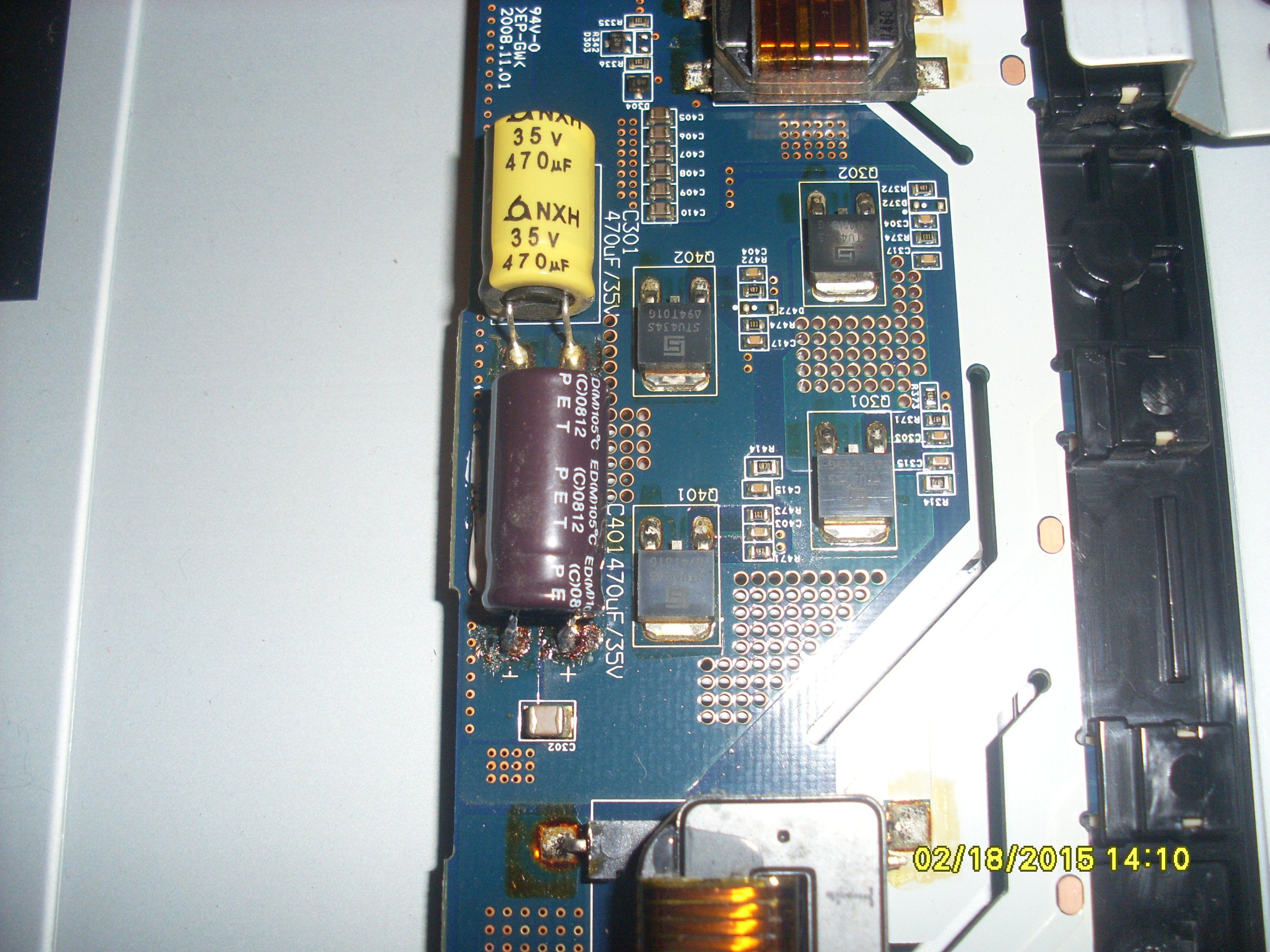

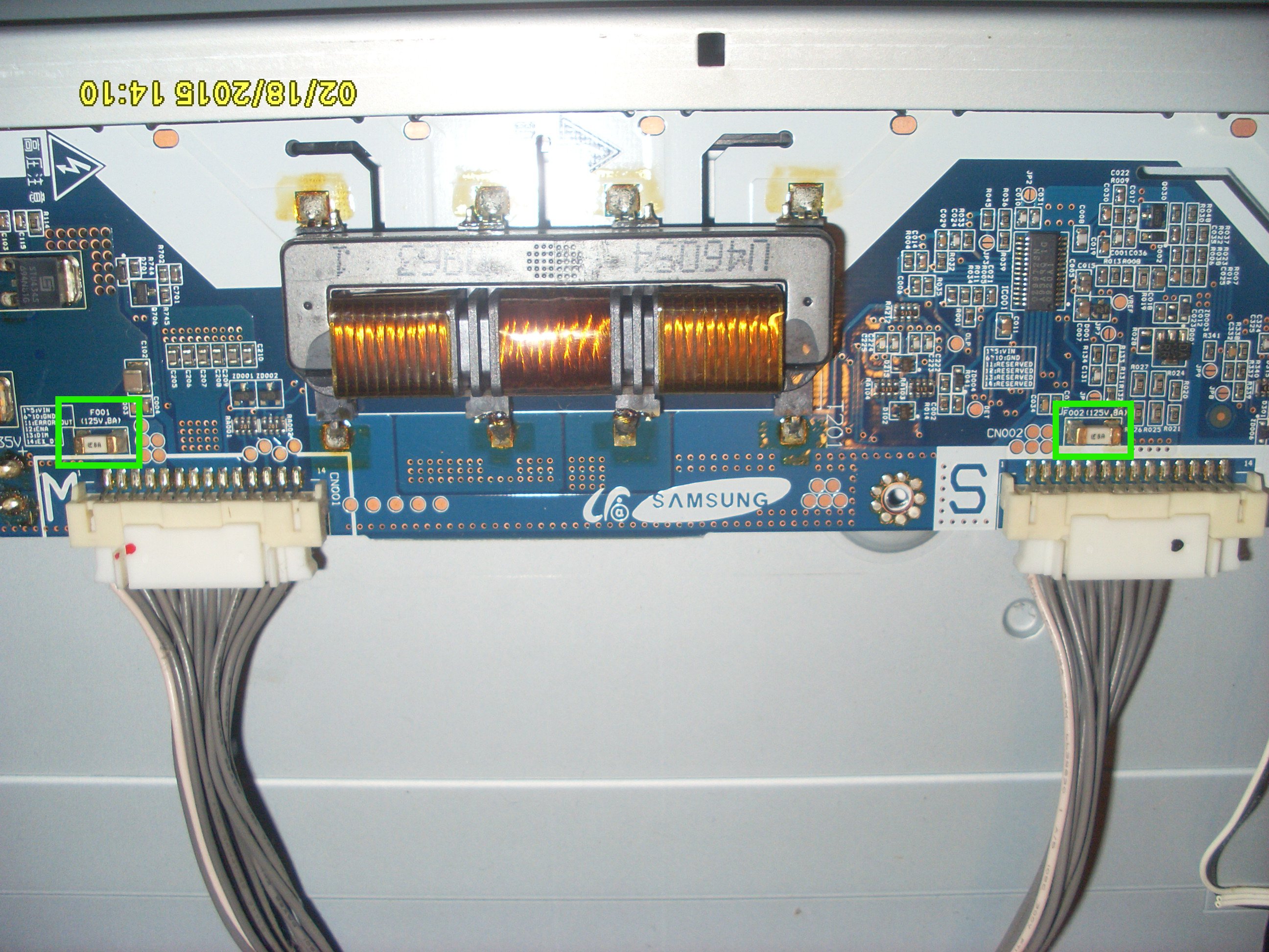

    Looks like it's a blown cap on the Inverter board..
    Oh gods, please let this be an easy fix!!
    • Michale32086
      • Nov 2011
      • 1453
      Re: Toshiba 46xv645u 1-Blink 2-Blink 3-Blink Upon Power Up..
      Nope.. This is just not my lucky day...
      Replaced the blown cap.. Still have the 3-blinks...

        Ask yourself what caused the cap to blow? Is the fuse on that board OK?
          I figured a power surge of some sort..
          I found two fuses and they check out..
          I know it's a crappy solder job, but the replacement cap is solid..
            Nah, that's just flux... the joint itself is ok... those are always tricky to do, as surface mounting a radial electrolytic is not optimal.

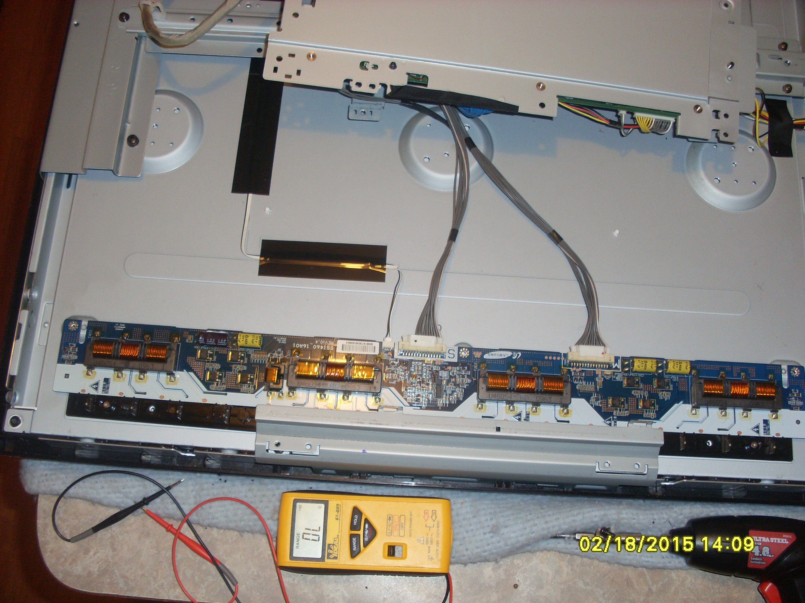

            Do you have 24V at the fuses, at both ends?

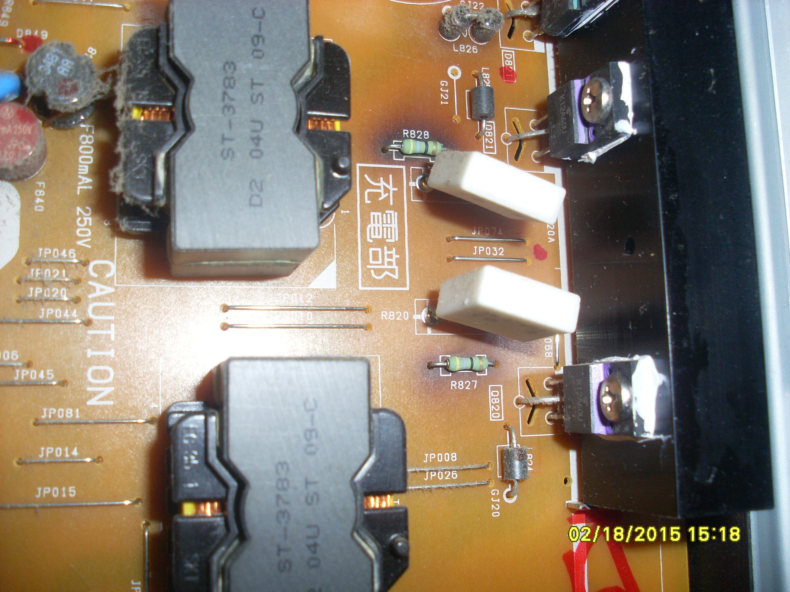

              Yikes, I don't recall ever seeing a bad cap on one of these samsung inverters. My first guess with the power related issue would be the q880 on the power supply. Just like the older toshiba power supplies where 3 ic are replaced on the power supply for the 3 blink code. There are also 2 47ohm resistors on the power supply that run hot and usually discolor the board. I have not seen one open but I'm sure it's possible with how hot they run. Can't remember the exact location but they are on the right near 2 mosfets( I think in my thread about the board I had the location).

                  Not sure what you mean by "both ends"...
                  If I have one probe on one end and the other probe on the other, I get 0v
                  If I have POS probe on either end and NEG probe to chassis GND, I also get 0v
                  This is with the unit plugged in...
                    Definitely some discoloration here, so this is where I assume you mean ...
                    • nicholas1110
                      • Aug 2012
                      • 127
                      • usa
                      Yep those 2 resistors should be 47ohm when you test them.
