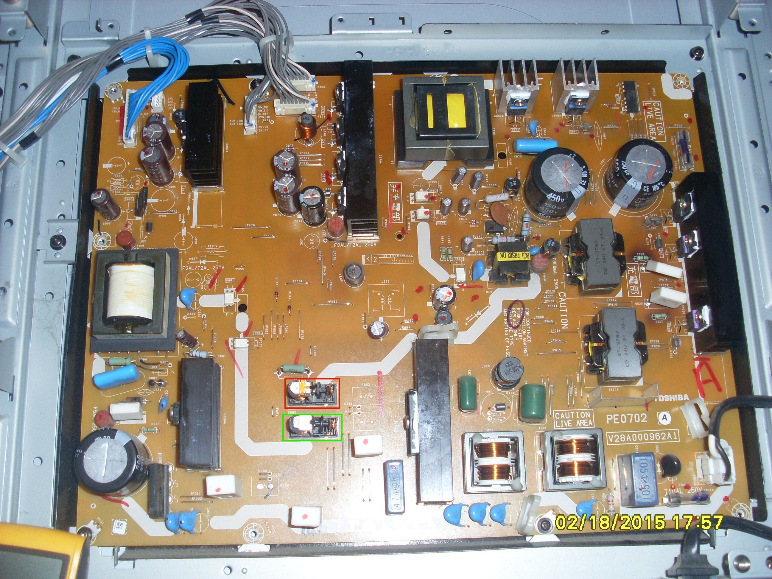

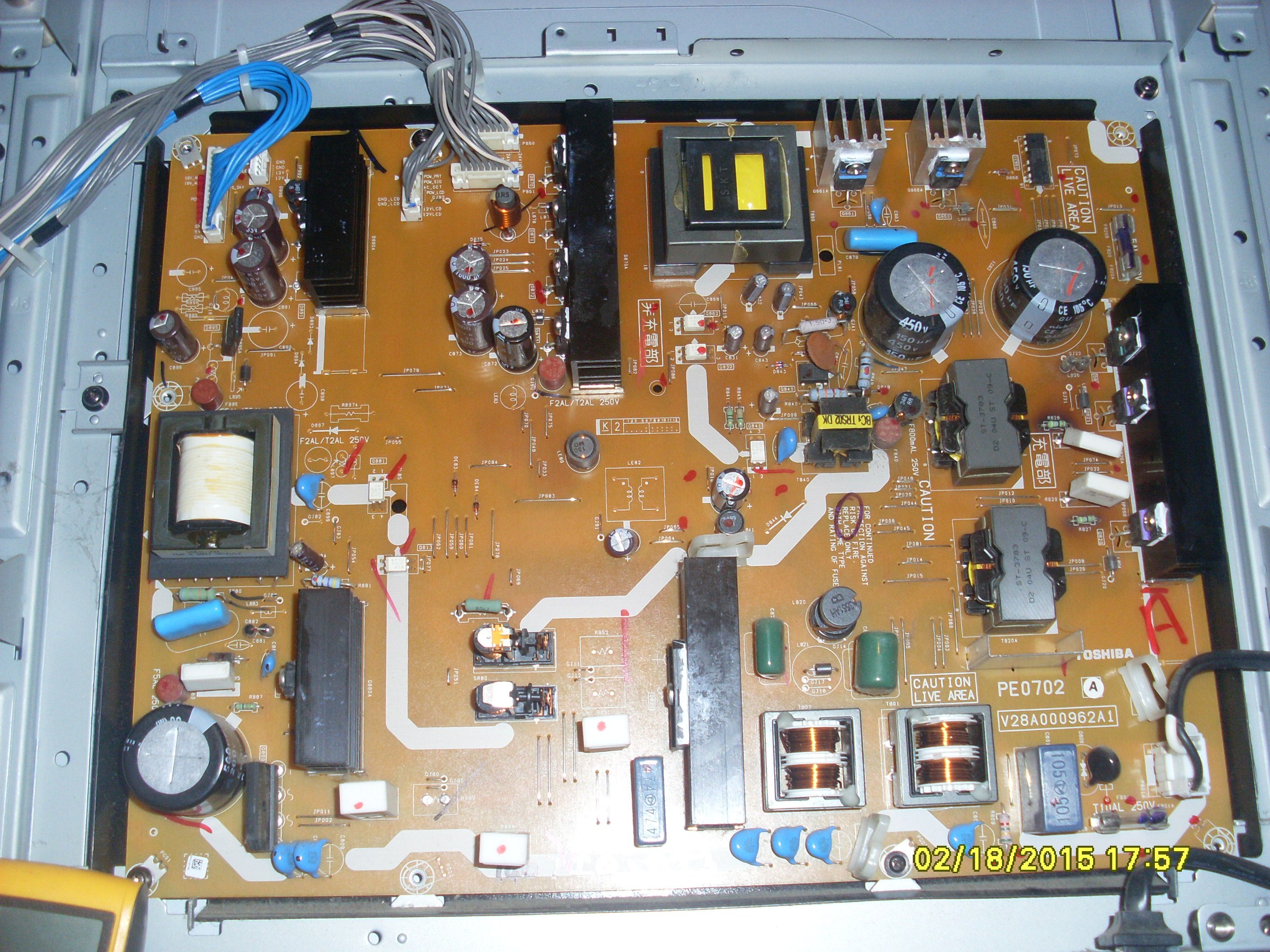

    Ok, full picture of the power board please
      Attached
        Re: Toshiba 46xv645u 1-Blink 2-Blink 3-Blink Upon Power Up..
        Why are the covers missing from the two relays near the bottom of the power supply?
          I pulled them off when I was following Nicholas's info in the previous thread...
            Prolly best to put them back on. Do they ever engage?
              SR80 does... It will close when unit is plugged in. When unit is unpluged, SR80 will open, then close, then open again...
              SR81... Doornail dead...

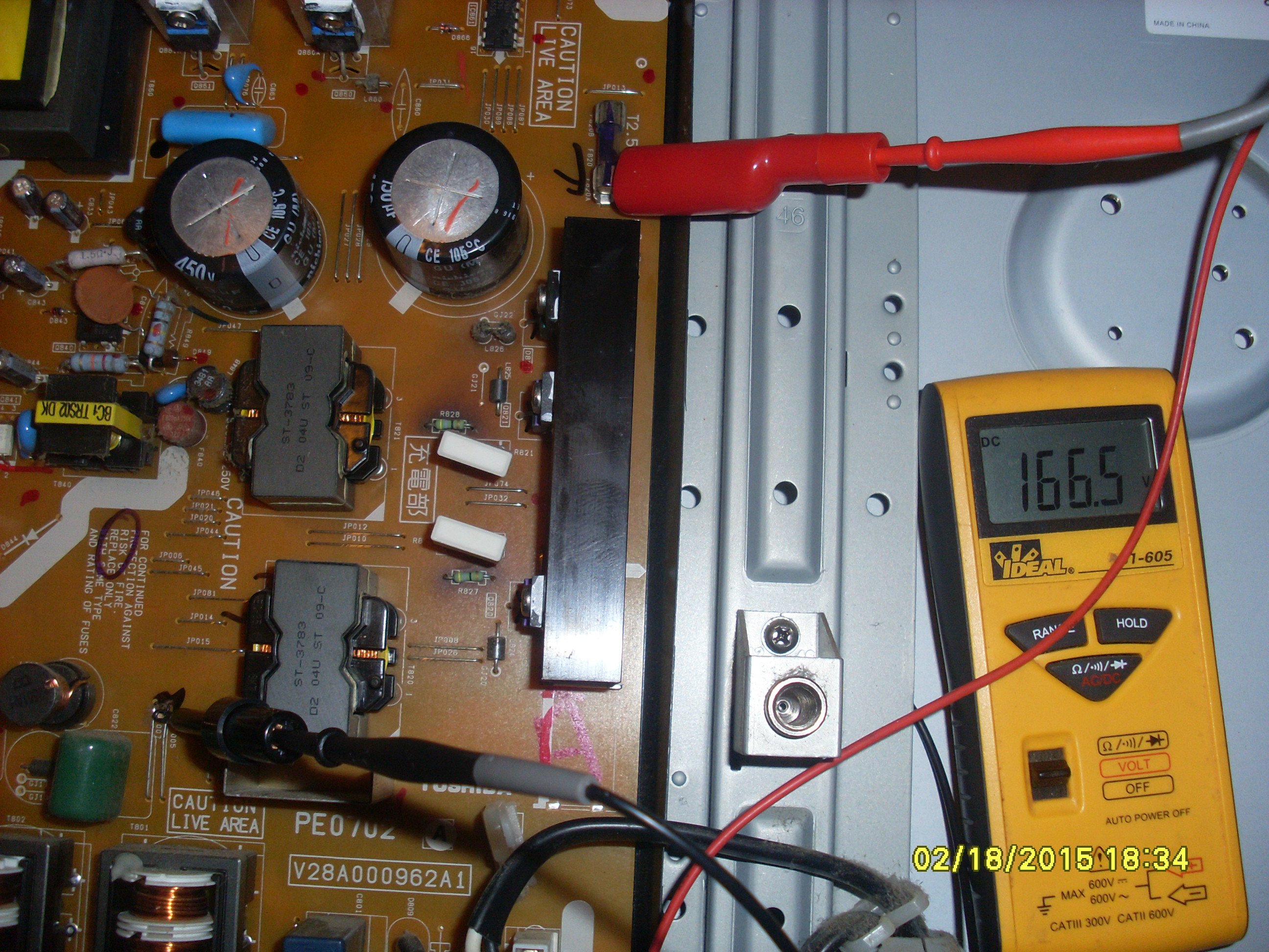

                Ok, can you find some way to measure the DC volts across the two large 450V caps in the top right of the power supply? Maybe try tracing the pos and neg to nearby pins and probe there. Danger -- high voltage!
                  Need both?? Or will one suffice???
                  Never mind. They are in-line... I found the nearby pins.. POS is one side of the FUSE and the NEG goes to a jumper set.. One sec
                    Just one, I suspect they're in parallel.
                      On the 150uf 450v Caps, the voltage is 166.xV
                        Does this change at all when you first power it up?
                          There doesn't seem to be any difference between "plugging in" and "powering up"..
                          It's at 3V when first hooked up..
                          When I plug it in, it shoots up to 166.xV and there is no change if I push the power button..
                            I was leaning more towards the power board being the problem.. But with the blown cap and no voltage on the inverter board fuses, I am rethinking..
                              I'm fairly sure this is a power board fault.
                              I need to find a schematic of the board.
