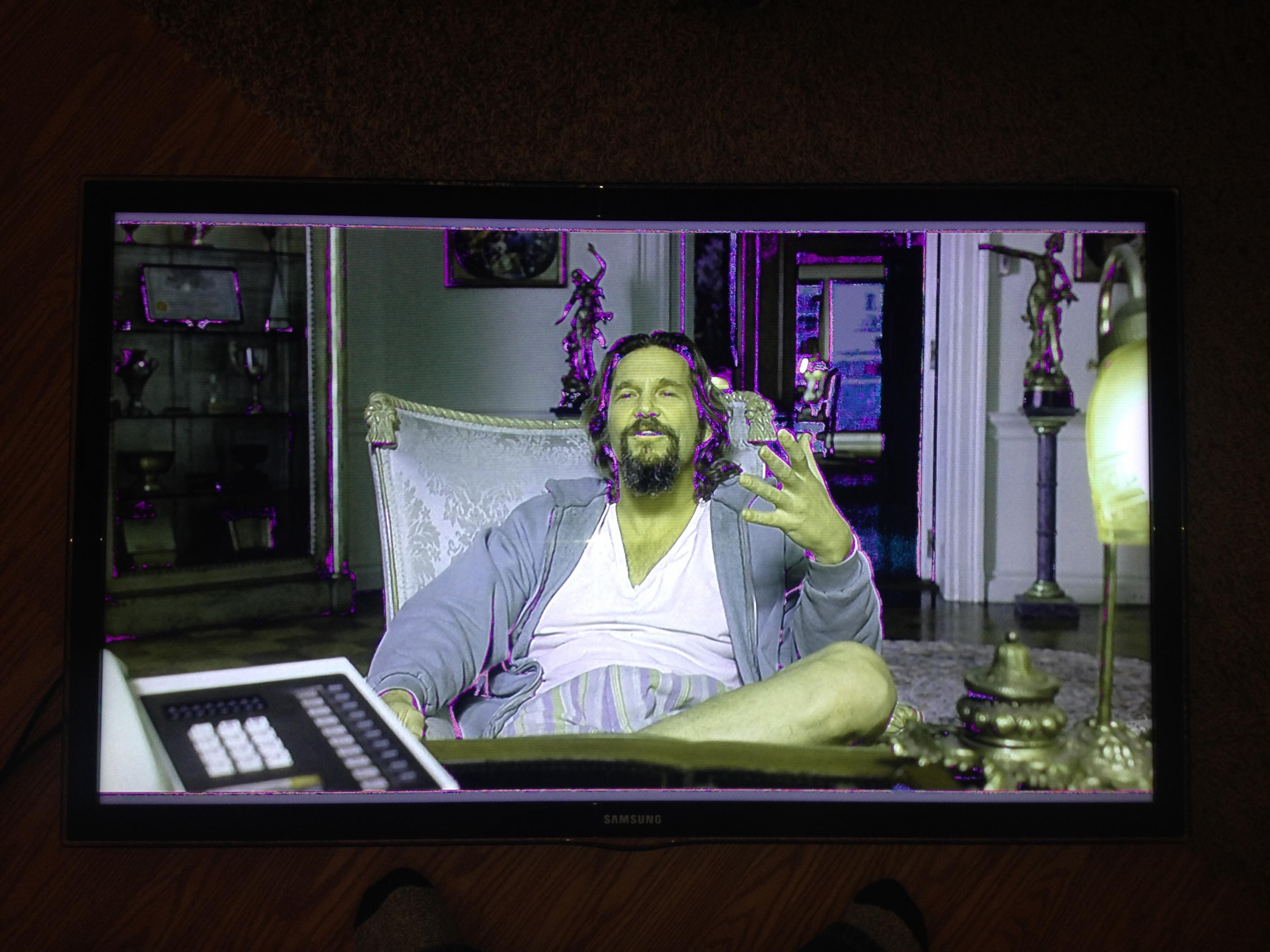

Tv has bright white screen, can see very faint smart tv logo pop up then all white again. This tells me main board is working. Reseated all lvds at tcon, did not help issue. Have 12v at tcon fuse. Did find a seperate smaller fuse at bottom of tcon that looks "cooked", no short though. Measures 1.4 v one side and 17v other?

Thanks for info. Unhooking left/right lvds to tcon does not change picture at all. I may consider this one a parts tv.Comment

Looks like loose LVDS or main board panel setting wrong. Good news is panel looks OK to me.Please do not PM me with questions! Questions via PM will not be answered. Post on the forums instead!

Ive cleaned, reseated lvds 3-times tcon to main to drive buffers does not help. Im going to try to do a firmware update first, it needs a update. Tom do you have service manual for this?Comment

Looks like maybe the wrong version of tcon was purchased. Did you order by part number on the sticker, or the board number that's printed on the board. I know these tcons have many different version as they can go in different size panels. I suggest you compare your original part with the one you purchased. The last 4 numbers and a letter of the actual part number will be on the sticker usually.Comment

You may be on to something nicholas, i went with the sticker on the back and seller assuring me it was out of a un46 model. The numbers are very different though, model printed on board is the same though. Original is m$35-D060329-L$UT311964EJ91.... New board is M$35-D061337-L$Qt31170B7851.Comment

Ahh, yep chi mei panel. You will need to order the exact one as they are very specific. The 35-D060329 if the number you will need to go off of.Comment
