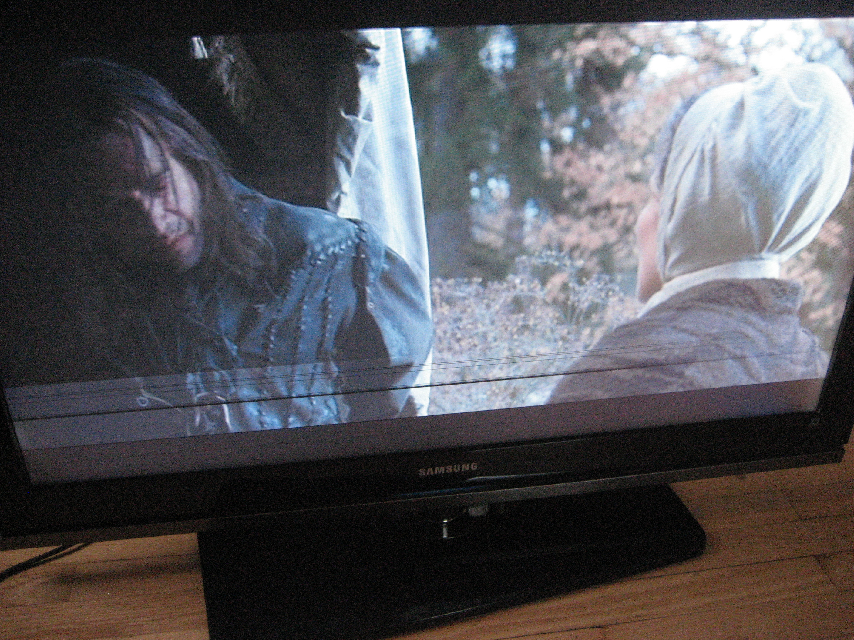

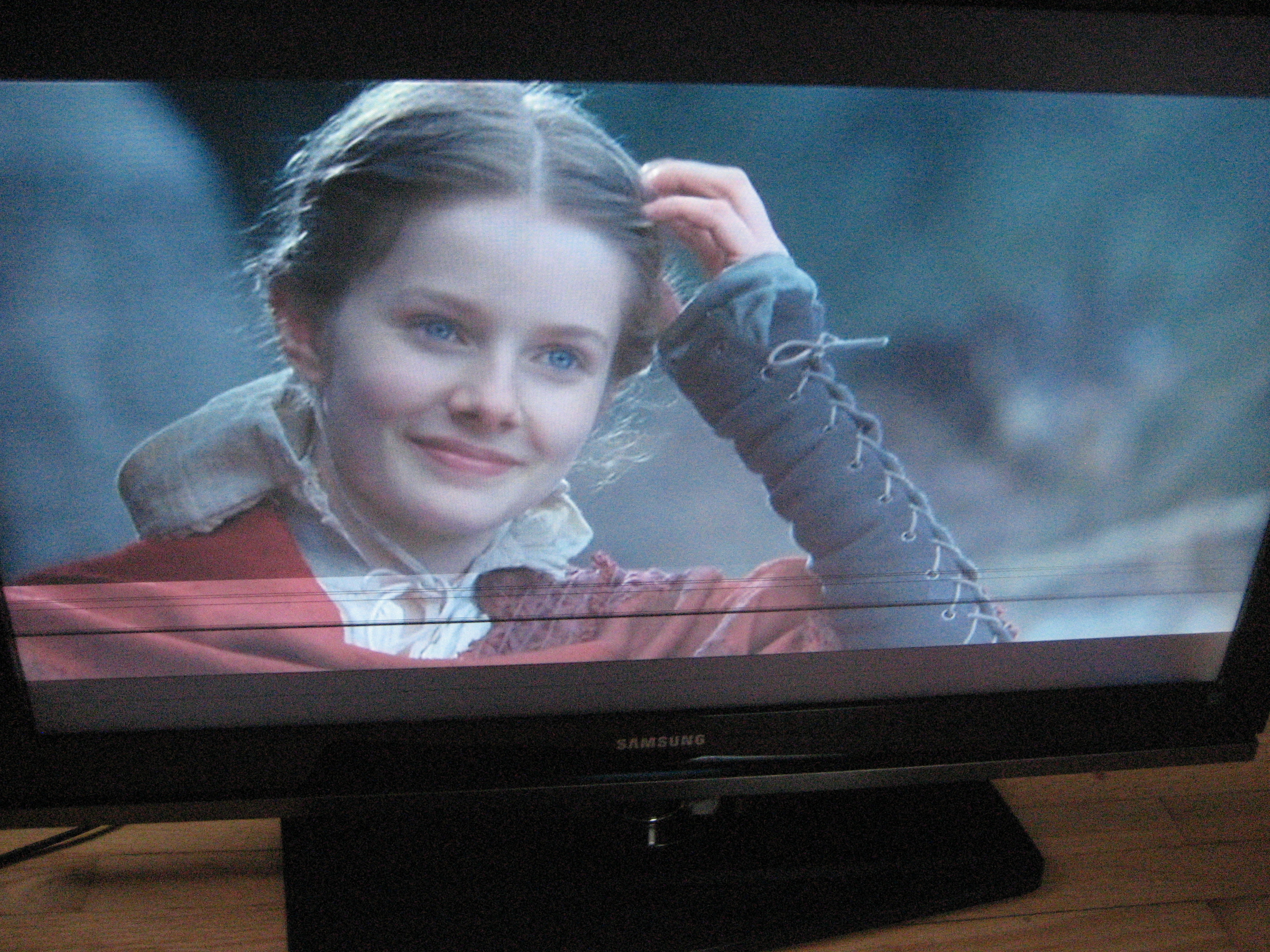

                Re: LN-T4069f video issue
                1st attempt at loading pics....
                • vbrad511
                  • Feb 2015
                  • 70
                  What's seen in these pics is after I place some plastic shims under and on top of the offending side tab. With the shims not there the stripe was clear-pictured, but darker than the rest of the tv.
                    To me... that looks like a defective LCD panel... sorry!

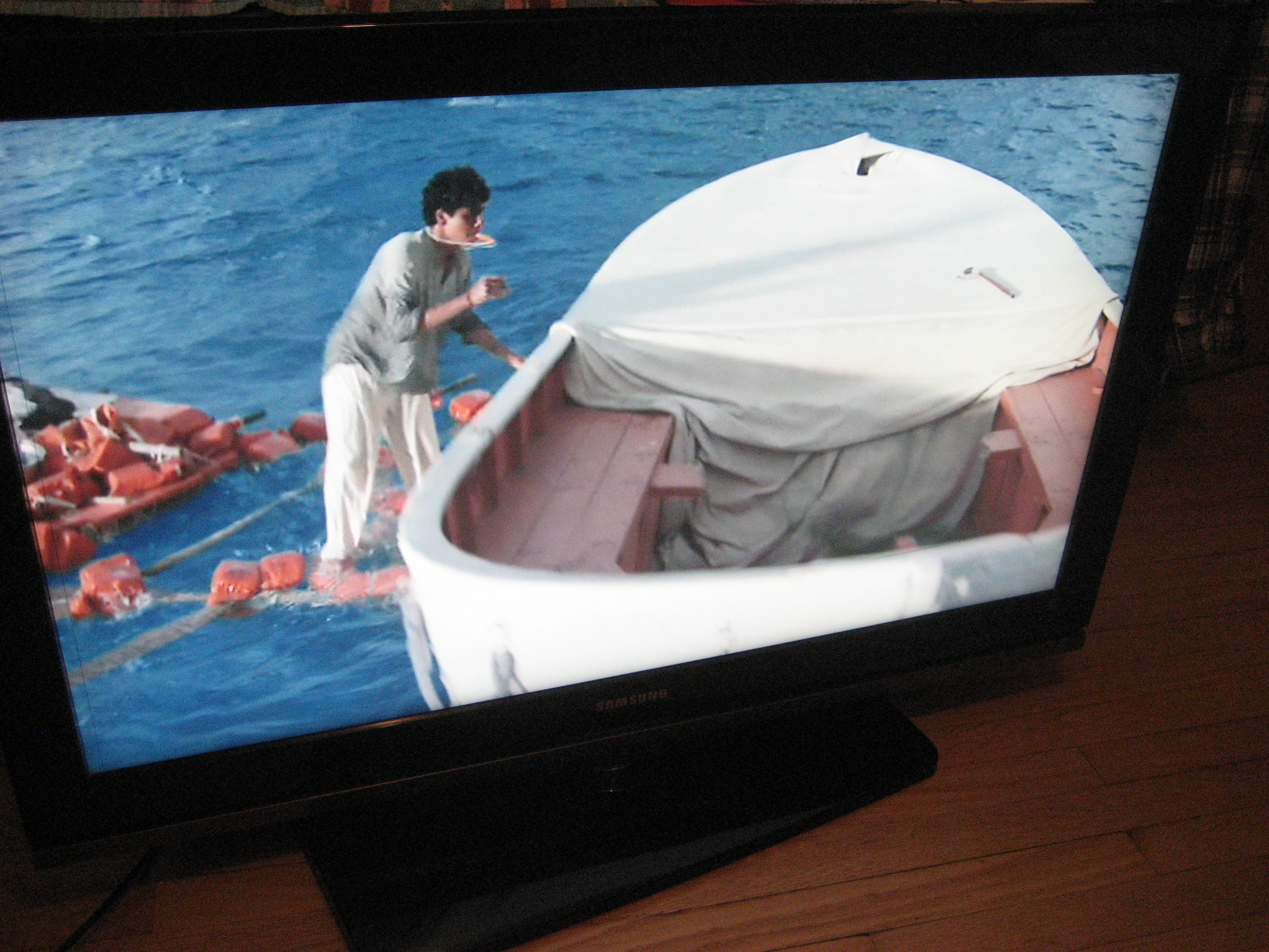

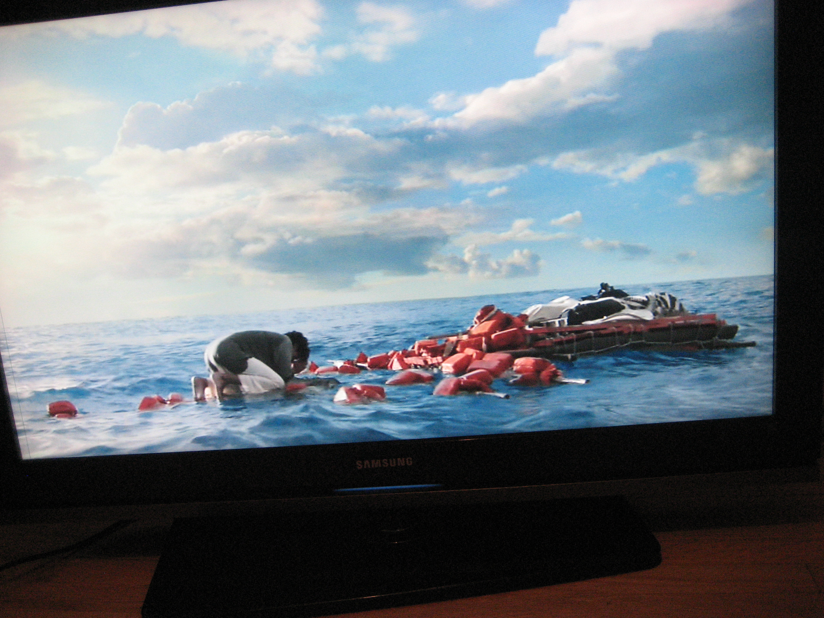

                      I place silicone pads on the upper tabs several days ago and the original problems basically went away. There was still a "little" odd behavior when cold, but once it warmed up (3 or 4 minutes) it was crystal-clear, for as long as the set was on. It only developed the stripe after I pulled it back apart to thicken the pad on that upper left corner, and ended up damaging the one on the vertical side. At this point I'm debating pulling the other side tabs loose and removing the plastic shims around that left tab to see what it does. I get the feeling the pic is going to fade lighter on the left side, but again, what is there to lose at this point...
                      • vbrad511
                        • Feb 2015
                        • 70
                        Well, given the shape of things I figured there wasn't much to lose, so I tore into it one more time. It was the tab on the left vertical side at the bottom that'd come loose, and the makeshift shim and pressure pad did change it, but not much, and it took a fair amount of pressure to even get that much. Without that pad and shim the picture was still there, just a bit lighter than the upper 3/4 or so of the screen. There were no wires attached to the tabs so I thought MAYBE they redirected signal through the lcd, and seeing as one of them being displaced lightened the picture and didn't kill it, so why not disable the other 3 on that side, so I did. Got it back together and things look fine. I had to make a few adjustments on the settings, and I've got a very thin blue line on the out left edge, but I'm happy with it. I MAY try to reset the silicone pad on that upper left tab, or I may not..
