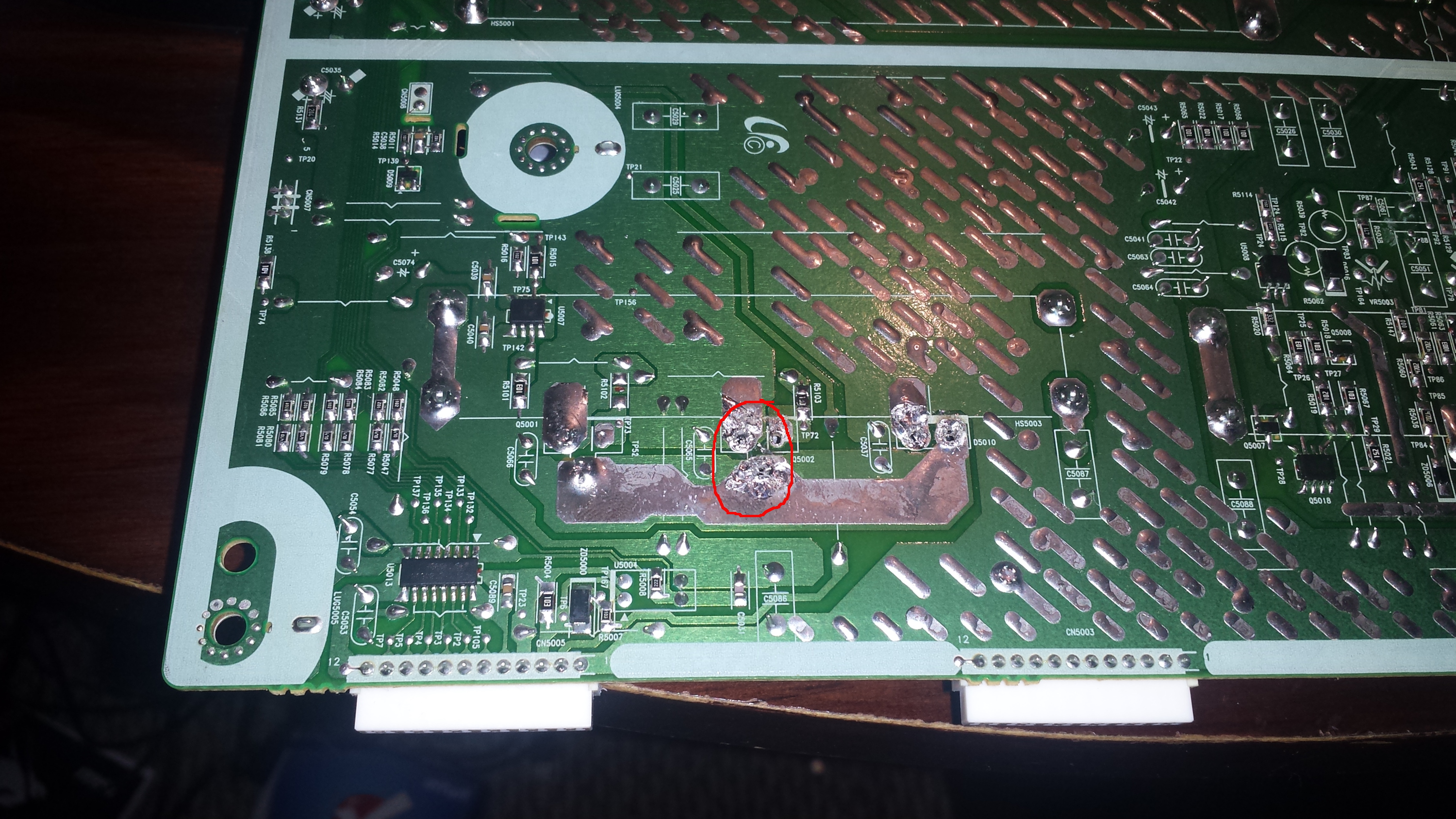

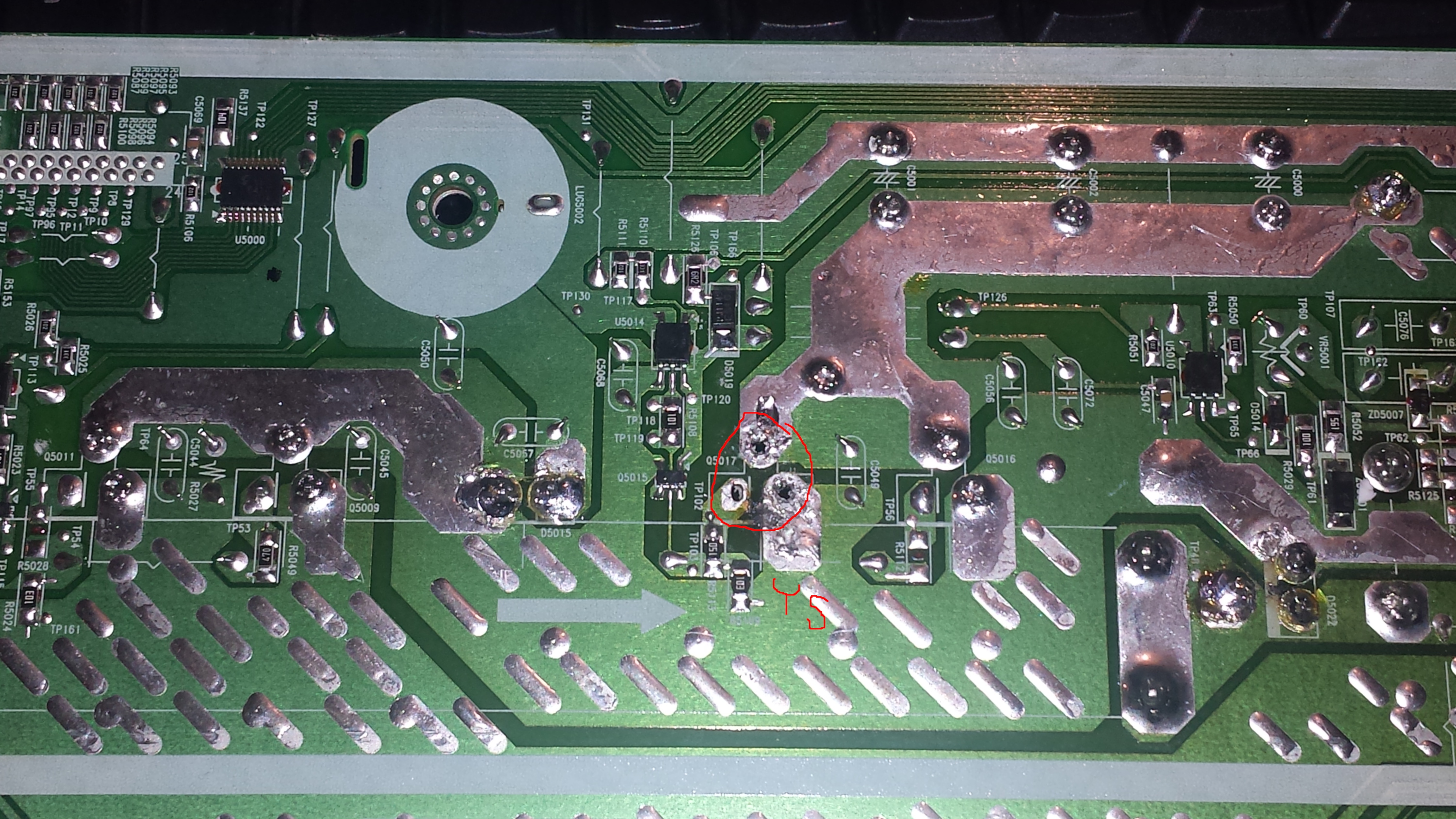

Samsung Plasma PN51D490 No picture.

    Re: Samsung Plasma PN51D490 No picture.
    Here is the solder side.
      Have the service manual for this tv now.
        U5007, U5014 and Q5015 are the driver ICs of interest. They should be replaced when replacing the FETs/IGBTs. You can try running the set with these parts out. You won't get a picture but voltages like Ve, Vsc, Vs, Va etc should power up.... you MAY see a few "sparklies" on the screen, but that's all.
