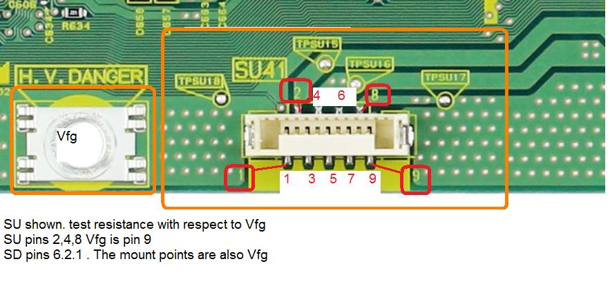

    Gentlemen, I have a Panasonic plasma with an original 4 blink sos. I downloaded the correct manual for my set and followed the detailed flow chart, and discovered a shorted v-sus line. Continued to follow the chart and discovered bad Sc board. It took a while to learn how to disconnect everything necessary, as I have never worked on anything but LG and Samsung Plasma's. All other boards check ok. I would like to confirm my buffer boards are ok I do not quit understand how to do this part of the chart. Can I remove the SC board completely and then check for resistance on the points listed in the manual, or should I put SC back in? Thanks for all the Help in advance, George.
    If you're doing a resistance check as per the G20/G25 troubleshooting guide then you should be able to it insitu with the boards in, SC out. Disconnect the interconnecting ribbon between the sd/su. measure and record results, reconnect that ribbon when done.
    this will save the hassle of getting the panel ribbons back in stright which can be fiddly.
    you'll need a meter to measures about 6Mohms however if you have one that goes to 2meg, and it goes OL then that should be good enough.
    usually Vfo will go short and the others can also go short or have a resistance substantially lower
    Generally speaking the buffers survive, however, I have had one i did not check where both sd/su where shorted on the vfo and the 5v_f lines were substantially out. Result of that mistake was blowing up a brand new SC board
    Moduslink have a good price for the 54" board $68 for repair return. Taking labour and parts prices into account I would not bother attempting a self repair with a kit unless you've done one before.

                  Gentlemen, I have some results, I would like to share, for my buffer boards. Starting with the SU upper board. TPSU15 =5.91m ohms VFO TPSU16 =219.1K ohms VSCN-F (TPSC1) TPSU17 =9.48m ohms 5V_F On to the SD board. TPSD29 =6.23m ohms VFO TPSD28 =219.8k ohms VSCN-F (TPSC1) and finally TPSD26 =35.51m ohms 5V_F All tests were done according to the manual slide 43. If anything looks out of place please let me know, thanks for all your help.
                    safe to use

                                        Received My repaired SC board from Moduslink today, getting ready to install it. Anything I should watch out for, or recheck, before I turn on. Don't want to blow anything, if I missed something with the buffers. thanks guy's.
