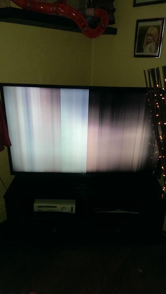

    Hi, I've been asked to look at a TV because they've lost the receipt and can't take it back.
    The TV powers up, to a back lit blank screen, originally the picture went blurred with like lines (I'll upload a picture) but now it's just blank.
    I thought t-con but it's an LED TV and it seems to be integrated with the panel.
    Anyone have any thoughts? It's still within it's warranty, just can't be returned because of no receipt.
    Is there any common vestel issues that would cause this fault? thanks guys.
    Re: Hitachi 50HYT62U back light but no picture.
    Looks like a bad LCD panel to me. Probably not going to be repairable.
    Will be more and more common as these budget LED-LCD TVs start dying, it'll be panel, LED backlights or main board (firmware) before anything else.
