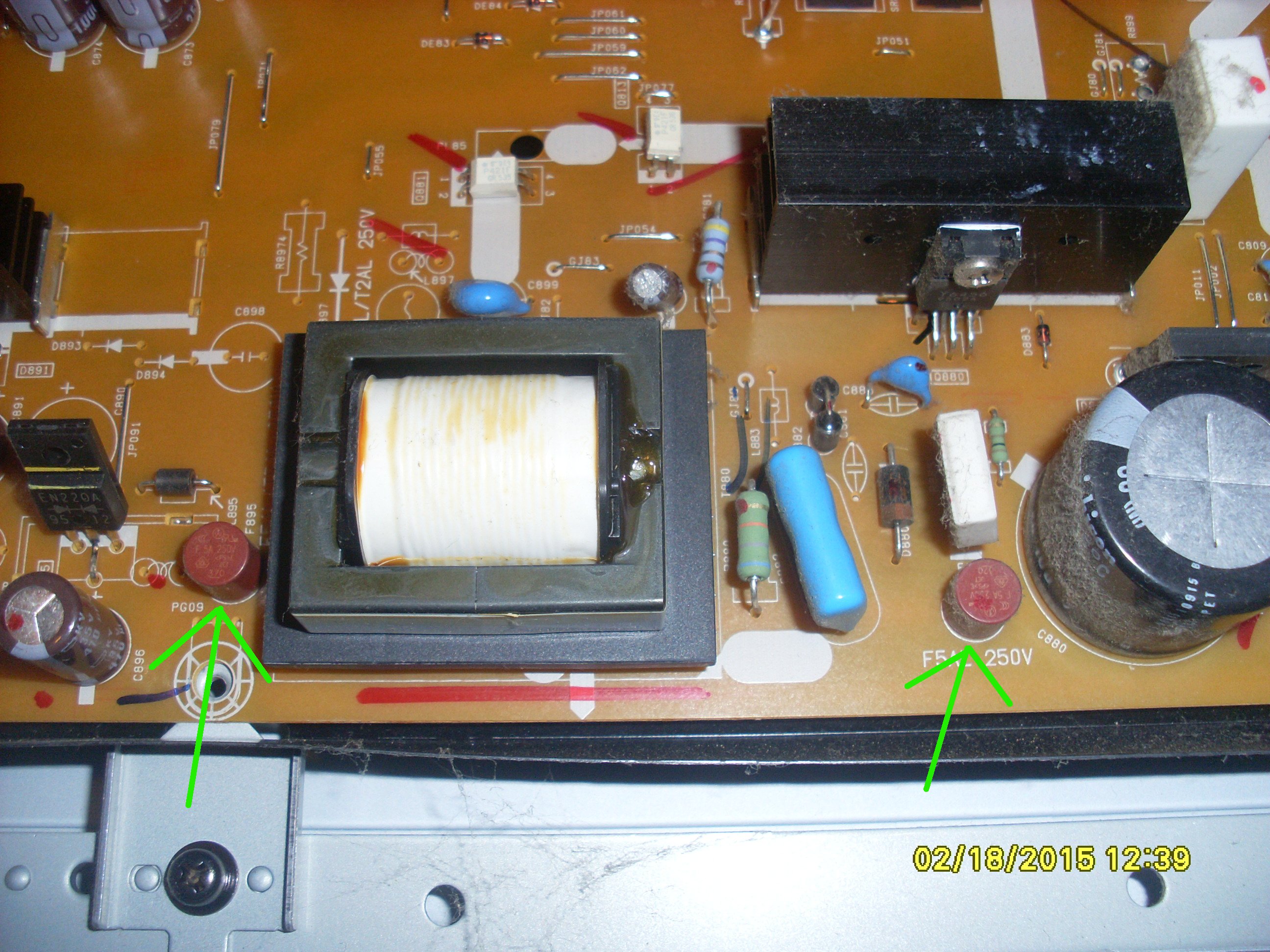

    Having a bit if a hard time with this toshiba. I have repaired this tv 3 times for the same issue. The symptoms of the tv are dead, no standby voltage. So let's start at the beginning of the story. First repair attempt, I replaced the open cement fuseable resistor r850, and q880 which is str-y6456 ( was not shorted). Sent the tv back to the customer, tv ran for about a 2 weeks. Tv came back. Same r850 fuseable resistor was open. This time I ordered a repair kit, which came with r850, bridge rectifier d820, and 2 47ohm resistors at r827, r828 ( which are running hot as the board has browned near them but they show 47ohm still. Tv ran for about 5 days this time, and back with the same r850 resistor open. There are no shorted mosfets. My only thought is maybe the 2 150uf 450v caps.
    So main question, what can cause this fuseable 1.8ohm resistor to keep opening?
    I have 3 more of these TVs in my shop right now with the same issue, and I'm hesitant to send them home. I've let them run here for over 48 hours now strait with no issue.
    Any help would be appreciated.

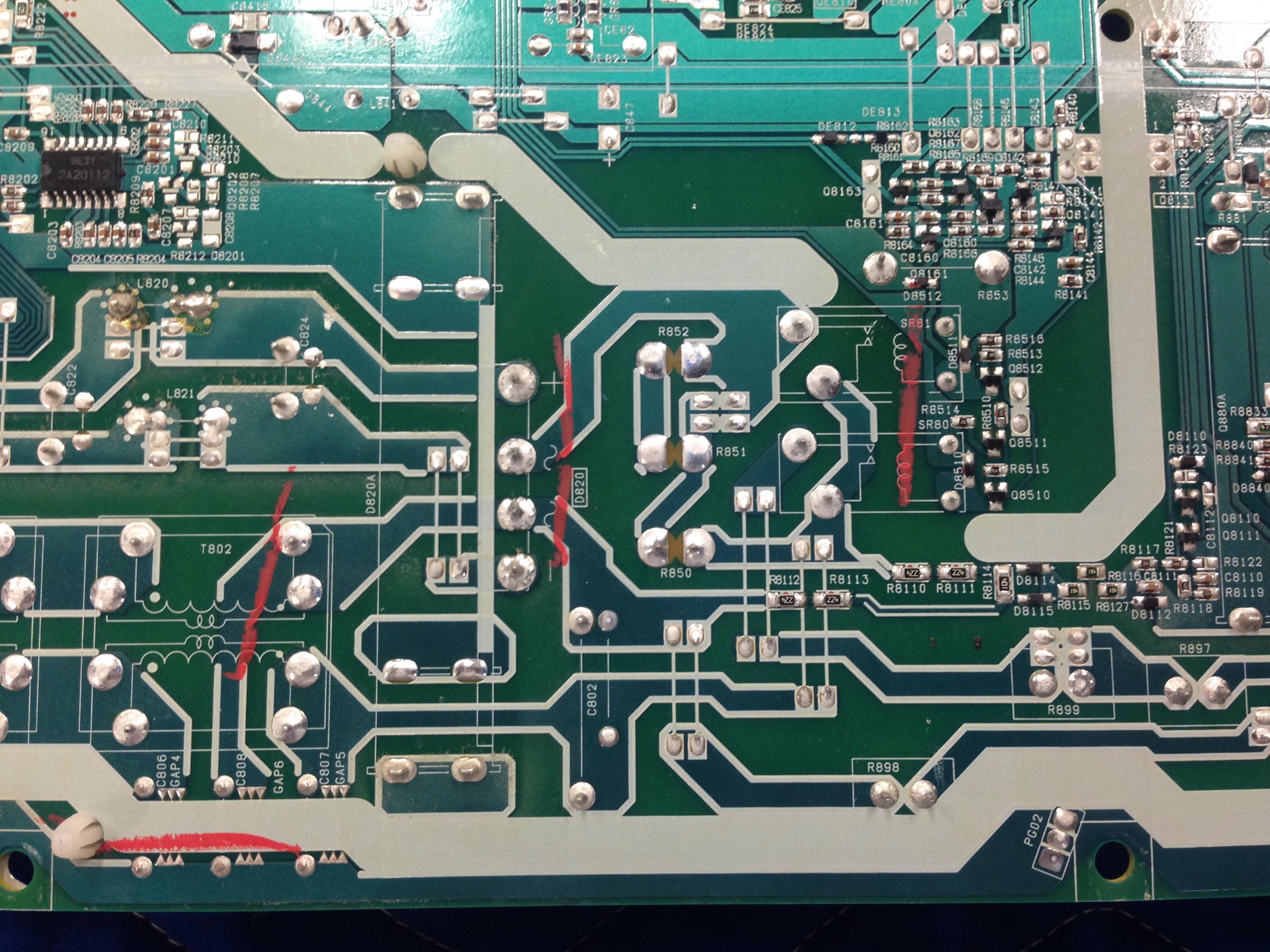

      Please upload the pictures of the whole backside of the TV, and also the bottom side of the power supply board.

        For some reason my phone will only let me do one photo at a time

          Another

            I don't have one with the back off the tv right now, I took these before I repaired the board and put the tv back together.

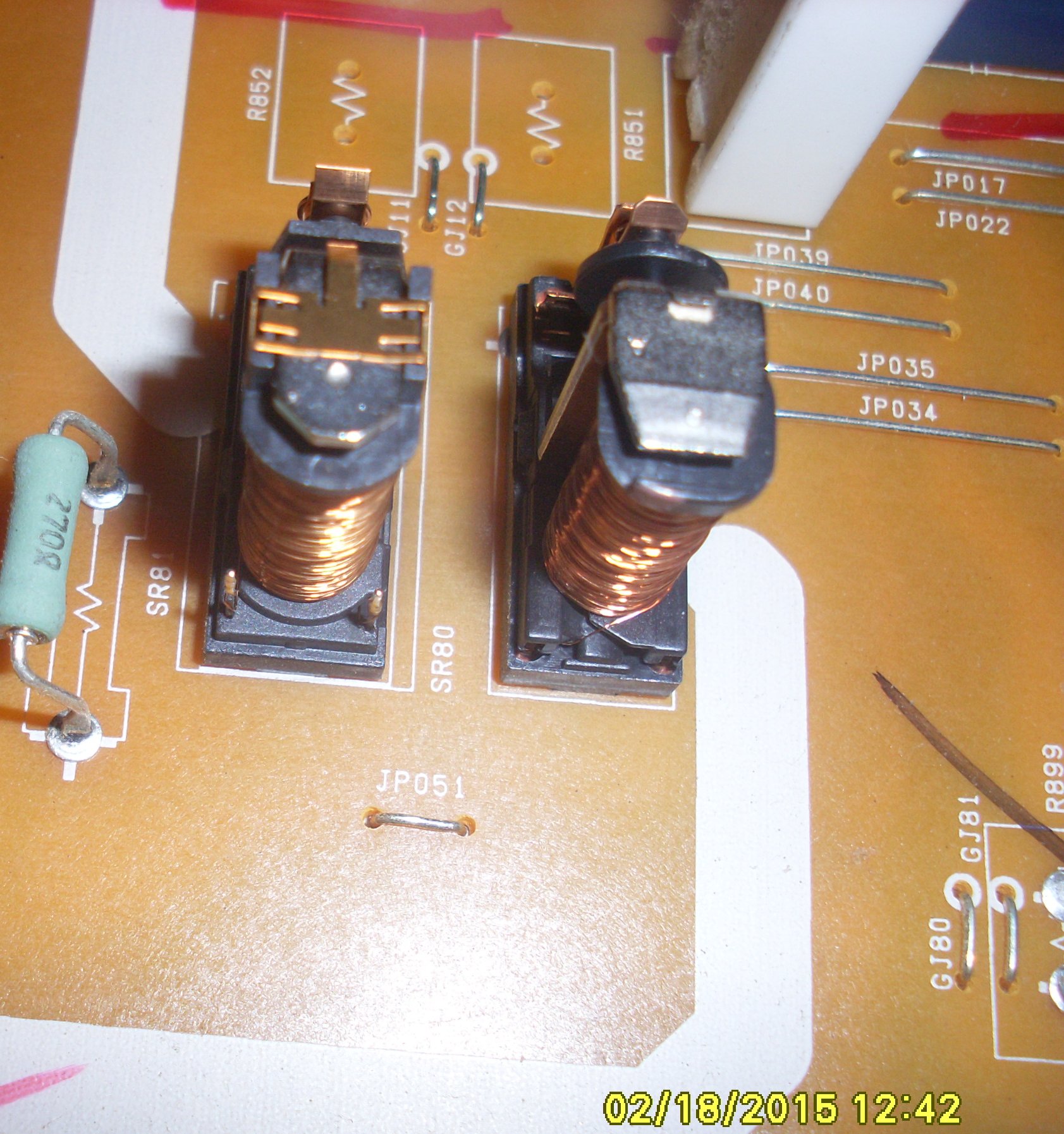

              Ok, found the issue. Relay sr80 has dirty contacts in it causing the r850 to open. I have opened the relays in the TVs I had running, cleaned them up and should be good to go. Hopefully this info helps the next person with this issue.

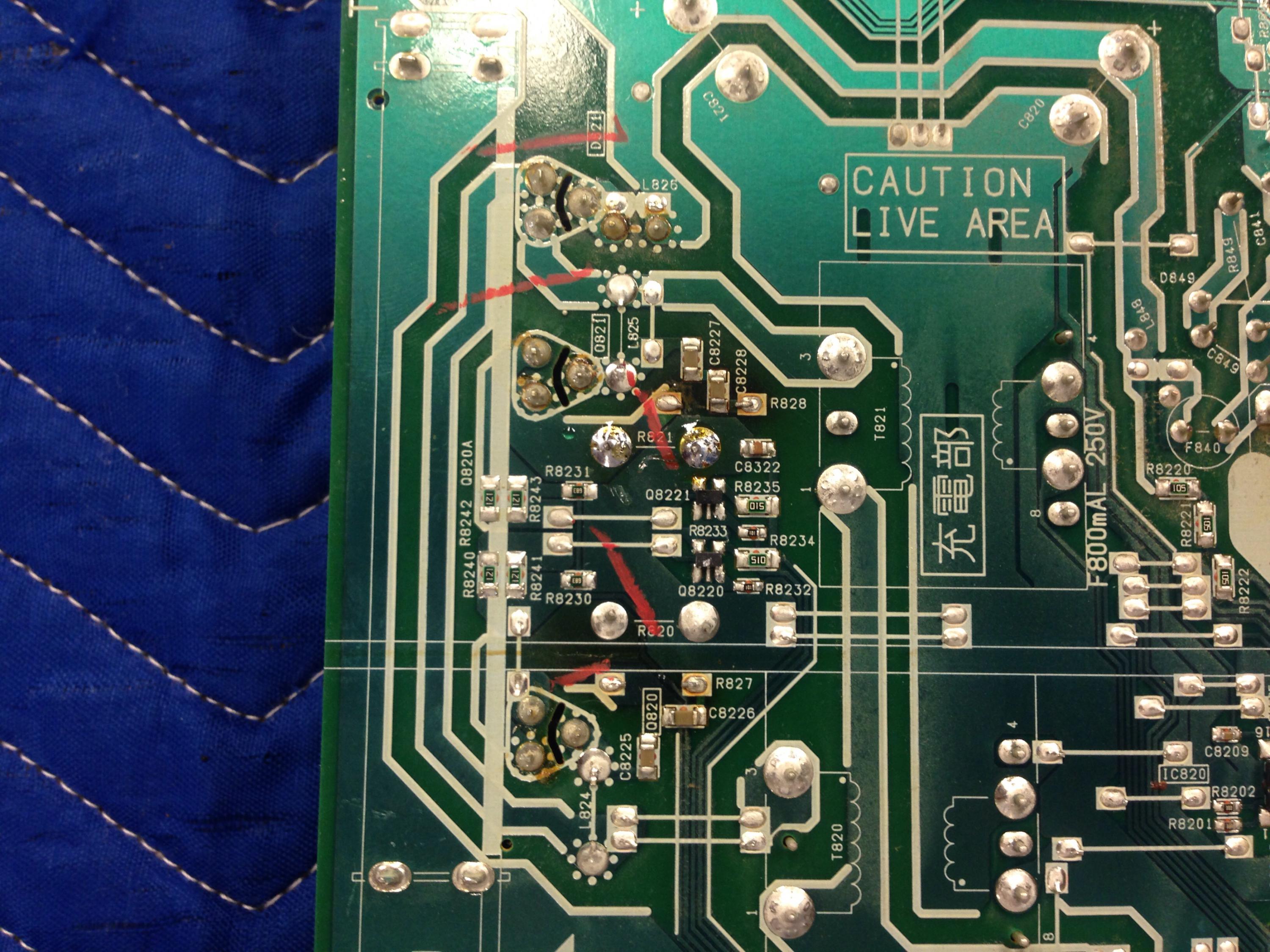

                              I have the same dead TV issue with the same power supply board (V28A000962A1) in a Toshiba 52XV645U. Bridge Rectifier @ D820 bad. Ceramic resistor fuse @ R850 bad. 47Ohm resistors @ R827 & R828 Ohm out fine but have blackened the PCB. I want to replace or clean the 5V Relay @ SR80 as you suggest. I can't find a replacement. How do you clean the switch contacts? I assume you desolder and remove the relay from the board to remove the cover. Then how did you clean the contacts? A spray? A file? Thanks if you get this!
                                I have the same Board from a Toshiba 47ZV650U. Same problem,
                                No power at all.
                                Tested R850 and it is Open. Bridged the contacts to test and it powerd on just fine. But i also noticed the Resistors on mine @ R827 and R828 are Blackened around them. Did you ever Find out the cause or Fix the issue? Thanks!

                                    The contacts on SR80 dont look dirty too me. Will upload a pic if i can yet.
                                    Edit: Heres the best photos i could get.
                                    Can try to get better ones 2mrrw.
                                      Re: Toshiba 46xv645u dead power supply
                                      The relay contact are blackened and pitted.

                                        Does that mean i need to replace the Relay as well? or is there a certain method to Cleaning/restoring the contacts of the relay?
