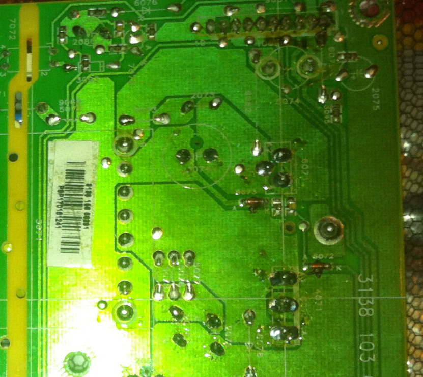

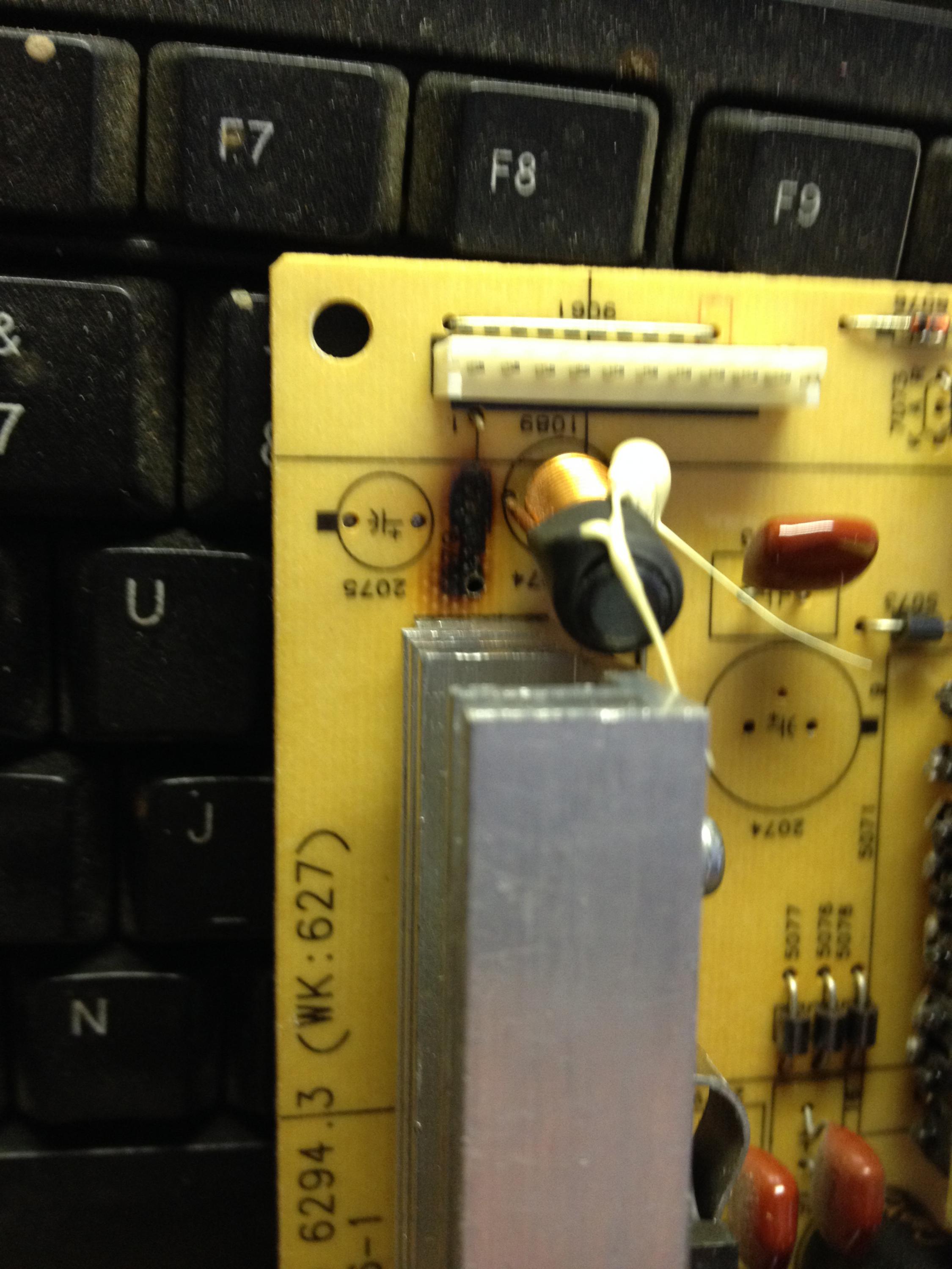

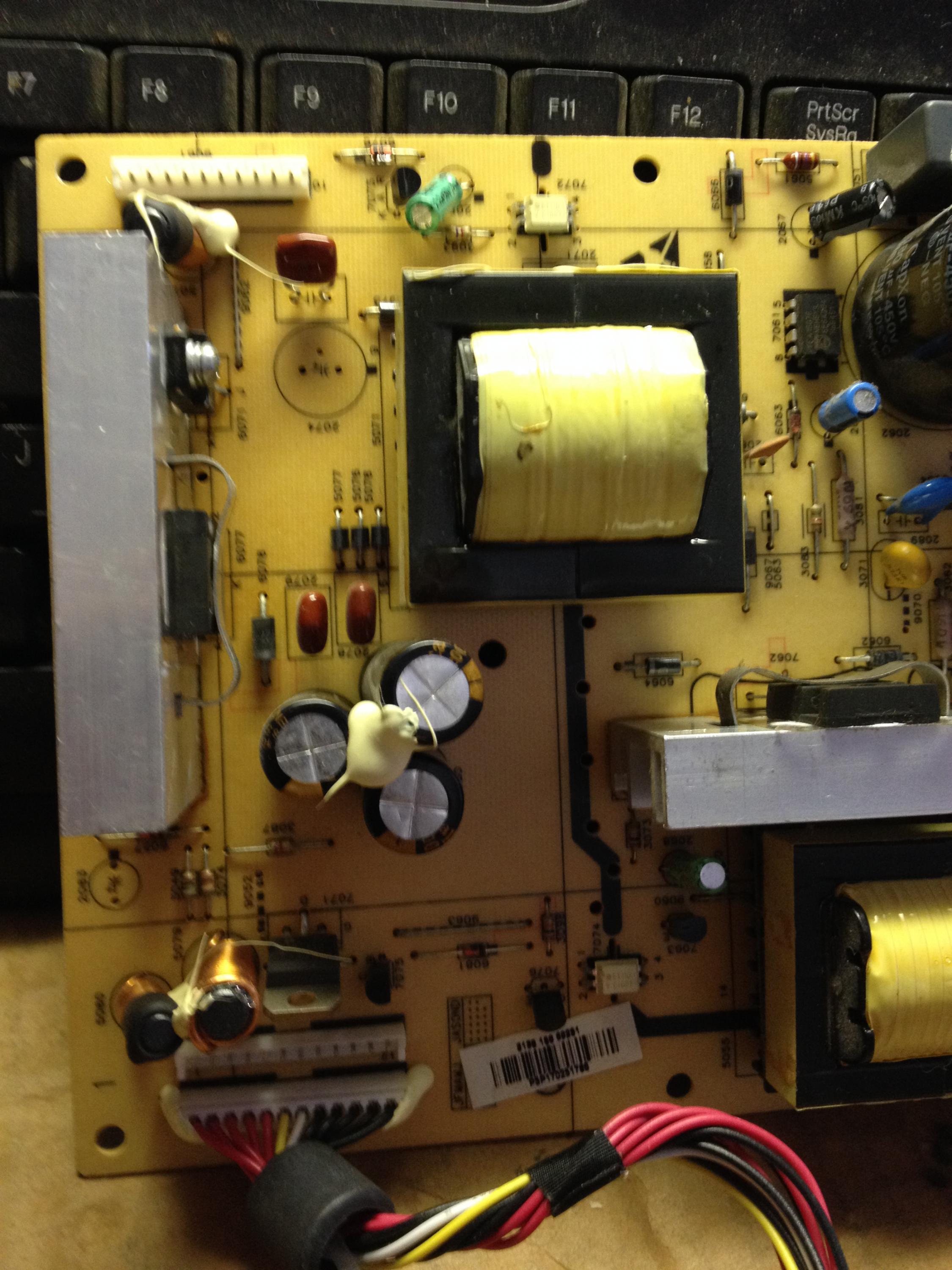

    Here is picture of problem
      Re: magnavox 37mf321d/37 burned power supply

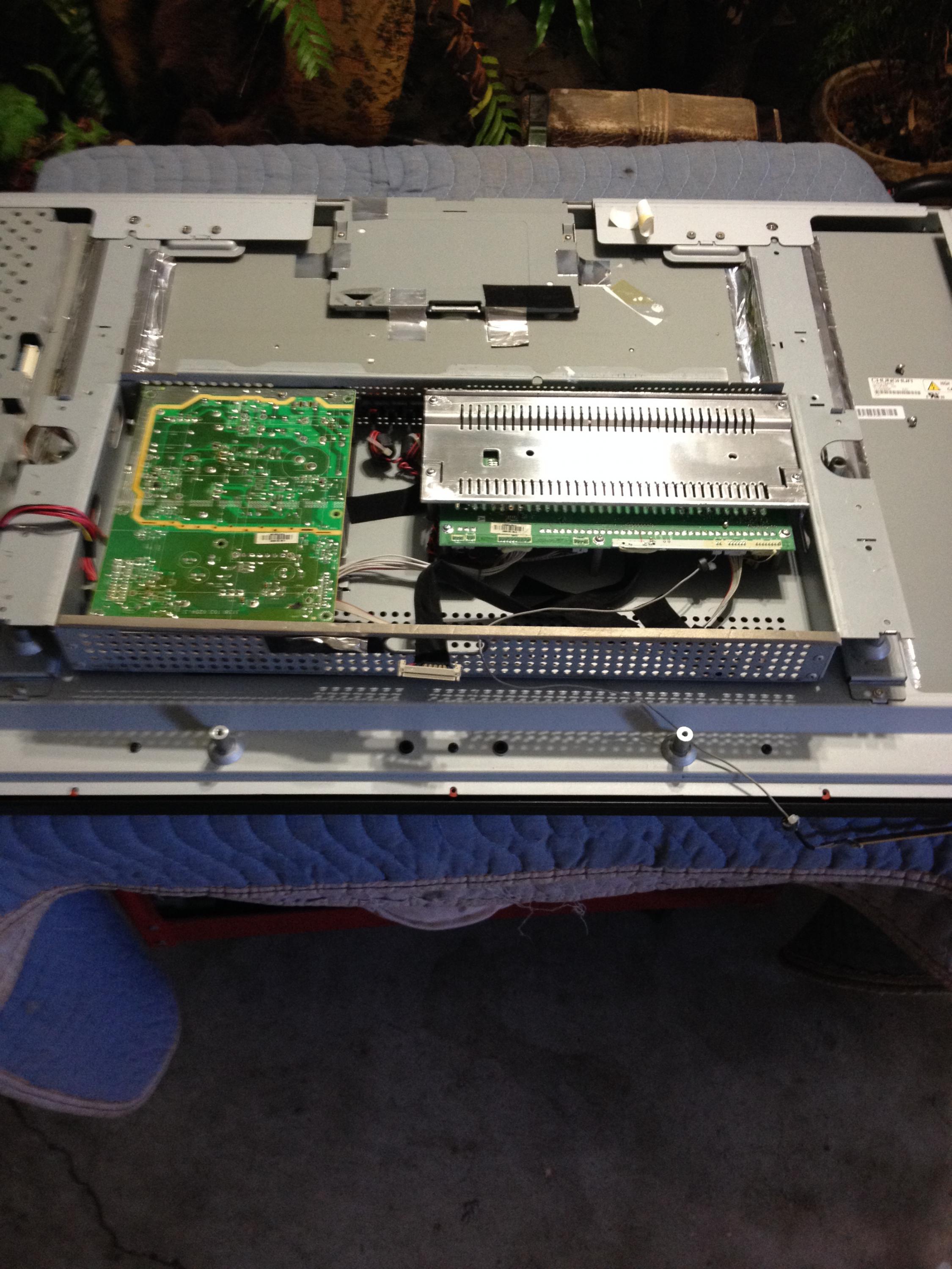

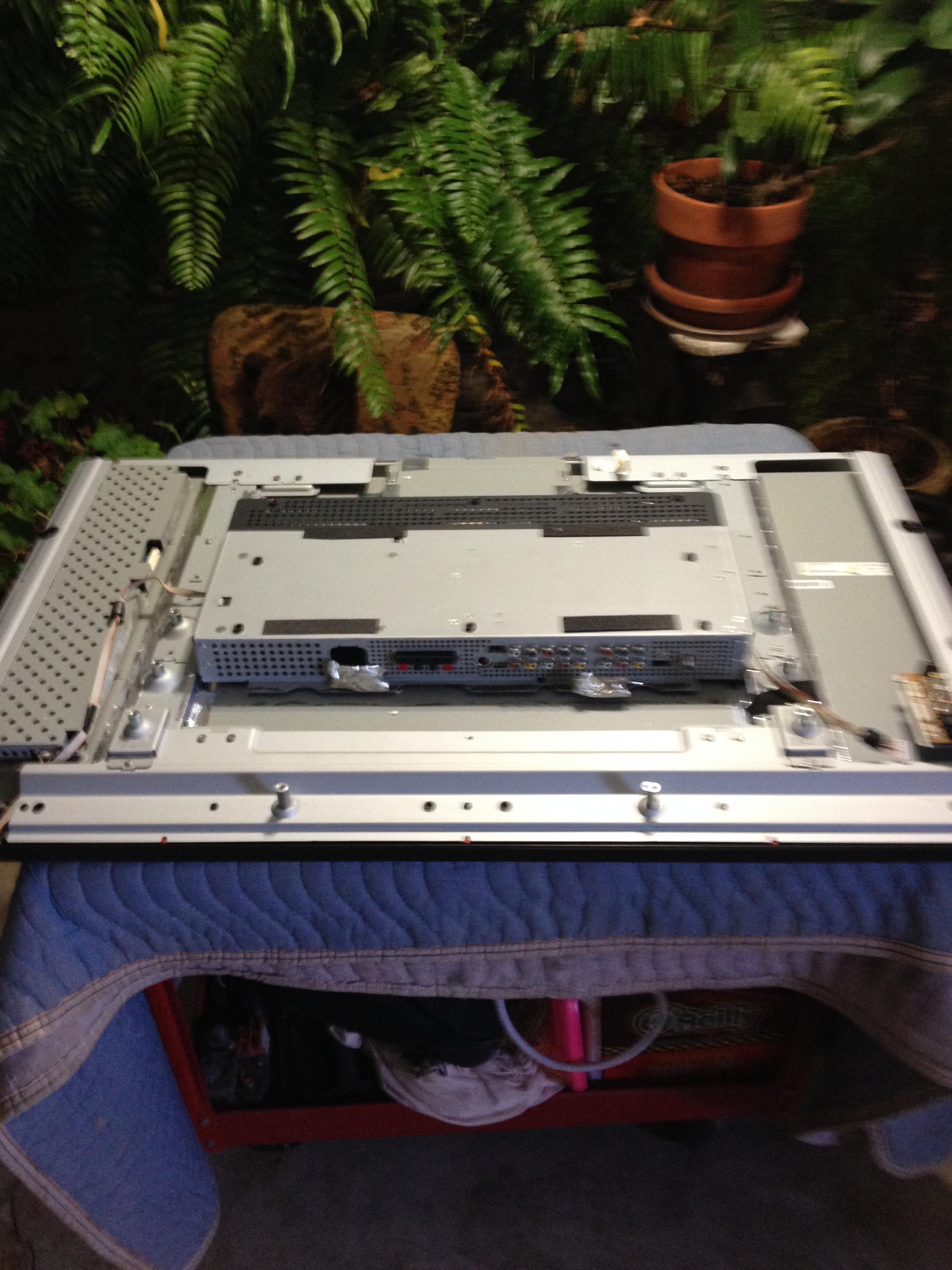

      How about the pictures of the whole board? both sides of the board.
      Also the pictures of the whole backside of the TV.

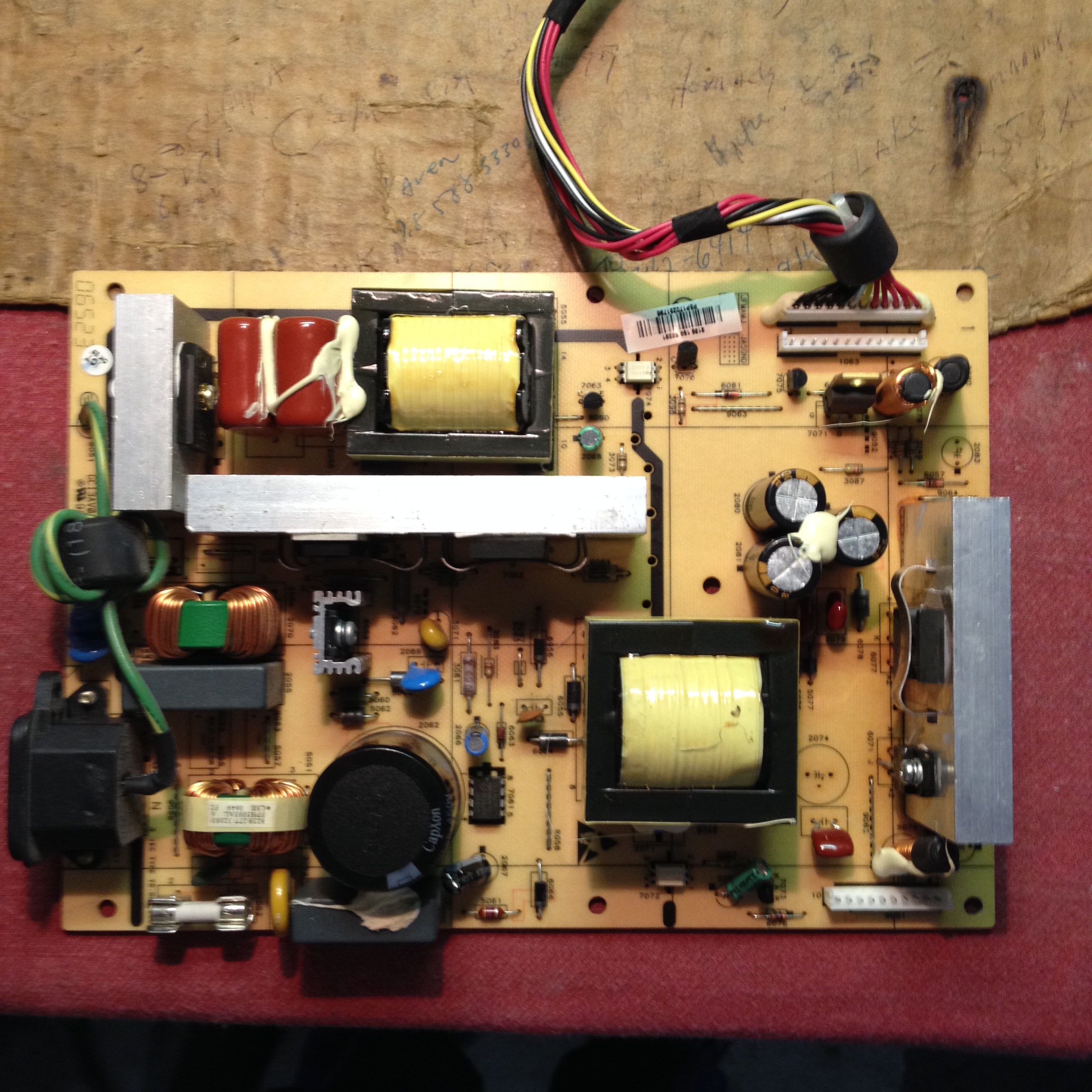

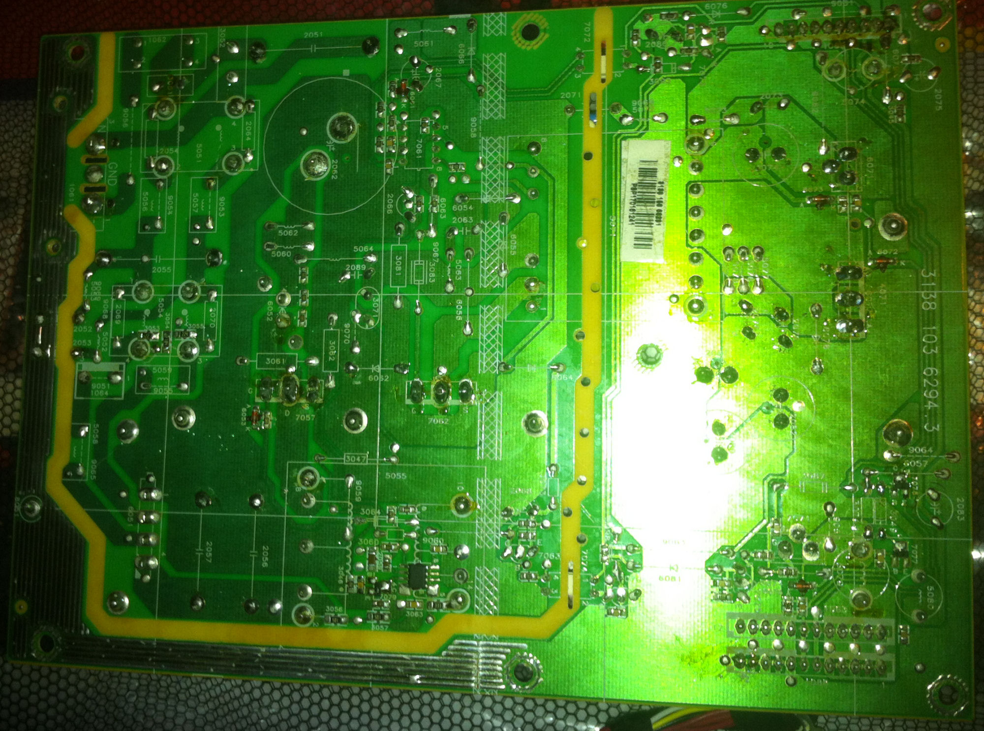

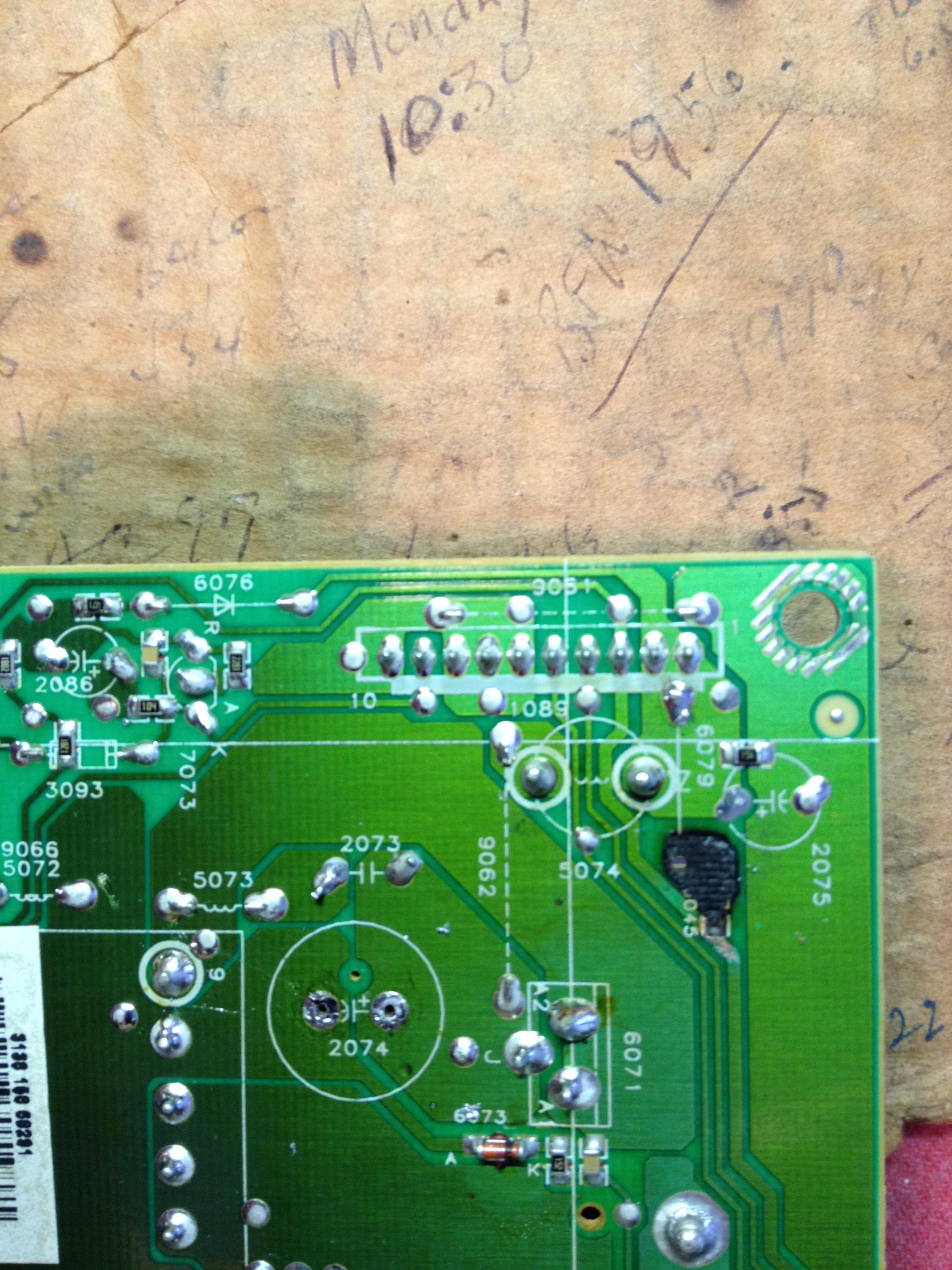

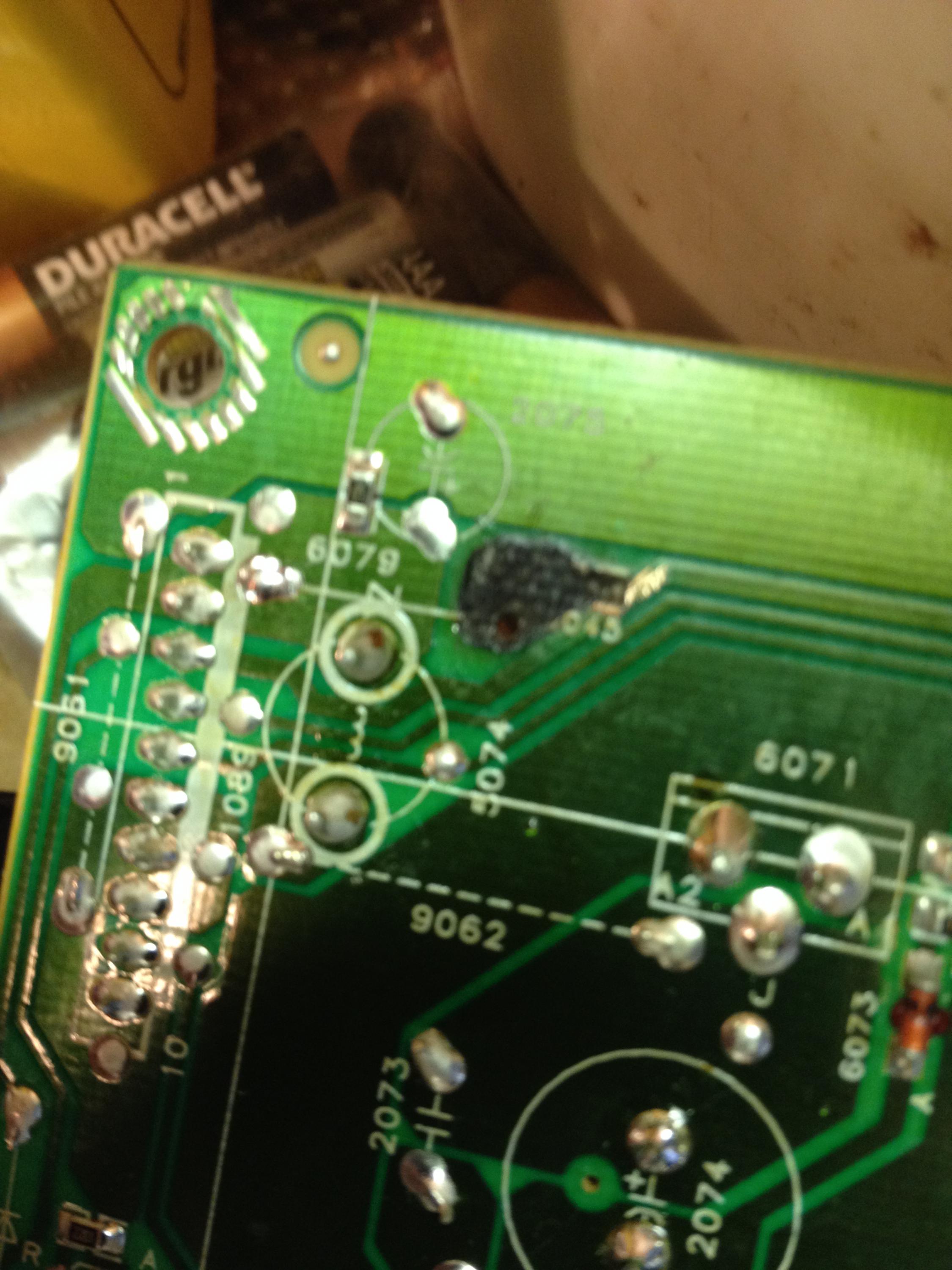

        More pics. Have been unable to link to this site till this morning.
          Good closeups of the bottom are going to be necessary. Split it into 2 or 3 pics if you have to. I recall having one of these with a bad diode on the bottom, one of the glass ones. I didn't have burns though.

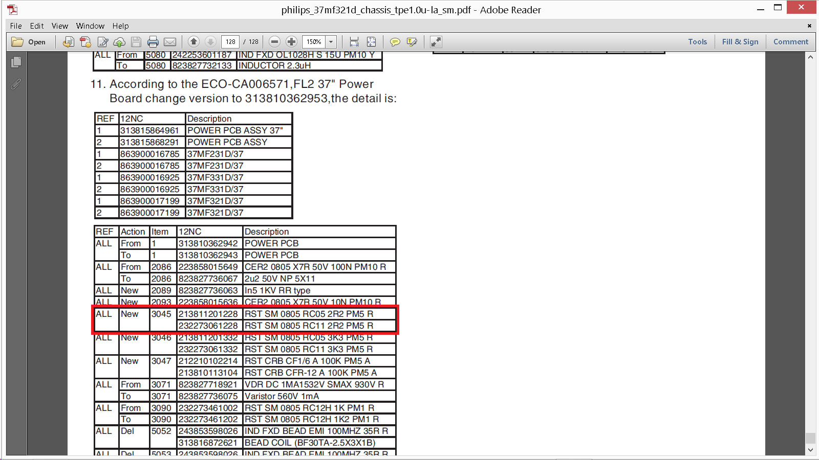

              Thanks for the schematic Budm. It is the same one I found i think. It does not have components 6079 or 3045 in the index or the schematic that I can find. Am I missing something?
              Lookimback, here are some other pics but probably aren't good enough.
              Am also replacing bloated cap at 2074. symptoms were green led on front panel blinking all the time when plugged in.

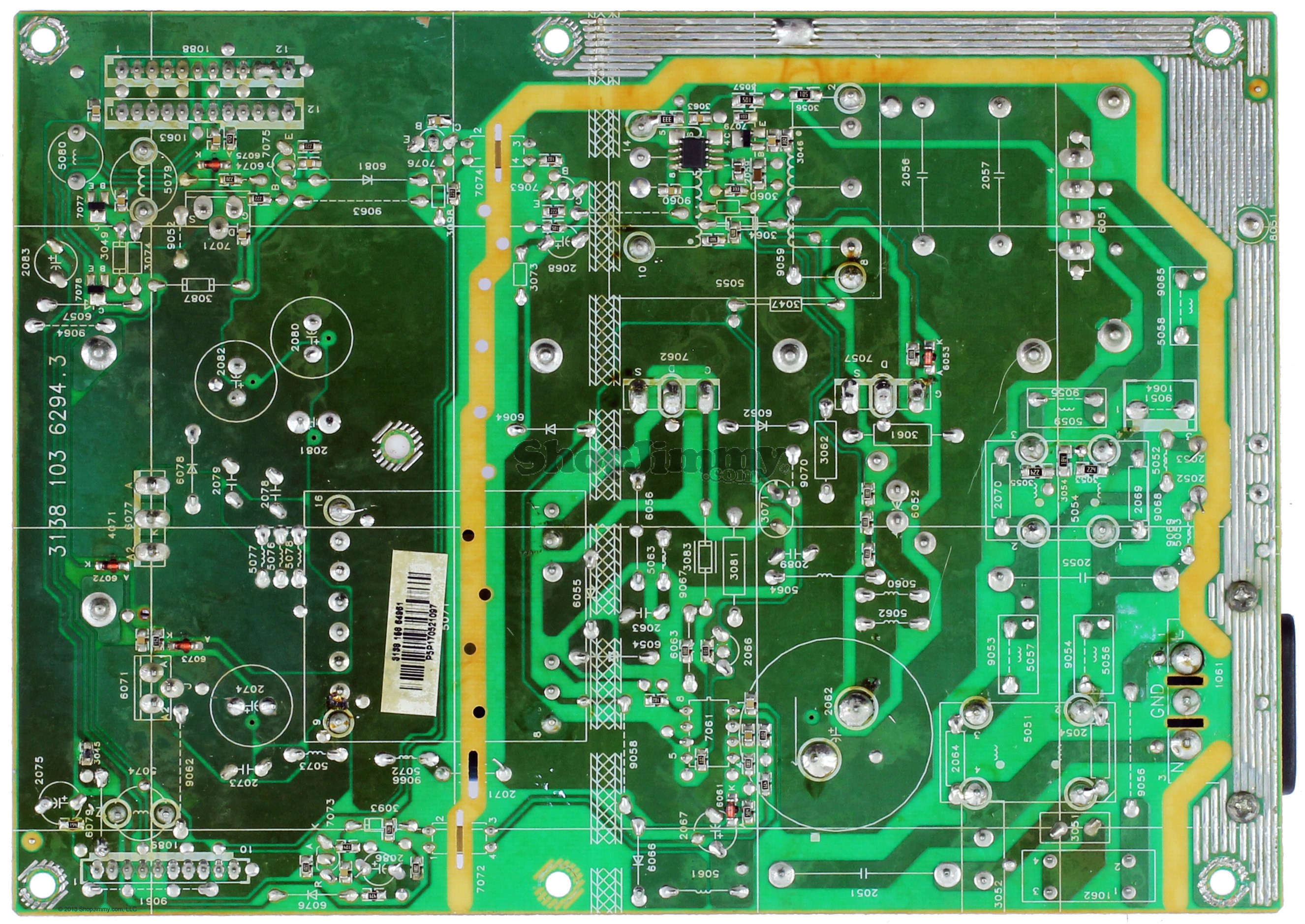

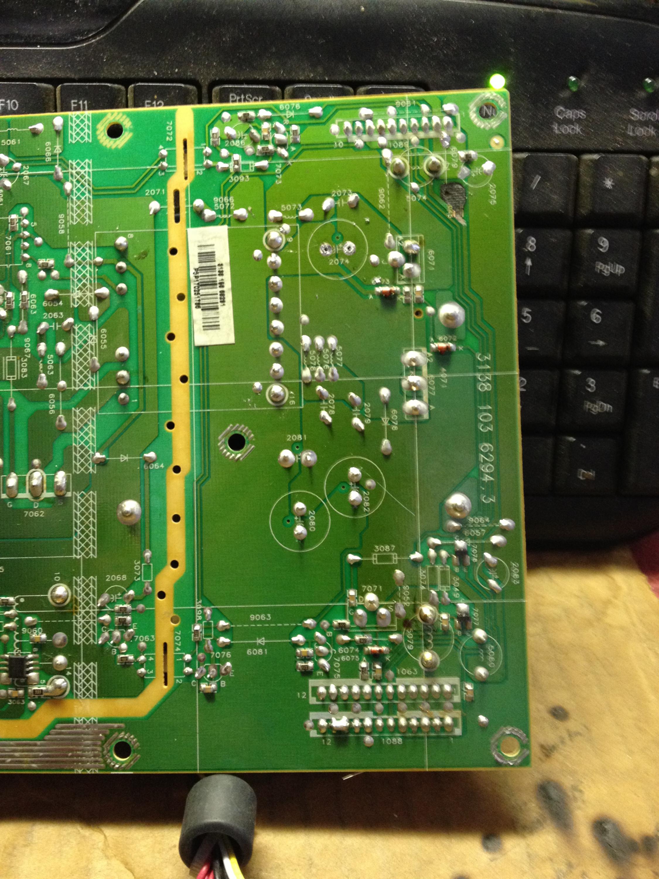

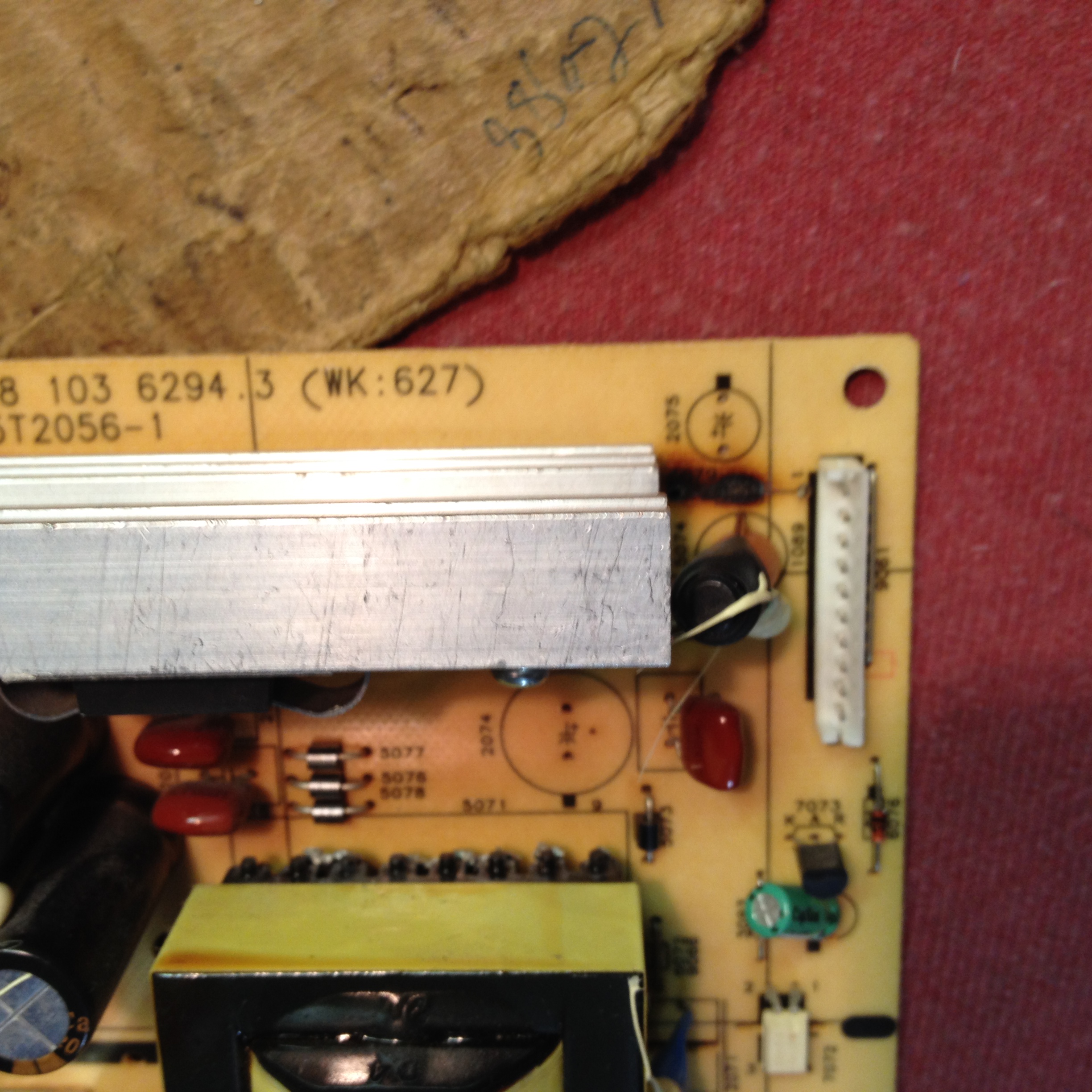

                I was able to find a pic of the back of this board which isn't burned. maybe that will help.

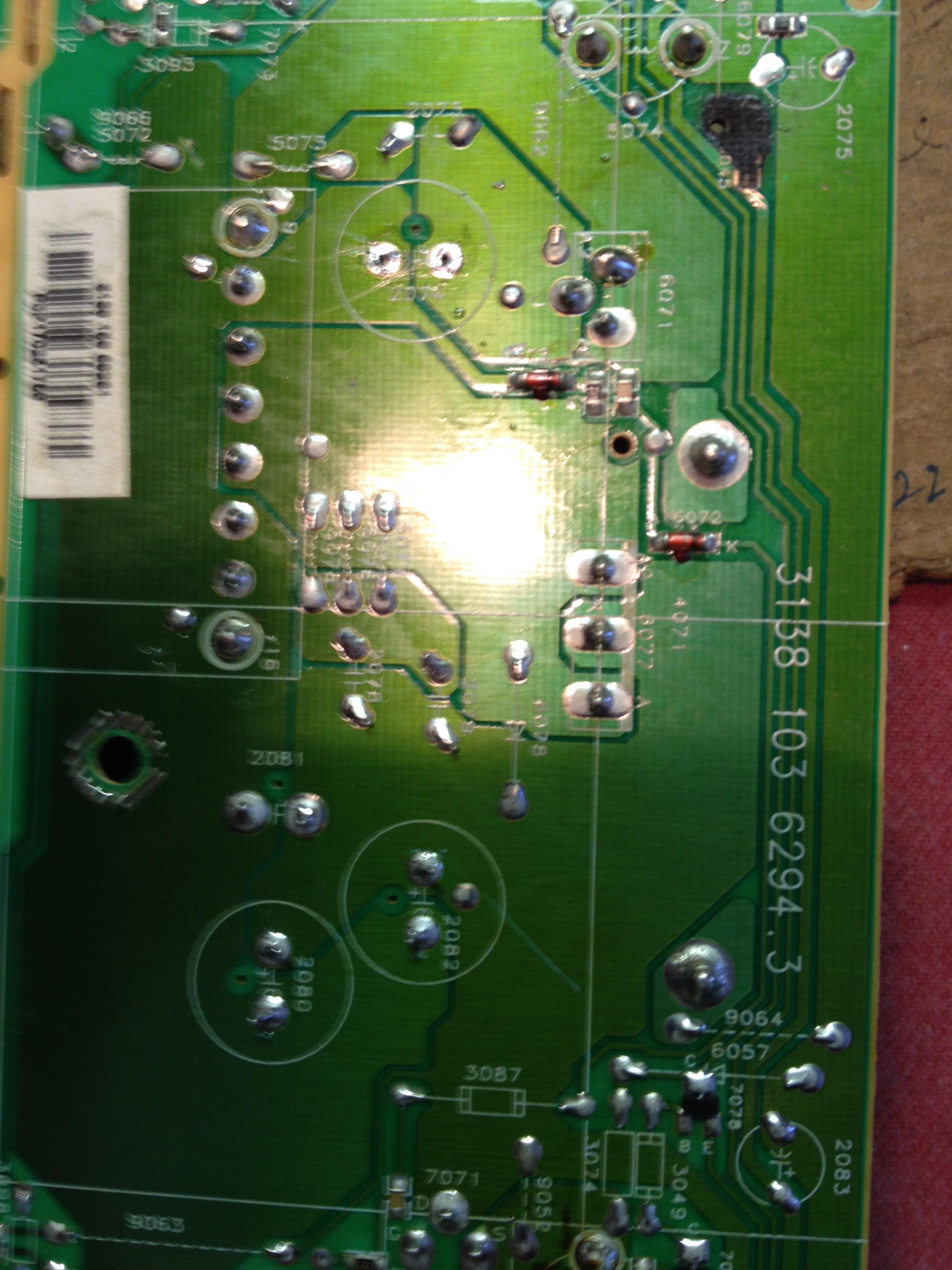

                  You have an entire diode (6079) which has burned off of this. Something shorted really bad. I can't tell if there was something at 3045 on the bottom.

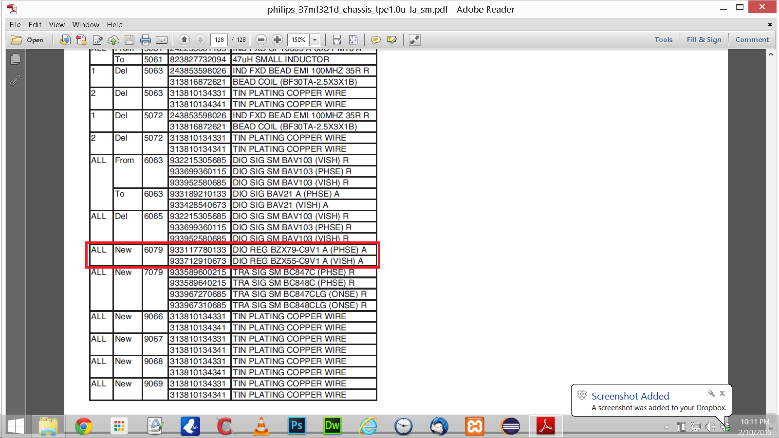

                    You're board is a revision so it's different from your schematic. I found the parts in the service manual. You can download the service manual here.

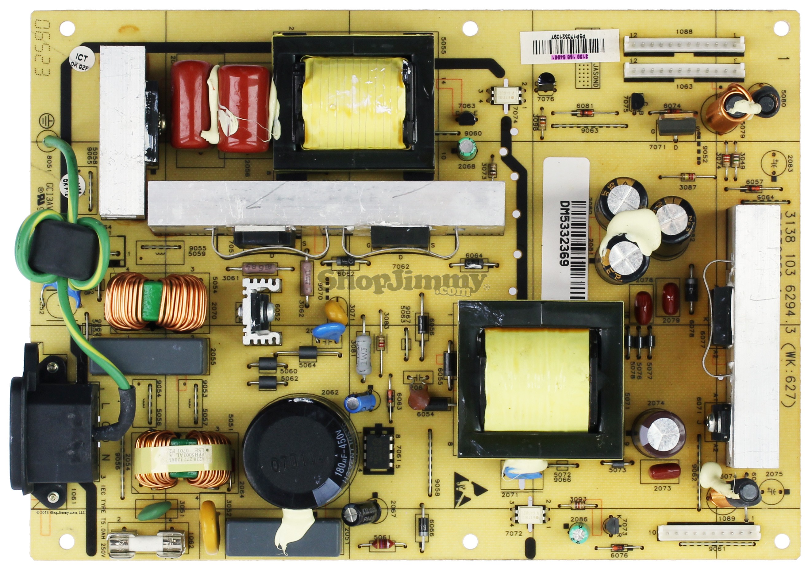

                      That is the same manual that I extracted the power supply circuit from, so we need an update diagram for the OP power supply.
                      The pictures are not clear enough for me read the printing on the tag of the power supply.
                      SJ has good pictures of the board:
                      http://www.shopjimmy.com/philips-313...er-supply.htm#
                      It looks to be the same as your, but need the verification of what is printed on the barcode sticker.
                      I can see that the voltage output pin 1 and 2 of connector 9061 connector is fed to the Anode of D6079, the Cathode of D6079 is connected to the resistor R3045 (more likely to be low Ohms resistor), the other end of R3045 is connected to pin 3 of connector 9061.
                      So you need to check the resistance between pin 3 of connector 9061 against PIN 6 (6~8 are tied together) which are GND pin.
                        I can make out the last 5 numbers, 68291. So it's this one. http://www.shopjimmy.com/philips-313...upply-unit.htm

                                I could be wrong, but the diode which is burned off the board looks to be connected to pin 1 or 2, which I think are both 16v output. 6, 7, 8, and 10 are ground. So maybe the 16v and 24v have both shorted to ground, or to each other?
