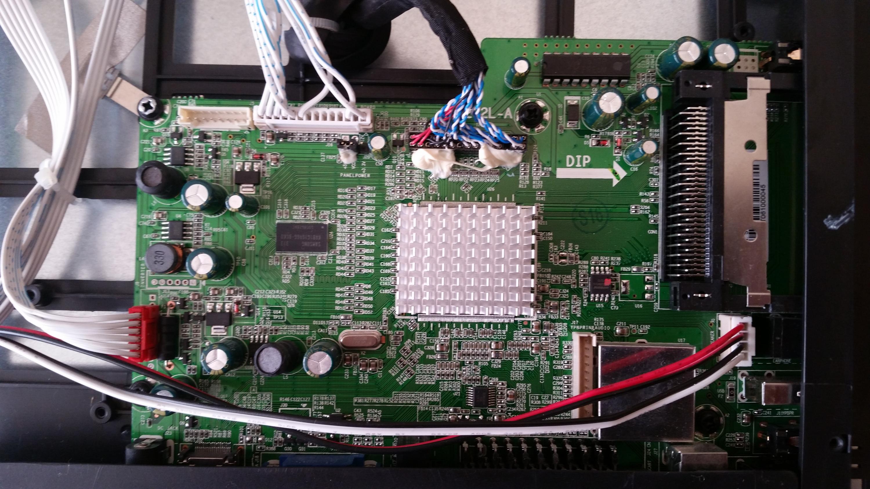

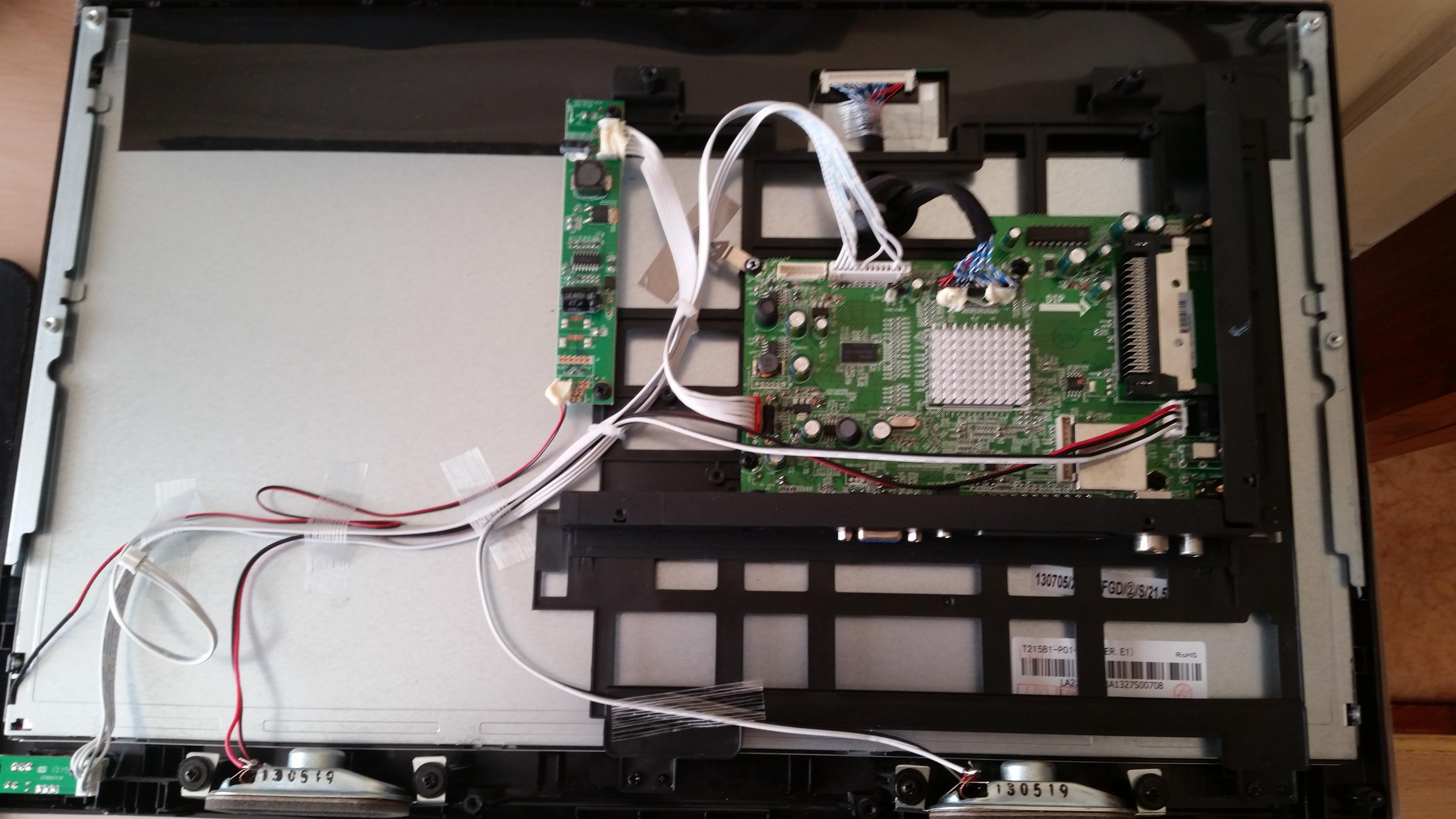

    hello
    tv works fine but when using inputs scart/hdmi it keeps showing a message asking you to ring a helpline
    i have been searhing online and there seems to be a update to fix this but cant find any firmware updates
    or possible EEprom fault
    has any guys come across this problem before ?
    thankyou
    Re: Polariod le-22gbr+dvd
    Replace the epprom on the main board, these boards the epprom always seems to corrupt because the software is barly functional. I bet that if you replace it the tv will be back to life.
      anyone know where i can get a eeprom though

              ok so out of interest how do i find the correct eeprom anyway ?
                First what is the full model number of the board ?
                  Cv9202l-a -11 121116
                    From what i think it reads Winbond 25Q32BVSIG eeprom found some on ebay but they need programming i think ?
                      Yes, will need programming.
                      It's a serial/SPI flash for the TV's software. EEPROMs are different and generally only store configuration. Most TVs will work with a blank EEPROM, as they will reset it with new data.
                        so correct me if it read your reply wrong i can order and fit a new eeprom and the tv will reset with new data ?
                          No....This is an SPI/serial flash. Stores software that the TV runs. So it won't work unfortunately.
                          If it *was* an EEPROM, that might work (on many sets it does)
                            Ok thanks tom so the only option is a replacement board ?
                              Yeah, pretty much - hardly worth it for a 22" set. Still, do try the reset first.
