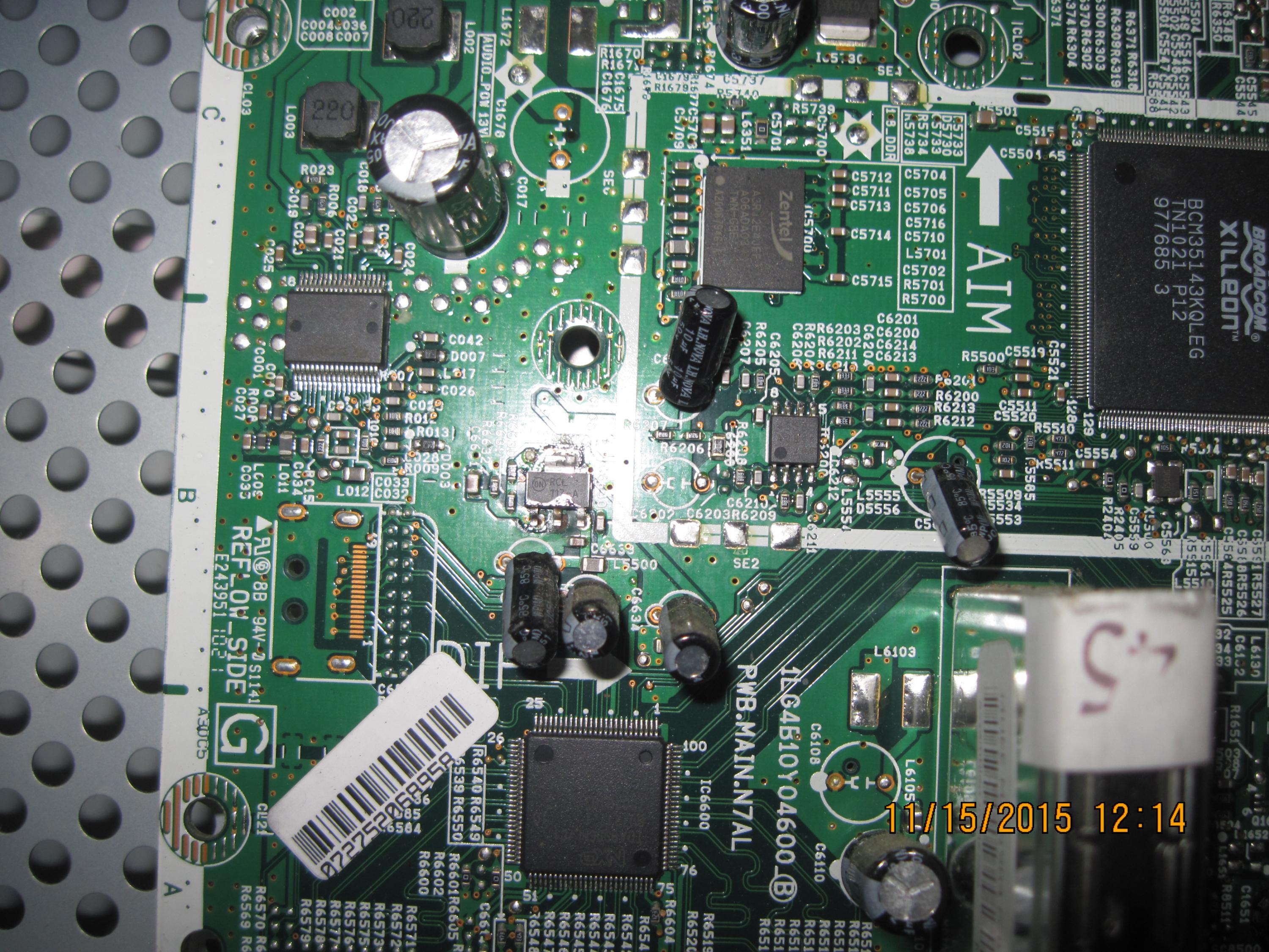

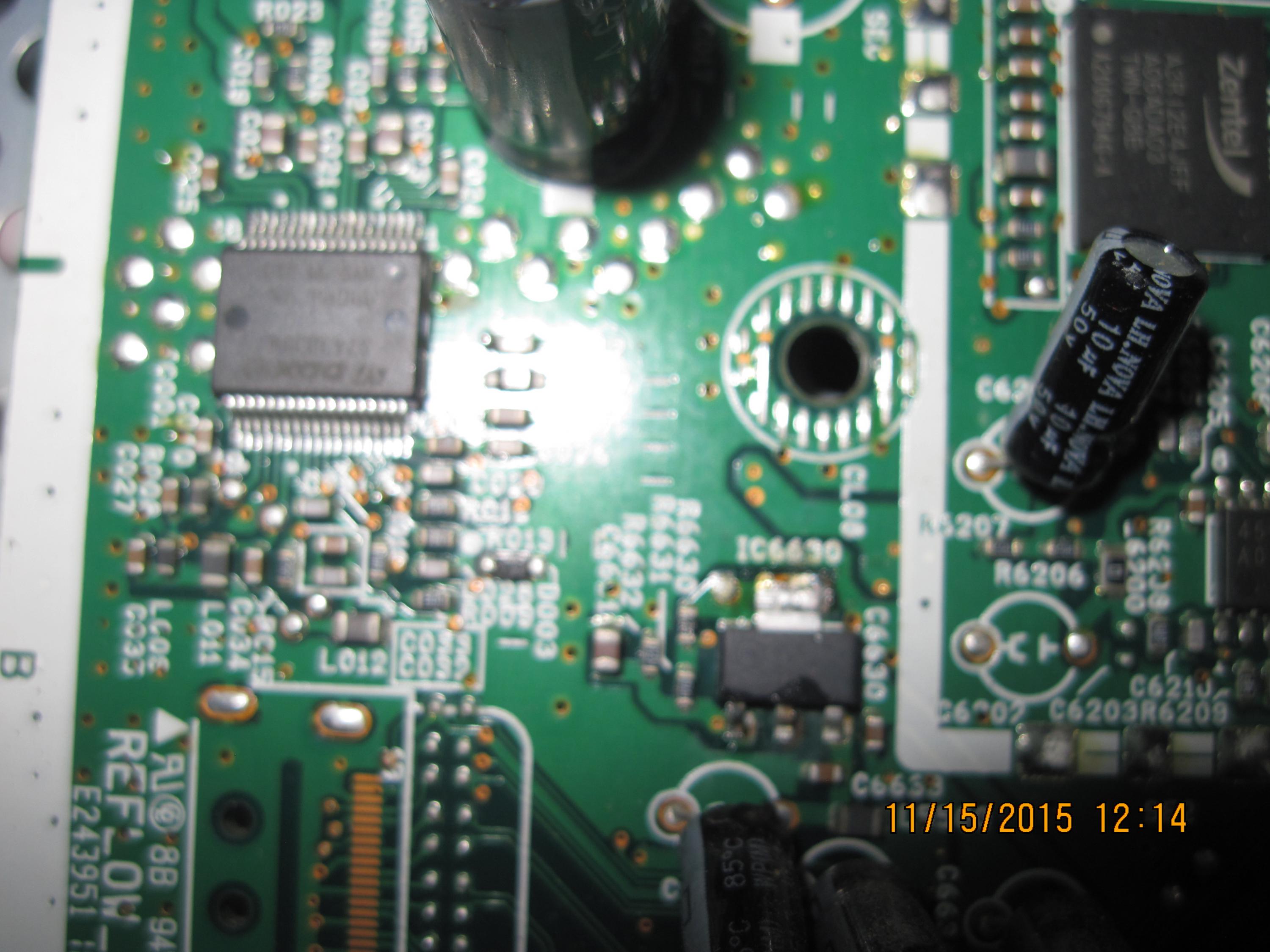

          Let's revisit this tv. Ok, I've out that the audio 13v is missing. Traced it back to the ic6630
          voltage reg. 3.3 on the right leg and 1.8 on the big tab on top and .5 on the left left.

              Does anyone have the service manual for Sanyo DP42740-02? I'm trying the schematic for the 13v audio.
