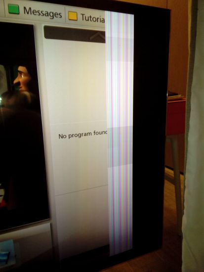

    I have a vertical bar in the plasma, about 7 inch wide.
    You can see it in the attached photo.
    Is it fixable?
    Thanks,
    Gil
    Re: Plasma Panasonic 65VT60 vertical bar problem
    Hmm, it does not look good. That could be a bad panel or a loose/damaged ribbon cable.
    Worth opening the set up and checking all the ribbon cables to the panel are seated well (do this with power off.)
    tw2005 may have some advice on "mirror" or test pattern functions.
      Thanks for the quick response.
      The plasma belongs to a friend and he suggested to sell it to me.
      As I don't have the option to open it, what are the chances of bad panel?
      Does this texture of the bar is familiar/typical with ribbon disconnected?
        The vertical bars on my bad panel Samsung plasma were black with sparklies in them. Those look more like a LCD panel failure.
        If you can get it for cheap it might be worth the risk. If it isn't fixable you can always sell the boards.
          I'd say bad panel 50-50 chance. A bit of a risk in other words.
          • Shinju
            • Mar 2014
            • 1239
            Do those lines project colors when the screen is black or no signal?
            To me it looks like a loose ribbon, but like tom66 said its a 50/50 gamble.

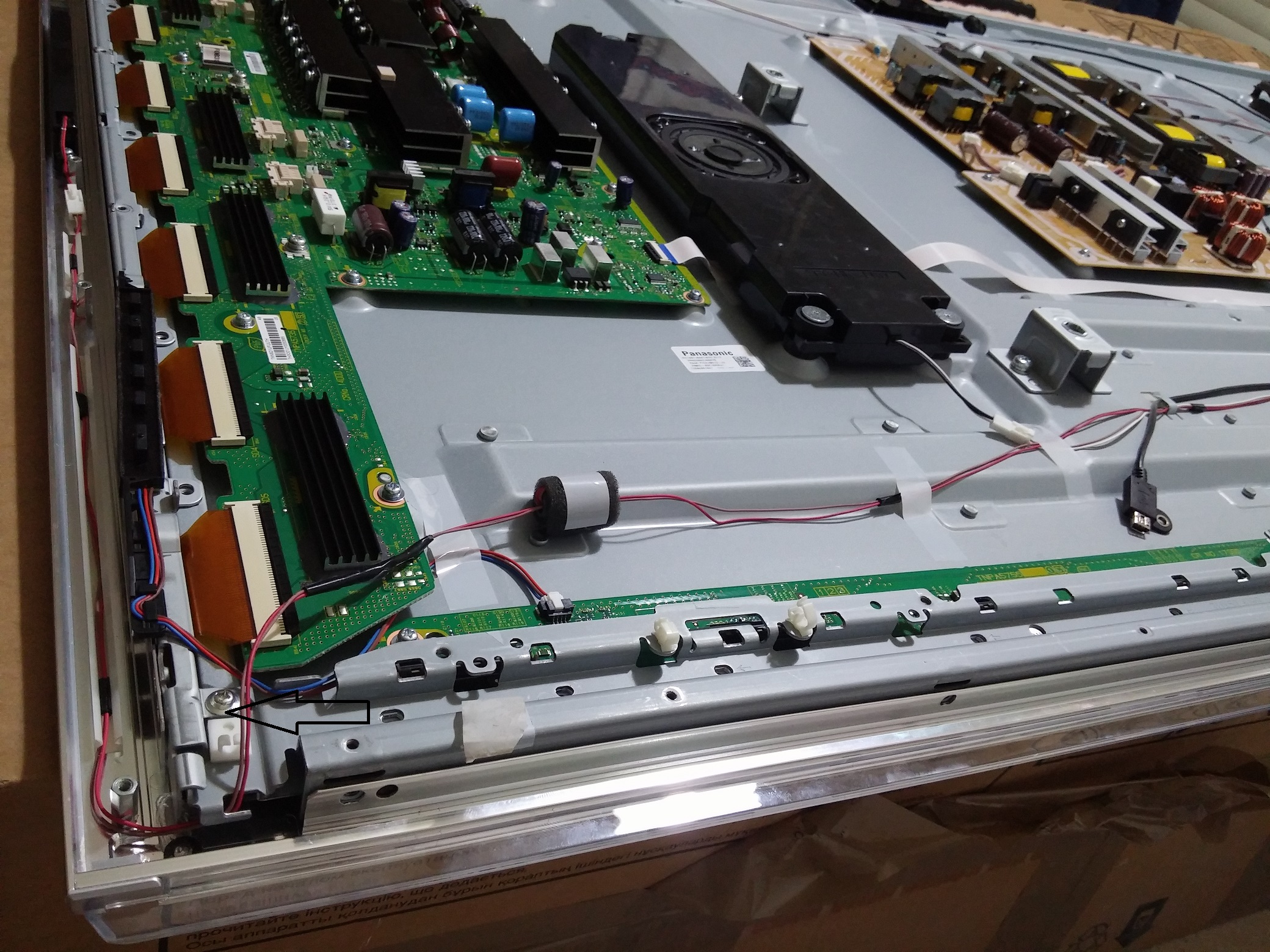

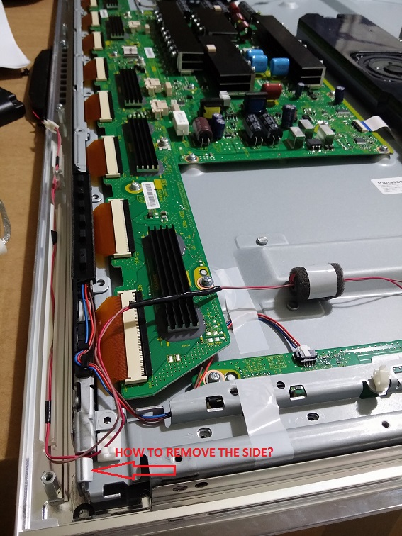

                      I bought today the TV.
                      There is a black bar on the right, after it there is this colored bar. the colored bar is sometimes from top to bottom and sometimes only from top to third way to the bottom.
                      I opened the cover and want to remove the bottom bar to see the ribbons of C1 board.
                      I can't open the side bar in order to remove the bottom bar (see image)
                      Any suggestions? I couldn't see how in the manual...
                      Thanks,
                      Gil

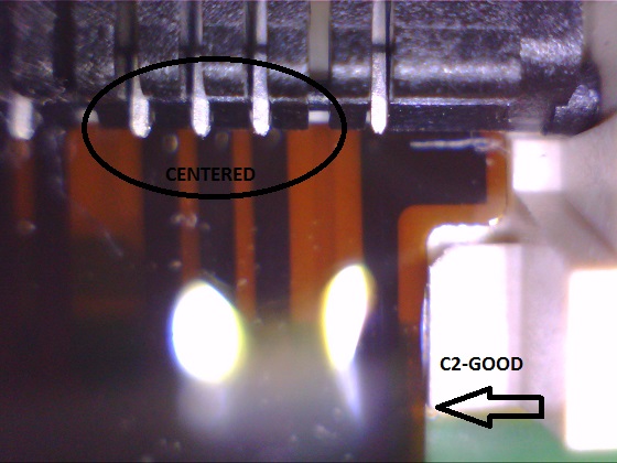

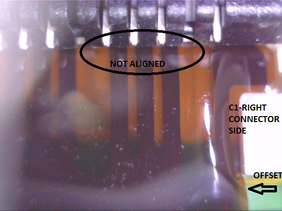

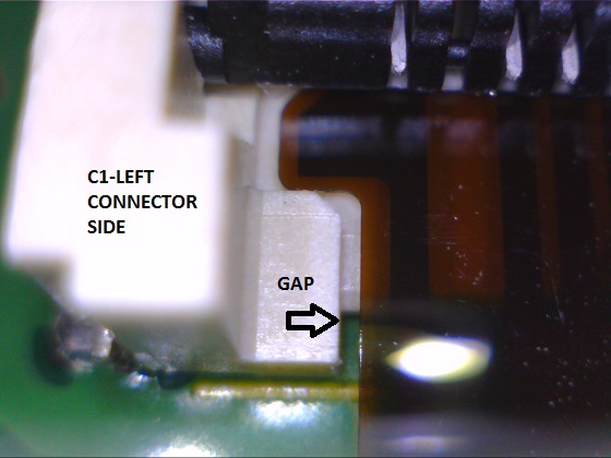

                        One more inspection, and I think I found the root cause but need your help:
                        I found that C1 ribbons are offset to the right, causing bad contact as you can see in the attached images.
                        C2 and C3 are aligned properly.
                        You can see enlarged image of the ribbons and the pins of the connector.

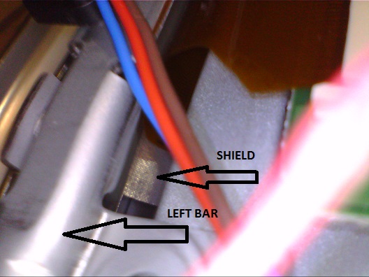

                        Now I really need help of my previous question of how to disconnect the left and bottom bars so I can reach all ribbons of C1 and align them properly.
                        I can see that the bars are attached to the panel with some shield (see image)
                          Are those the ribbons on the left of the set (looking from the back)? Those would not cause the fault you are seeing - if they were badly aligned you would get bars going across, left-to-right, not from top-to-bottom.
                          • vz56098
                            • Feb 2015
                            • 14
                            • Israel
                            No, these are the ribbons of C1 board (at the bottom)
                            The bar is in the side of C1 board
                                I can't open the bottom bar to align them, i cant reach it..
                                • Shinju
                                  • Mar 2014
                                  • 1239
                                  with the VT30, where the control is for the TV is next to the Ydrive buffers on the lower buffer. I had to disconnect the entire metal bar to be able to pull out the ydrive buffer ribbons.
                                  You might have to pull that off, as I see it looks very simular and then you might be able to access the lower bar that is blocking your C buffers.

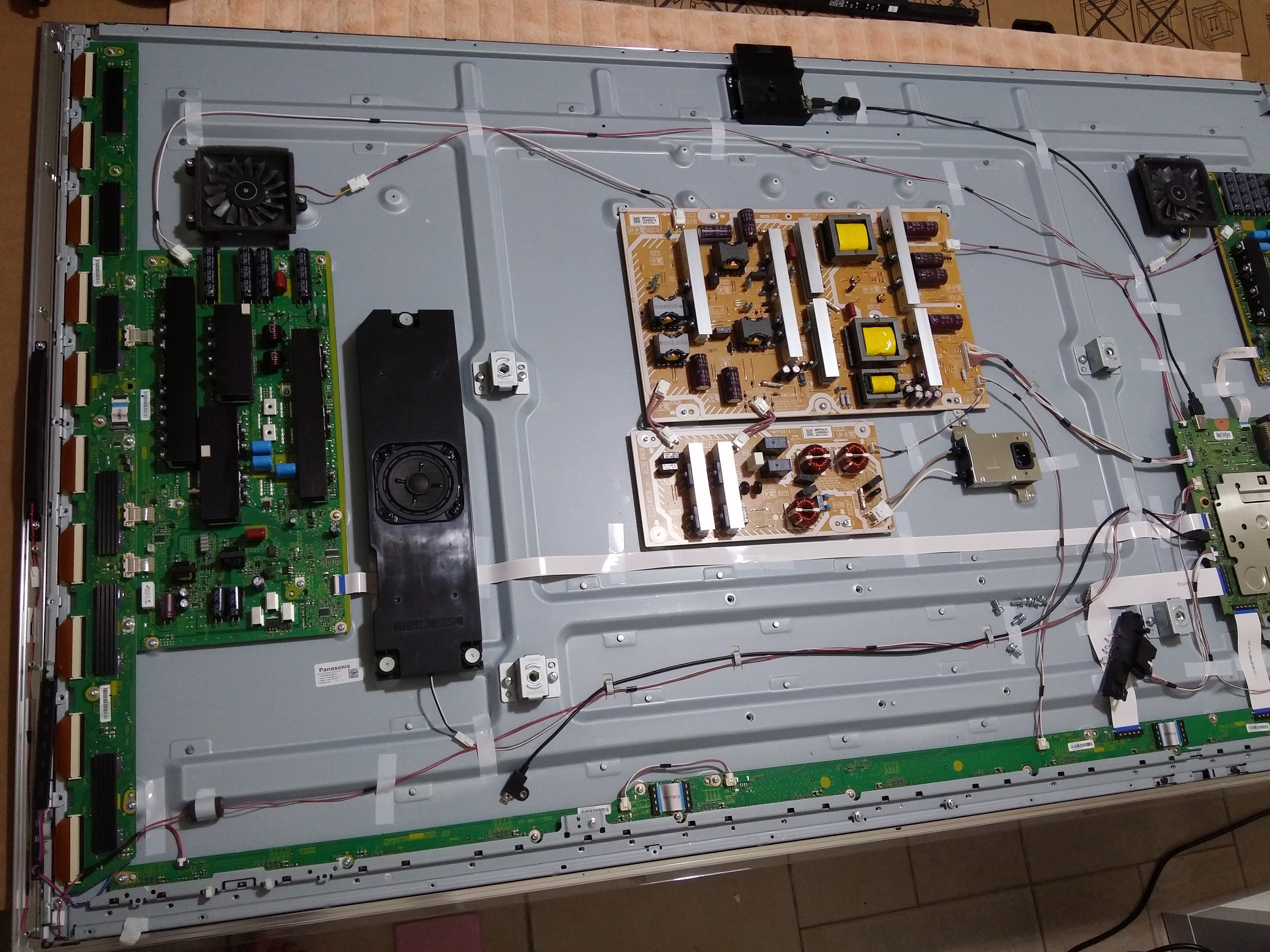

                                  Can you get a photo of the entire back side of the panel?
                                  • vz56098
                                    • Feb 2015
                                    • 14
                                    • Israel
                                    I uploaded the images. Note that the screw that is connected there in the corner was out (I just put it back now)
                                    • Shinju
                                      • Mar 2014
                                      • 1239
                                      Egads! I am not sure, it looks like its the entire frame.
                                      I would look for a Repair manual if you can find one with the exploded view of the TV.
                                      These slimmer panny plasma panels seem to be a pain to get into some of the components!
                                        It's quite likely the ribbons are bonded onto the board there. They are definitely bonded on the 2012 720p sets. It is a cost saving measure but it means a bad connection cannot be (easily) fixed.
                                        Wow, the heatsink is really wimpy... I was thinking of picking up one of these (50/55" version) with pink blob fault (easy fix), but I am now reconsidering...
