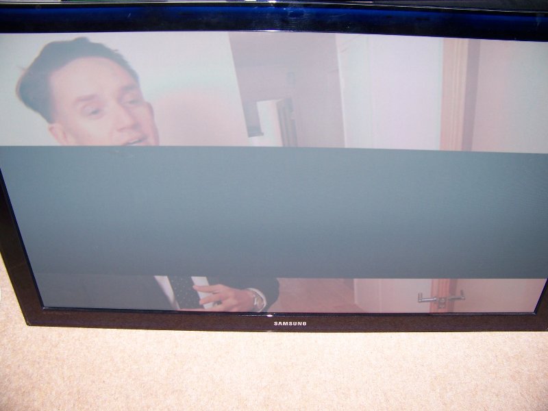

    Hi Guys
    I have a samsung 50" plasma with large areas (horizontal bands) of the screen permanently black. Tv works fine above and below them and menus also do not show up within the bands.
    The Y buffer has 6 tabs going to the panel and tabs 4 and 5 seem to be the culprit...matching the black band areas which are equal to 1/6th of the screen each.
    I have swapped the y buffer board but this has not cured it...exactly the same fault remains.
    I am suspecting its the panel as I cannot see how anything else could give this effect...anything else I can try before scrapping?
    Thanks for any help.

    Are the connections on the X-main side ok? The fault you describe is very unusual. Any cracks in the panel?

        could we have a picture of the fault? what you're describing kind of sounds like a panel issue these black bars at span horizontally consist of individual lines in a group it sounds and what you're saying is the menu coincides with in the area above or below the black bars but you can't see anything through them right? It kind of sounds like a panel issue and I have seen this a few times with Samsung's. somehow wear the ribbon cable meets into the panel where it is fused they become detached from the connection where it goes into the phosphors. Not repairable

          I can post a pic later but its simply an approx 8" solid uniform black band approx 4" off the bottom of the screen.

                Well, feast your eyes on the enclosed pic.
                The band is black not grey as may seem on the pic.

                  Looking at the pic, maybe my diagnosis about tabs 4 and 5 may not be 100% accurate....
                  Screen is 25" high in total. top section is 8", black band is 13" and bottom is 4".
                  So, it may be tabs 3,4 and 5 not working
                    I think you can rule out the buffer so either panel or ribbon/connection. Do you have any history on this set ?
