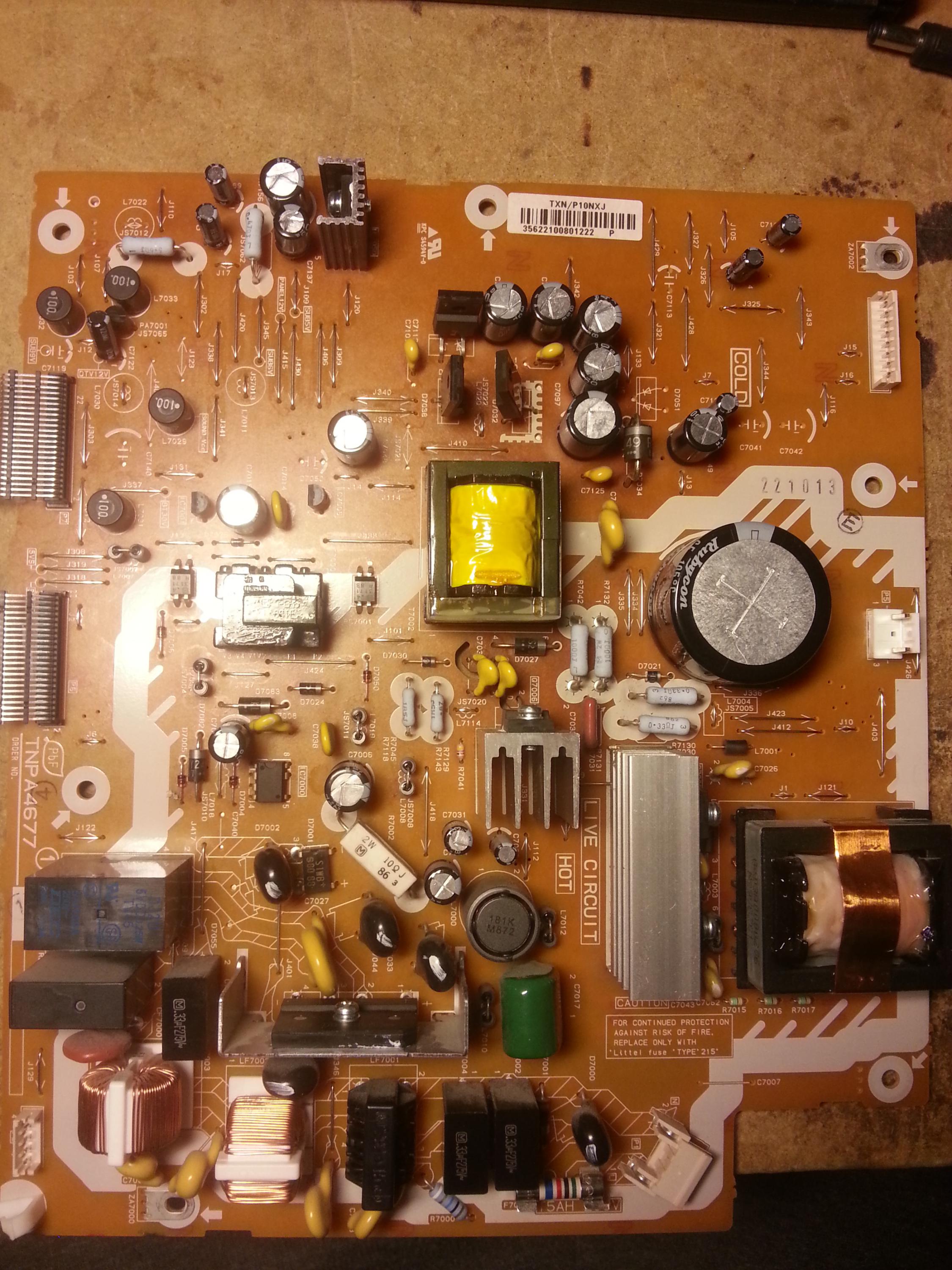

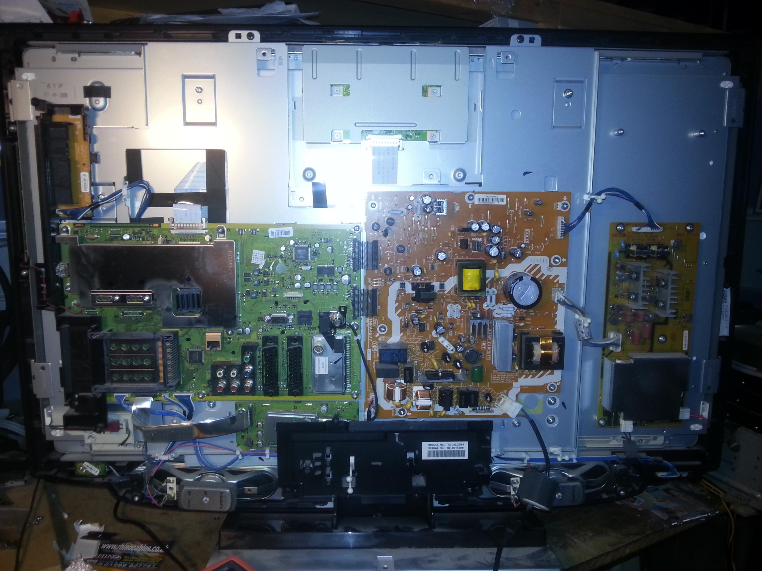

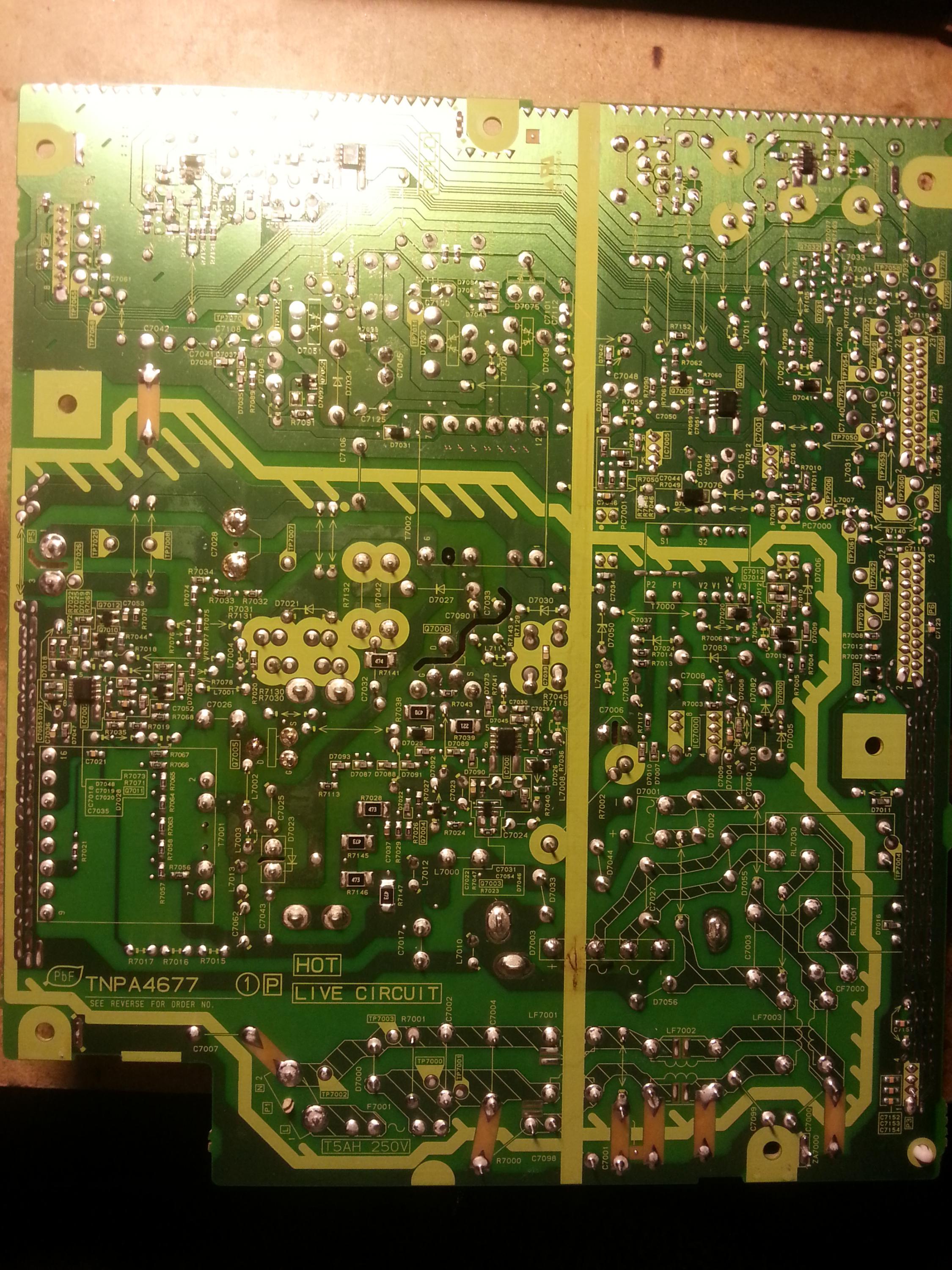

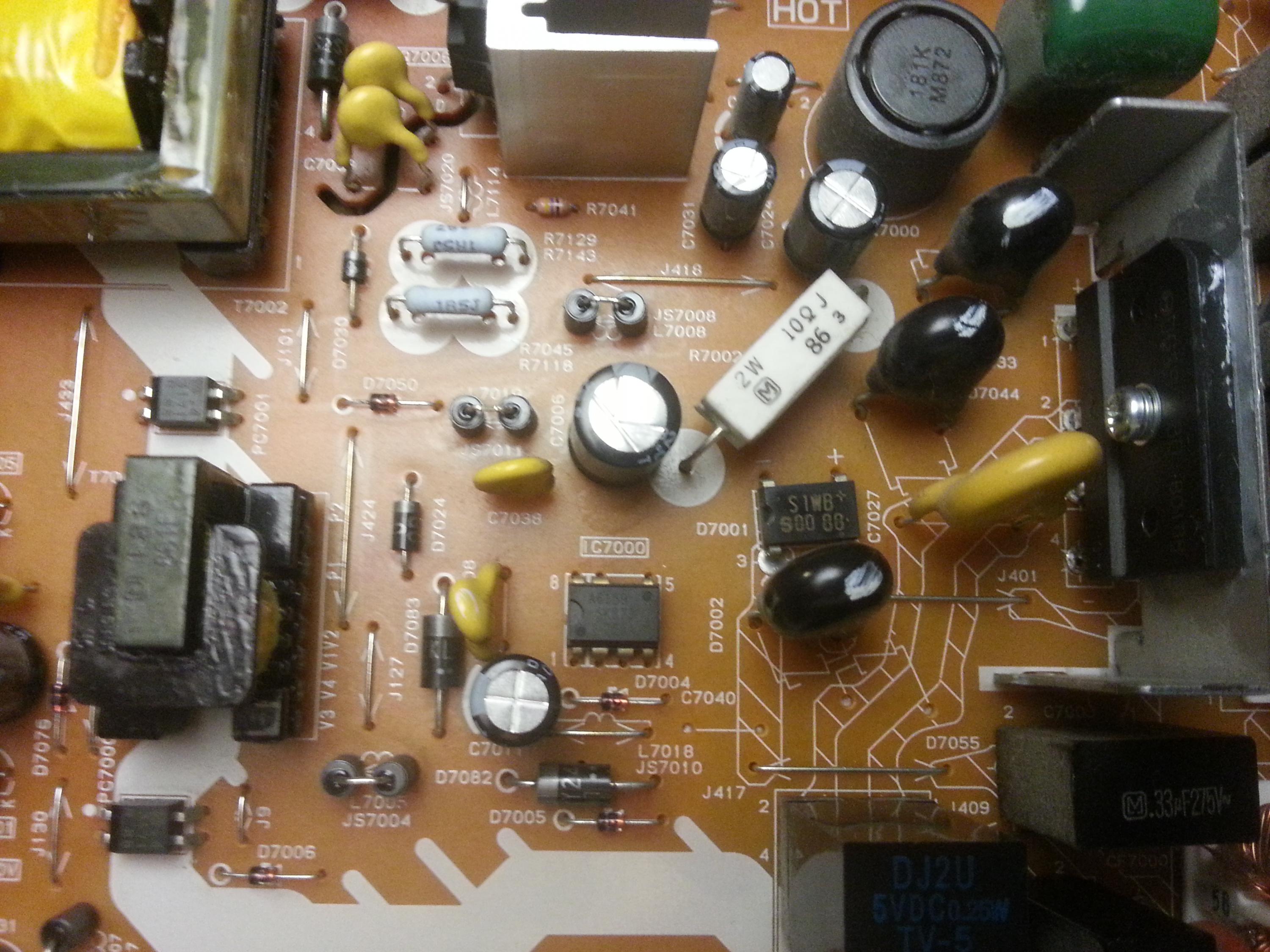

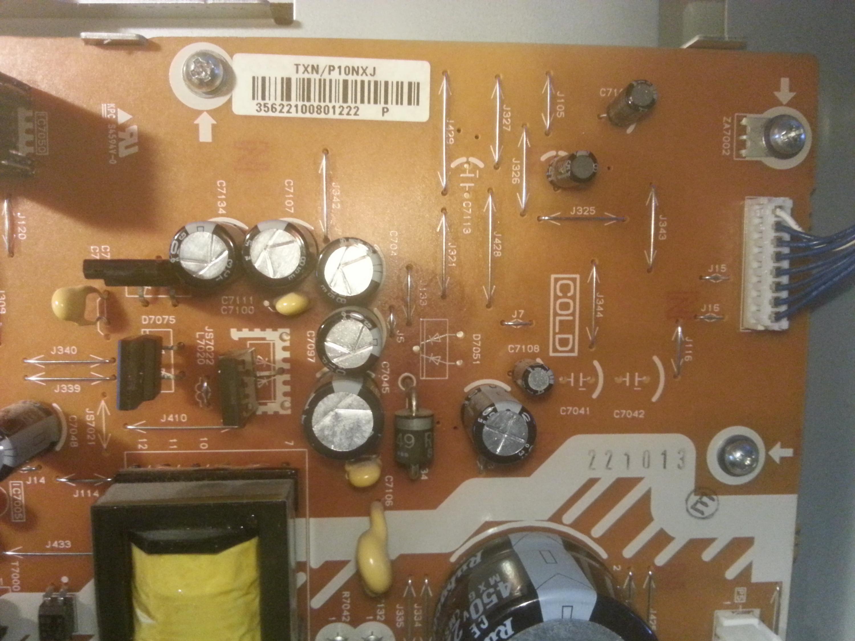

    Hello, I have a Panasonic L32C4B with no standby light.
    I have found 5v at J359 (bottom left, 5th pic) and have 16.45v at the VCC of IC7000 (pic 4)
    340v across the = and - of D7001 and 342v across the 450v 2.2uf cap c7006.
    There are no legends on either the power board or main board so i'm a little unsure of what to check further.
    Can anyone give some pointers please ?
    Thanks.

    Re: Panasonic TX-L32C4B no stanby light.
    This TV is a TX-32LZD81, i got the backs confused.
    The fault was located to the tcon fuse that had failed.
