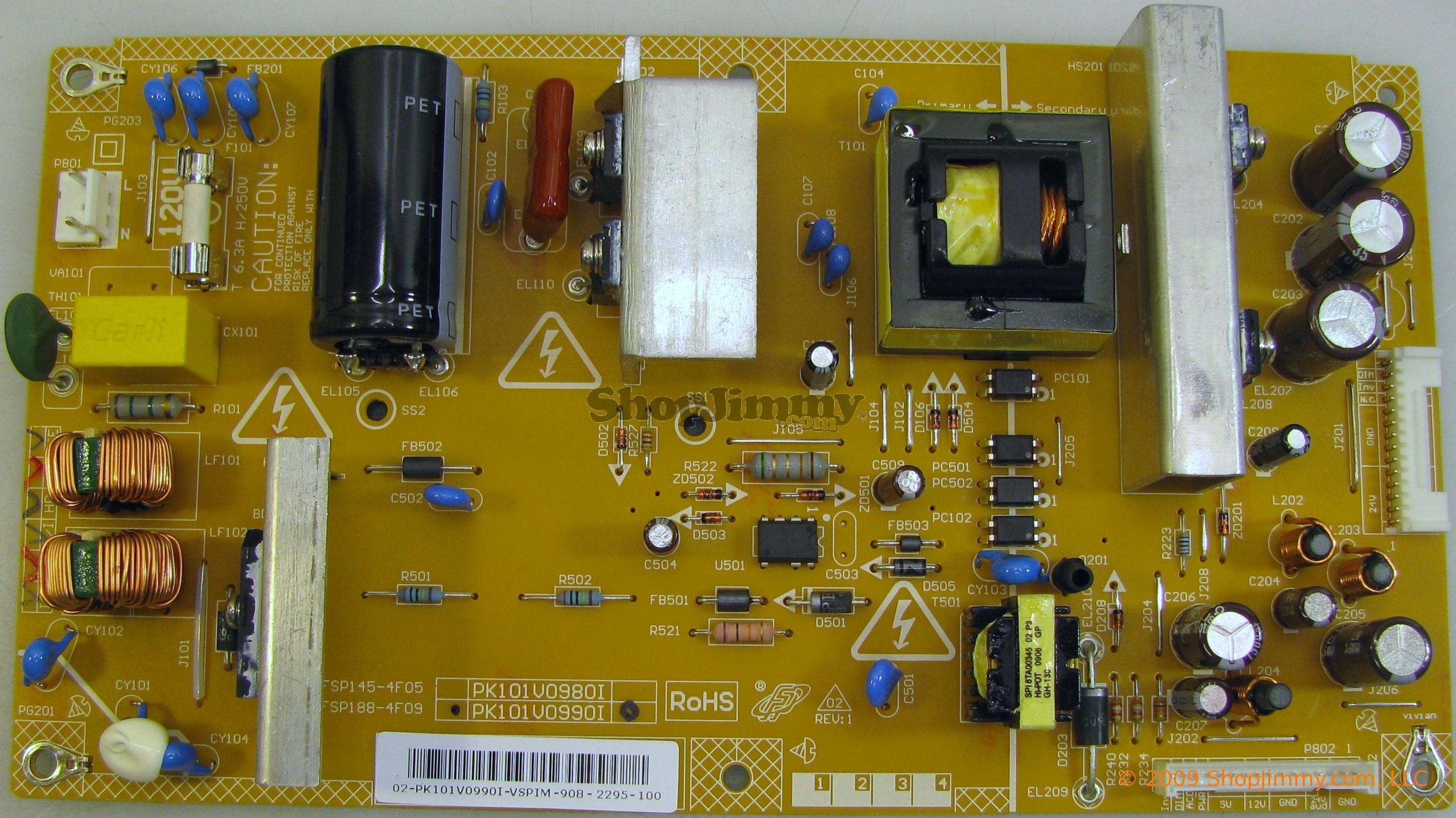

    I'm working on the power supply , and i want to know if i should have the voltages (24-12-5 V) even if it is plugged only to 120v (and not plugged to the other boards of the tv.
    I tried to resolder the diode d200 and when i plugged it back the ic m200 blew right off, i changed the diode and the ic but since then there is no voltages coming out ...

        The fuse is ok ,i would like to know what kind of voltage i should get out of the bridge (BD001),right now i get something like 2.4 v , if i follow the line i get to diode d203 that is open, the diode # is T2D89, i google it and can't find anything that fit .
        Any clues?

                  Re: Toshiba 37AV502R PSU
                  here foudl, allow me to post a pic. http://www.shopjimmy.com/toshiba-750...wer-supply.htm
                    Is that the exact match to your board, foudl?
                    I will need good clear pictures of the bottom side of the board also since SJ does not have one.

                      Oops ,my bad ,you're right, now the voltage out of the bridge is 168v, i can follow the voltage to the drain of Q300 (k3994 mosfet), but from there no voltage out

                          I need to see the WHOLE bottom side of YOUR board, the picture in the link does not show the whole bottom side, the pictures must be clear enough for me to trace out the connections on the bottom side of the board.

                              OK, so let me get this correctly, if you do not have cable connected to the P802 connector, there is NO voltage on any one of the pins?
                              • foudl
                                • Dec 2014
                                • 25
                                No voltage at all ,but as mention before the diode d 203 is wide open so i figure out that it is normal not to have any kind of voltage going out, i would like to know what voltage i should read on the primary side.
                                  The DCV on the main filter cap should be around 160VDC which you had verified.
                                  Right now you need to get the 5VSTBY power supply working first.
