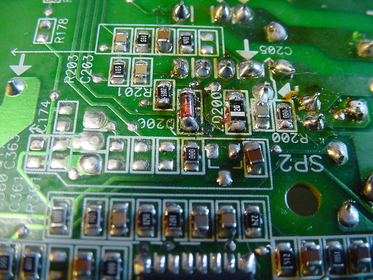

                              #54
                              Re: Toshiba 37AV502R PSU
                              OK, remove smd Diode D200 and see if the 5V will be stable, if it does you can use 1N914/ or 1n4148.
                              It uses the same standby circuit as used in the 32" version.
                              http://s807.photobucket.com/user/bud...?sort=3&page=1
                                #55
                                Nice. Removed D200 and it started right up. Guess I need to order a diode?
                                  #56
                                  I put in the SMD 1N914, you can use axial small signal diode, just bend the legs.
                                    #57
                                    scouring some computer psu's and motherboards looking for a good diode to use.
                                      #58
                                      Got the diode replaced. Thanks for all you help. I did not know my multi-meter could be setup to show the amp draw and that idea really helped identify the psu as the problem. Thanks again everyone.
