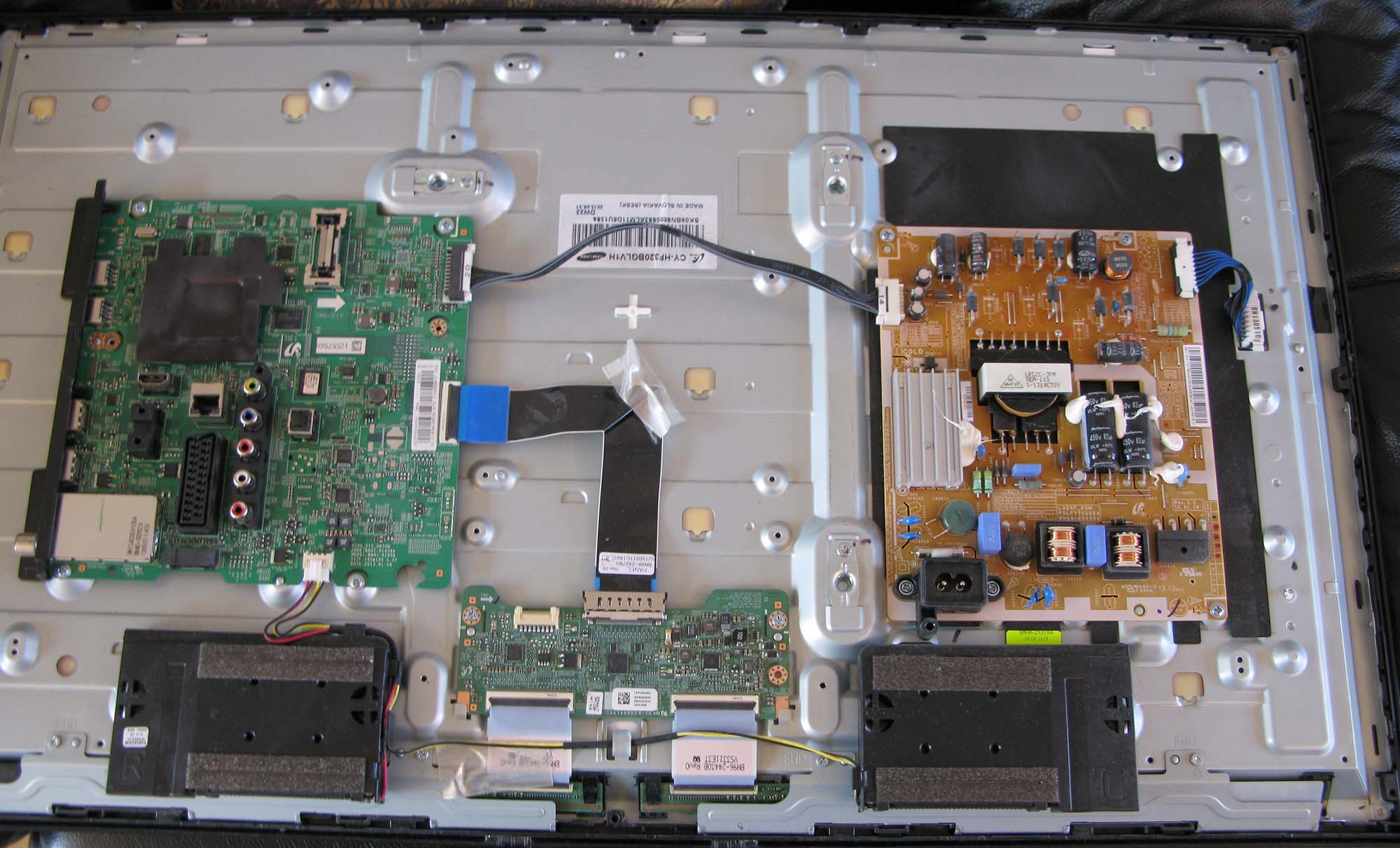

    Have a 32" LED TV UE32F5300AK that has sound but no picture or backlight.

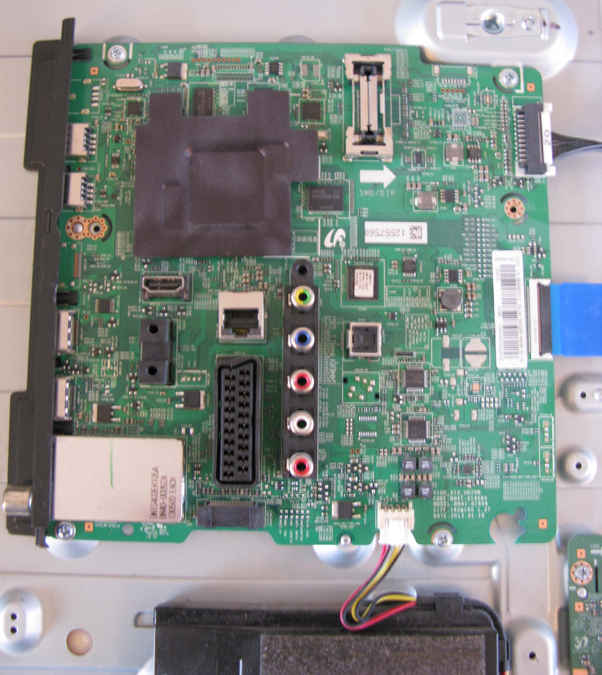

    Tried a factory reset using the remote with no joy. See below for measurements taken from the PSU to Main board connector
    PIN1 B13V – 12.85V
    PIN 2 PWM_DIM – 4.7V
    PIN 3 B13V – 12.85V
    PIN 4 ECO_ON/OFF – 0V
    PIN 5 Vamp – 12.85V
    PIN 6 BLU_ON/OFF – 4.7V
    PIN 7 Vamp – 12,85V
    PIN 8 GND – GND
    PIN 9 GND – GND
    PIN 10 GND – GND
    PIN 11 B5V – 0V
    PIN 12 A5V – 5.2V
    PIN 13 B5V – 5.2V
    PIN 14 PS ON/OFF – 3.3V
    Any ideas ?

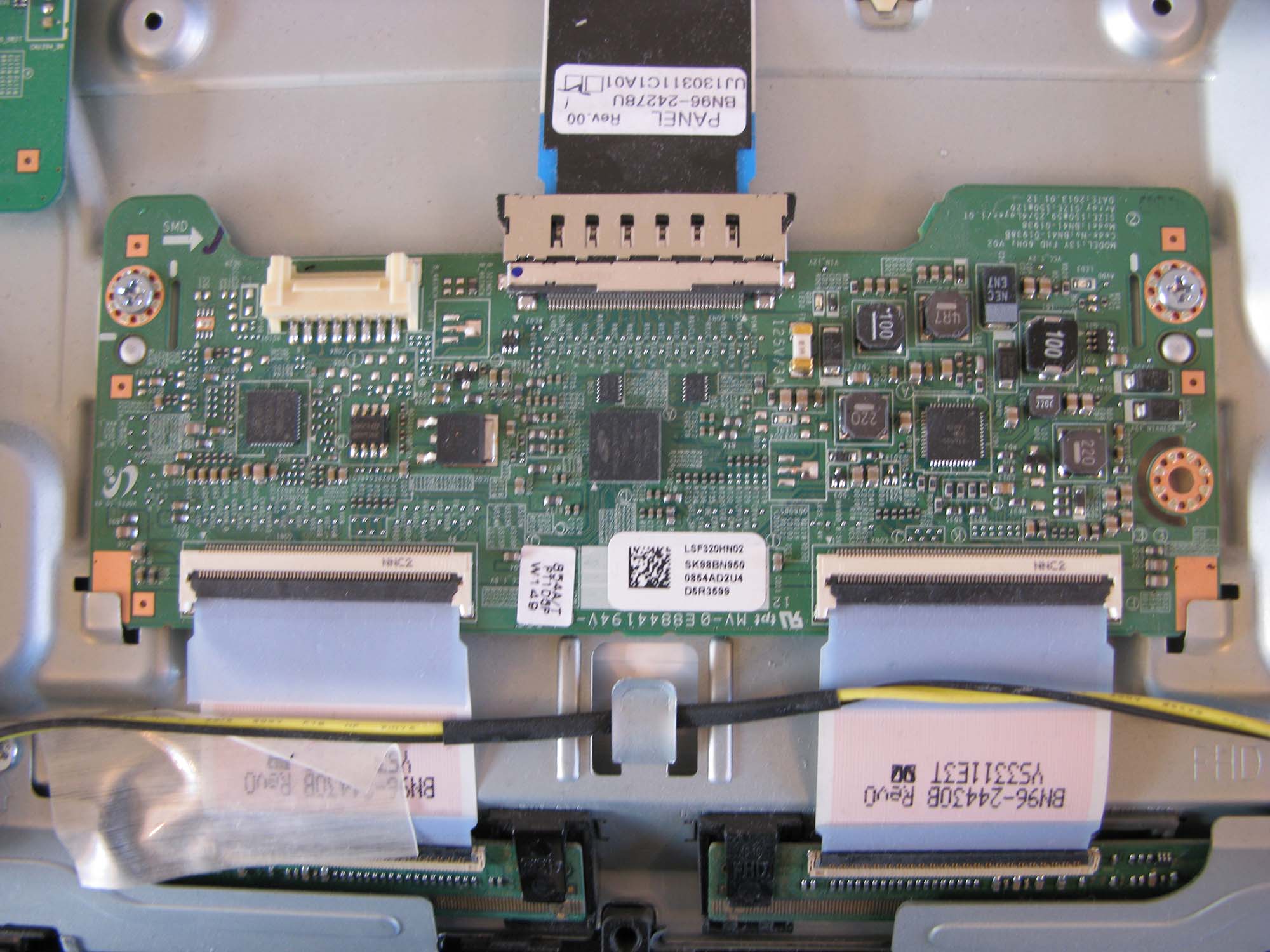

    see the tcon?, the last pic., looks like a fuse there, try checking that fuse with a multimeter. check anything labeled starts with F, F=fuse.

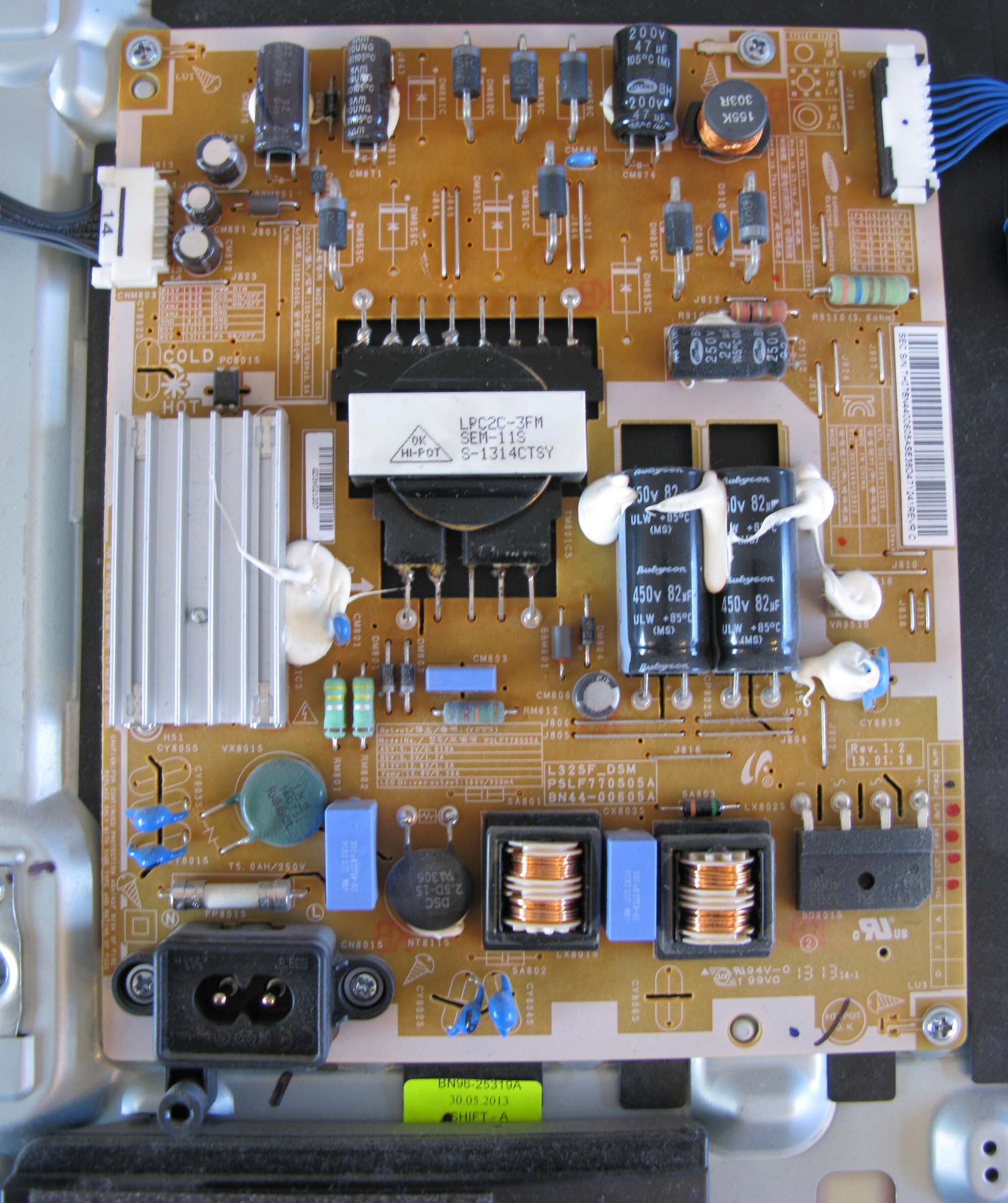

      BLU_ON_OFF and PWM_DIM, how do they behave when you turn on the TV ? From standby to ON I mean? They look like the control signals for the backlight.
      If they change I would assume the problem is on the PSU board. The voltage for the LEDs is probably coming from a separate winding of the main transformer, could then be boosted with the little coil on top...
      What,s underneath the board? If you can find an LED current controller chip that's a good start from there you can draw parts of the circuit, single layer board shouldn't be that hard.

        Thanks for the help. The fuses on the T-Con all seem fine. The BLU_ON_OFF and PWM_DIM do change when switched on from standby. I checked the connector from the PSU to the screen and I can only get a voltage on 1 pin and its varies from 190-220v. I also checked the 220v 45uf capacitor at the top right of the PSU (near the screen connector) and its only measuring 119v. Does this suggest a faulty PSU ?

          More likely is open circuit LED in screen. Another one like this! Very new set (2013 generation, F-series)
          Check all the LED returns (LED- or LEDK marked), should be only a few volts each, but none should be zero...
