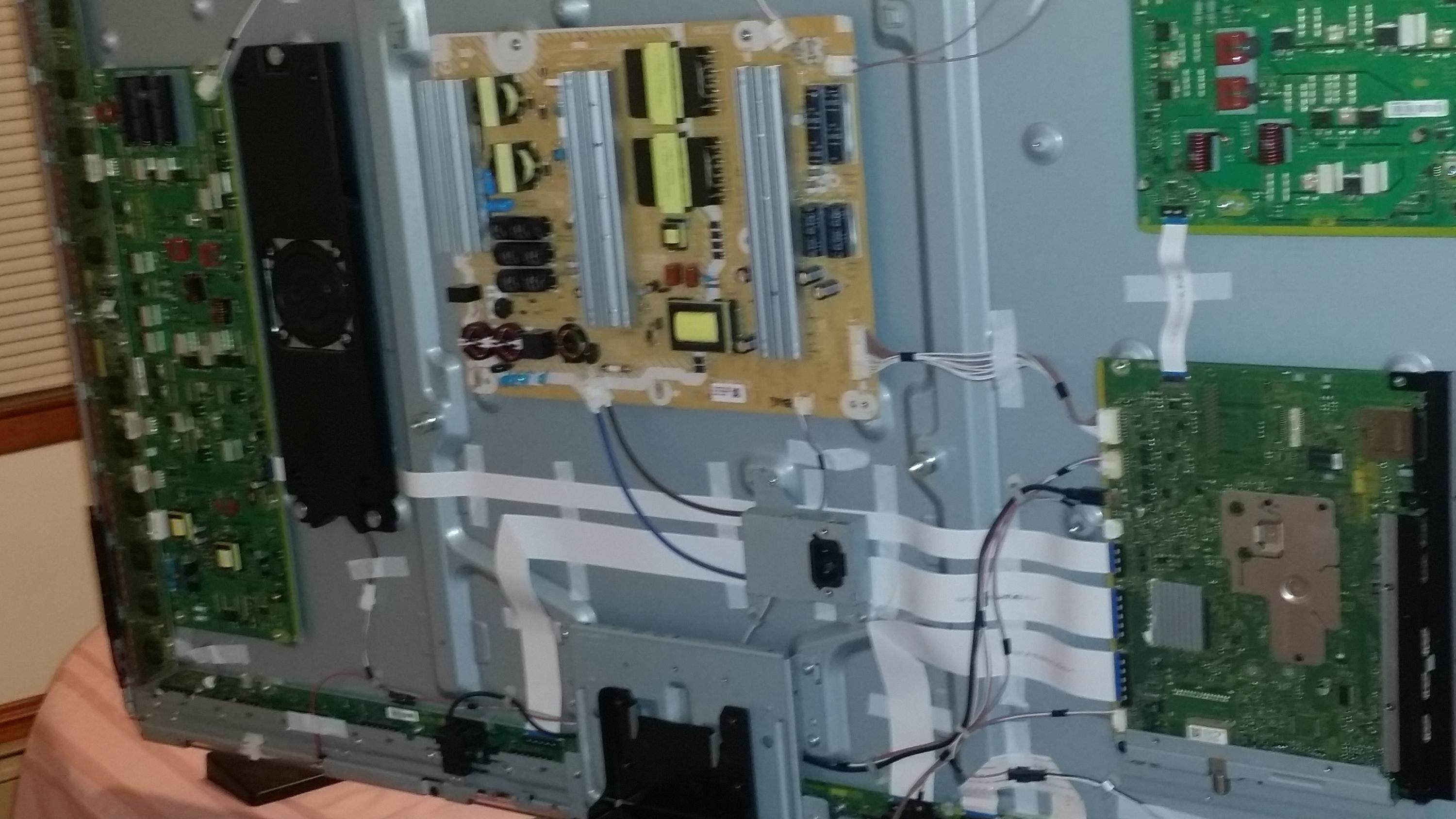

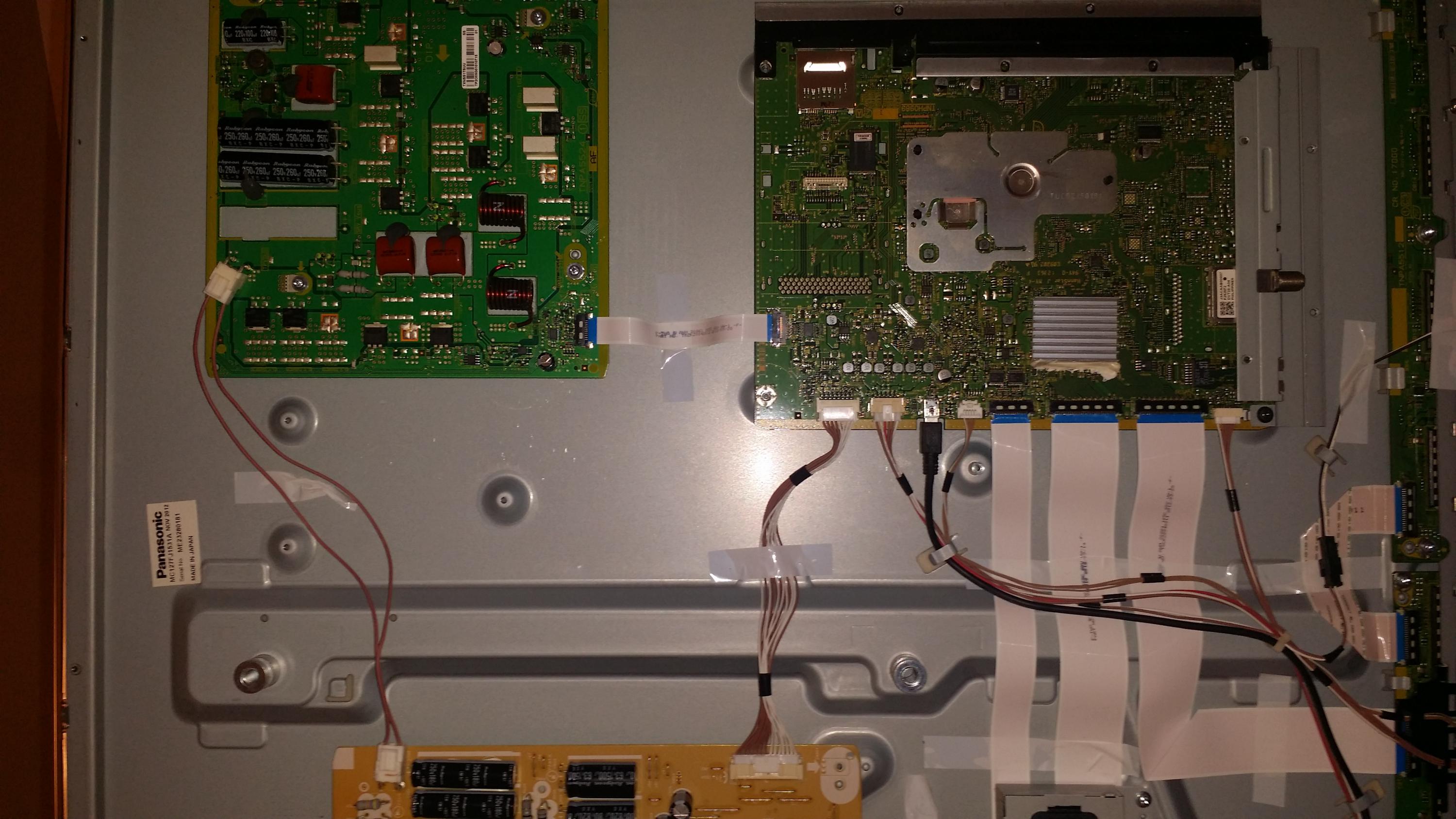

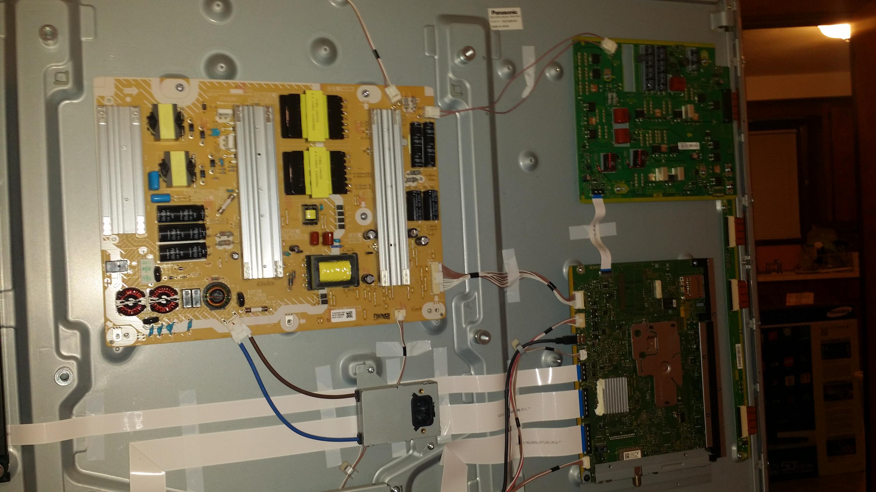

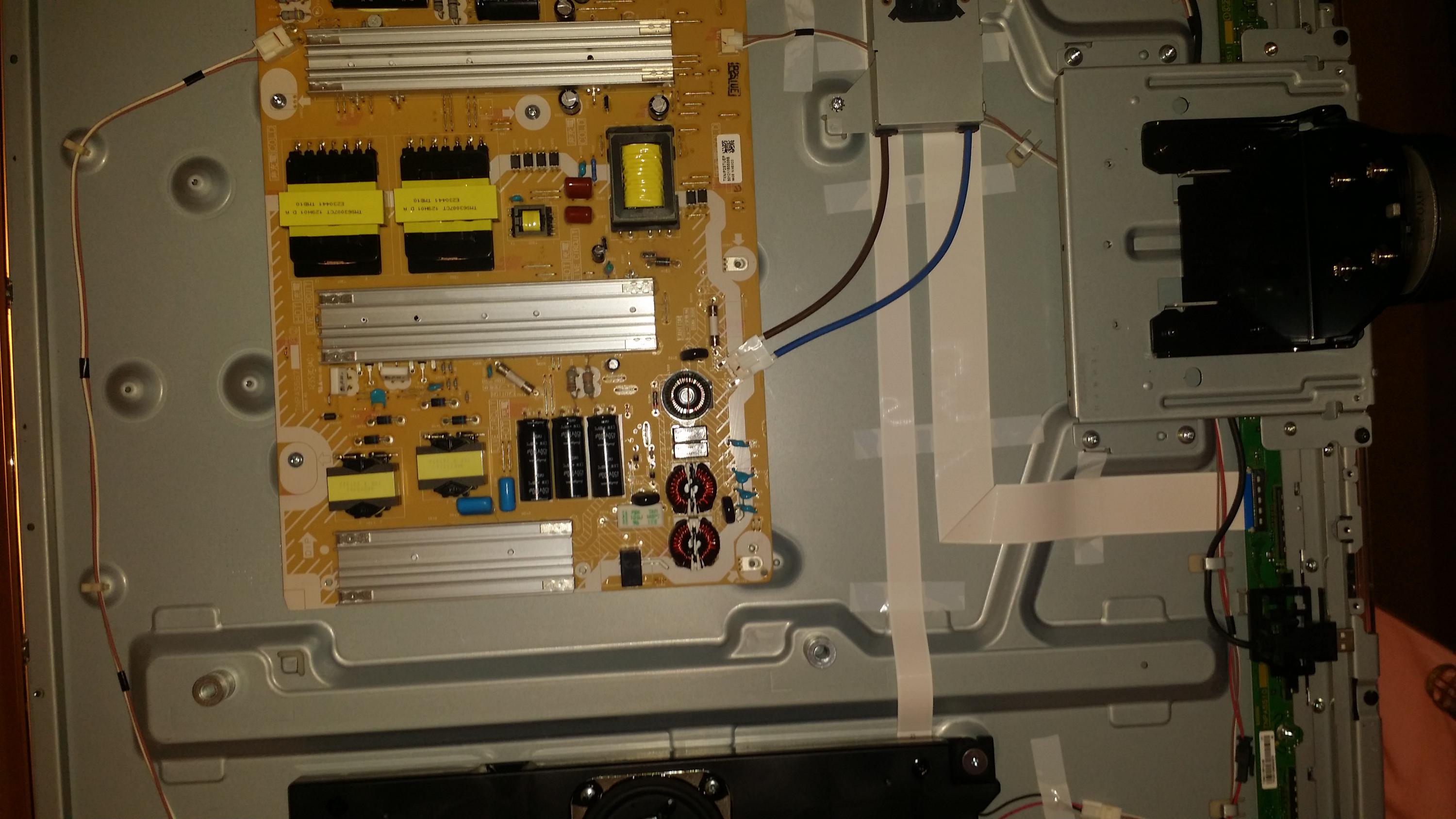

    So my plasma has the 6 blink code. No power only blinking light. I started by checking all connections. All good there. Nothing is marked for voltages on these boards. I have 215 volts going to the X and Y sus boards. I have nothing else to go from here. I also disconnected ribbons from the Y board to attempt getting 7 blinks but I still have 6. It seems like the A board is the issue. Just want to confirm
    Pictures to follow

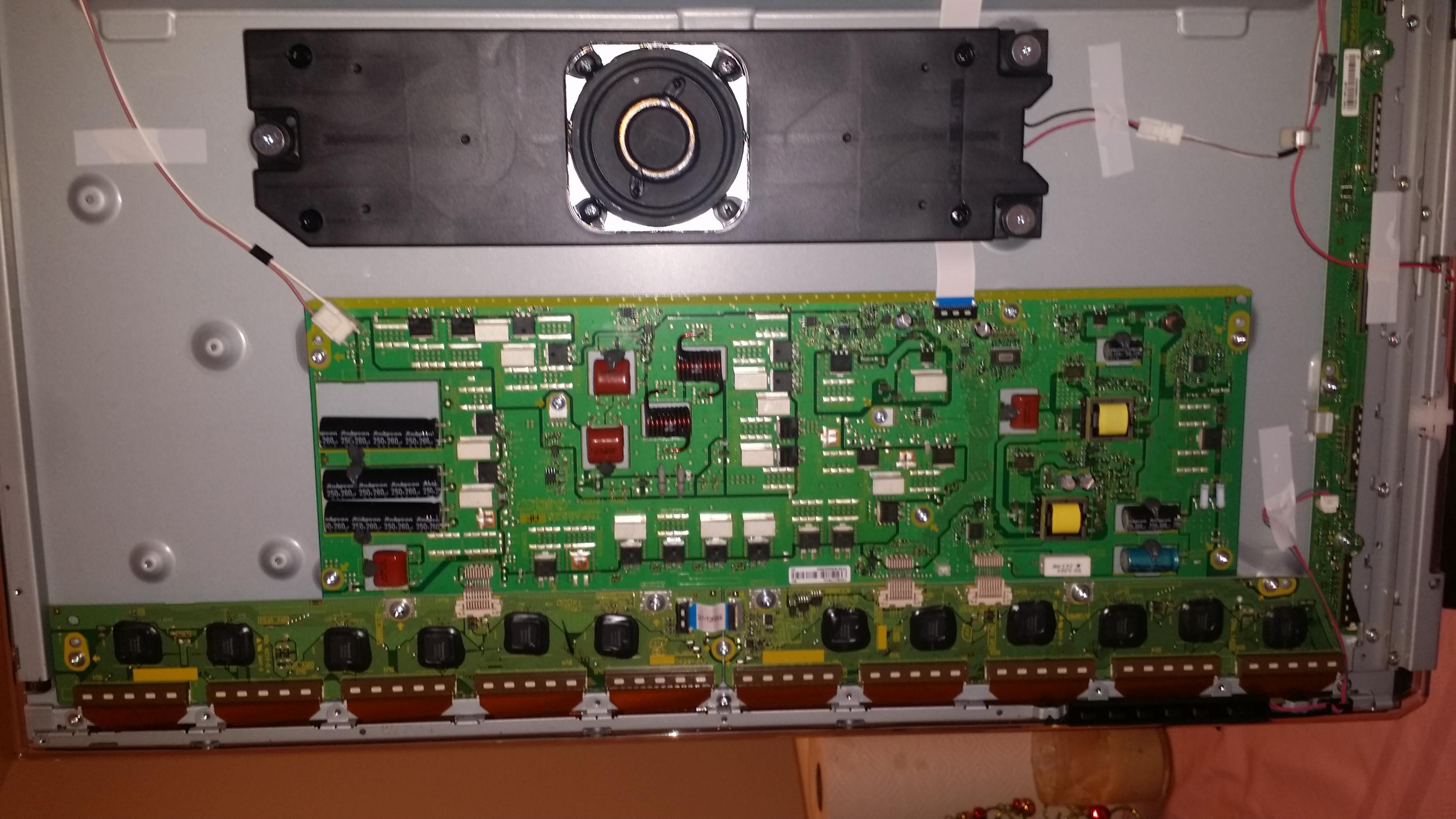

    Re: Panasonic 3d Plasma TC-p50st50 6 blinks no power
    Few pics

      when you say disconnected ribbons from the SC board, which one/s? they are labelled.
        Disconnected SC20 C36 and TV stays on with no backlight. Maybe bad Y sus and both buffers to go with it need to be changed. Thats my best guess.
          ok, so sounds like you've changed your mind. I'd have to find the training guide but 6 blink is Sc board, 7 can be SC or SD/SU.
          were the screws loose by any chance on tha SC board where t's mounteD/ burn or scorch marks on the bottom or mount points of the panel frame?

                s o I bought the Y board and the two buffers from a respectable company all three a brand new boards unfortunately it did not help out the TV I am really good with a multimeter just need some guidance on what could be next I still have 6 flashing LED
                  Assuming used boards, that Sc could be bad too. The training guide is straight forward with it's test for 6 blinks. It simply says , disconnect the SC20 ribbon and turn on. If it goes 8 blinks then it says SC board.
                  Stays 6 then A board but since you managed to get the TV on without a blink then A should be ok. I guess you've probed around the replacement board for any signs of shorted transistors?
                  Awkward situation, if they have a return policy try another set of boards
                    Can't remember but do these sets have LEDs on SC/SS boards?
                    Could also check for ER MID voltage across red poly caps near inductors. AFAIK the only cause of SOS6 on SC is low or high ER MID voltage (which can be a symptom of a few faults.)
                    Should be around 1/2 Vs (=108V), tolerance of 20V either way. Should also be similar to SS board.
