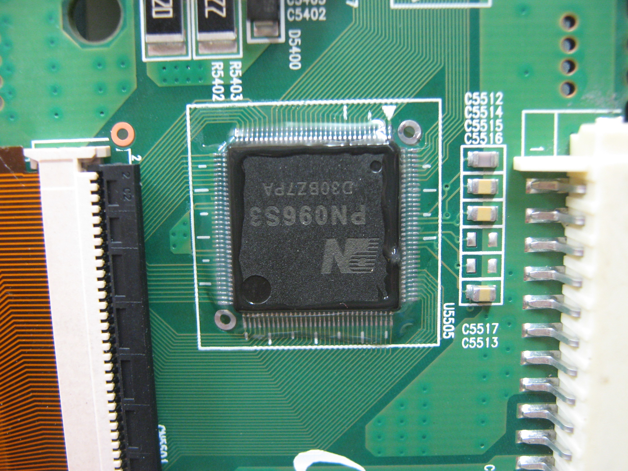

    Silicon around plasma buffer ICs.
    Just want to know what it is and where can it be found? thanks, Andy.

    Re: Silicon around plasma buffer ICs.
    Any ideas please? they would be very helpful, thanks.
      Are you talking about Silicon thermal interface or Silicon thermal compound?
      For example:
      http://www.bergquistcompany.com/thermal_materials/
      Digikey sells them.
        Insulator stuff. Never used it myself. But would imagine some kind of silicone RTV could work OK.
          Yes, sorry, tried to be as clear as I could, it is the insulator stuff that I need, that RTV silicon looks OK, I'll give it bash, thanks peeps.
            Do NOT use regular automotive-type RTV silicone! It can easily become slightly conductive and completely defeats the purpose of putting it there, plus some of them are corrosive. The sensor-safe ones shouldn't be corrosive but still are still a terrible choice for insulating any significant voltage.
            Electronics stores sell a whole range of special RTV silicone which is similar but has defined electrical insulating characteristics (quite good ones at that!). The antique TV guys use it to recoat flyback transformers, etc.
            It is available in caulking-tube sizes but is quite expensive and luckily smaller tubes of it are available in several sizes for a reasonable price for the amount used in typical litle projects. There are several series of electronic ones like RTV162, RTV103 and RTV133 high voltage available with different colors and various properties, any of which should be fine for buffer ICs, just don't use automotive RTV if you want a reliable repair.
            There is also good old' MG Chemicals "Corona Dope" which is a great insulator (used to be used by TV techs all the time on flybacks, etc.) and should work fine for insulating buffer ICs.
            Bob Andersen has an interesting video where he talks about the silicone he uses on flybacks. I'll see if I can figure out which one it is and post a link here.
            I buy mine at a local electronics supplier but you can search somwhere like Digikey for "RTV" and you'll find some of them.
              You need electronics grade RTV, regular RTV is corrosive as mention above.
                I used this product, http://www.permatex.com/products-2/p...-sealer-detail
                It bugs me when the plastic cap cracks up a short time after the tube is first opened. I have been bitching to Permatex about this on their Facebook page.
                      Originally posted by rievax_60
                      I used this product, <link to Permatex Windshield & Glass Sealer>
                      Even though it worked for rievax_60, and I hope it holds up for him in the long term, I wouldn't use that for this purpose since it has not been formulated with any attention to corrosiveness or electrical insulation. Even though they are designed for "sealing", many of the silicone formulations stay slightly porous and can actually wick up moisture. Not something you want with a few hundred volts and very close spacing.
                          Ahh, interesting, I'd never bothered to actually pull a datasheet.
                          Bob states the dielectric specification incorrectly in his video. He says it is 20kv per mil (which I always thought sounded optimistic), it is 20kv/mm or 500v/mil. Still impressive but that makes far more sense!
