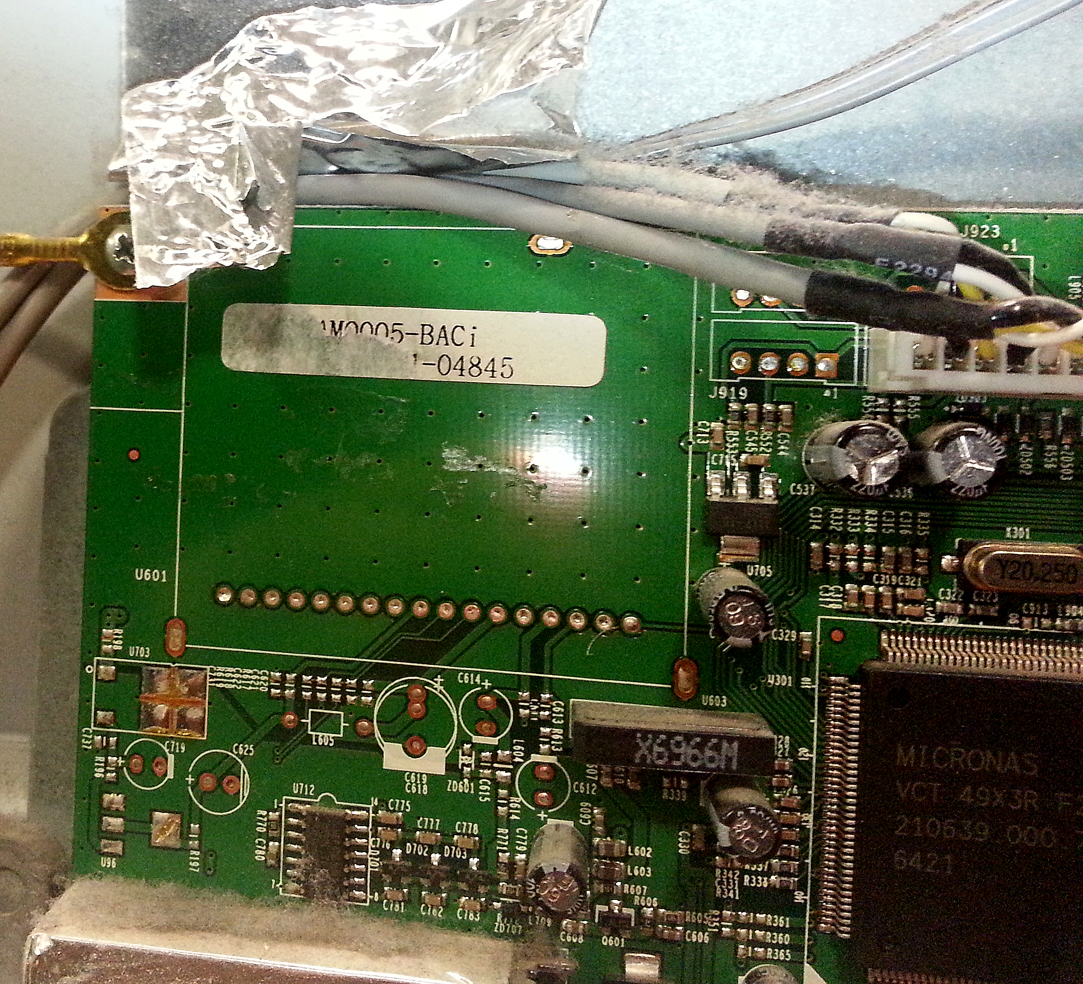

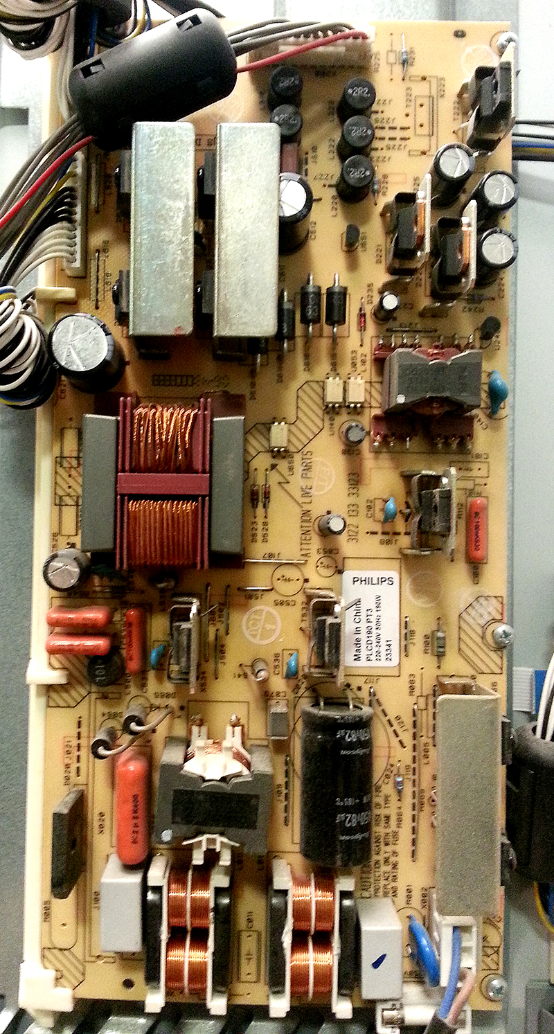

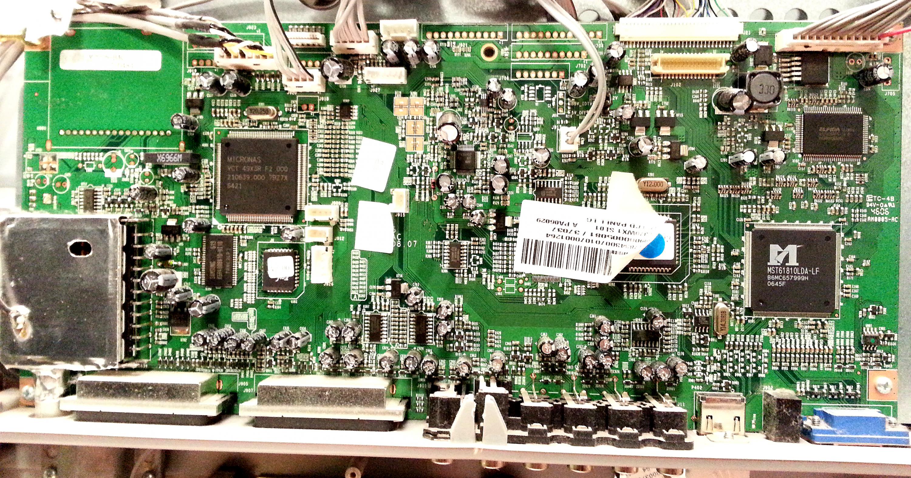

    Hi Guys can you please help with this Bush LCD37TV006HD problem?
    Pics attached.
    The problem is it will keep switching channels/inputs or go into menus and raise the volume up and down all on its own without any buttons being pressed.

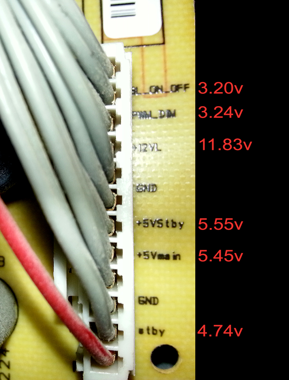

    Here are the voltages:
    BL_ON_OFF - 3.20v
    PMW_DIM - 3.24v
    +12VL - 11.83v
    +5v Stby - 5.5v
    +5v main -5.45v
    styb - 4.74v
    Thanks,
    zx81.

          I've had a fault like this on a Bush made by proview like this set. In that case the strange "parallel port" connector between boards had come loose. It connects the main board to the chassis.
