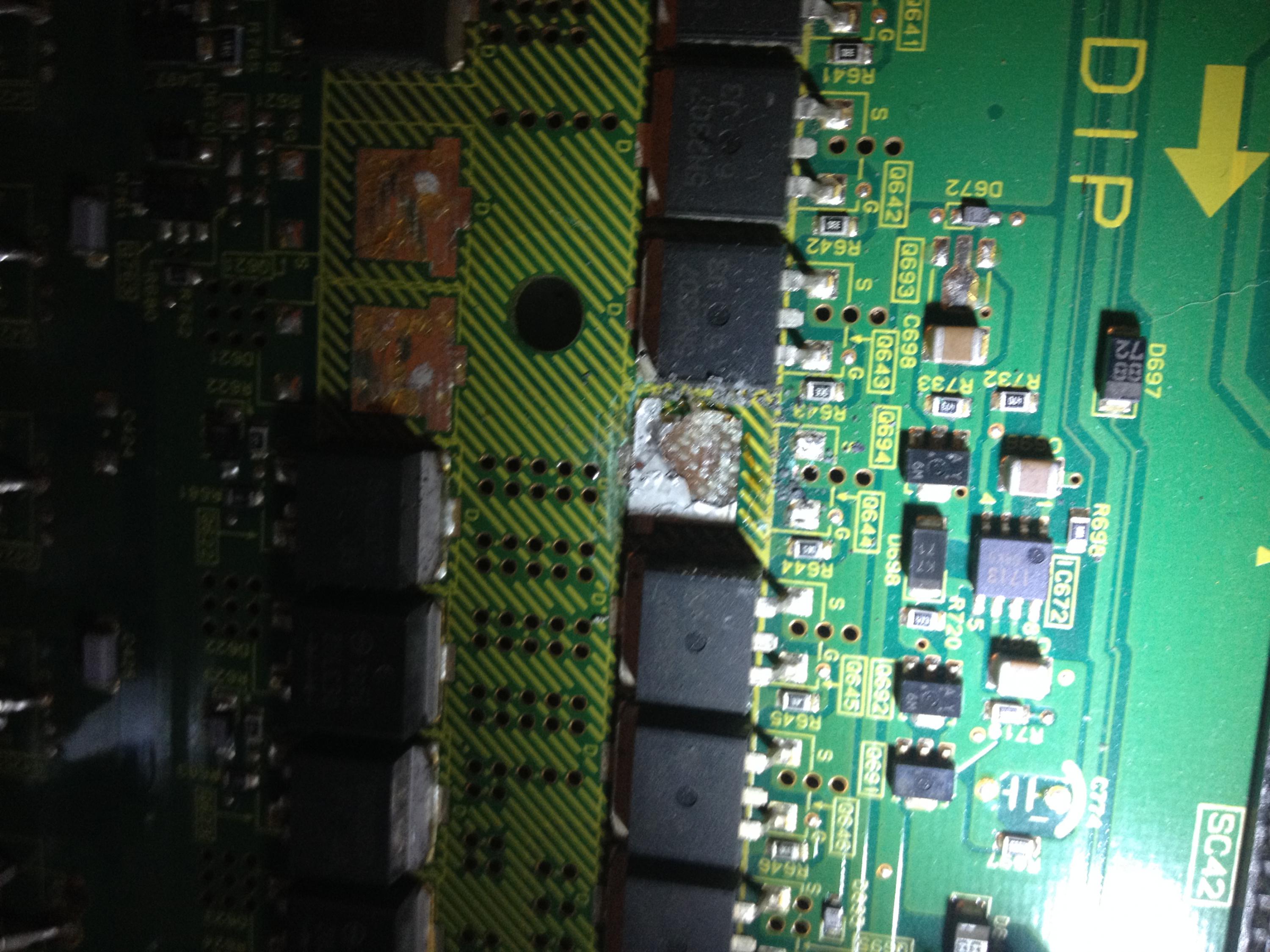

      Re: Panasonic TH-42PZ77U 7 blinks
      Originally posted by tw2005
      out of curiosity start with Q644 since leg to leg was different
      After lifting the right leg of Q644, the measurement is exactly the same as it was with both legs in circuit.
        All you want to do is check RL to tab as that is what was shorted. if it is with the leg up then recheck the bank and see if the RL short has gone or not.
            I don't know that I actually had a short. If you remember right, that one just read a little lower than the others. RL to tab (back of the transistor) is identical to what it was.
            RL to TAB is shorted that's why we're doing this. Just start at the first transistor and continue until you find one shorted on the RL and the bank no longer shows shorted. I just suggested that one since you said leg-leg was different.
                When I said the measurement was exactly the same, I meant on Q644. I had not checked the others. I'm a novice here but, I'm learning. I just checked the others starting at Q641 and with the leg of Q644 lifted, the measurement goes to .463 I held my leads on it with one hand and, used my other hand to push the leg of Q644 back down and Q641 went to .045 I guess this means Q644 is the cause of the problem? That one is shorted and shorts the whole bank til you take it out of circuit? Do I have this right?
                You see me being a newbie to this, I didn't realize that the original .045 measurement was a short. I have a lot to learn.
                oh ok, well then that proved to be a good guess because you remember you said leg - leg this was the only one different which I was hoping may have been a hint.
                yeah so if it no longer reads 045 in bank with 644 lifted then that's it. you'd probably get away with firing the TV up with just 1 missing for a quick test or wait and replace it. lift both legs remove completely first though.
                        I gave her a go and with both legs of Q644 lifted, the tv powered up and the menu came up on screen. Looks like that's all I need to do is replace that. Sweet.
                        Now, am I going to need to use hot air to get the job done without damaging anything? In the other thread, a guy or two damaged their boards removing the FET
                            So what do you have? This is where you may need input from someone first hand. I think the damage would be not getting enough heat into it quickly. I'm tempted to suggest 80w iron with chisel tip flow fresh solder on the tab, heat until it starts bubbling on the sides and lifts off.
                            Dewick excess solder , flux pen then lightly tin the back of the new transistor tab. Place and heat, feed solder on the sides which should draw in. Heat so it goes right through . let cool then tack the legs to their pads.
                            Bound to be video on hand soldering smd fets
                            Right now I have an iron and a solder gun. I think the solder gun is 100w. Not positive. On Wednesday I expect delivery of a Weller soldering station. It has a temp range of 350 to 850Β°F (177 to 454Β°C). I see some hot air stations pretty reasonable that might be a worthwhile investment. I have solder wick and some canned flux.
                              Never used a solder gun , honestly give it a go.if the solder has melted the transistor will need no force to move it.force and high heat lifts/tears the copper tracks . if it does not happen don't use force. Using a kids tablet . slow as for typing
                                Right. I don't want this to happen. https://www.badcaps.net/forum/showpo...8&postcount=67
                                I see you posted in that thread so you know what I mean. I have to wait for a new part anyway. I will watch some videos on it in the mean time.
                                  It happened anyway. #@!@%^@$%!@#^
                                    Did you use a hot air gun or soldering iron to heat up the tab?
                                      I used a soldering iron. I'm thinking maybe I should just get a hot air unit. I don't think I need an expensive one. I'm not sure it would have made a difference since I've never tried it.
                                        Well I tried to flow solder into that pad and it won't stick to the area where the copper pad was torn out.
                                        I may have to just try it with what's left.
                                          Rockguy it will help if u can use some chip quick to remove any smd chip without destroying the pad , it has a lower melting point and stay liquid long enough to remove the chip .I use it to remove large chips . works very well
