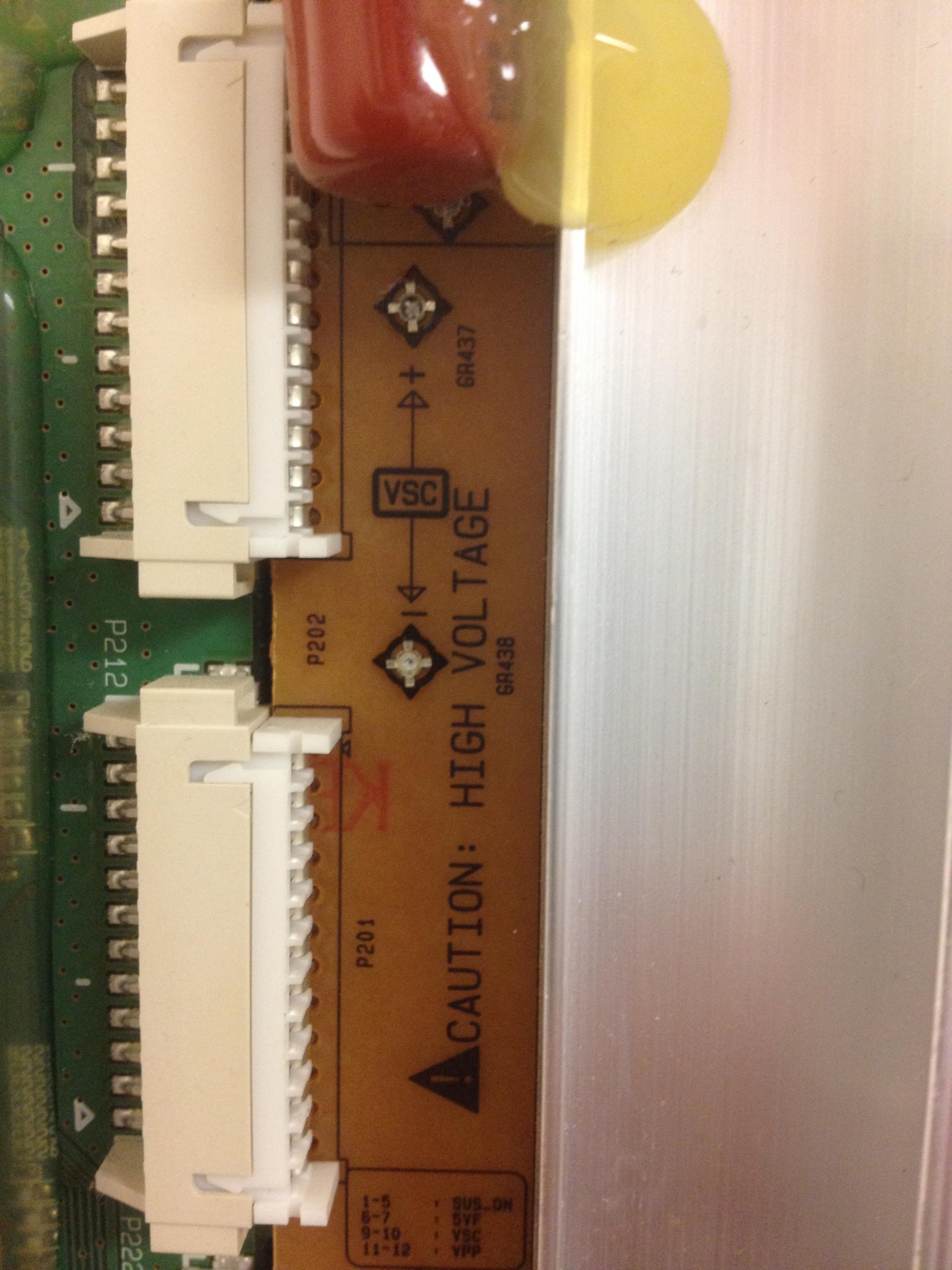

    Re: LG 60PV450 Sound No Picture
    On the Y-sus locate the two resistors marked -Vy and Vsc and check voltage across them, should be approx -200V and 150V

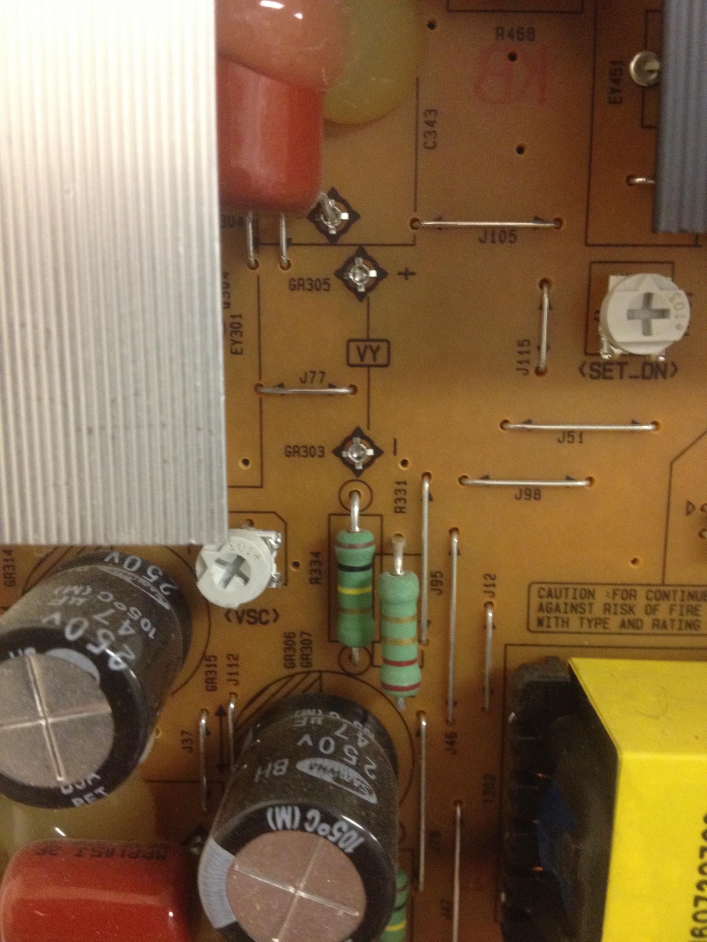

        Tom just want to make sure this is what I am looking for (in pics)? And I assume Fluke on DC and measure across those test points? If so I get:
        Vsc 2.7V (fluctuating)
        -Vy -69.7 (fluctuating)
        Way off unless my testing is incorrect.
          Those are very low voltages (I am also seeing low voltage on both Y/X, those are the correct test points. what is your VZB reading on your Xmain?

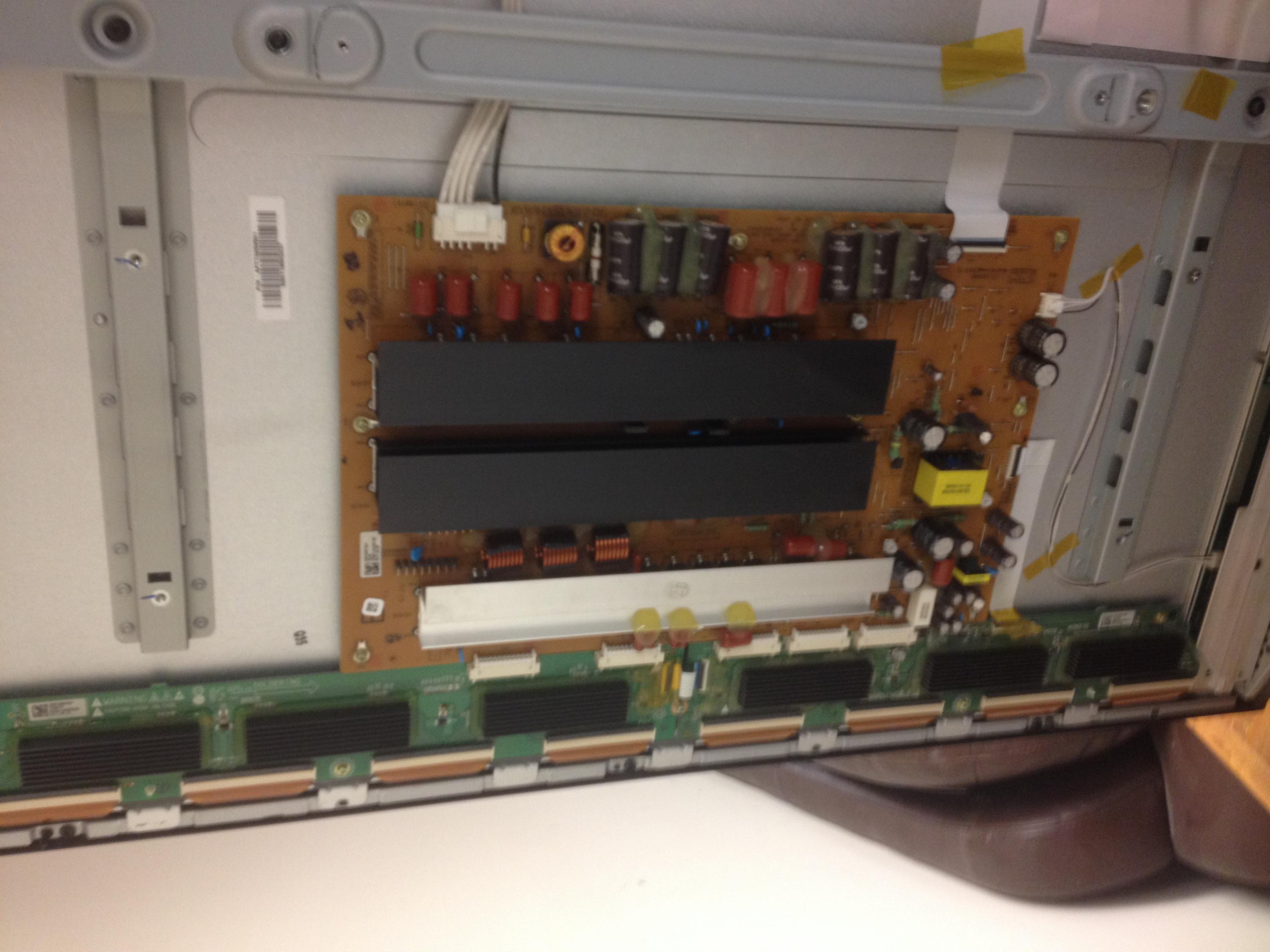

                With the buffers pulled out of circuit the Vsc is registering 0.012V and the Vy has jumped up to about -130V. I am guessing you are talking about the small ribbon cable on the bottom going into the bottom buffer from the Ysus board?

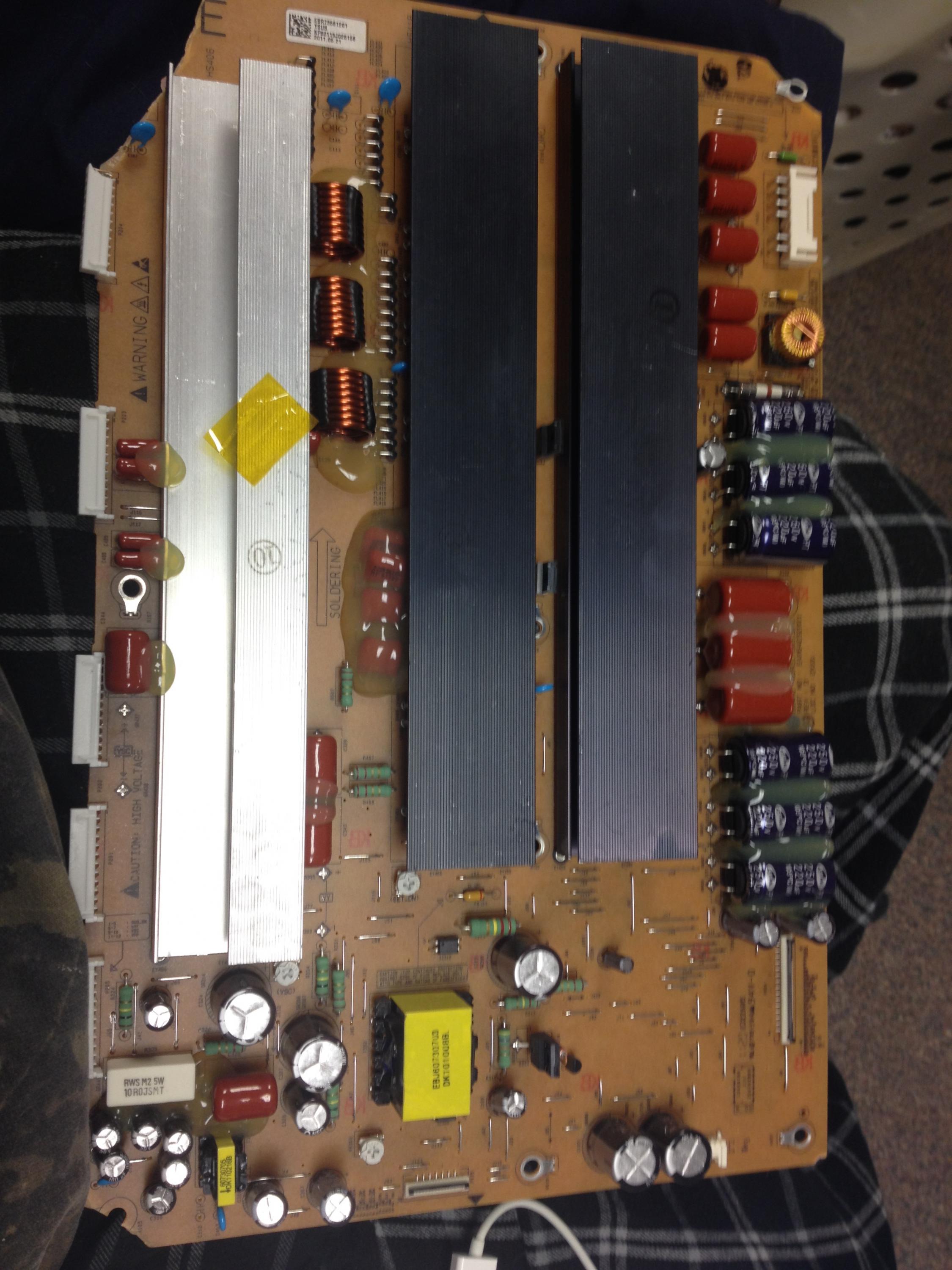

                                This is the pic of the damaged board I received but should work for ID purposes.
                                    gotcha, so you already installed the new (used) buffers and when they are both connected you are not getting a picture and with only the top buffer attached you are only getting the top half of a picture?
                                    Did you test the buffers for shorts before installing them?
                                    Also your Ysus is Part Number EBR73561201
                                    MFR Part Number 1 LG EBR73561201
                                    Board Number(s) EAX64232001
                                    Panel Sticker Number PDP60R30110
                                      In hindsight no, I just tested it and low and behold the bottom one is shorted. If I am testing correctly, I am using my Fluke 87 III Ohm setting black on one pin of the middle connector (P212) and starting at the top of the ribbon cable connector following it from top to down like a zipper with the red lead. The top connector (P201) is showing shorts on about 6 or 7 different pins. The remaining 3 ribbon cable connectors all test OK.
                                        Yep that's dead. No cracks on the panel? Is original OK?
