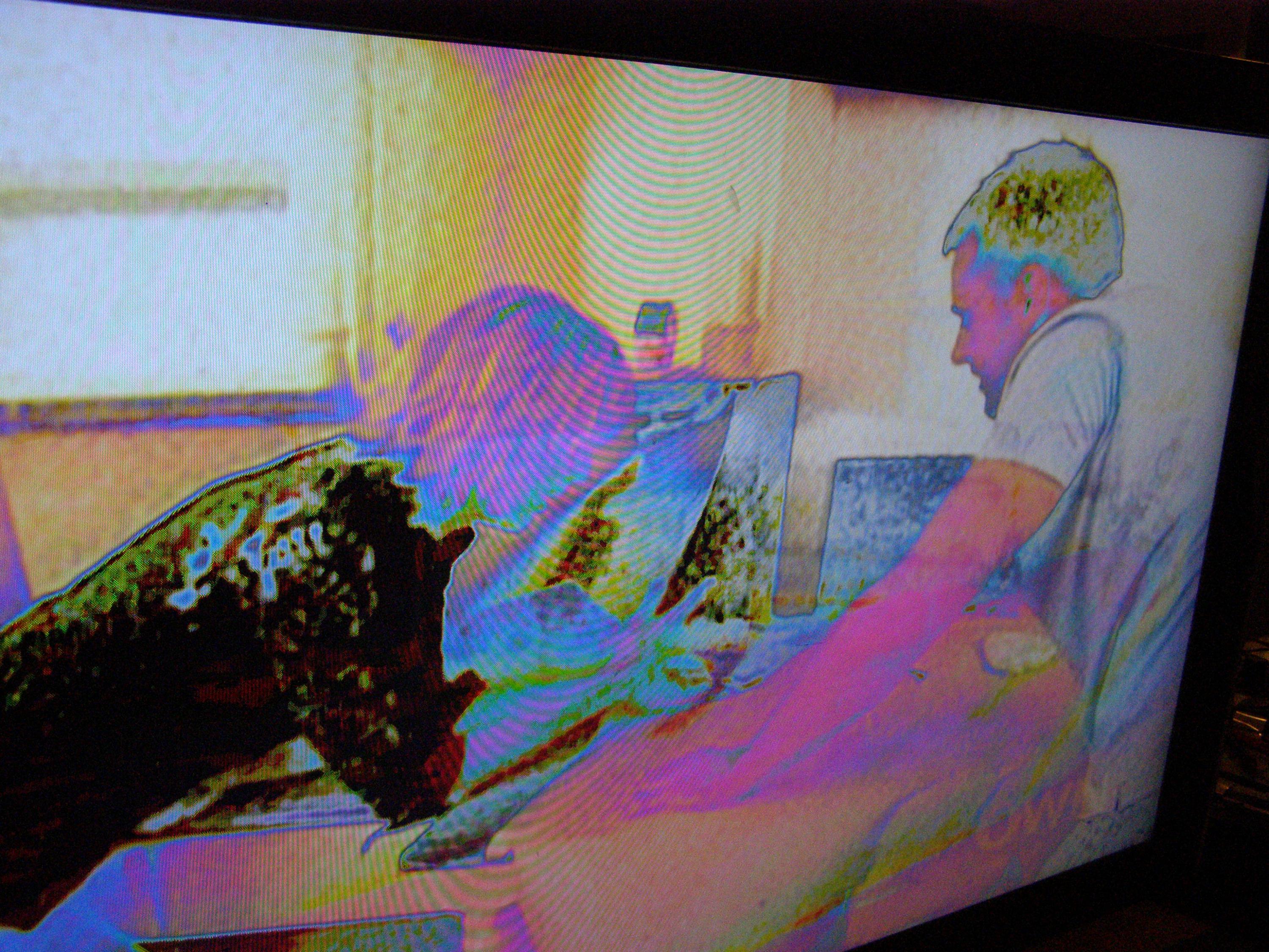

Samsung ln46a530p1fxzc image is NEON

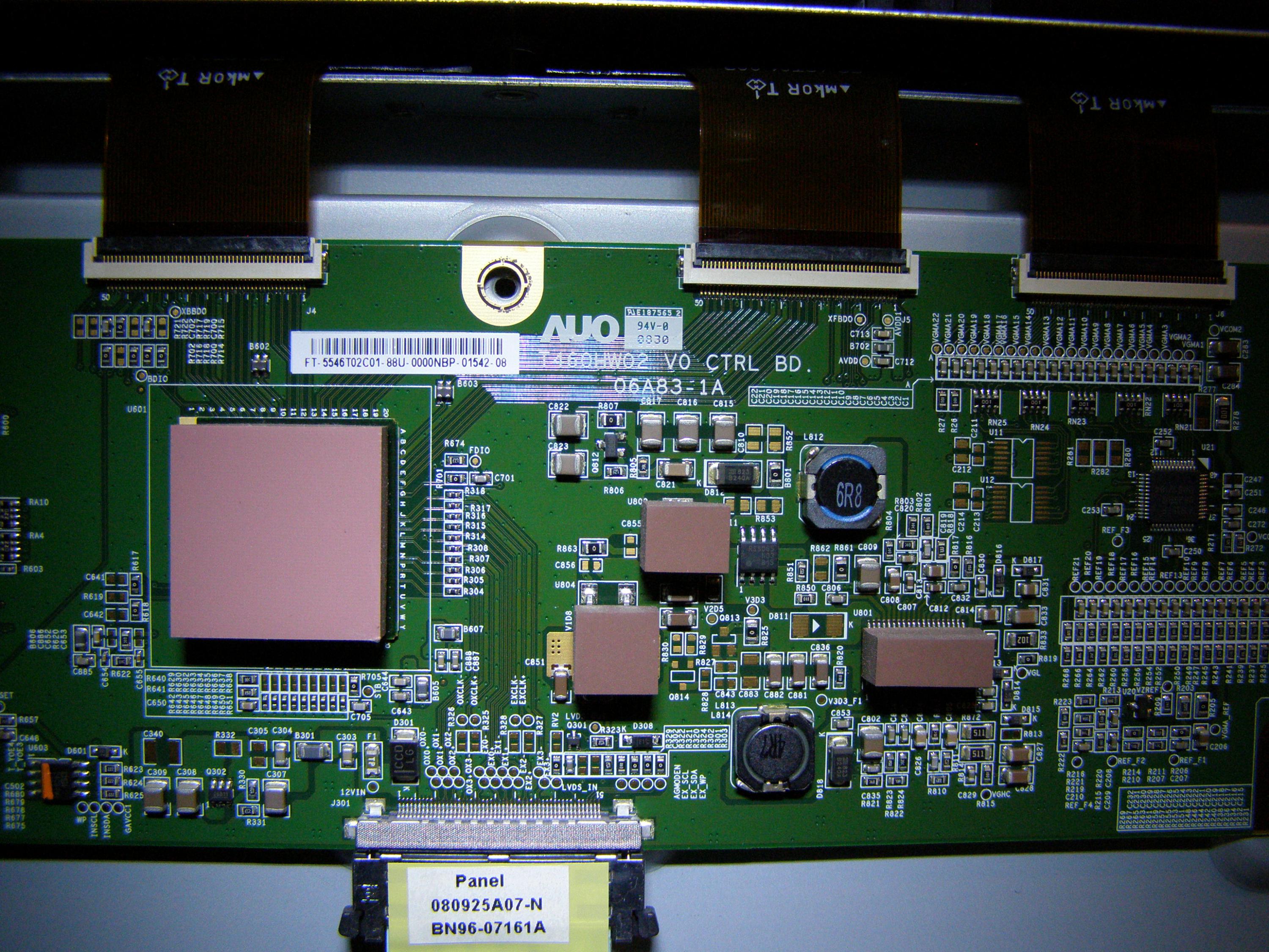

    hi im new to badcaps very interesting sit, my samsung ln46a530p1fxzc picture looks like the people are neon,imaged attached, pull off ribbon cable from tcon board and cleaned the ends, also when the tv is on a music channel the screen appears to be slightly red any ideas thanks jim
  • diif
    • Feb 2014
    • 6978
    • England
    Re: Samsung ln46a530p1fxzc image is NEON
    It looks like the common AS15-F gamma chip failure. There are many threads on here if you do a search. Can you take a picture of the t-con ?

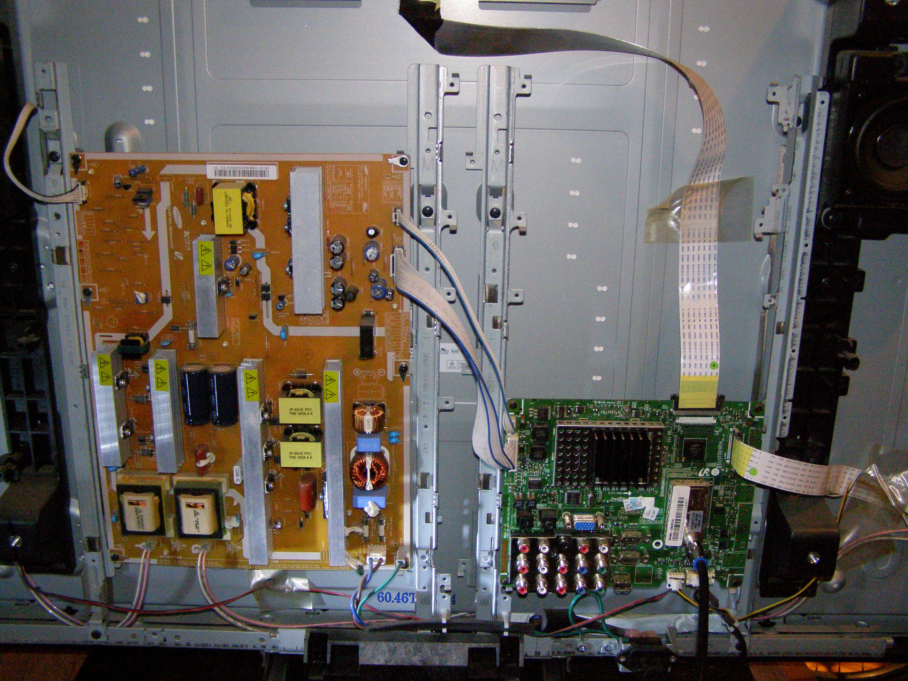

      I may be your tcon board the as15 chip. Need good clear pictures of tcon.

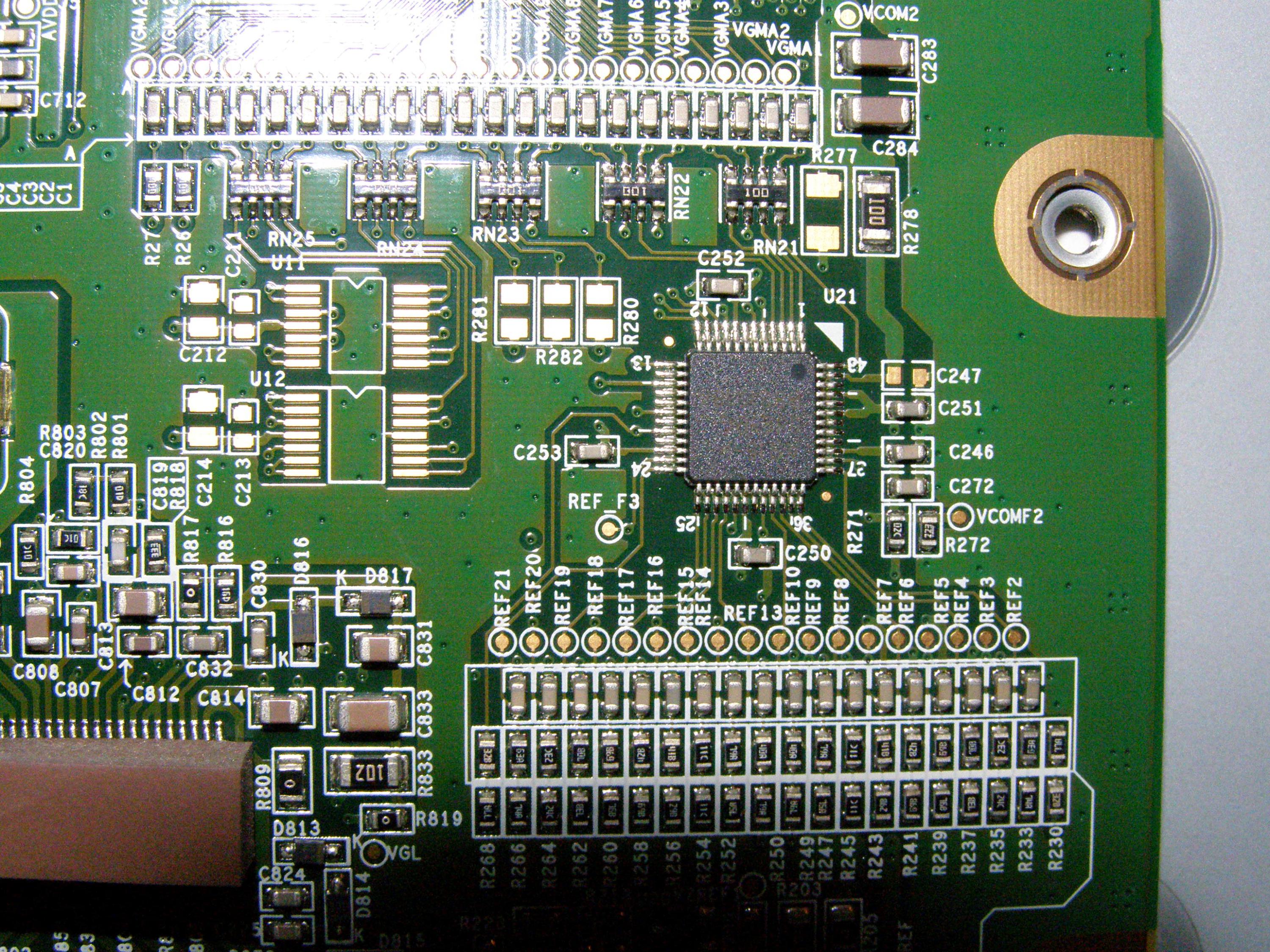

        here r pics sorry 4 delay

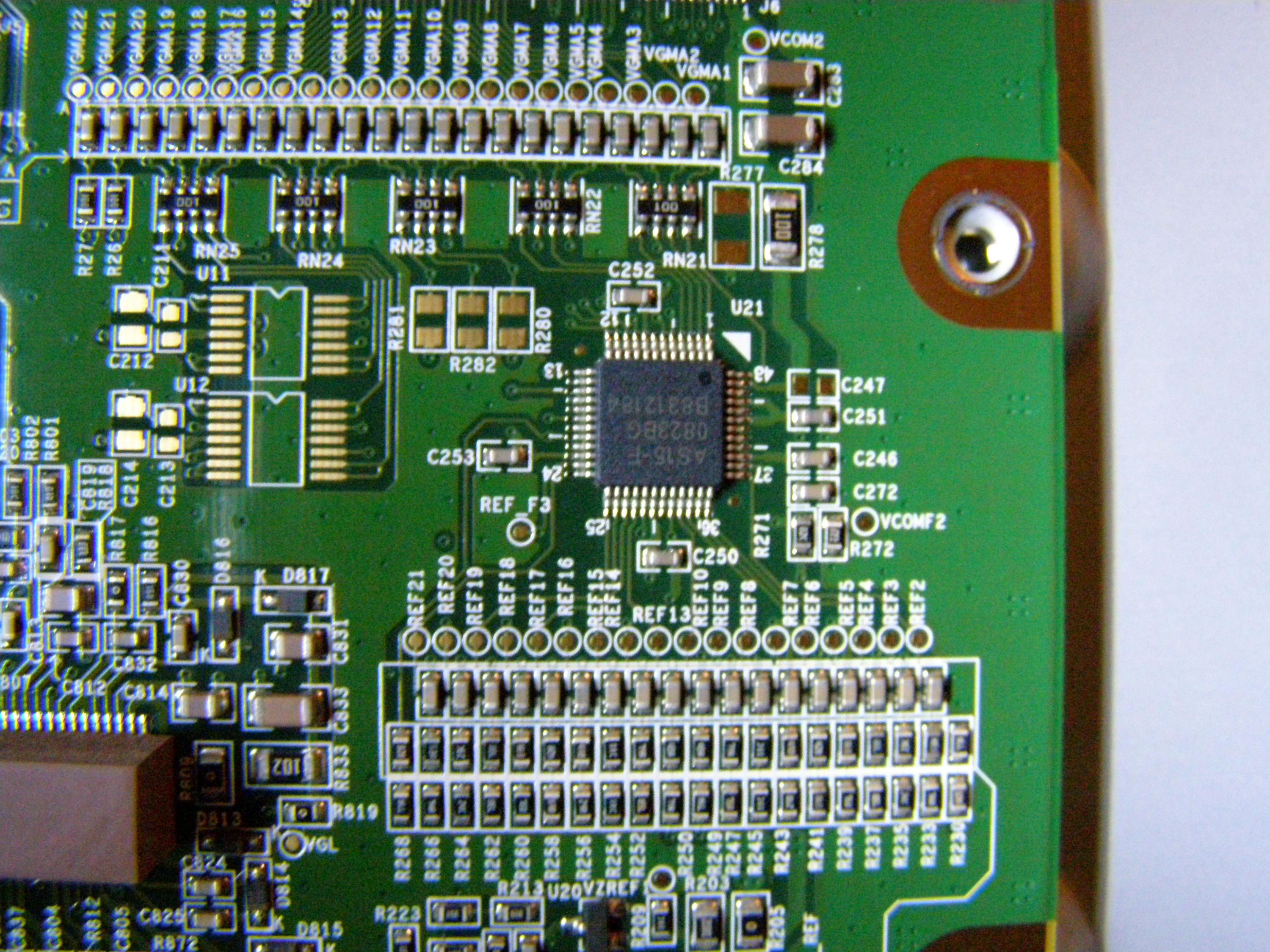

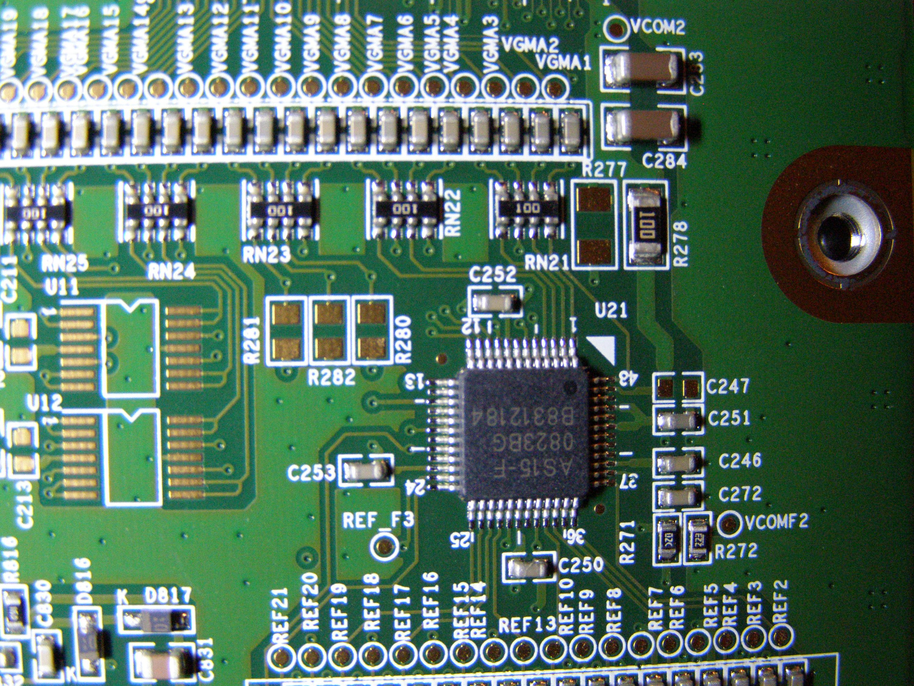

          Yep, AS15 Gamma Voltage ref IC.
          You can check the DC Voltages at VGMA1 ~ the highest VGMA (looks to #19) and report each reading.
            i measured voltages on connector VGMA1-8.6 vgma2-9.6
            vgma3-9.9
            vgma4-13
            vgma5-11.05
            vgma6-8.73
            vgma7-11.7
            vgma8-13.16
            vgma9-8.09
            vgma10-7.5
            vgma11-7.5
            vgma12-6.6
            vgma13-12.9
            vgma14-12.1
            vgma15-5.4
            vgma16-5.0
            vgma17-4.1
            vgma18-3.5
            vgma19-3.0
            vgma20-.65
            vgma21-.51
            vgma22-.26
            VCOM-6.54
            AVDD-15.47
              It is bad, either try to replace the IC or replace the board.
                  Board P/N as printed on the bar code sticker:
                  5546t02c01:
                  http://www.shopjimmy.com/auo-55-46t0...-con-board.htm
                  • tileman
                    • Nov 2014
                    • 14
                    • usa
                    thanks Bud im going to order the IC does it mater if the second and third row of numbers on the original IC match the new on or does it only have to be AS15F on the first row
