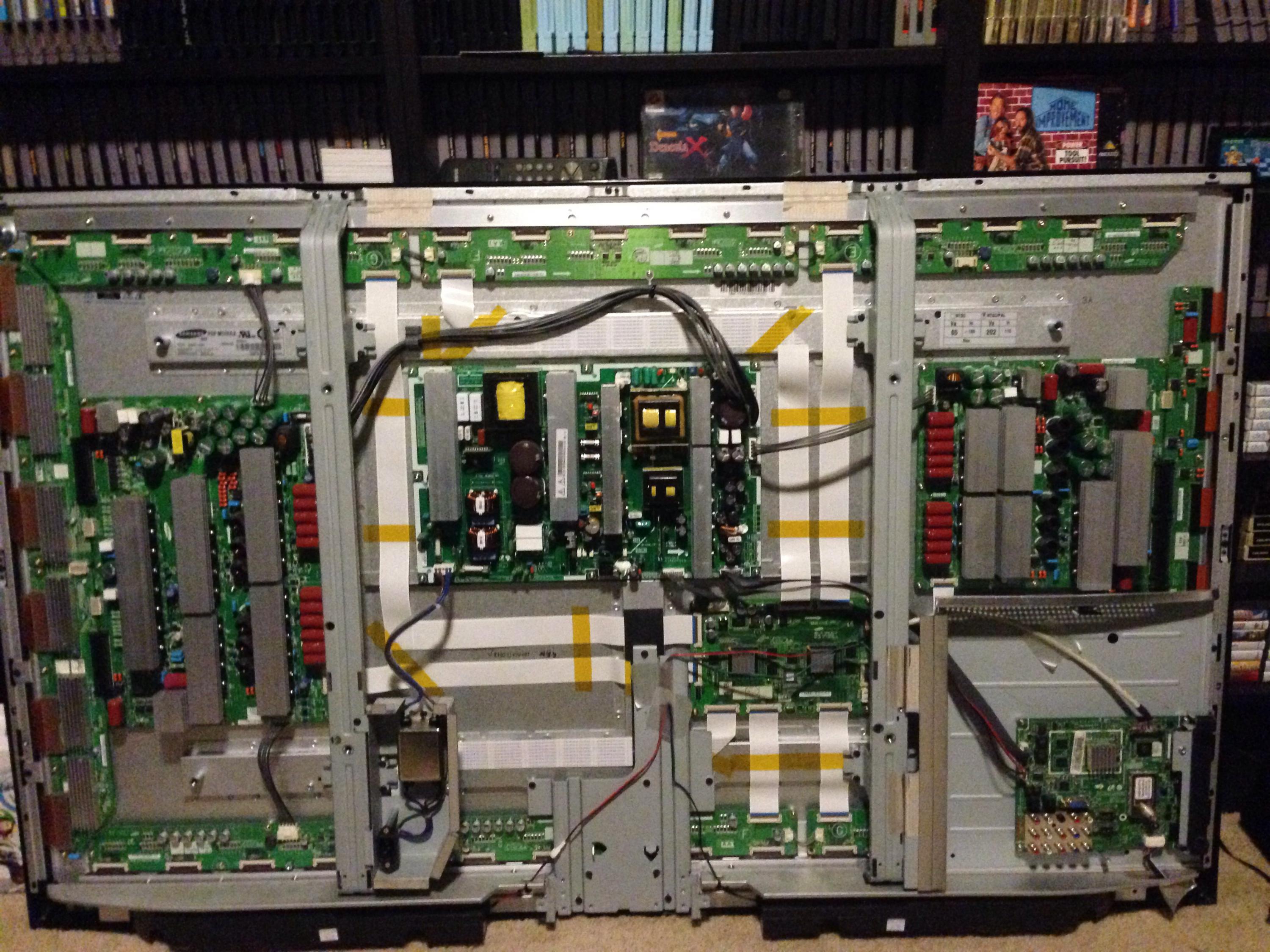

    Re: Samsung PN58A550S1FXZA turns on with audio chime, no picture.
    All fuses check out good.
    I took a chance and powered on the unit, I hear humming from the x board and a a slight buzzBUZZbuzzBUZZ kind of sounds like oscillation back and fort between low and slightly louder buzzing from the Y board.
    Va/Vs are in spec.
    This is what I am looking at here folks!
      VSC -185 spec/ Actual bouncing between -125 to -113. Me thinks the y-main is shot.
        Tried the Ymain out of the cracked panel and same thing, low VSC.
        Think maybe the Lower and Upper drive buffers are shot?

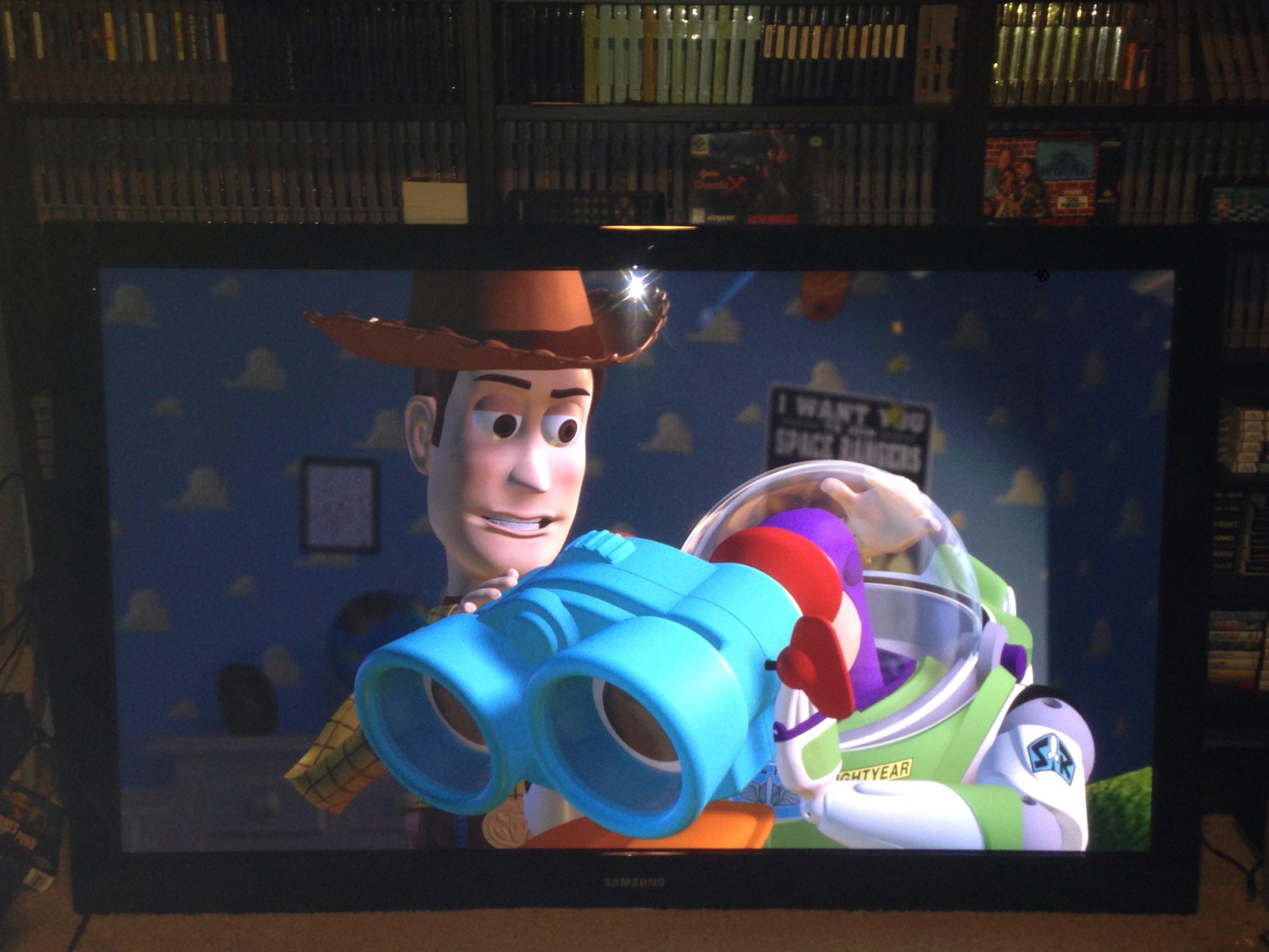

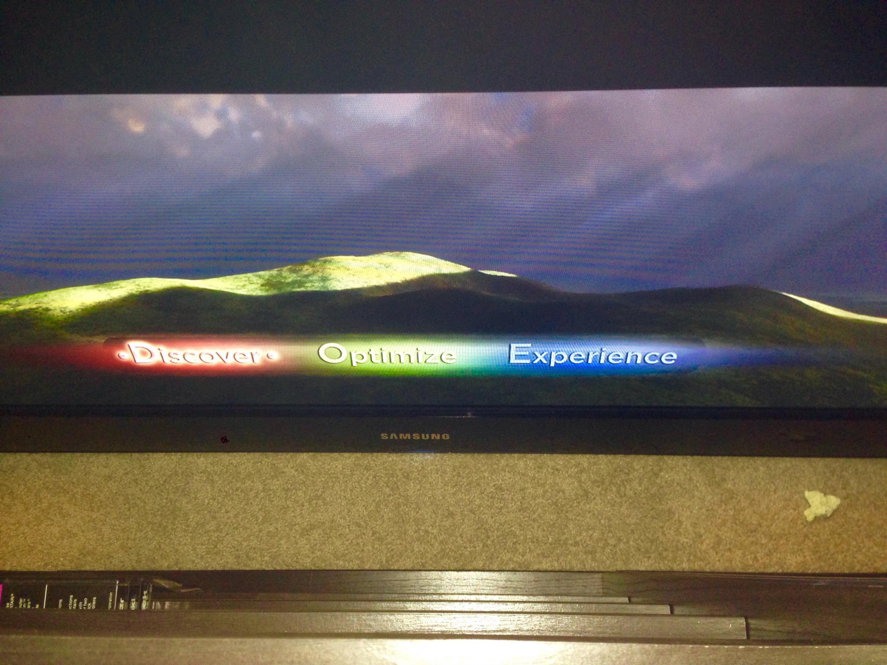

              As for anyone who is following this thread i have an update, I have got the TV working, well half of it anyway it seems that the second from the top buffer IC blew out catastrophically causing damage to the upper buffer board on the backside Blowing out a spot circle on the back of the PDP. so I'm going to have to track down another one but the TV seems to run fine with only the lower buffer.
              All voltages are stable and in spec even after being on for 20 min. I was running the test patterns and then decided to switch to video just to see that work and it worked fine.
              • Shinju
                • Mar 2014
                • 1239
                And fixed, I went back to scavenge the busted panel for its y-drive boards and tested them for shorts and they tested out great so I put the upper Ydrive buffer in and its up and running and the picture looks great.
                I do have a new old stock upper Ydrive coming I think I will put that in to be safe but I am sure this buffer would be fine.
