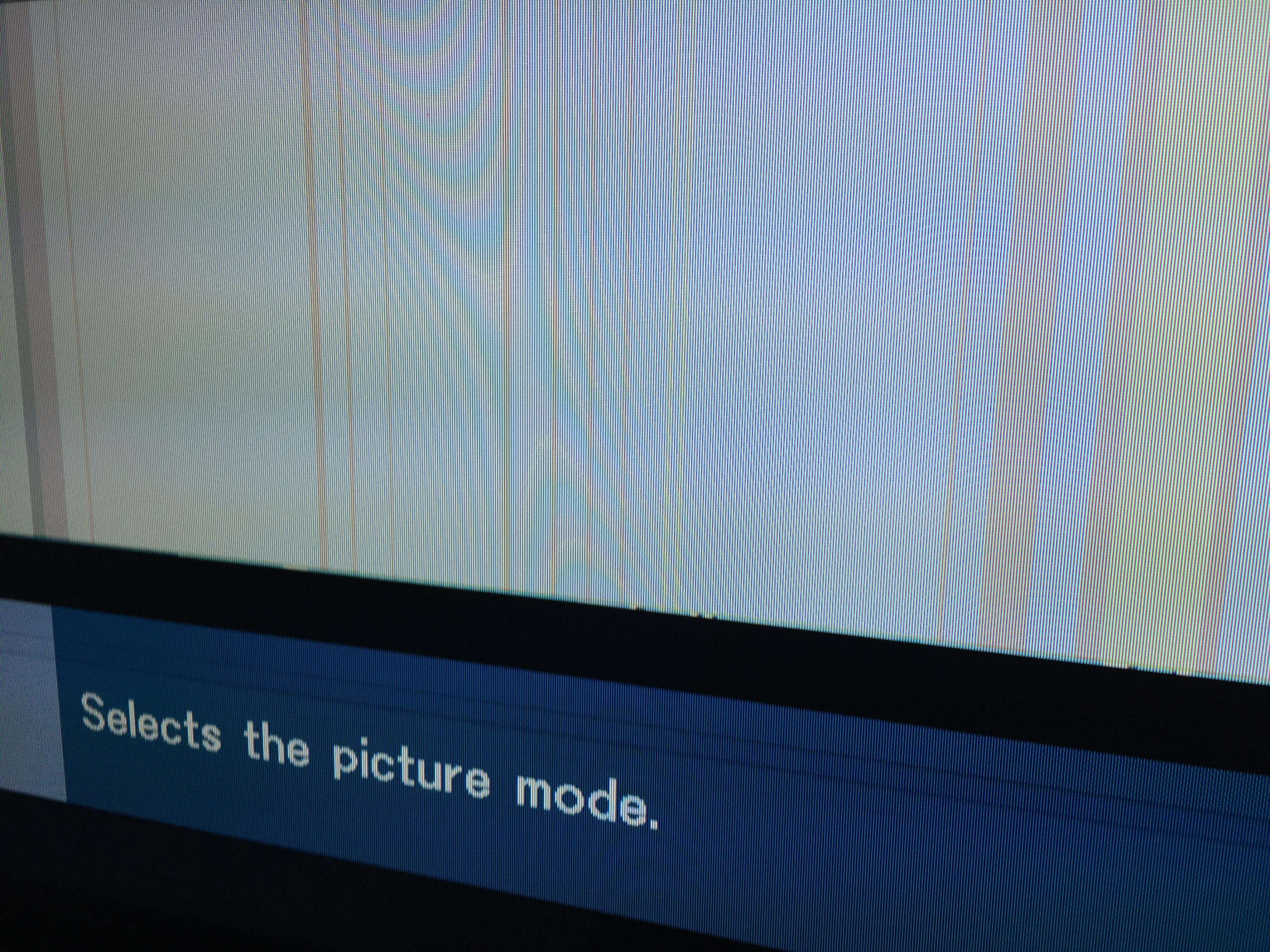

    I have this samsung tv that will turn on but will not display correctly.I am thinking possibly tcon board.look at picture give me your opinion.thanks
    Re: Ln32a450c1d screen is not displaying correctly
    Can't quite see what you mean, is it the vertical lines you are concerned about? Is the picture otherwise ok?

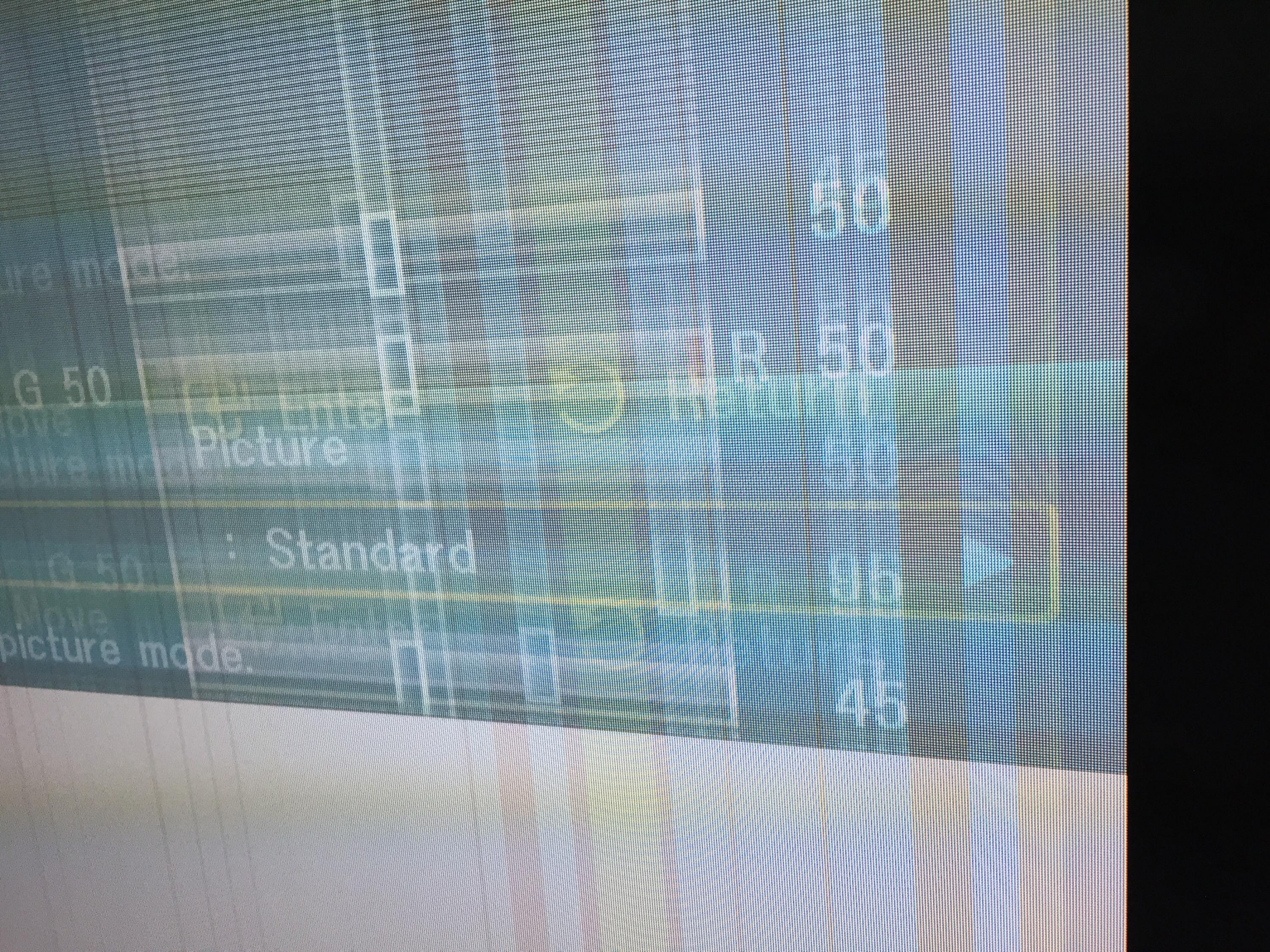

      Here is another pic
        I'm going to say panel possibly tab bonds, is there one area that is continuously white?
          No it changes like it wants to work
            Could you record a video of the whole screen doing what it does?
                Here video did it in two parts
                https://www.youtube.com/watch?v=qoreP4Y_xxY
                Second part
                https://www.youtube.com/watch?v=dLqURdC3rwE
                I hope this helps
                  Looks like a bad panel, maybe worth trying tabs but I would be surprised.
                    I tried reseting the tab tcon board still same i did look at tcon see if it was getting power.looks like it is also checked voltages on spots from tcon to panel ribbon.they have voltages also two caps c1 and c2 .c2 has 15v and c1 has 3.3v.there is also ka1718 mosfet maybe regulator center tab 1.216 left tab 2.651 and right tab 3.313 fuse 11.87 on both sides.do these reading look good if so that way i can say it is a bad panel.
