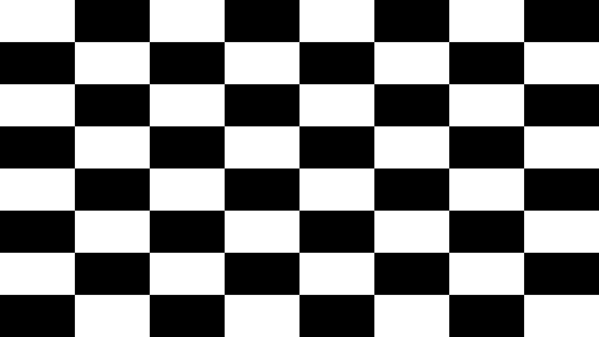

    Made a nice score on this thing today, mint condition and ended up just being a software issue. If you run into any of these LN-T4x6x series TV's and you are seeing any of the following issues: Blue (or other color) tint, psychedelic colors, negative colors, 2-3 horizontal lines, it is probably a simple fix. I can see it easily being mistaken as a hardware issue, and funny enough a new motherboard would probably fix it. I don't want you guys to go wasting your money for such an easy fix.
    Samsung released a firmware update that set values incorrectly in the service menu and when customers call them about it, Samsung tells the customer they shouldnt have installed the firmware and their TV is broken. (reported by multiple people online and the gent I picked this up from.)
    Here is the fix:
    1. Make sure the TV is off. Then on the remote, slowly press MUTE, 1, 8, 2, POWER. Wait for the TV to come on and the service menu should come up.
    For psychedlic/negative colors: Goto "Option Byte" then "Lvds Tx Fmt".. Change from JEIDA to VESA. That should fix the issue.
    For blue (or any other color tint): This one is more involved. Probably easiest to do with a PC that has VGA and HDMI connections. You need to find an 8x8 checkerboard image, or use the one I've attached. With the PC displaying on the TV and the checkerboard JPG full screen, bring up the service menu and go into Calibration. Run the calibration on both HDMI and VGA, once for each or until it reports "success".. I had to try a few different times for some reason and finally got it by using the checkerboard for my windows background and hiding the taskbar/destktop icons.

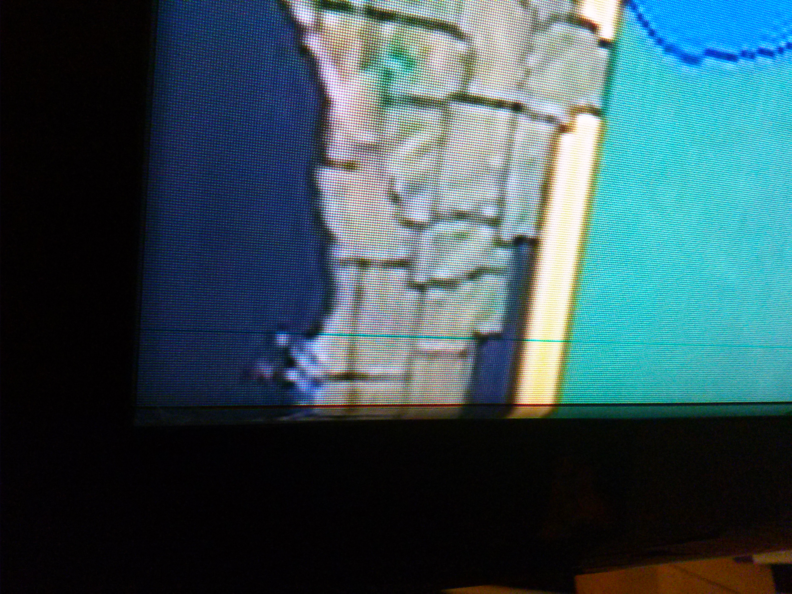

    Well, scratch the horizontal lines part. They are intermittent and have returned. Also seeing a blue vertical line on the left side of the screen. They seem to go away when I flex the TV. It's looking like the previous owner was probably trying to fix a hardware issue by updating the firmware and messing around in the service menu and screwed up the calibration.
    I wasn't able to recreate the horizontal lines to take a picture, but they are 3 horizontal lines evenly spaced out and also artifacting occuring in between the lines. I got a picture of the blue vertical line. This also goes away if I flex the TV a certain way, but they aren't mutually exclusive.
    Starting to look like a tab bonding issue to me, any other suggestions? I'll probably tear it down tonight and look at the components, maybe even poke at the tabs. You guys want to group buy a tab bonding machine? We can keep it at my house.

      Re: LN-T4061F Blue Tint, horizontal lines
      sure seems like a tab bond issue.
        I may have been wrong about the lines going away when I flexed the TV. I did a reset through the service menu and the lines immediately disappeared and haven't been back since. Is it possible this was a software issue? I'll keep playing with it to make sure they dont come back.
          Lines are back. Seems to happen when the unit is cold and they disappear after a bit. I was able to make go away quick with a hair dryer. I think it may be the capacitors near the mainboard header on the PSU. I'm gonna try a few more times today and report back.
