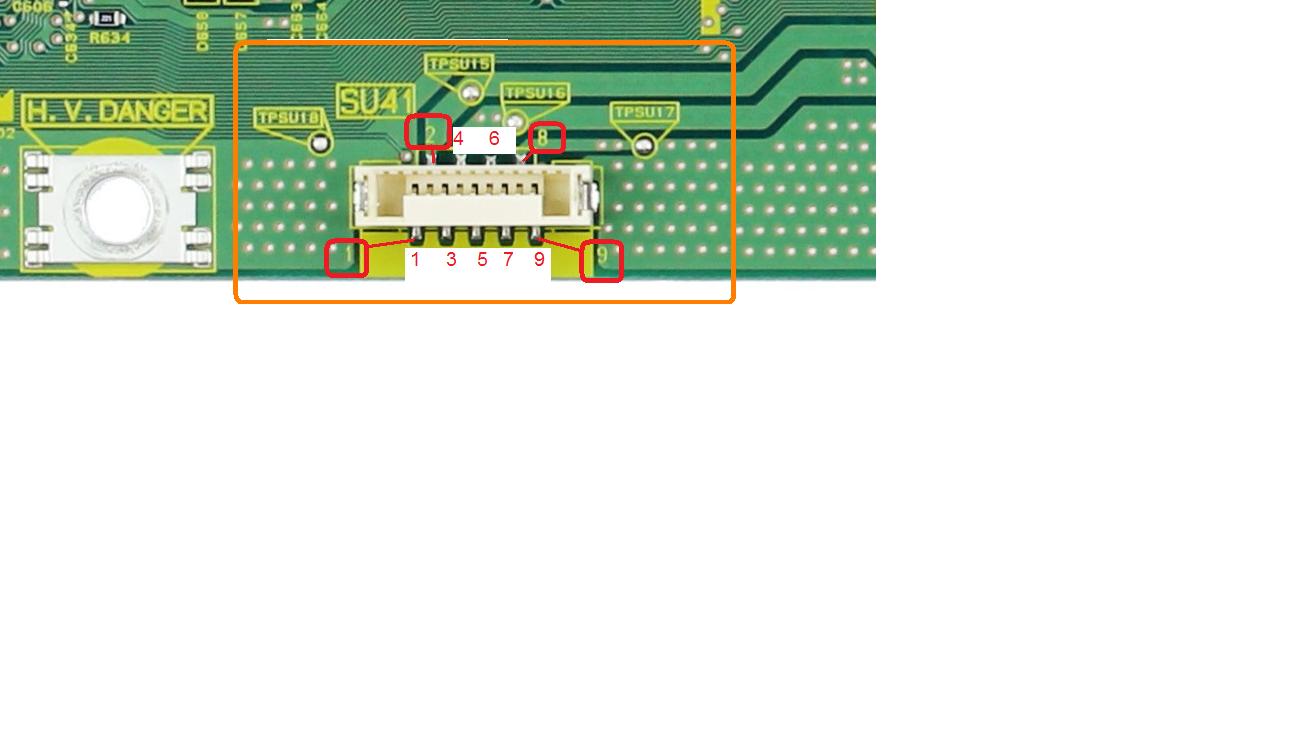

    Slide 43 – Vfo, VSCN-F, & 5V_F Resistance Measurements (SU-SD boards)
    Step 1: Remove the 4 VFG screws from the SU and SD boards…check!
    Step 2: Disconnect SC41, SC42, and SC46 from the SC board. Also, remove the ribbon cable between the SU and SD boards (SU11/SD11).
    Step 3: Using the VF-Ground as reference, measure the Vfo, VSCN-F, and 5v-F resistances on the SU and SD boards individually (here I used the Chassis as ground since the point highlighted in the image on Slide 44 of the troubleshooting guide does not appear to be a ground).
    SU41 (pin2, TPSU15, 2.2M) --> 5.77MOhm
    SU41 (pin4, TPSU16, 221K) --> 221KOhm
    SU41 (pin8, TPSU17, 5.7M) --> No Response
    SD42 (pin1, TPSD29, 2.2M) --> 6.14 MOhm
    SD42 (pin2, TPSD28, 221K) --> 221K
    SD42 (pin6, TPSD26, 5.7M) --> 15 MOhm (Rising, climbs over 20 MOhm)

    First, it appears as though the troubleshooting guide has reversed the expected resistances for VFO and 5V_F. Would you all agree?
    Second, when I test TPSU17 (both on the test point and on the actual pin) I get NO RESPONSE from the multimeter…nothing. In other cases (for instance when I indicated short above for various IGBTs) the voltmeter will go from reading “0.L” when not in contact with anything, to reading 000.1 Ohm when the two leads are touched together, or when reading an actual short. Why does this pin not respond at all? Also, why is the reading for the same line on the other board so high?
    I repeated the above measurements after jumping pin1 and pin2 of SC50 with an alligator clip. Readings were identical to those without the jump.

          I would say the buffers are fine. They usually are, however I had a TV with a bad set and popped a new SC.
          If they were bad , at least one of those 3 check points would be dead short. usually Vfo.
          Try reversing the probes, and yes they may have mixed up the results, I'll check but in my thread I did up a table of real results from my boards. thatwas before I found that G20/25 guide and they match up pretty good.

              Ok, I reversed the probes and got a reading for 5V_F on the SU board (8.1M).
              I've begun to look at your 'chronicle' its a doozy...a LOT of work there. I've attached a spreadsheet with the rest of my readings from the buffer boards, next to yours from that thread. Is there any reason why I might have elevated readings for Vfo? Notice that with probes reversed I did not get OL for pin7 on the SD board??

                    No, I think somewhere in the bowels of that thread of mine johnboy1313 had a similar issue not being able to attain the results.
                    Could simply be the meter. what do you have?
                    I would push on and just get the Sc board done. What you have there will not blow the board and I expect this will work once the SC is done.
