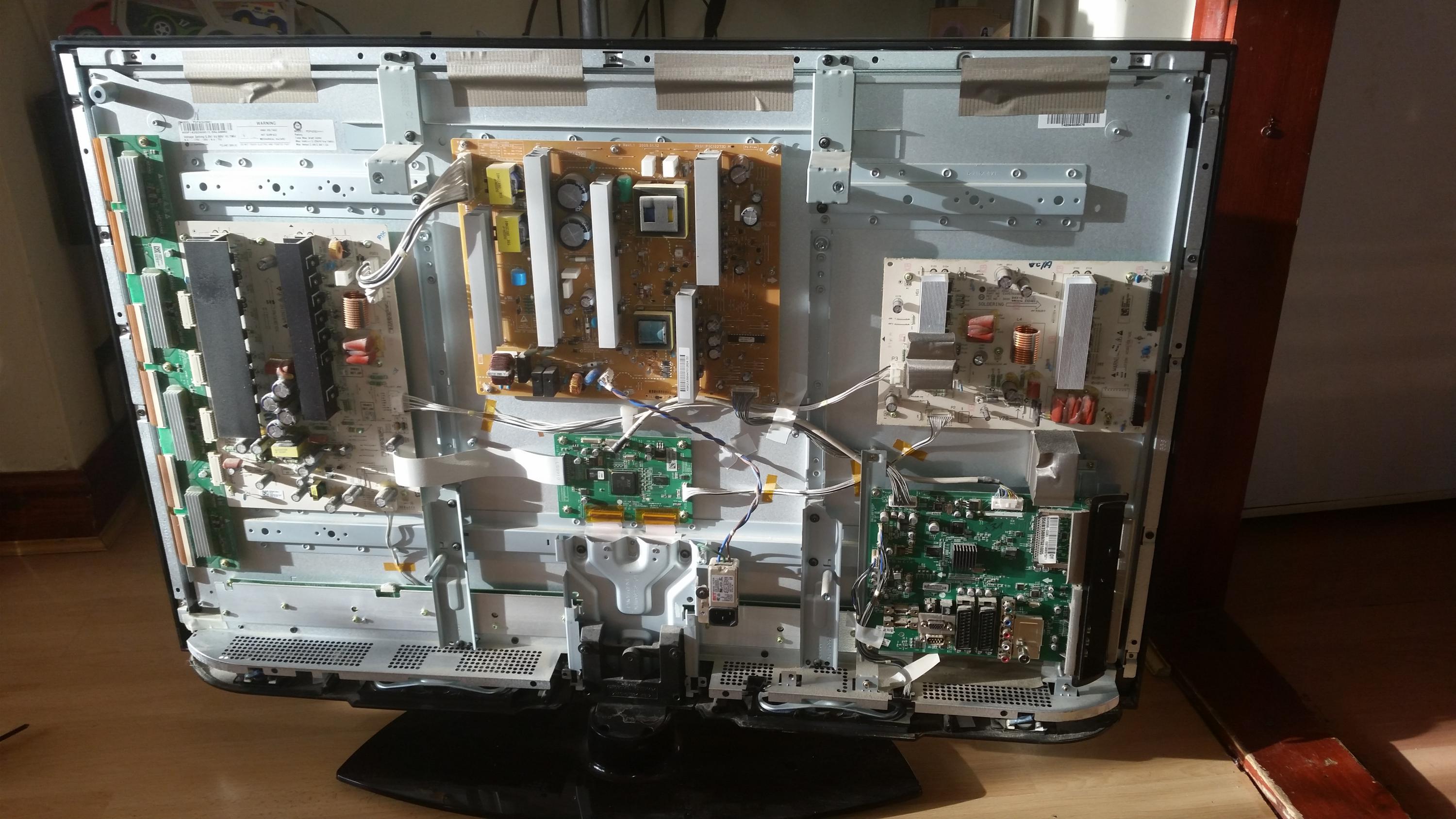

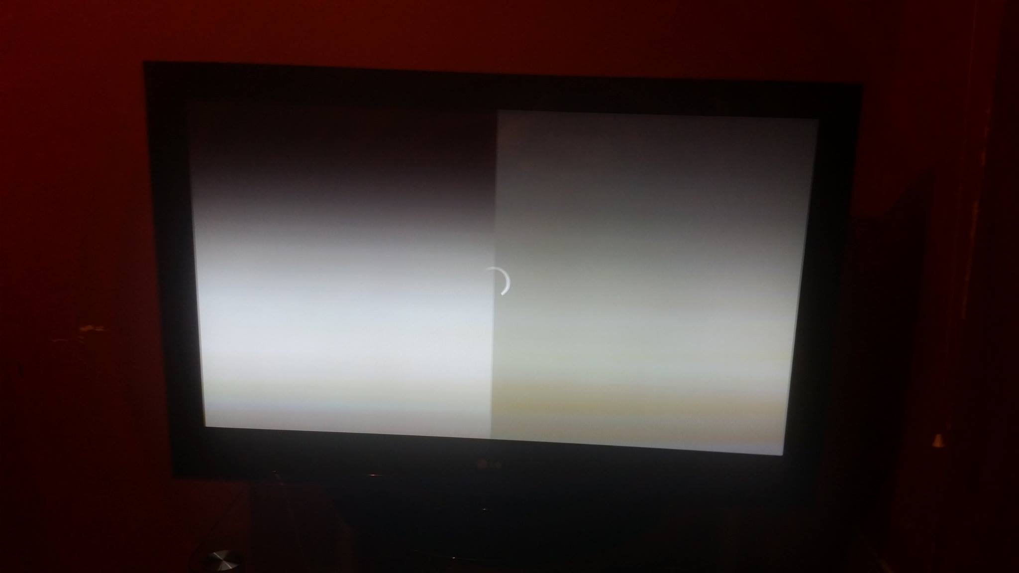

    hi guys
    picked this tv up today originally had a fault where only half the screen was working but fixed this after cleaning out loads of dust and reseating the lvds ribbons,but i have also noticed that the remote control does not work on this tv i have tried 3 remotes the only thing that works is the turn off button even the side buttons do not respond
    also just for the record the tv takes roughly a minute to turn on not sure if thats normal for lg plasma ?
    thanks
    p.s the standby sensor is flashing on the front when trying to use the remote

    Re: LG 42pq6000

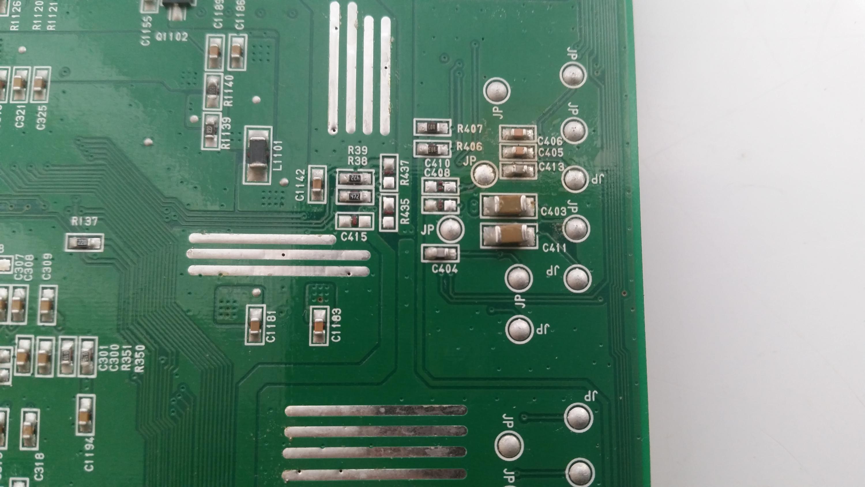

    update :
    im not getting a reading of C413
    C411
    C403
    C405
    C406 im getting readings could this be the problem ?
      Re: LG 42pq6000
      The standby light should not flash, I would check that a button is not jammed on the button panel. If possible, unplug it and just test with IR for now.

        Re: LG 42pq6000
        already tried that tom if you disconnect the side buttons the tv will not turn on at all if you press buttons on remote the blue standby light flashes fine but nothing works on tv
        p.s both power switches are the only thing that works on the remote and side button

          Re: LG 42pq6000
          could it be the control board causing this problem because the right side of the screen problem has come back and if i press a button on the remote it goes ?
            Re: LG 42pq6000
            Sounds more like it could be main board related. Try disconnecting the LVDS cable between the main board and logic/control boards. Then put a little wire jumper across the "EXT AUTO GEN" points to engage the test patterns; what happens? Do the patterns appear OK? The TV will need to be turned on, but only plug it in when you have made all connection changes.

              Re: LG 42pq6000
              yes test patterns are scrolling through look fine tom but on some light test patterns i can just about still see the half screen fault
                Re: LG 42pq6000
                Run it for some time to make sure that's not just image retention. It is possible you have two faults here, but that would be odd.

                  Re: LG 42pq6000
                  ok ill run it for a while you think its main board and control board fault then ?
                    Re: LG 42pq6000
                    I think there might be two faults yes.
                    Might be expensive to fix. At least Y-sustain, Z-sustain, power board and Y-buffer are guaranteed ok, you should recover your investment there easily.

                        Re: LG 42pq6000
                        Originally posted by sordids999
                        update :
                        C411
                        C403
                        C405
                        tom last question would that cap cause this fault ?
                        its strange ive just realised the volume works on the remote but it wont show it on screen that its going up
                          Re: LG 42pq6000
                          Doubt it, what are you using to read the caps?
                          Have you tried a full factory reset? (Hold MENU on the TV and MENU on the remote then select "Factory Reset"; if prompted for a password use 1234 or 0000 or 3142)

                            Re: LG 42pq6000
                            esr meter unless that the wrong thing to use ?
                            no factory reset does not work tom
                              Re: LG 42pq6000
                              ESR meter can't be used on these small caps. I doubt they will cause the issue. I will look into how to get service menu access.
