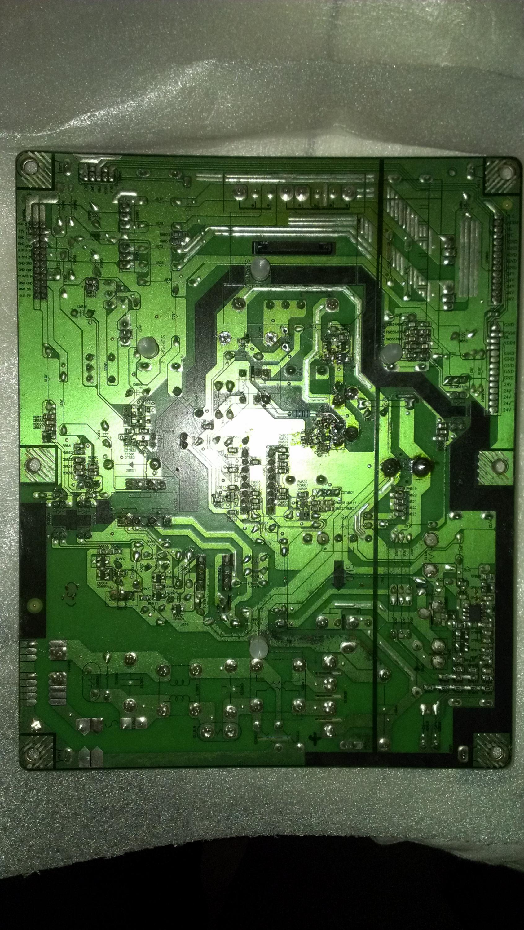

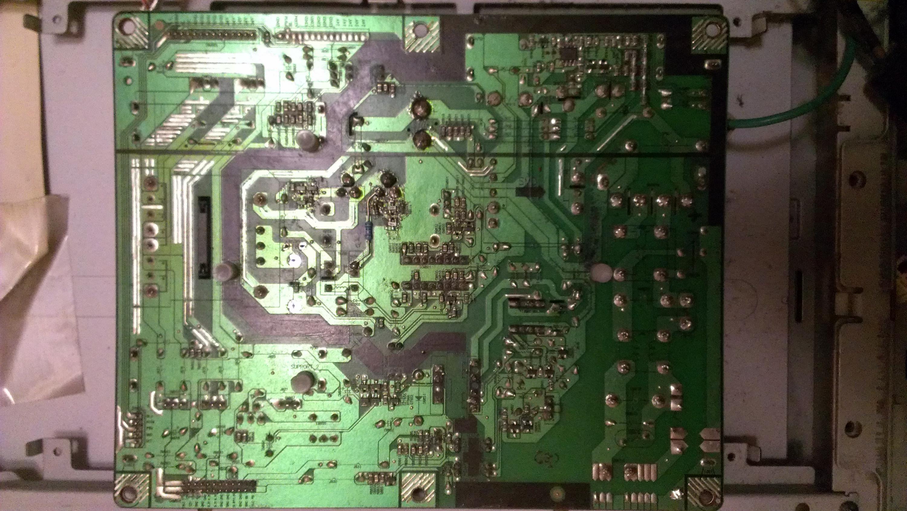

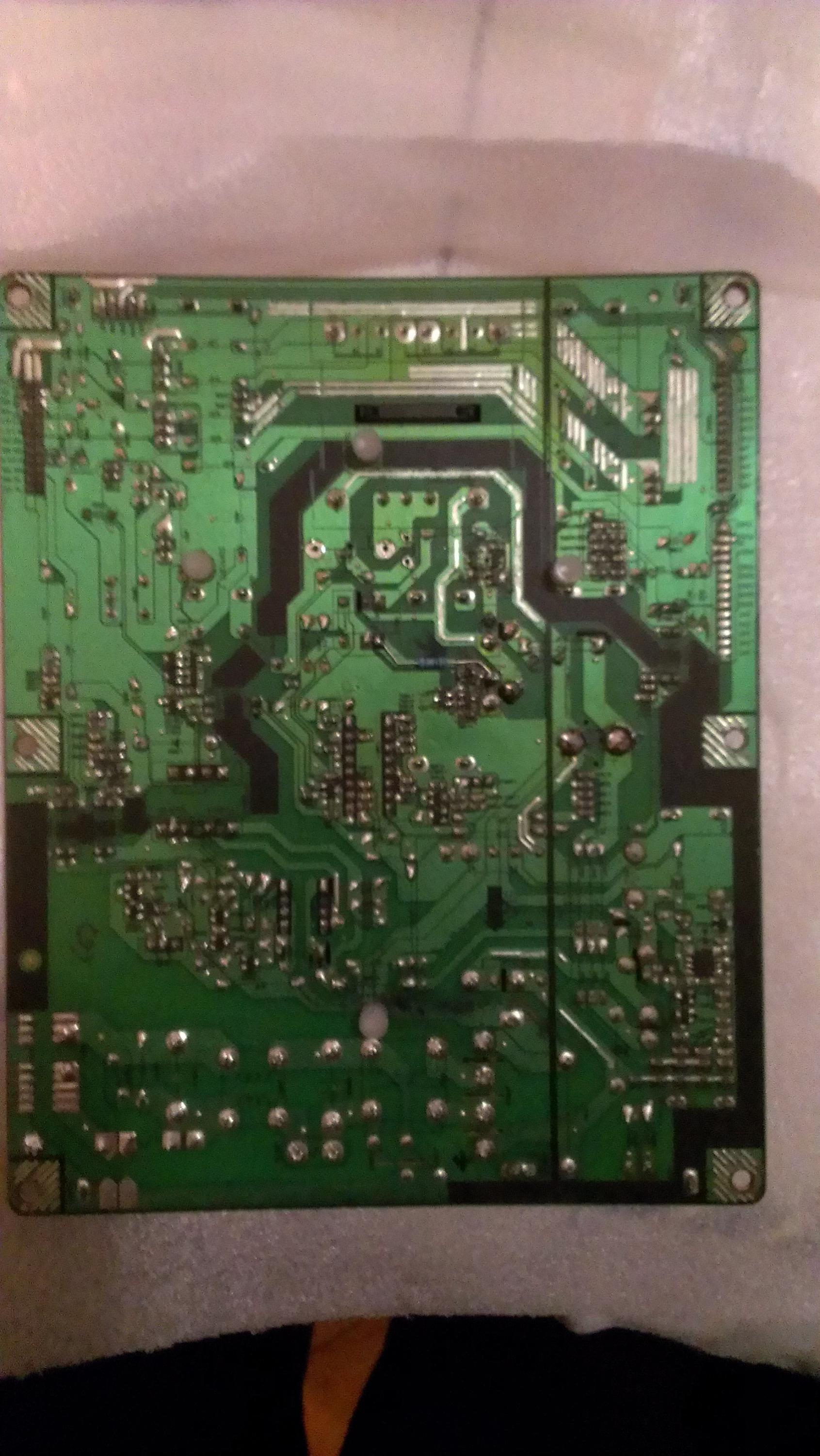

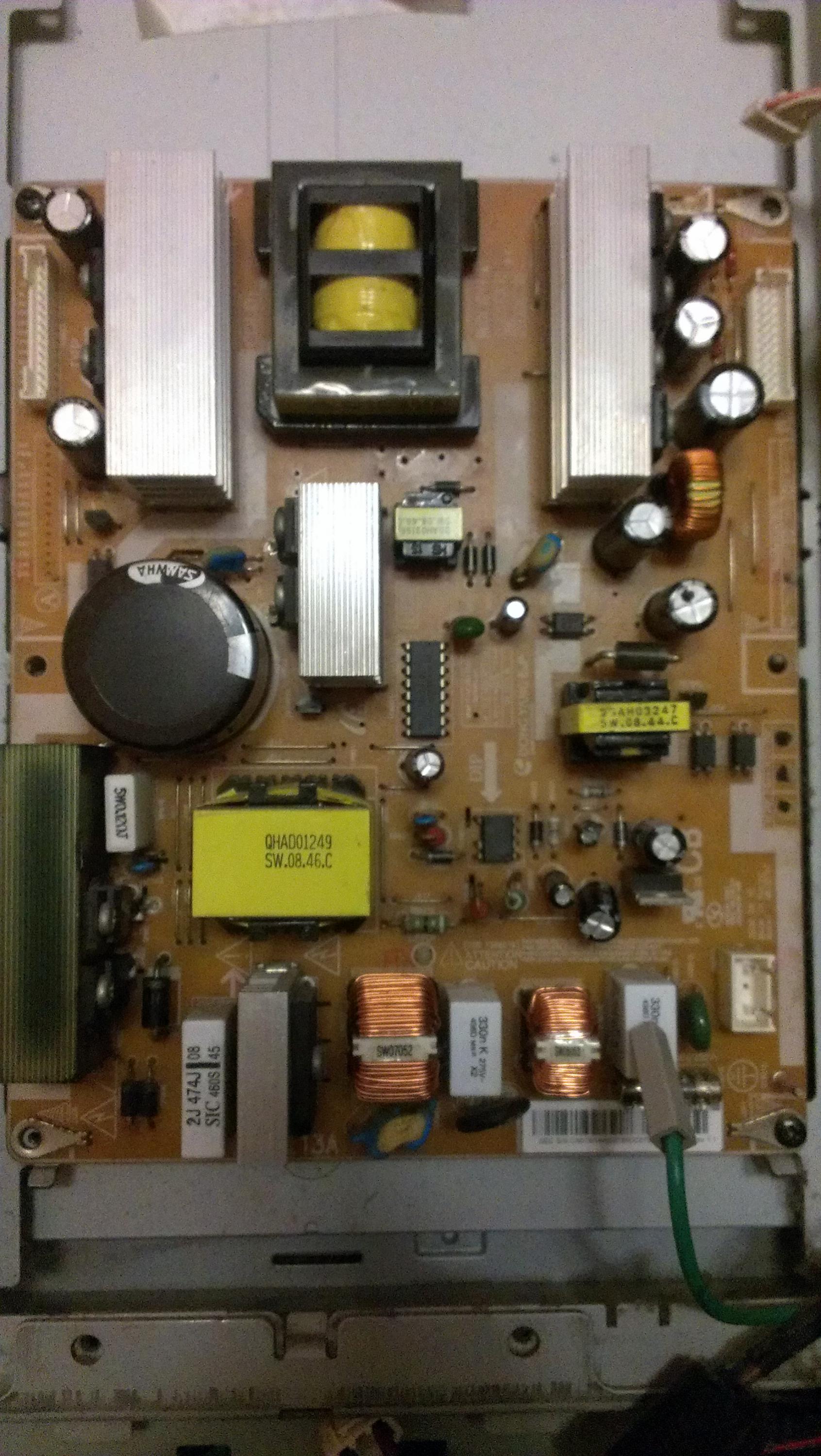

    HI,
    i got this tv some time ago.
    I saw 2 post regarding this power supply, but neither of them solved my probem .
    the Symptoms are:
    When tv is on standby (red light steady on);
    I press power button and it starts to blink red light 5 times;
    Then enters on standby again without turning on.
    Reading the posts found on this forum decided to "retouched " a bunch of solders, hoping that the problem was a dry solder joint - no luck.
    Unfortunatly doing that QM801 got dead, RM813 blew up, DM804 open, DZM805 and DZM806 dead , and fuse blown off course.
    Replaced all of them including QM802.
    Now when i connect the tv the red light goes on. But when i press the power button i start to ear a noise, after two or three blinks of the red light. Somethink like when u connect a small call with wrong polatiry similar to a squeeze noise and decide to disconnect the unit from the mains.
    As a last resource i removed CM809 and CM808 but ended up with a blown fuse.
    ps: i have also removed all the glue from all the caps.
    Could someone please help me?
    thanks in advance.

    Re: Samsung LE32A437 + BN44-00213A
    posting clear pictures of the boards of your tv may help you more with fixing your problem
                Why is it that QM801 blew and took everything out underneath QM802, jet leaving everything alone underneath QM801? What am I missing? The noise you are talking about is coming from where and sounds like what?
                Maybe use the light bulb trick in series with the AC input and try again. Also a variac would come handy in this case.
                  "Reading the posts found on this forum decided to "retouched " a bunch of solders, hoping that the problem was a dry solder joint - no luck.
                  Replaced all of them including QM802." That sounds like solder bridges something was not done right, those parts will be damaged if the Drain is shorted to Gate.
                  I would inspect the board closely, check and see if you do have boosted PFC Voltage (>360VDC). I would leave Q801, 802 out for now.
