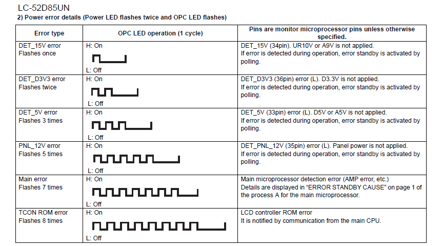

    Sharp Lc-52d85un
    Hi ! Merry Chistmas to you all and a happy new year ! I have a Sharp Lc-52d85un with both opc and power led flashing twice. I have bypass power test by pressing input and ch- while turning on tv, power led stays lit until I remove my fingers from buttons it will flash again twice. During this test the display will remain dark. remove all connectors except p9701 power supply to mail pwb both leds still flashes 2 times.
  • R_J
    • Jun 2012
    • 9556
    Re: Sharp Lc-52d85un
    This is from the manual
