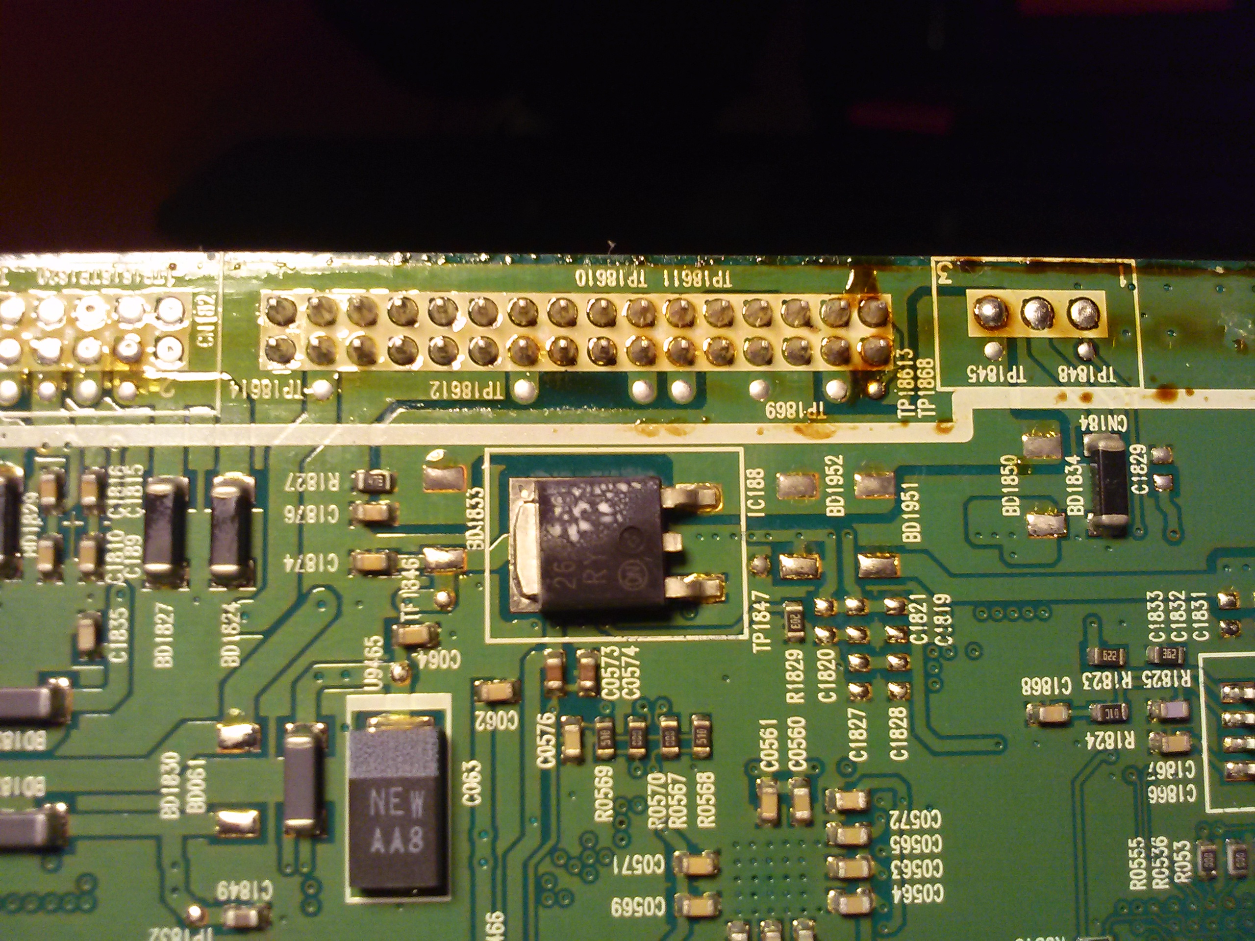

    Got it. Thanks for being so patient with me.
    here are my measurements:
    1. used as a ground while reading all the pins
    2-4. 0v
    5-10. 5.97v
    11-12. 0v
    13-14. 12.17v
    15-18. 0v
    19-22. 5.49v
    23-26. 0v
    27-30. 13.27v
    31-32. 0v
    Also noticed after a few minutes, TV will click off and one of the two LED's near the header I am measuring turns off. I then have to unplug the TV, plug it back in and use the power button to turn it on. If I unplug the power before it clicks off, the next time I plug it in, it will click on by itself without me pressing the power button.
    Still giving me 5 blinks from the power button LED.

        Ok, apologies, my probe must not have penetrated pin2 properly. Getting 4.231v from it. I tested all the other pins again to make sure I didnt miss anything. Going to test the voltages after the TV clicks off and CN801.
        LED that goes out is labeled OP182

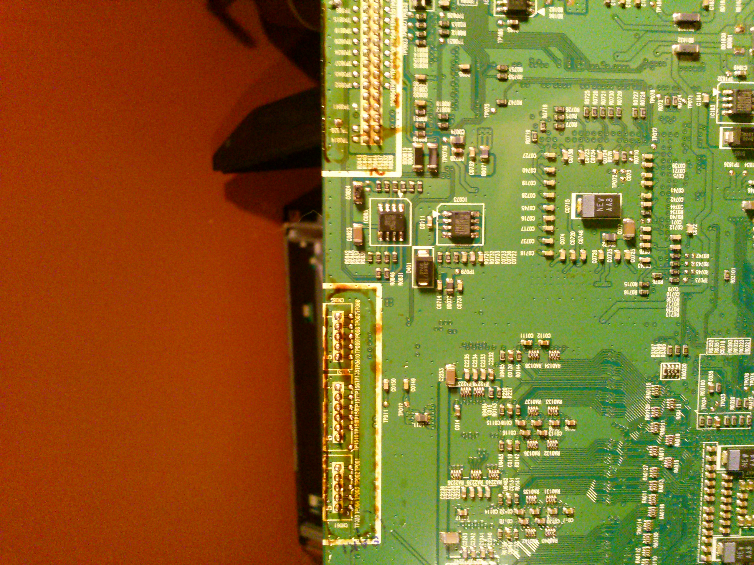

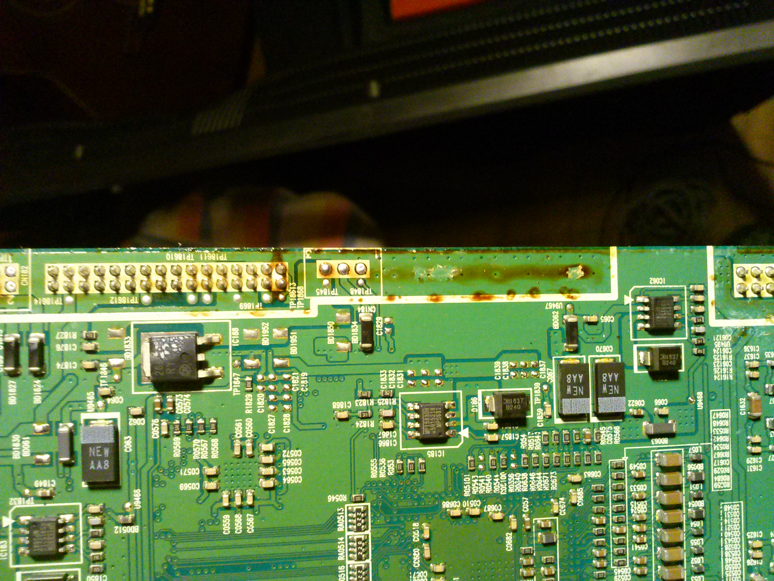

                  Well, I hate to say this but I should have removed the main board first and looked underneath of it. It appears that many areas underneath the main board or cooked. Please see attached pictures
                    #49
                    Re: Samsung LN-S4095D - Won't turn on; Power LED 5 blinks - I think I see a problem
                    That is flux... clean it off with alcohol, acetone etc and a brush. That board is not "cooked".
                      #50
                      Thanks. Was hard and "crispy" and scrapes off with my nail, still learning. Can you see the IC chip that has white marks on it in the pictures? Is that a problem?

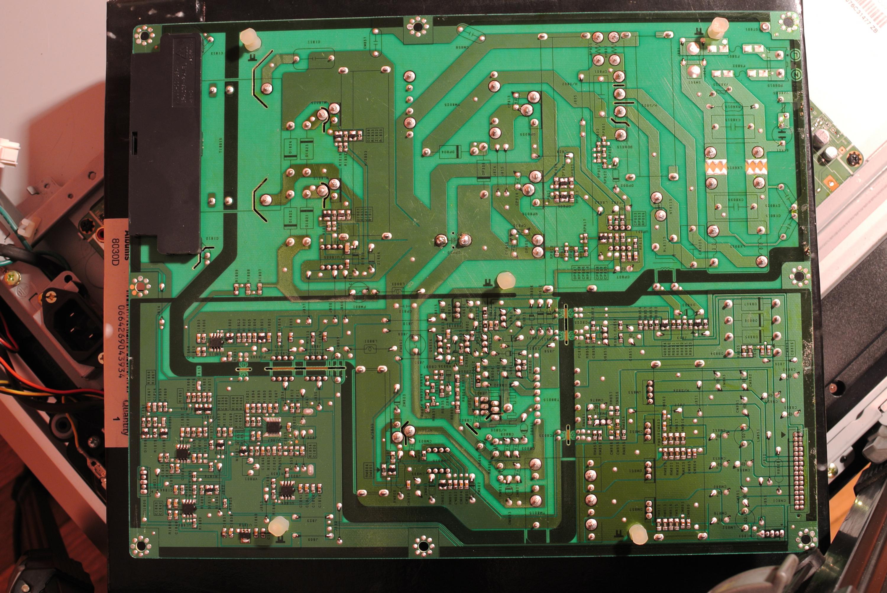

                                That cannot be right, did you hear the power relay RL811S click on?
                                Can I see the good clear pictures of the bottom side of the board?

                                        Good, how about good clear pictures of the bottom side of the board?
                                          #60
                                          Here ya go.
