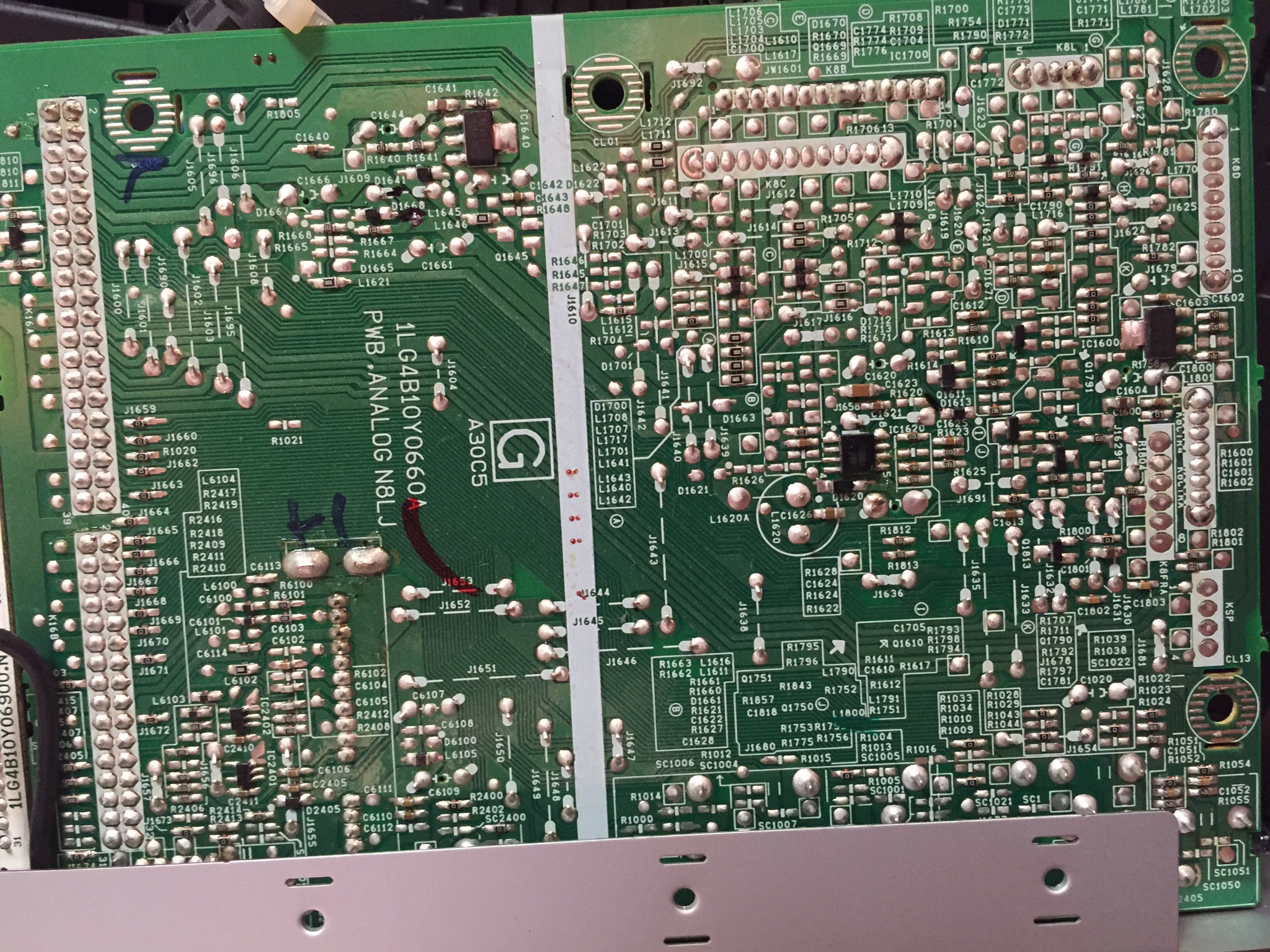

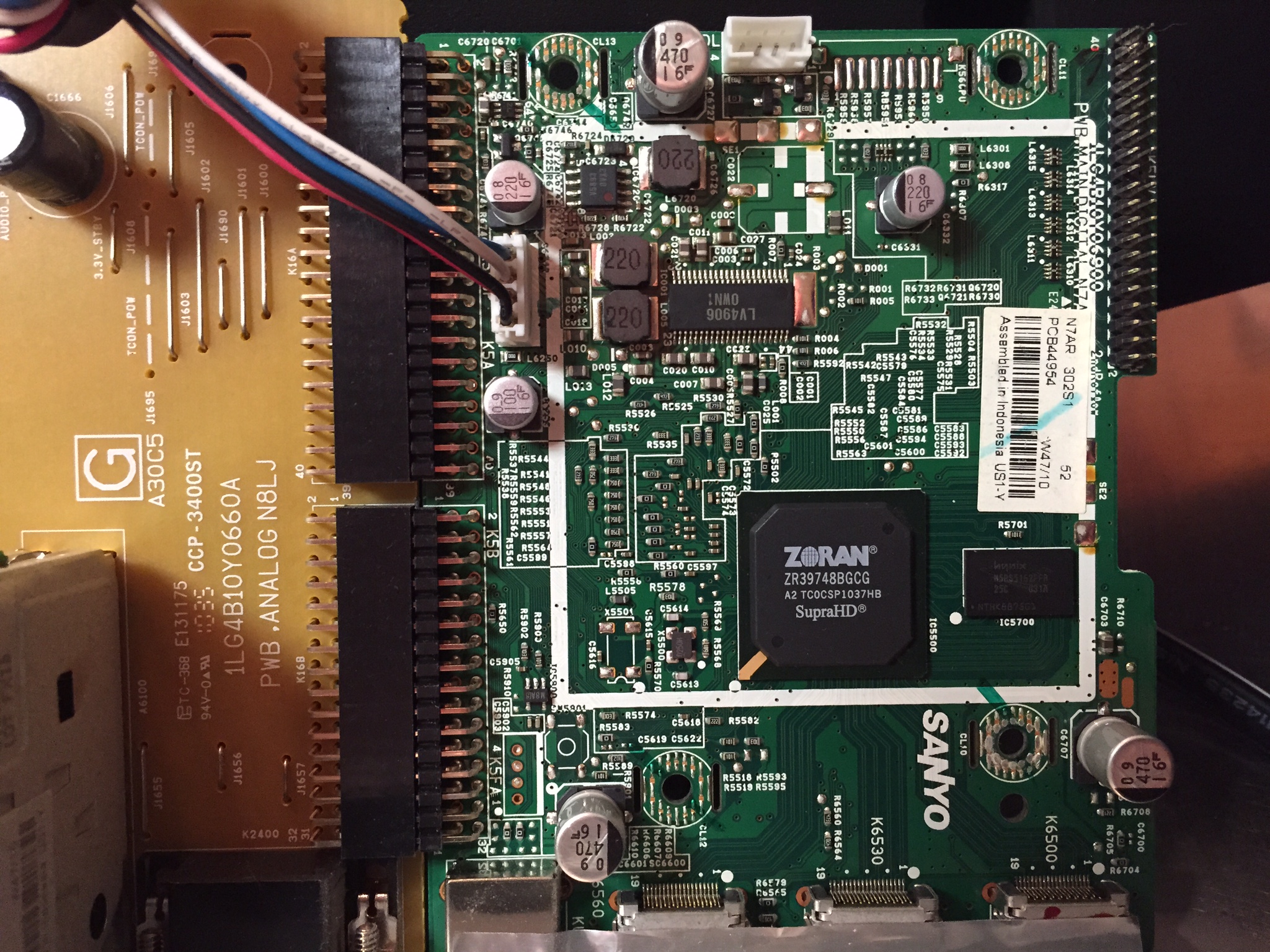

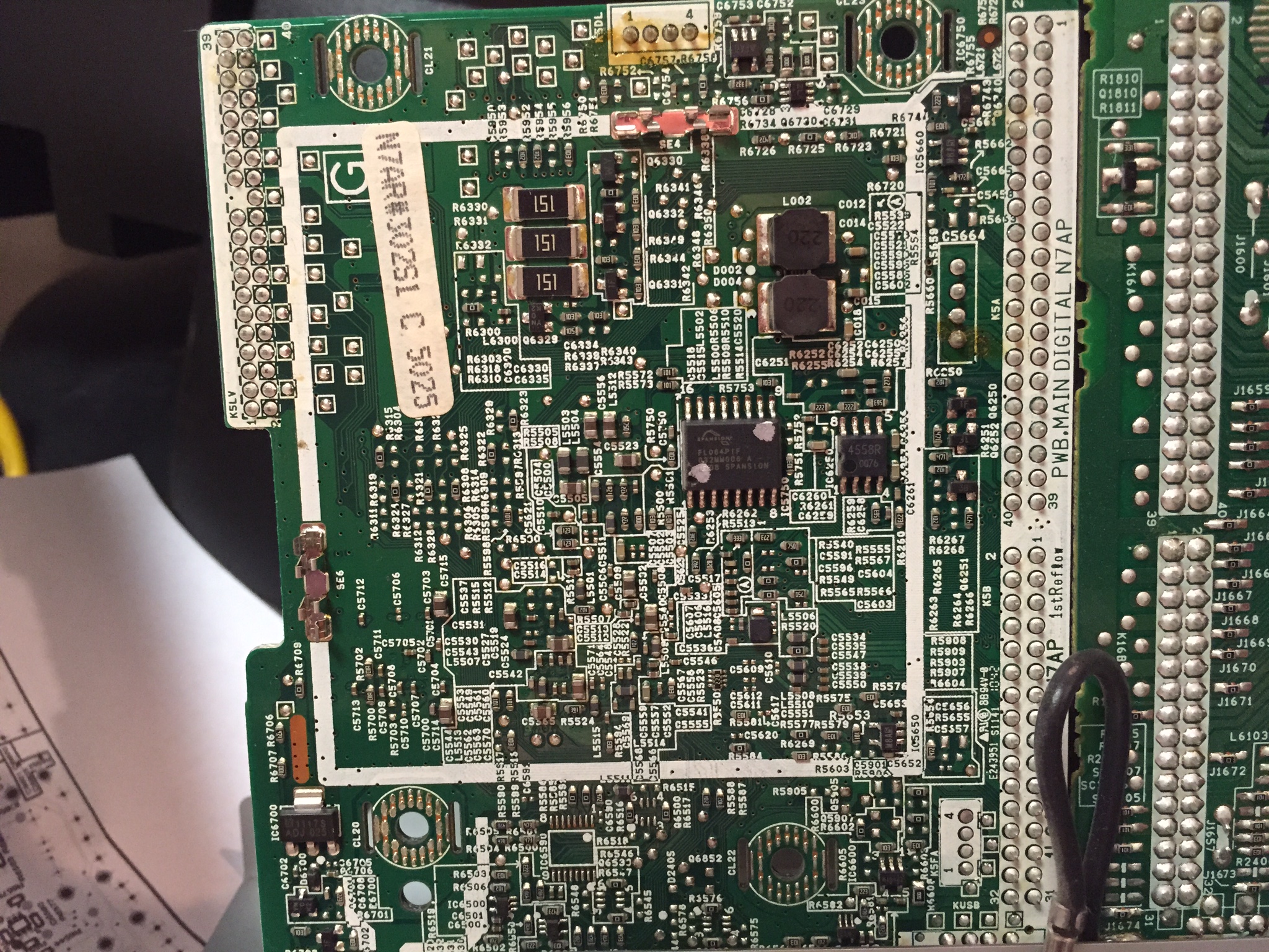

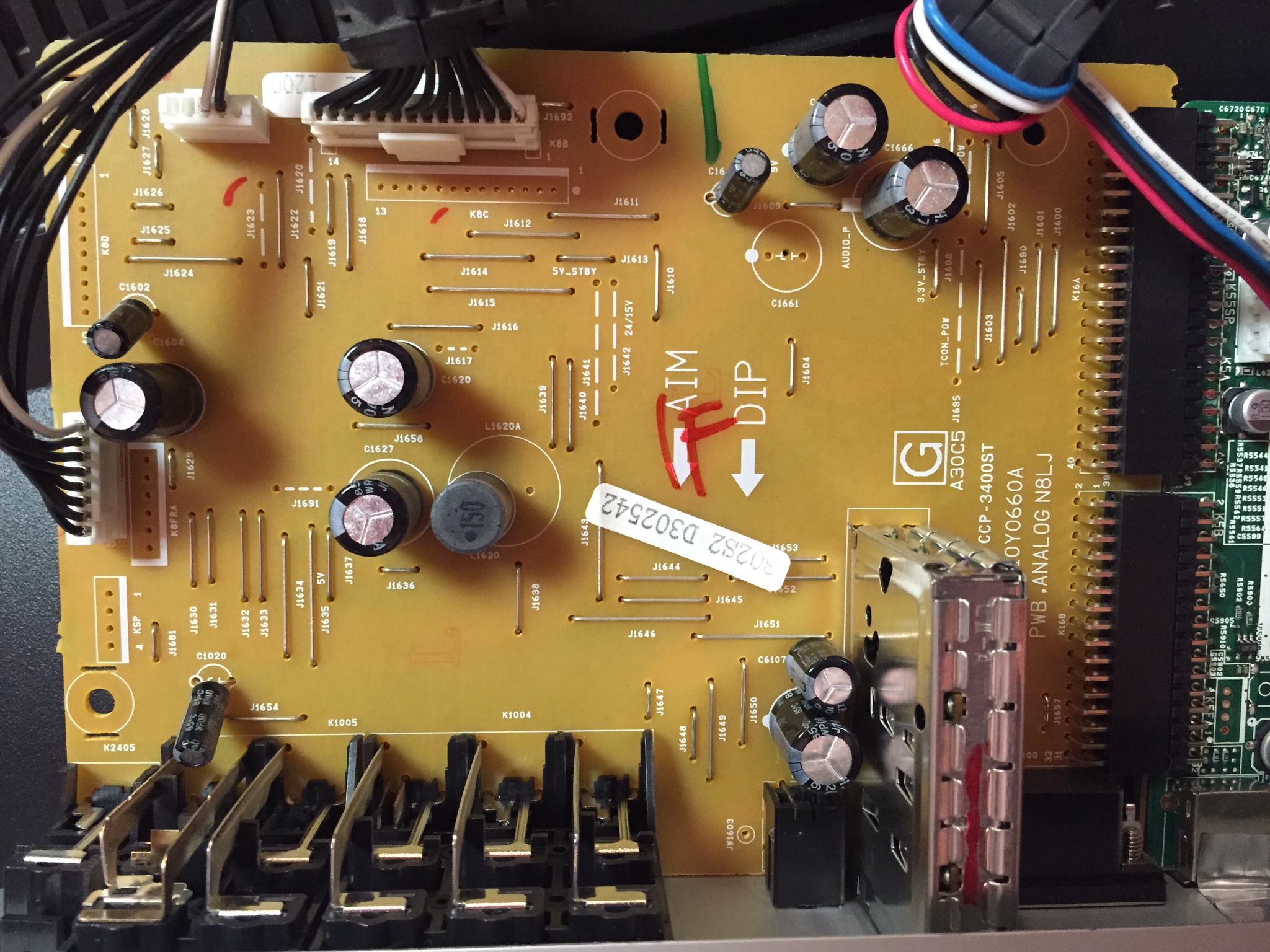

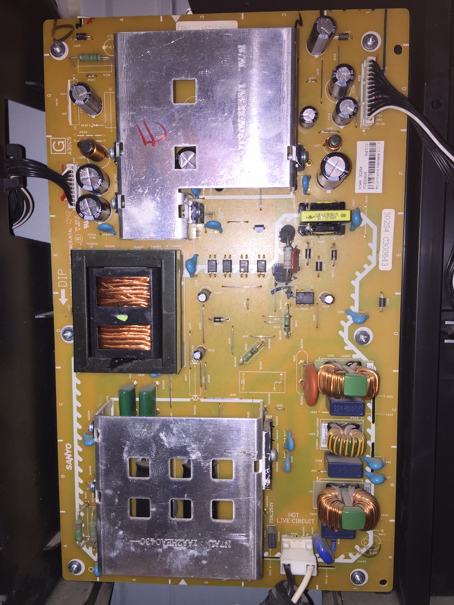

    Re: Sanyo DP42840 (P42840-06) No power
    Added board photo's

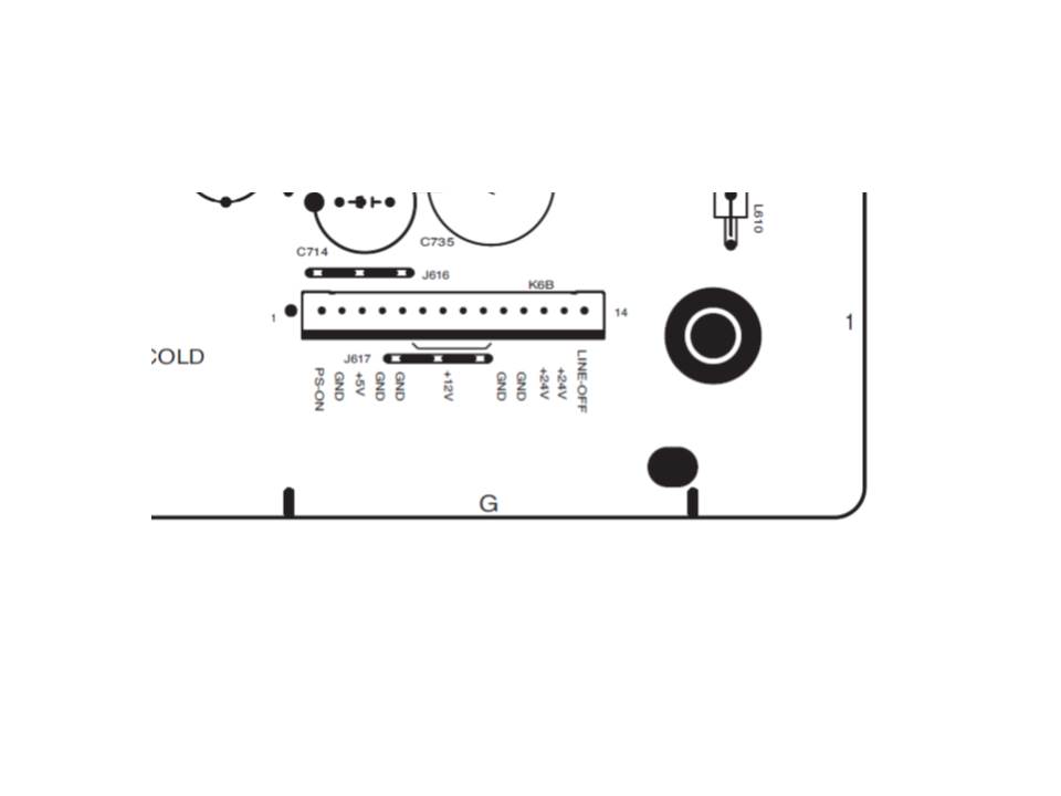

      Can you list the names of the pins at that connector as well, so we know which rails have voltage etc?
      Also upload the schematic if you can
        This excerpt is for the power supply side of the cable, so connections are sequentially reversed.

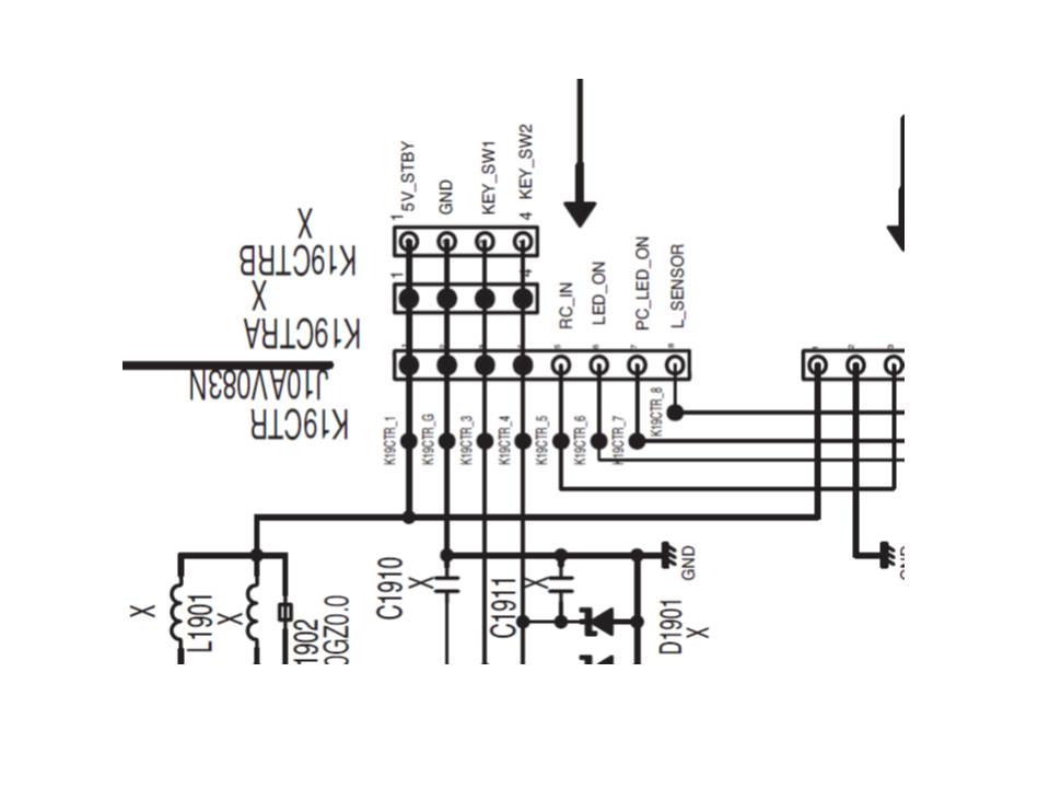

            Pin 4 is labelled as a ground - if it's rising to 3.21V there may be some serious problem. Is it connected to other ground pins or a separate one for some circuit?
            -David VanHorn
            • DaveB1972
              • Jun 2012
              • 10
              Pin 4 on the power supply line is indeed gnd. The pin 4 that is going to 3.21v is on the connector that returns to the switch.
              The included detail is of the schematic of the power board connector (at the power board) and I think it means the signal to pin 4 on the analog board is correct.
