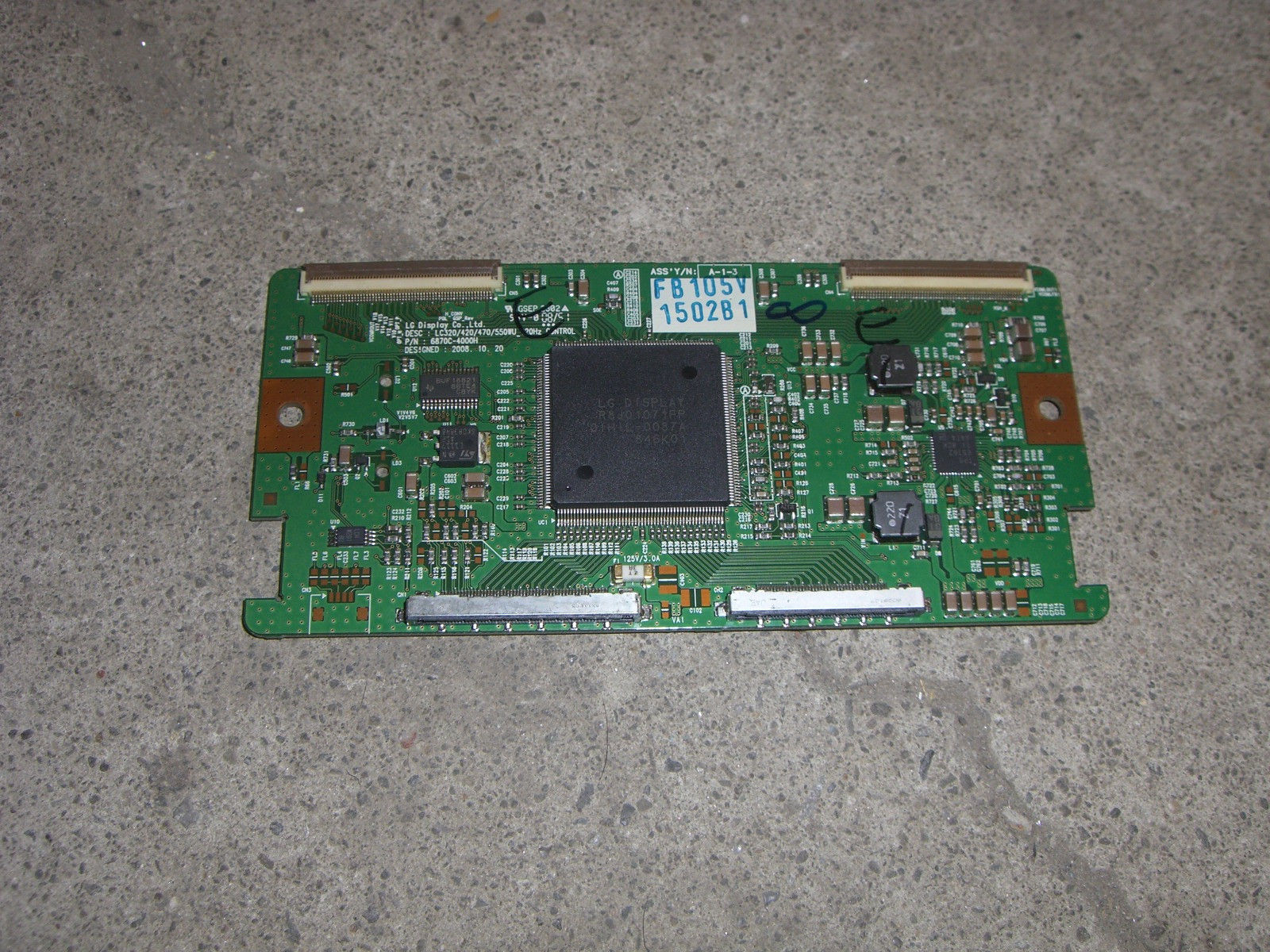

                                received tcon board today and installed it and no change still no display at all display just dark no picture or onscreen menu and backlight on and sound on
                                i then decided to experiment....i disconnected right tcon to panel ribbon cable and left the left side connected and power on tv....once i did that the left half of screen now had a display (on screen menu) and right side was now bright white with no display at all.
                                i did this with both new tcon and original tcon and same exact result
                                i then disconnected the left tcon to panel ribbon cable and conneced the right tcon to panel ribbon and result both sides were black although one side looked a little lighter than the other but both were dark no display
                                im not sure whats going on at all....any ideas?

                                  Re: philips lcd tv powers on ok backlight on sound on no display
                                  That means you have bad panel.
                                    thats not good....are you 100% sure?......no way it could be a main issue?
                                    i have no clue just asking....i know you know a lot but i just want to make sure before i tear tv apart for parts...

                                      It has the same problem as the LG I worked on awhile back, but my T-CON board was making the squealing sound and the switching power supply was getting hot due to shorted TFT driver IC on the panel.

                                        i saw your post...it does look like mine
                                        is there anything i can do to verify...using multimeter?

                                          here is a photo of board
                                          if you can show me test points that would be awesome
