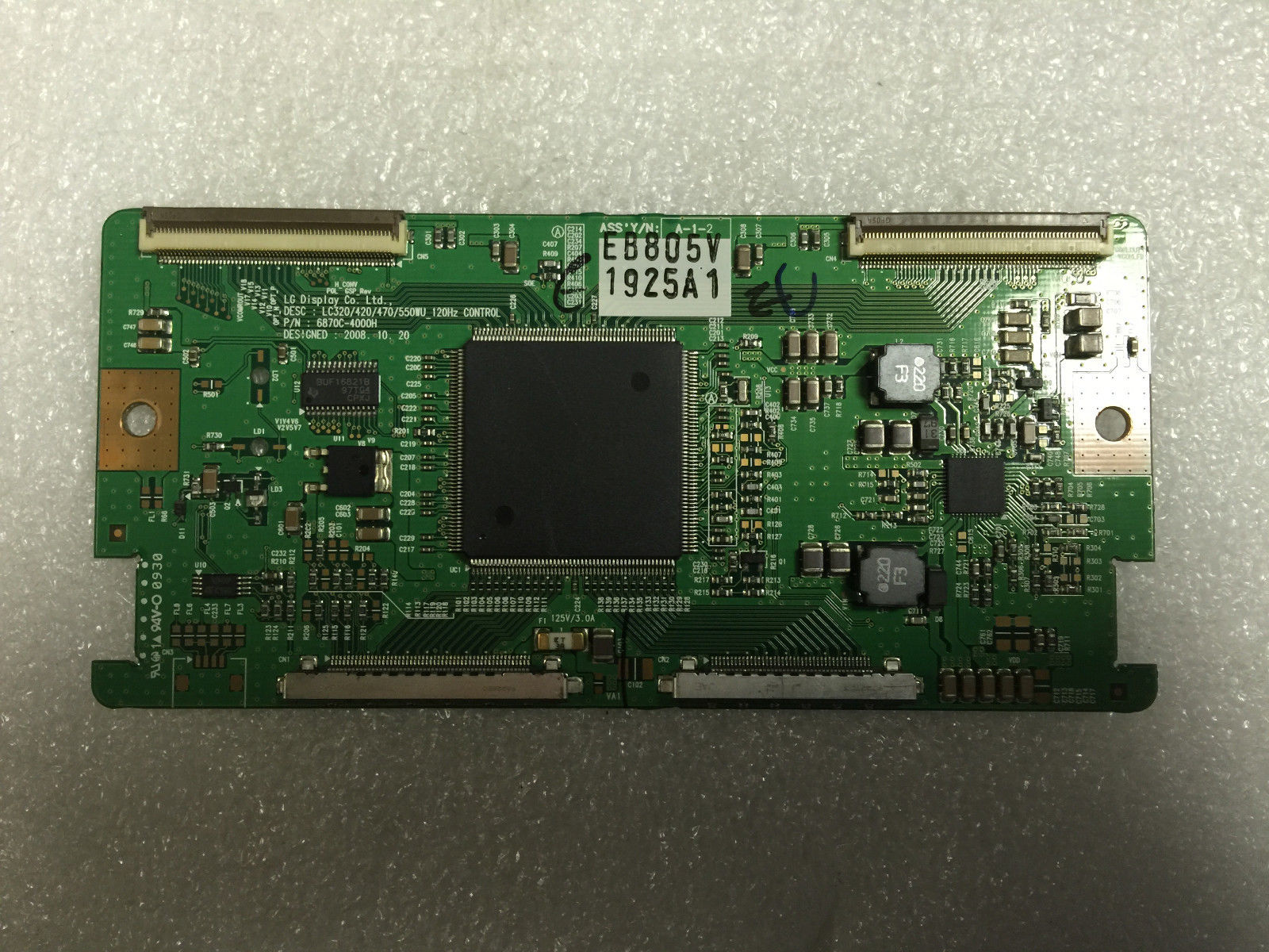

      Picture and the number of the T-CON board? There should be some Voltage test points on the T-CON that you can check.

        Re: philips lcd tv powers on ok backlight on sound on no display
        6871L-1925A
        see attached photo of board

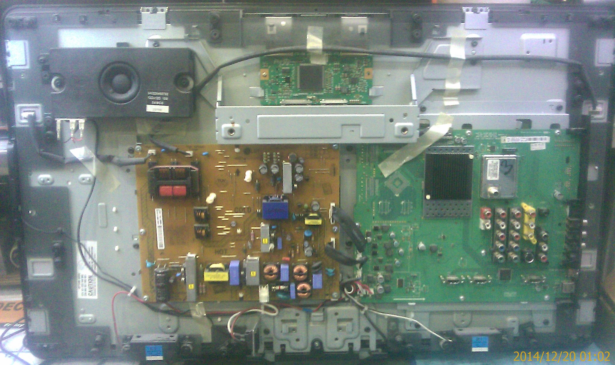

          This TV can do 120Hz, so is there another board (FRC) between the main board and this T-CON board?
          Can you upload the whole back side of the TV so we can see how all the boards are connected together?
          I also do not see '6871L-1925A' printed on the board.
          This one matches your board:
          http://www.shopjimmy.com/lg-philips-...-con-board.htm
          Looks like the FRC is done on the main board:
          http://www.shopjimmy.com/catalogsear...2PFL6704D%2FF7

            yes 120hz and no board in between main and tcon.........i will see if i can take a pic now..im at work with tv here....shop jimmy online video said if there is sound then typically its a tcon issue and not main
            is this somewhat true?

              LG t-con 120hz is processed on the mainboard.
                Yes and no since the video processor on the main can be bad. Something like this I would try a new T-CON.
                If you have scope then you can look at the LVDS signals and clock signals to see if they are present.

                  yes thats the tcon..same one as the photo i supplied....and this is a high end tv at its time...1080p 120hz subwoofer built in...very nice tv....600.00 when new....
                  here is a photo of back of tv.....i really want to fix it...its a very nice tv definitely not low end

                      here is the photo
                      any help would be appreciated.....i jsut want to find out how to know its tcon or main board with any testing thats not too involved all i have is a multimeter
