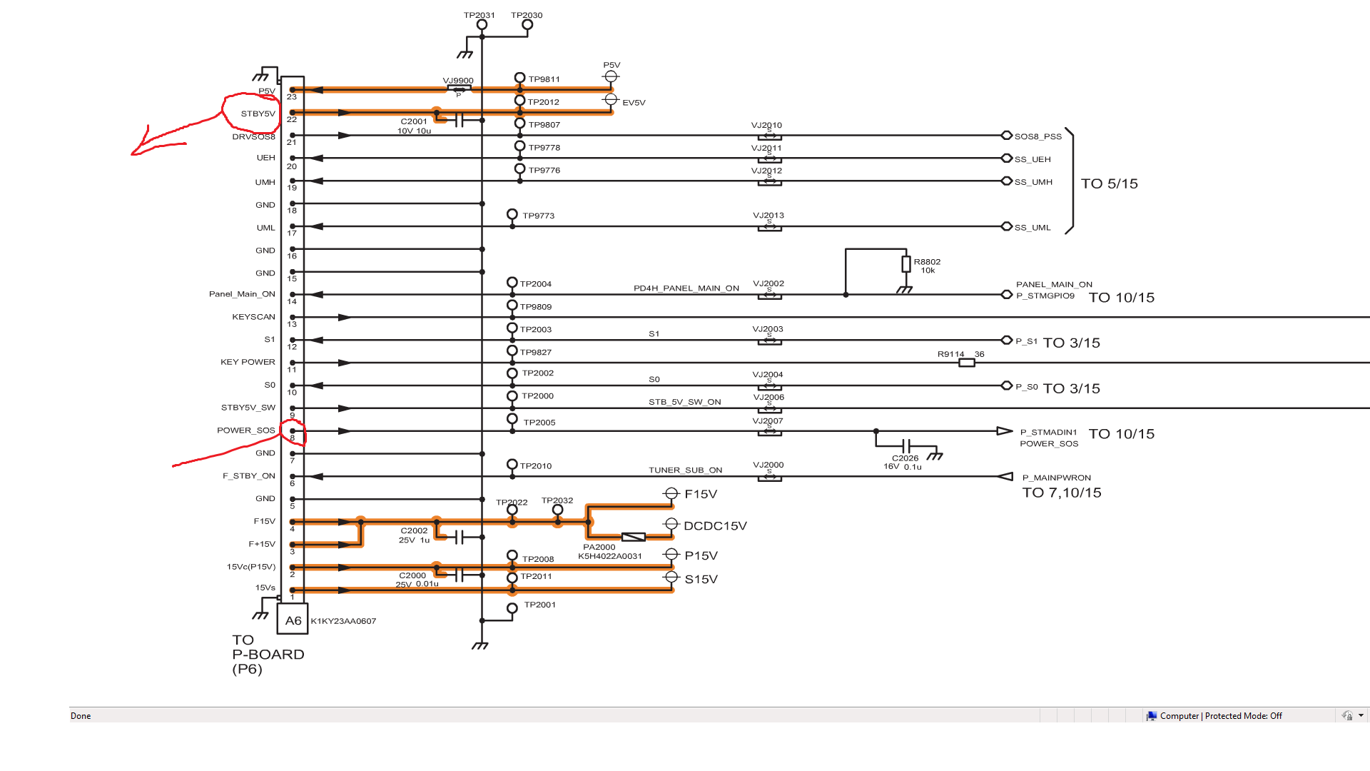

        Re: Panasonic TX-P50XT50B blinks 4 times red LED
        ok i bought service manual for this panasonic model.
        i attached photo of connector A6 which connect power board and main board, it does look from this schematic like Power SOS signal sends Power board to main board. on pin 8, which is Power SOS voltage, I have 3v(2.96). I think if power board sends SOS signal means it is damaged, am I right ? please confirm this.
          https://picasaweb.google.com/lh/phot...eat=directlink
          if you upload pics. right here, its a lot better, I clicked your picasa link, they want me to sign in to google etc, if you upload directly here, its faster and easier for us to see them.
            Here is a photo
