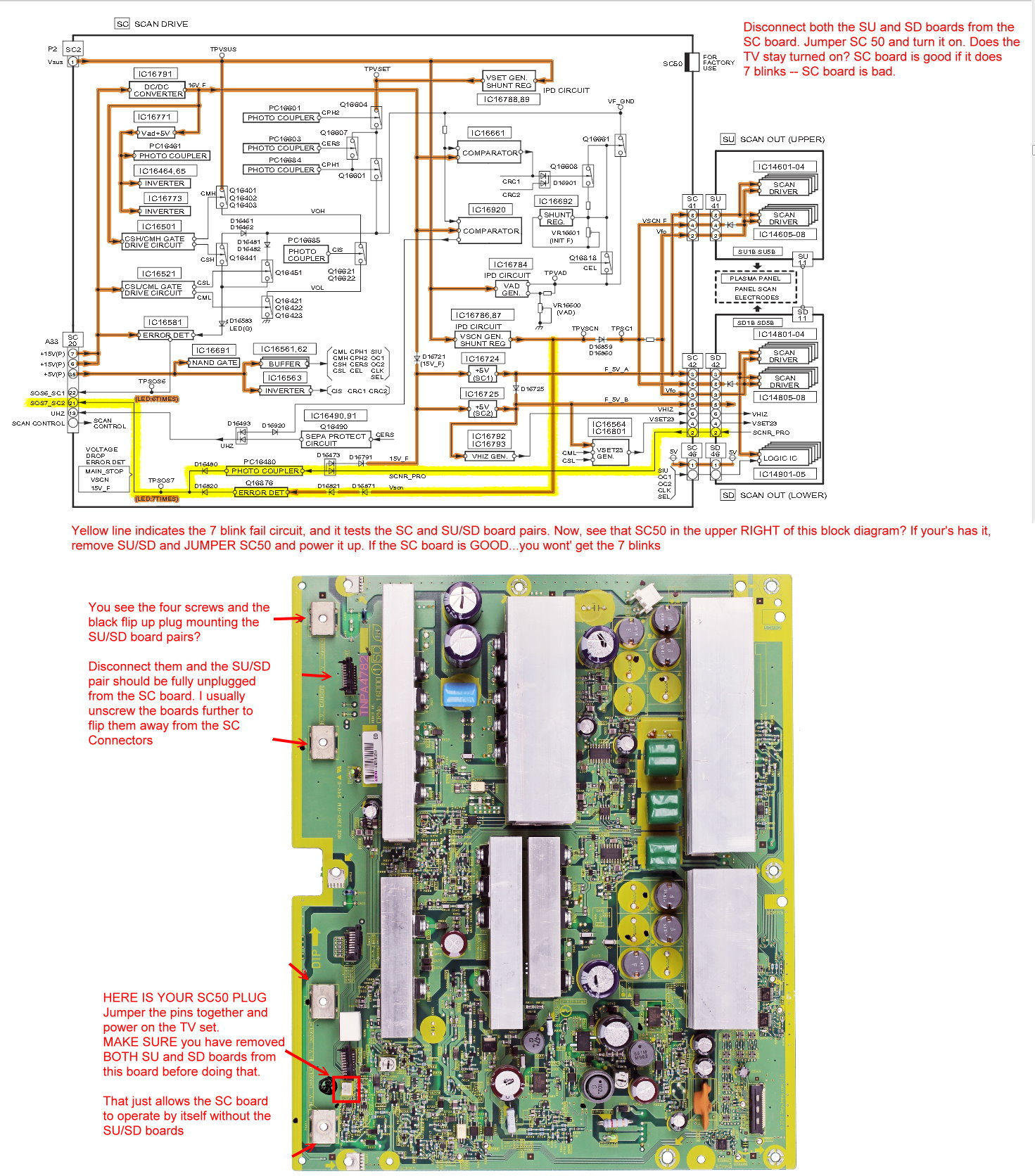

                  6 blinks --> DRIVER SOS1 , SC ENERGY RECOVERING CIRCUIT and the manual points to SD/SU or SC board.
                  Thats the board on the left hand side. Check if you have a SC50 jumper on the SC board , if so then use a harddisk jumper and remove/isolate the buffer boards from the sc board and turn on the tv. If the TV turns on you probably have bad buffer boards.
                  If you get 7 blinks then the SC board is bad.
                  • Moreno83

                    Re: Panasonic th-p42x10z
                    Here you will see the SC50 jumper ( If you have one )
