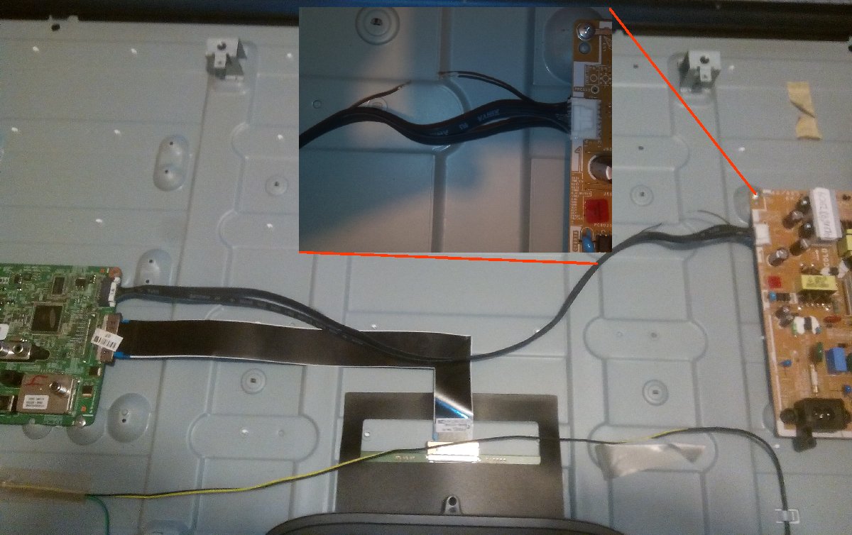

    I have a nice UN46EH6000 that I have tried 3 different power boards on. All three produce the same response.
    When plugged in, I hear the SAMSUNG tones, but absolutely no light on the screen at all..
    On the power button (a PS3 style thumb button) a red LED blinks 6 times..
    I was going to tear down the unit to the bare bulbs and see if the problem lies there but before I do, I wanted to see if those Error Code Blinks mean anything else.. GOOGLE was no help..
    Also, on the cable between the power board and the video board, there is a trace that had been factory cut...
    Any hints would be appreciated...
    Re: Samsung UN46EH6000 LED ERROR Codes
    They mean nothing. It is not an error code.
    Most likely open circuit LED strip, or short circuit LED to chassis.
    That will cause a Samsung to cycle the power or fail to boot.
    I don't think that's a factory cut.......
      Yea, that turned out to be the problem with a previously mentioned Westinghouse I worked on..
      OK, disassembly it is...
      Well, it WAS until I spliced it to see if that was my problem..
      Yea, probably not the smartest move, I realize...
      Thanx for the response...

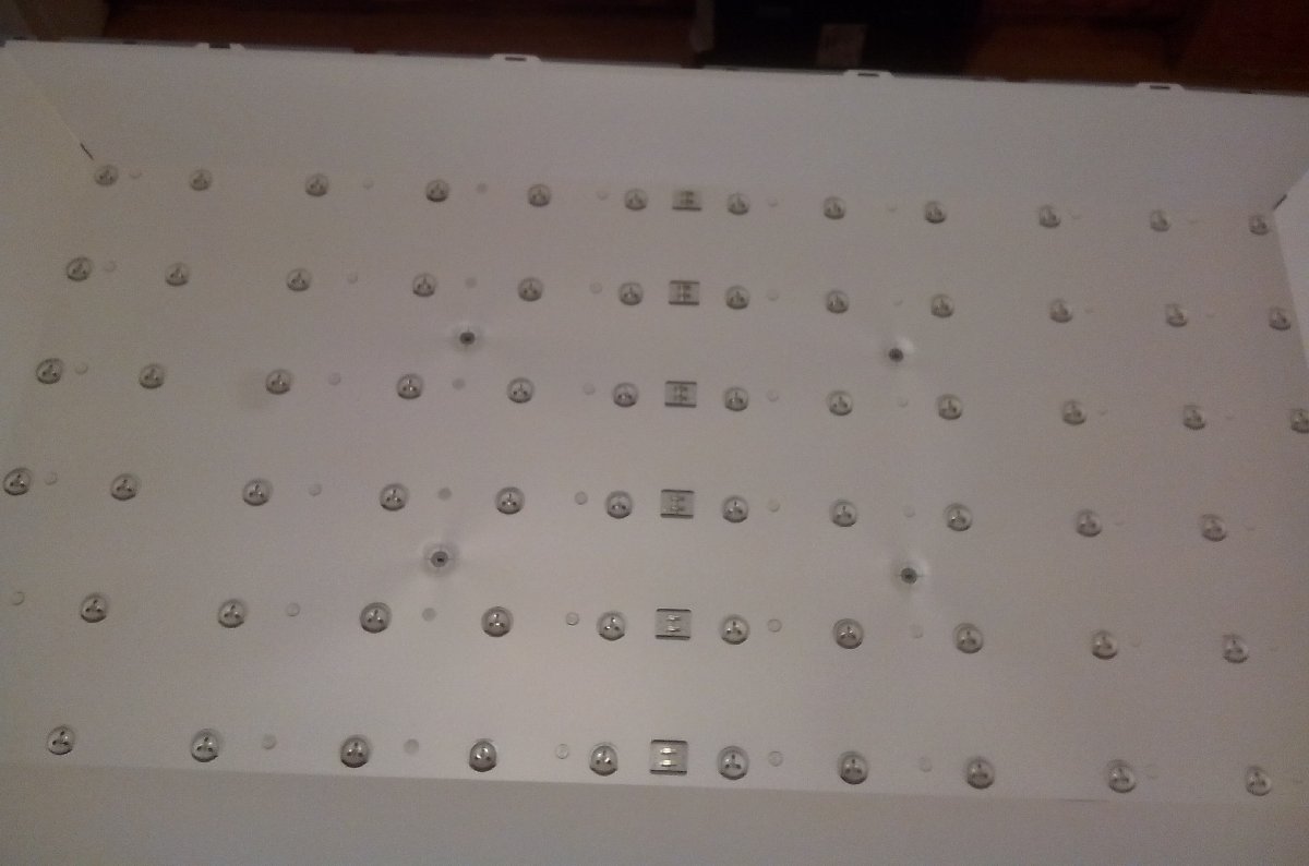

        OK, got the unit disassembled down to the bare LEDs
        Interesting arrangement.. Looks like a padded room I have been in once or twice.

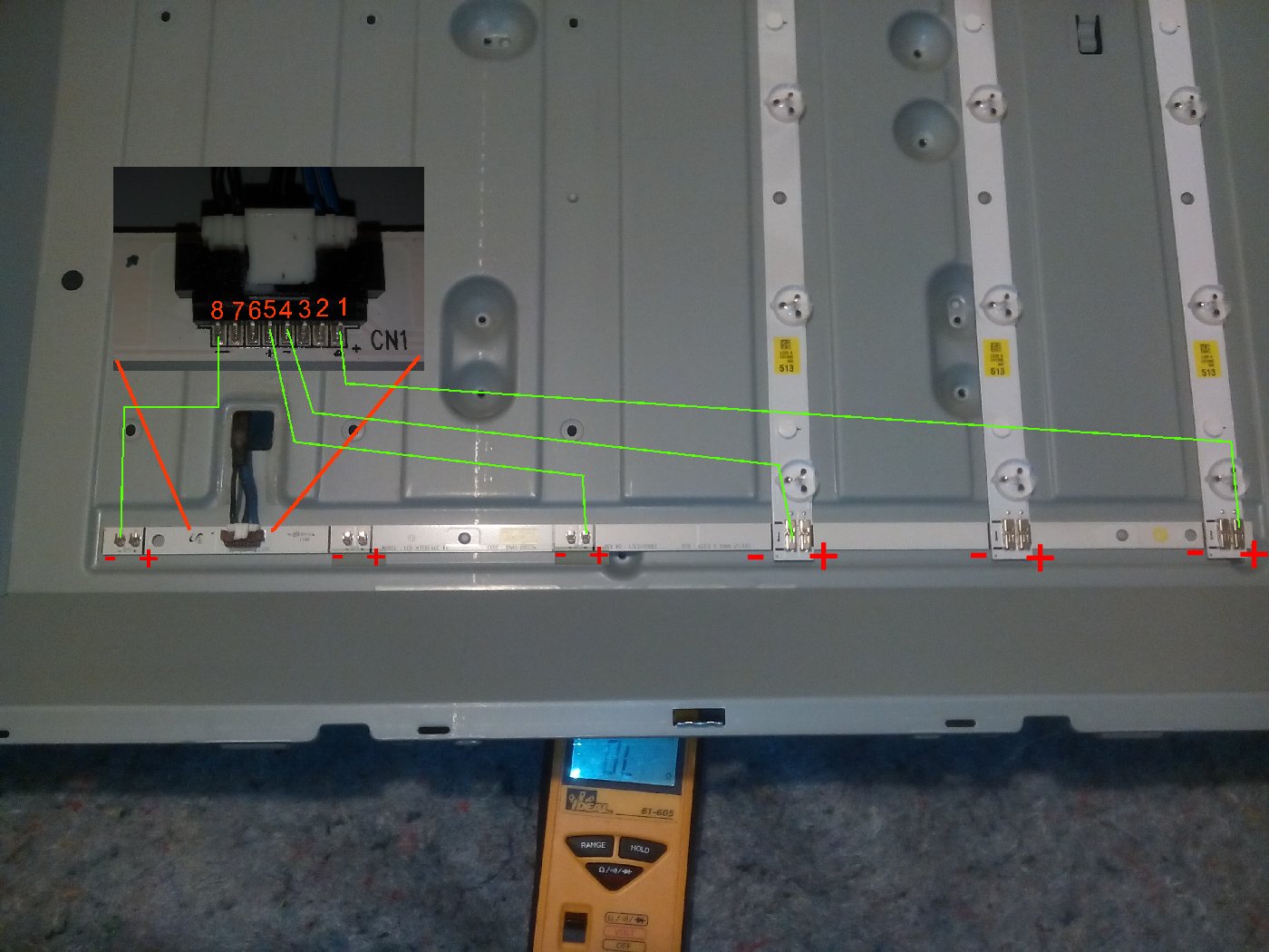

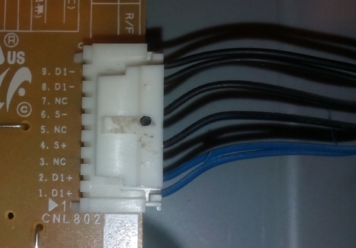

              Attached is the other side of the connector shown in the post above...
              • Michale32086
                • Nov 2011
                • 1453
                As the saying goes, "Curiouser and Curiouser..."
                I took out all of the light strips shown in post #4... Powered up and still got the same result. 6 blinks on the power LED...
                So, I tried something I probably should have done BEFORE I disassembled this unit down to bare tacks...
                I pulled the connector (Post #7) that goes from the power board to the LED strips shown in post #6...
                Plugged in and still the same 6 LED blinks..
                Which leads me to believe that the short is NOT in the LED strips....
                The only other possible culprit is the video board...
                But that doesn't make much sense...
                Does it??

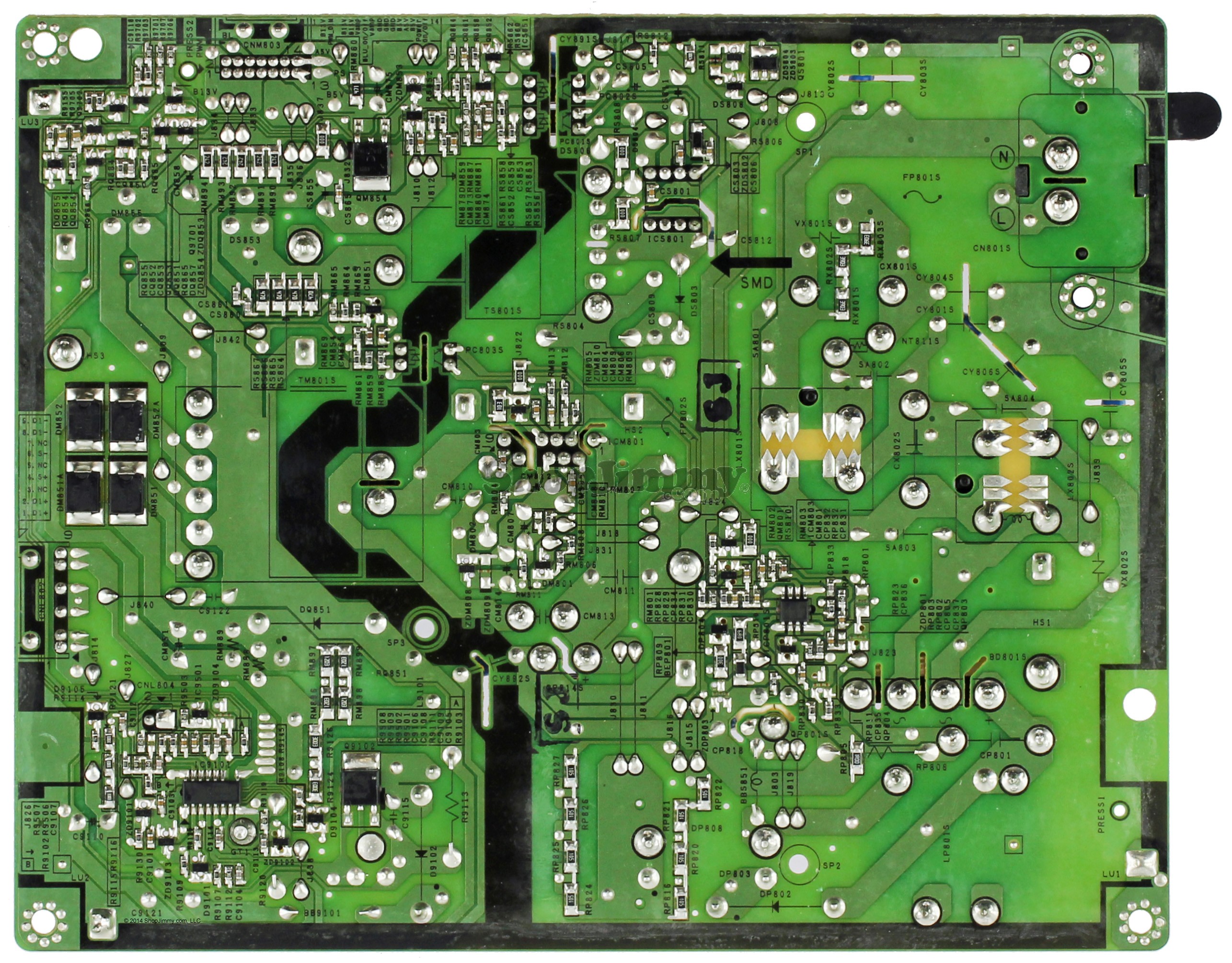

                  What DC Voltages do you get on the connector CNM803 pins when TV is OFF and when power switch is activated? There are label for each pin.
                  http://assets.shopjimmy.com/media/ca...498a-top_1.jpg
                  Also if you disconnect the CNM803 and then plug the TV into the outlet, do you get backlights?
                          Originally posted by Michale32086
                          1- 12.8v
                          2- 3.1v
                          3- 12.8v
                          4- 12.8v
                          5- 12.8v
                          6- 2.9v
                          7- 12.8v
                          8- 0
                          9- 0
                          10- 0
                          11- 5.3v
                          12- 5.2v
                          13- 5.3v
                          14- 3.2v
                          Plugged in, power switch activated makes no difference... From the tones I am assuming that the TV is activated once it's plugged in..
                          Nope... Dead as a doornail...
                          Can you please put the pin labels next to the readings?

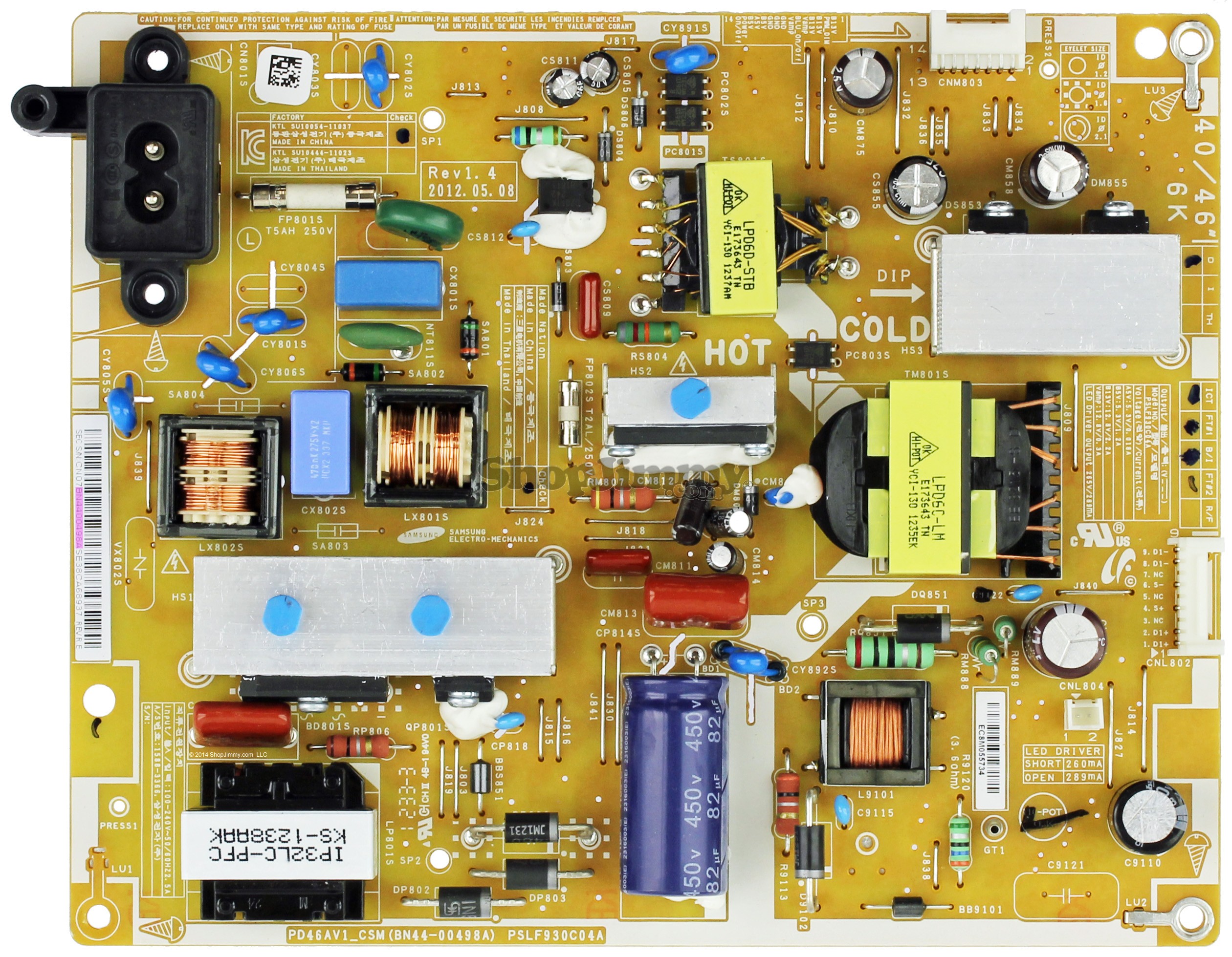

                            OK, I look at the picture myself:
                            Pin 6 = BL ON/OFF = 2.9V = OK, it should be <1V when TV is turned OFF.
                            Pin 14 = PWR ON/OFF = 3.2V = OK, it should be <1V when TV is turned OFF.
                            So the main board is sending out correct signal to turn on the power supply and the backlights circuits.
                            The problem is on the power supply board some where, the backlights should at least flash on for a second for the error detection circuit to detect any fault before going into shutdown.
                            What DC Voltage do you get at THE TWO LEGS of the main filter cap (82uf 450Vdc) when power switch is activated?
                            Pictures are provided by SHOPJIMMY.
