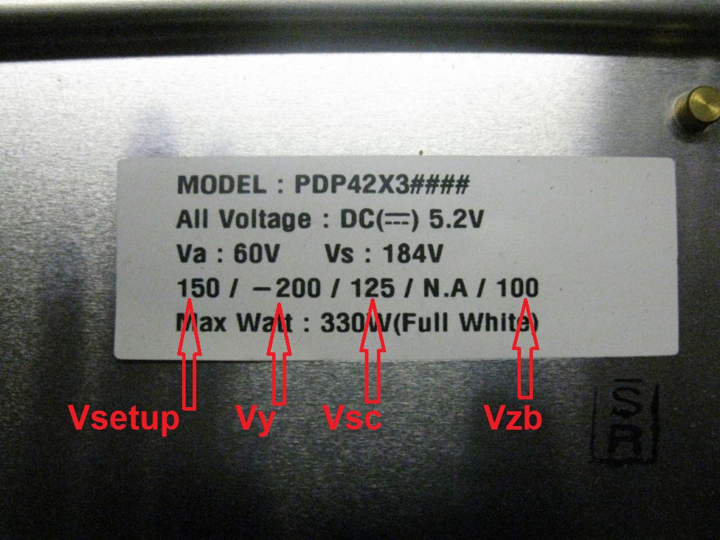

            Re: Plasma LG 42PC3RA led blinking
            hello
            i have make some test today
            here some measure
            Vy 6v
            Vsc-125 V
            Vzbias 100 v
            on my tv
            this is not picture of my tv
            but only Vsetup is N.A
            it's ok Vy is not good
            any idea
            thank for your help
              Ok and Vs and Va are good ?
              • steph06000
                • Sep 2015
                • 21
                • france
                hello
                184 for Vs 60 for Va
                with or without cards plugged
                correct voltage
                  Ok Vy isnt correct, in a dark room does the screen glow at all ?

                      #30
                      Hmm well Vy isnt correct, thats generated by Ysus reading up now a bad Ymain Ipm can cause no Vy.

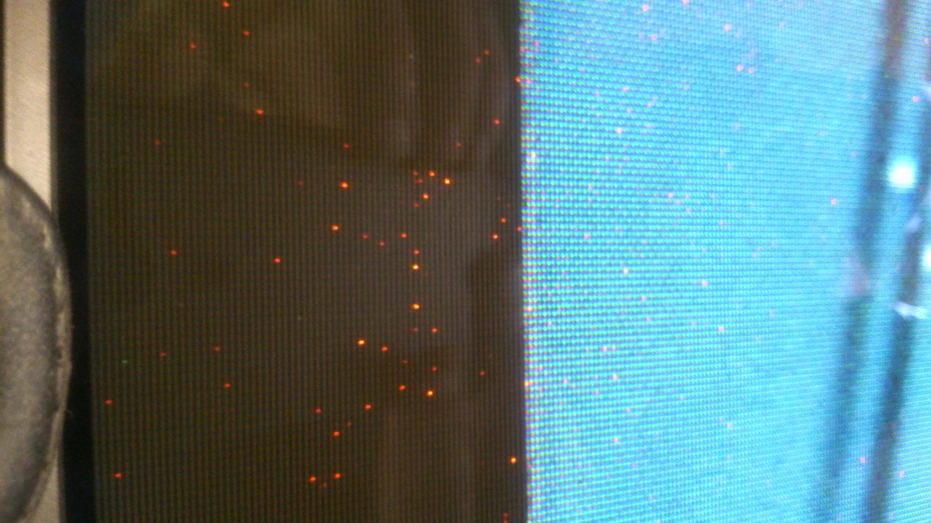

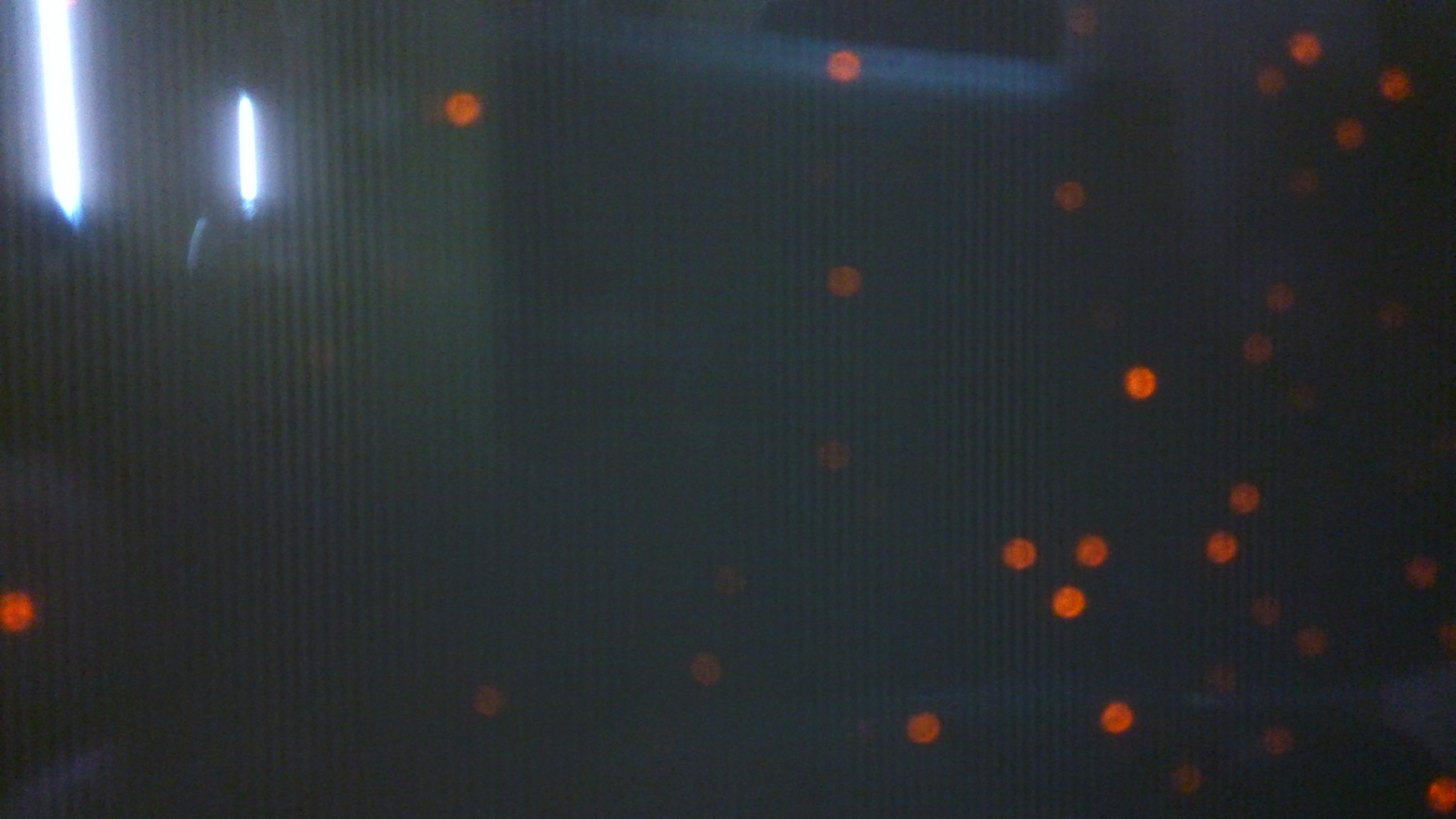

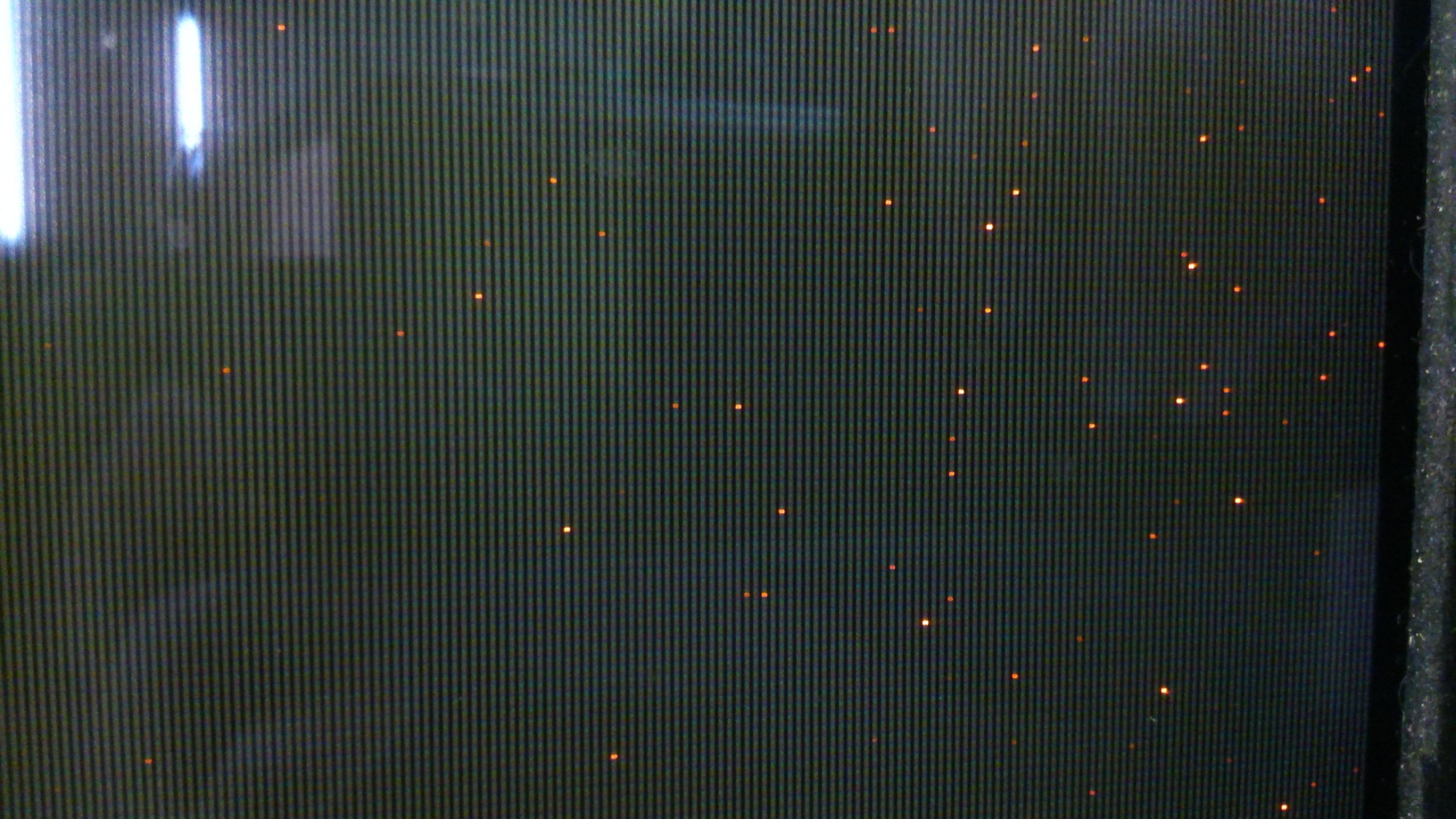

                                    #37
                                    hello
                                    good news
                                    mmartell : respect !! y-sus fault !!
                                    picture is back on my tv
                                    but not perfect
                                    i have red snow on black picture
                                    any idea ?
                                    thank for your help ReeceyBurger123 and mmartell
                                    • ReeceyBurger123
                                      Never Give Up !
                                      • May 2014
                                      • 7325
                                      • Britain
                                      #38
                                      Nice one Red snow ehy how bad can you take a picture Steph ?

                                        #39
                                        hello
                                        here some picture
                                        • ReeceyBurger123
                                          Never Give Up !
                                          • May 2014
                                          • 7325
                                          • Britain
                                          #40
                                          Not a Zsus issue, have you tried adjusting the Panel voltages ? Also you might need to update the firmware on the control board.
