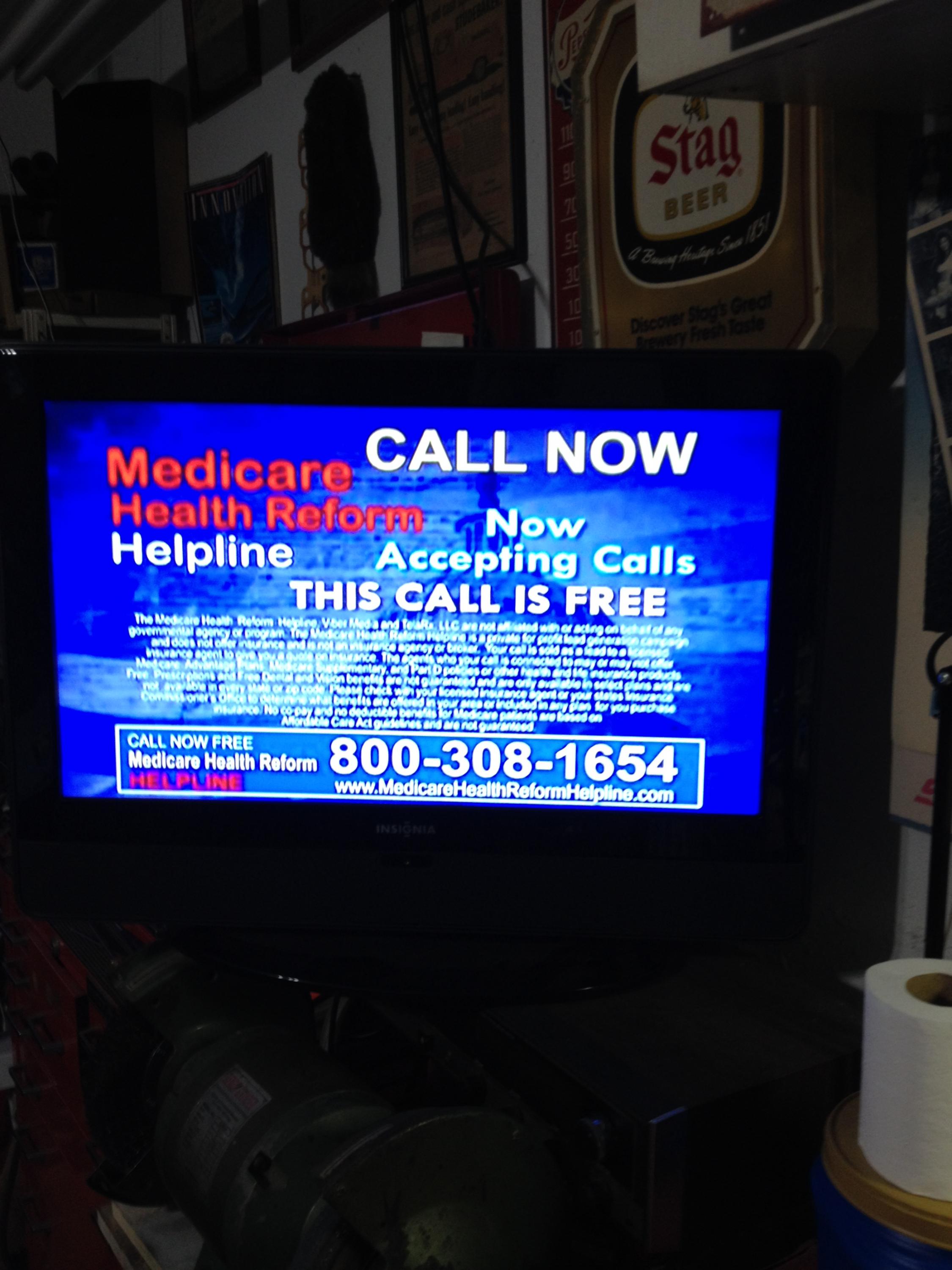

    Just picked up this set from an individual off craigslist for $5.00 with remote and manual. Got it home and would power up for a few minutes and then go dead. Pulled off back cover and saw two 1000mfd/10v domed caps. Esr was high so I pulled them and they only read 13 to 14 mfd. They were Capxon. Had some new caps on hand and replaced them. Got a decent older LCD with DVD for grandson now. Yeah Buddy!
