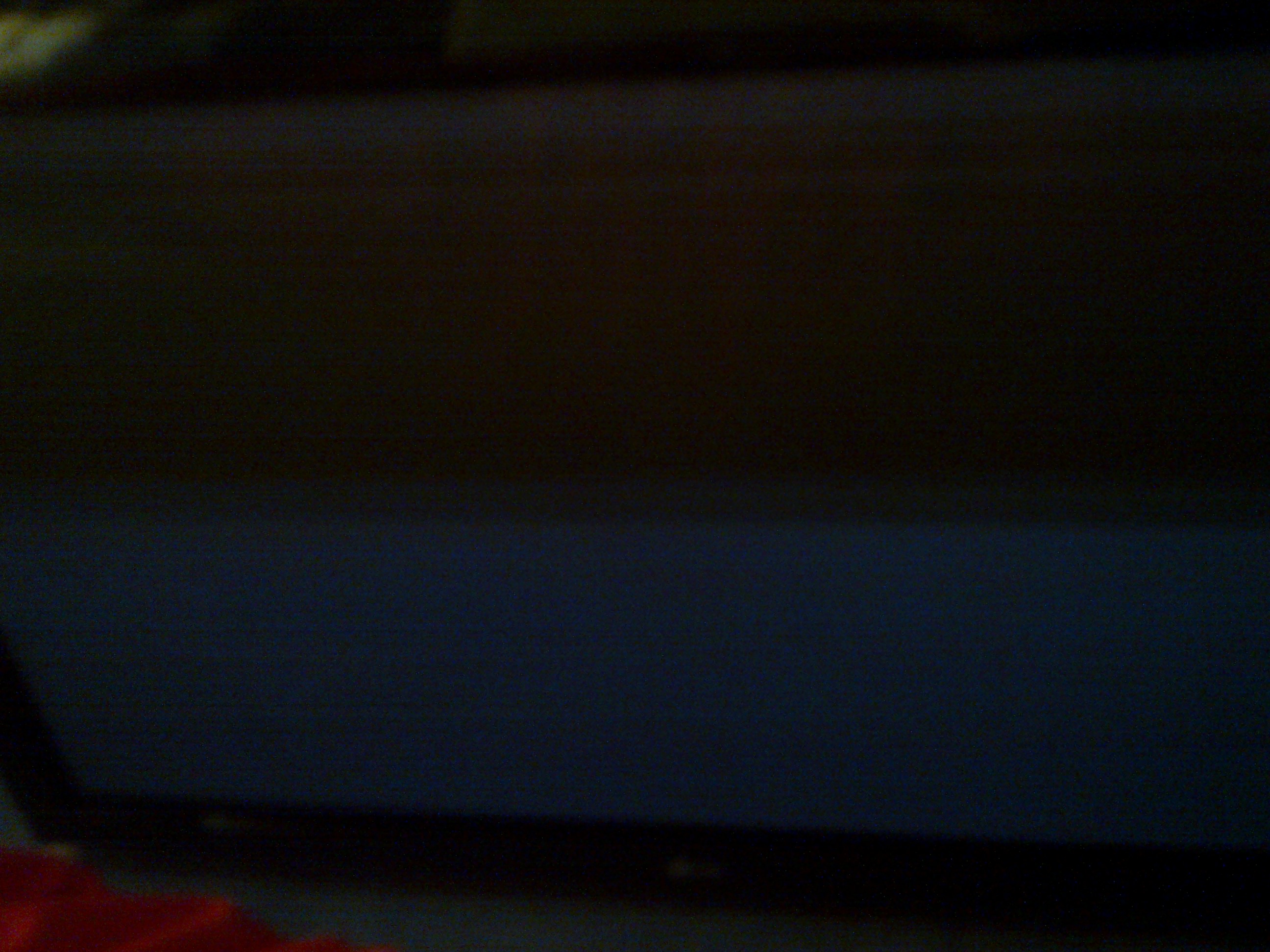

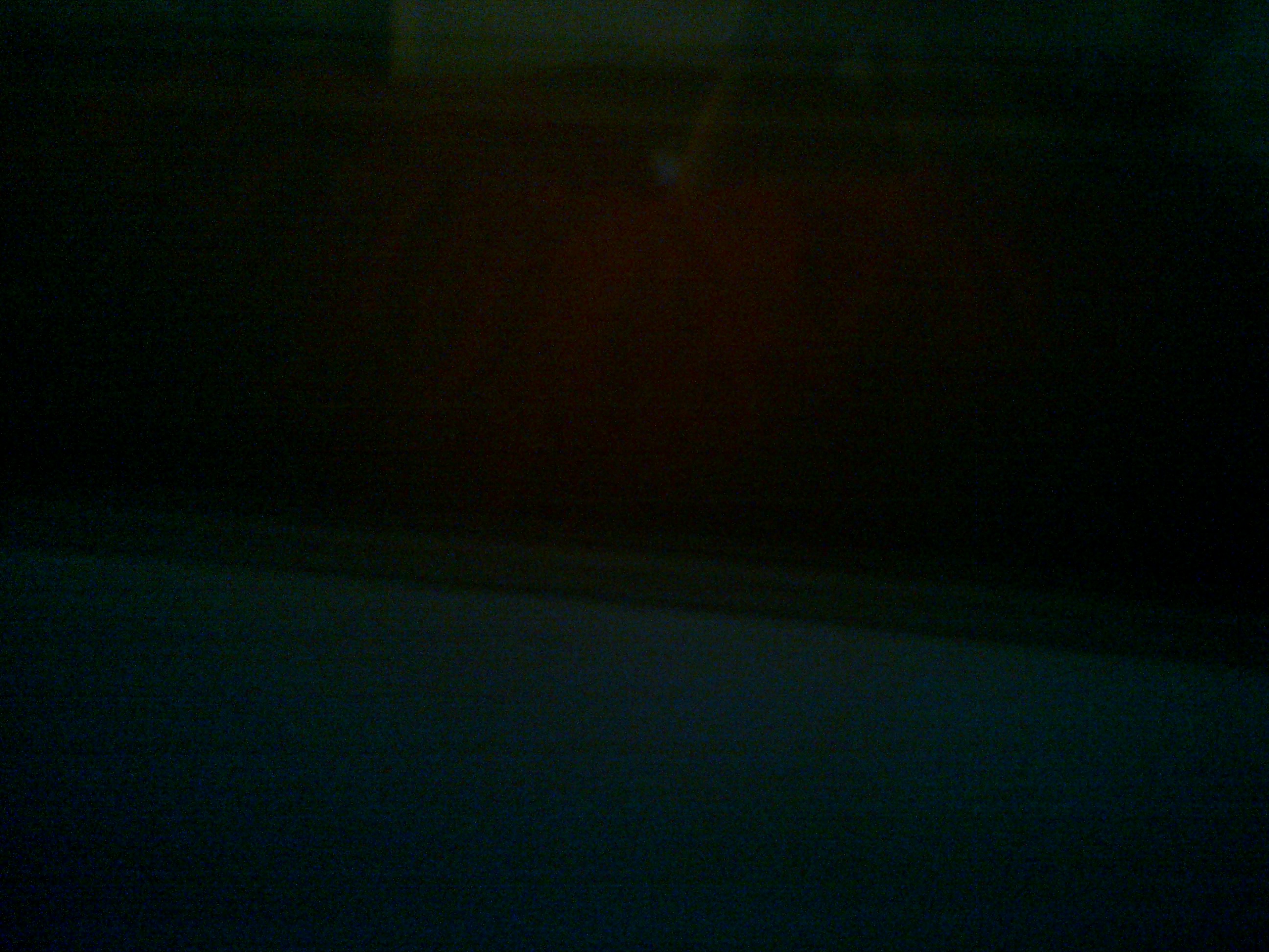

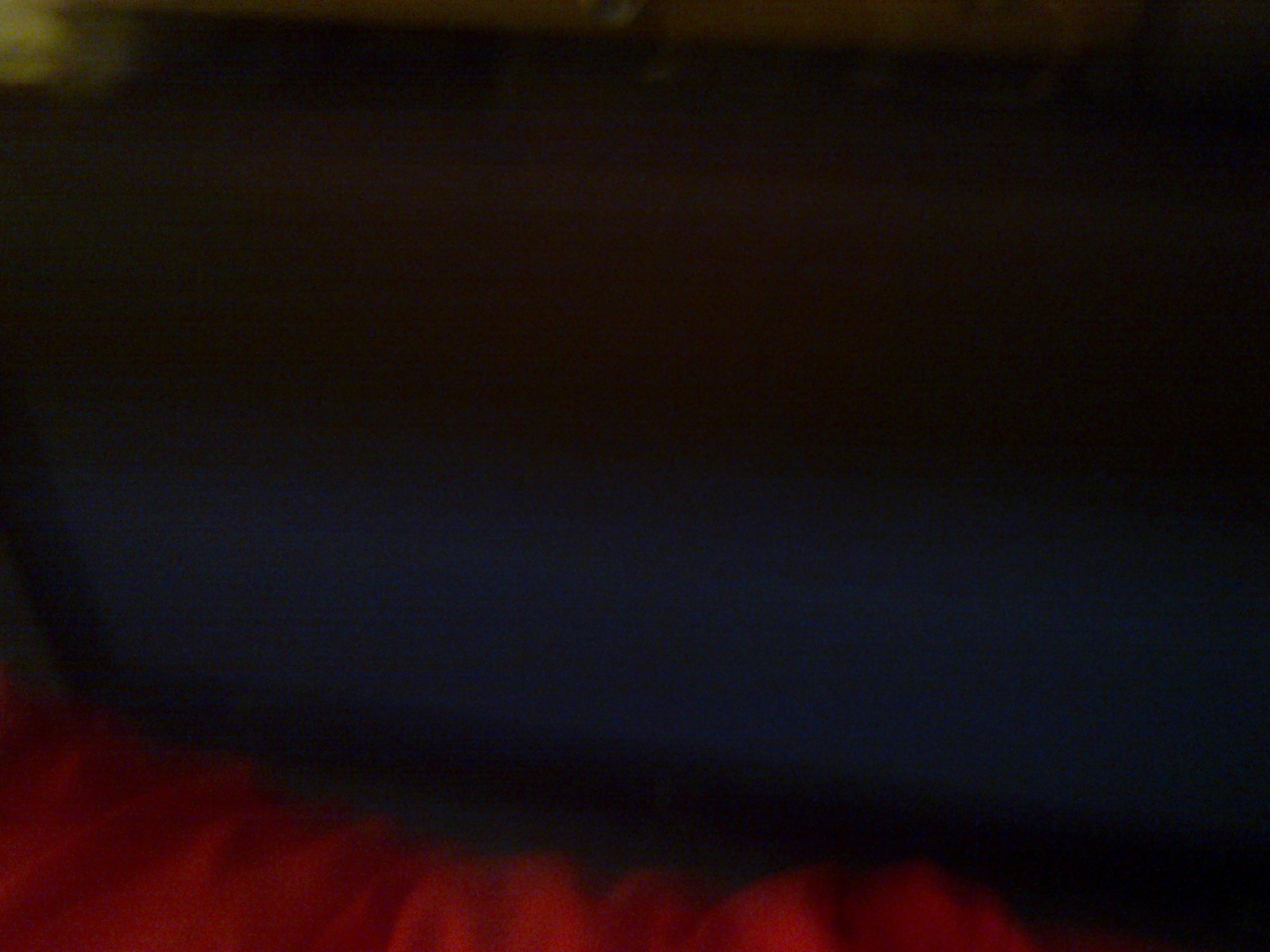

                    Re: lg 50pg3000 sound no pic
                    i have another of this model & as i fixed with top buffer before thought b easy
                    hmm however i purchased another top buffer as it had lines on screen but was same when turn tv on it shows wats in pics then screen goes off within 5seconds i never get any colour with top or bottom buffers removed individually does same & shows same with half screen blank obviously
                    any ideas or is panel dead?
                    thnx as always
                    ps;hope pics clear enuff for you to see wat i mean
                    • daphney
                      • Feb 2014
                      • 93
                      • uk
                      took voltages va 65 vs193 vy vsc & vzd all 99 if earth on chassis 0.01 across resistor screen is black then doesnt stay on long enuff to check when like in pics
                      thnx for help as always
                        I have one with lines on screen with colours rest blank, found top buffer to be shorted and a bubble burnt into it seems very common with thse sets.
                        • daphney
                          • Feb 2014
                          • 93
                          • uk
                          i dont see any colour sound is fine get wat pics show for 5secs mayb2 lol gott b quick to take pics replaced top buffer with another no diff am thinkin mayb tcon coz of voltages but i not sure????????????
