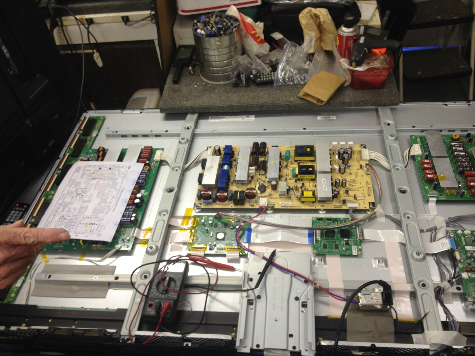

    I am working on a LG 60PX950-UA That the center white light blinks twice, and shuts off. I have unhooked the Y-SUS Board and powered on and nothing changed. I then unhooked the Z-SUS Board and powered on and got the same result. Anyone else had this issue with a LG60PX like this?

    Check for Vs & Va voltage with both Y- and Z-sus connected.

        Re: Lg 60px950-ua
        Tom,
        The label on the panel shows the voltage should be VA 60v & VS 203v. The power supply is producing VA 58v & VS 199v. Would that cause it to shut down?
          Re: Lg 60px950-ua
          That is fine. Unplug the TV from the mains power and allow it to discharge for at least five (5) minutes. Then connect the Y-sus and Z-sus again and measure Vs and Va voltages again.

            Re: Lg 60px950-ua
            Tom, I found your thread advising to unhook the LVDS cable from the control board and installing a jumper wire into the pin holes like this
            https://www.badcaps.net/forum/attach...7&d=1376575578
            I tried that and the test screen came up! So do I need a control board or a main board? pictures below of the set I am working on. Thanks again for your help!
              Re: Lg 60px950-ua
              Good! You would need a main board.
              (I was going to suggest that as a next step )
              There is also a "3D converter" board on this set, in between main & control. However from what I've seen it is usually the main board that fails.
