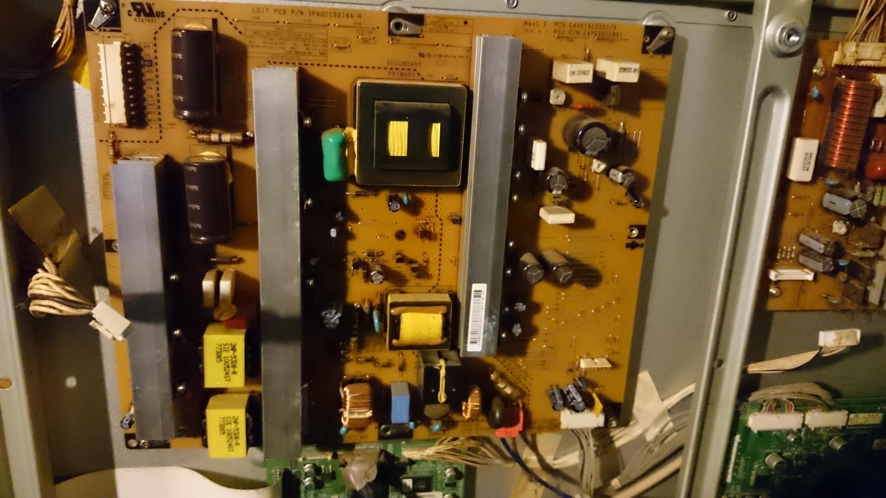

    Hi guys,
    Got this plasma for cheap.
    When i turn it on it just clicks 3 times and then repeats the same thing over and over again.
    Disconnected the ysus/zsus from the powerboard/mainboard but it keeps clicking so my guess would be the PS.
    I dont get any visual on the screen it stays black.
    All caps look ok.
    Have not measured a LG plasma before so if someone could guide me?
    I will take pictures tomorrow if needed.

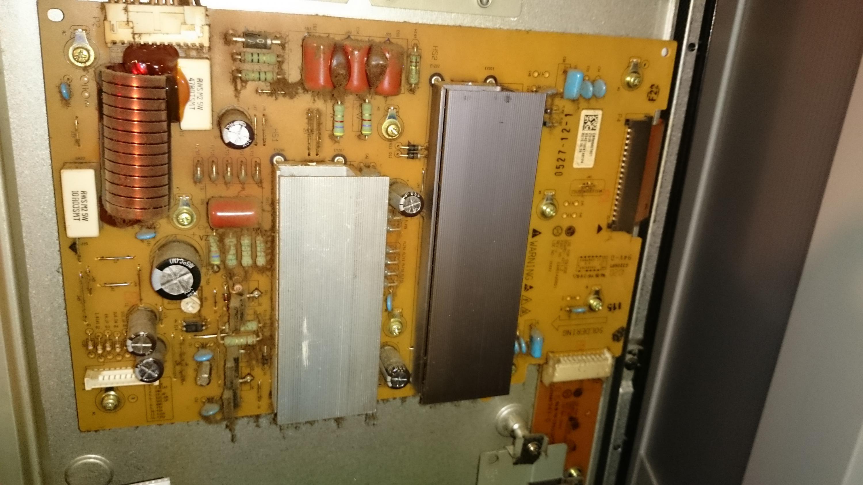

    Re: LG 42PJ150. Clicking Clicking Clicking
    Sorry for all the dust, only cleaned the PS.
      Just a idea here I had the same fault on my 42PJ350 LG once I changed them the tv worked
      I'm gathering that psu has the same rating but no doubt tom or more will reply
        Not a problem for me to buy 2 of those ceramic resistors. Is that 22 Ohm?
          Yes have u checked yours on the psu are the same ?
            Yes same values! Will try that tomorrow. Thx!
              Have you tested these resistors before ordering something you don't need.
              Have you checked 6 legged voltage regulator that is attached to heat sink near the bridge rectifier.
                Im going to test those resistors first ofcourse.
                I have not tested that 6 legged voltage regulator , how do i test that? Whats the name for the part?
                  Ok , tested the resistors. Both are 22 OHm.
                  I replaced all the small capacitors except the 3300uf.
                  Took the board with me to work and unsoldered the 3300uf and the value is 3900? Took a brand new 3300 and the value is 3330.
                  Could this be the reason its not starting up?
                                Got the panasonic on a hold so ill continue with this 1.
                                Replaced 2 caps ( 3300uf).
                                I just plugged it in and i got 1 click with another click later on and led is on. No more clicks...looks like its running in standby mode?
                                Pressed powerbutton again and led stays on but it continues klicking every 5secs.
                                Nothing happens on the screen.
                                Guessings its the voltage regulator. I read alot that replacing this part does not fix the problem.
                                More time tomorrow for this tv! Any tips are welcome!!

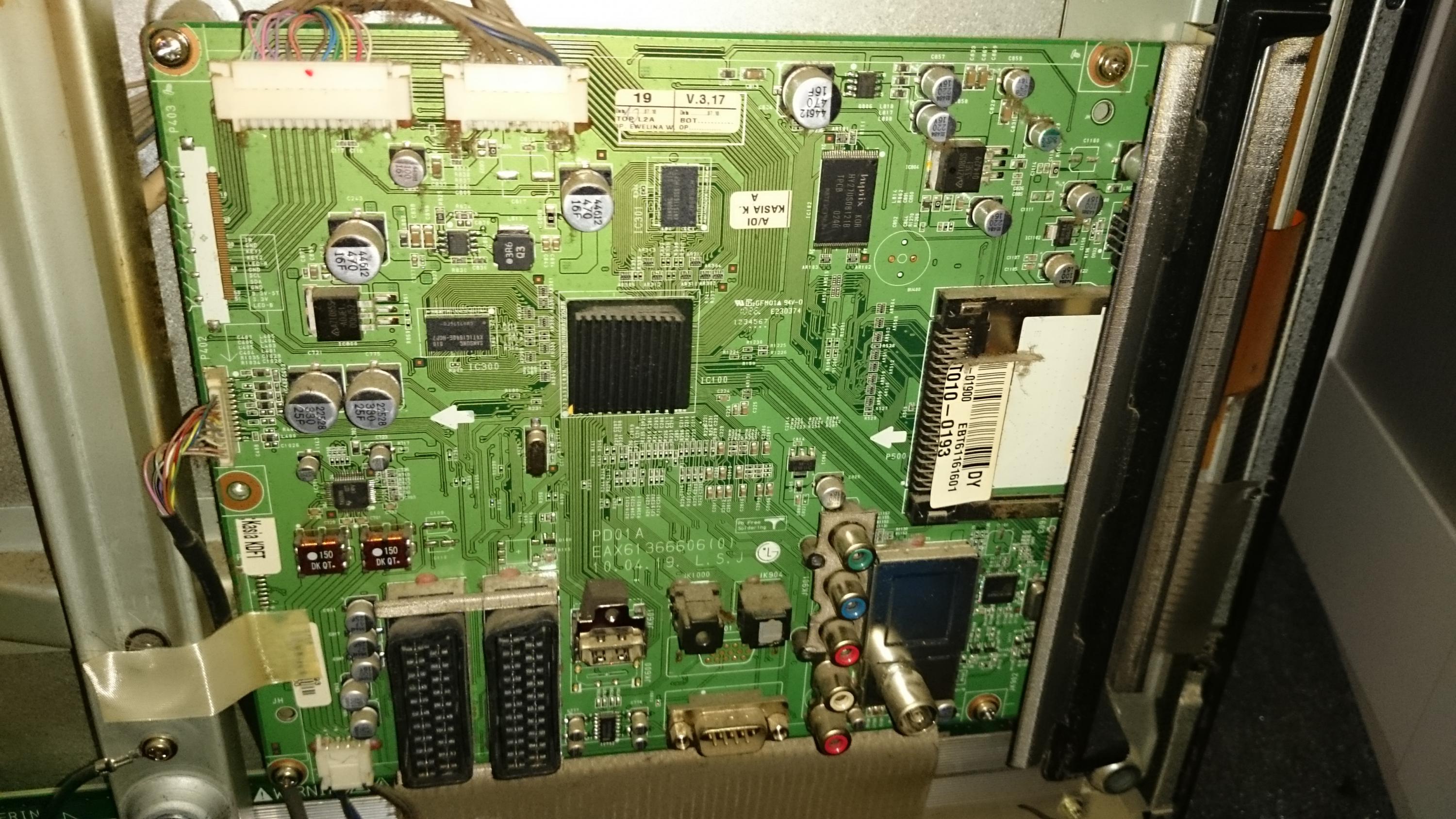

                                  When you get continuous clicking do you get good Vs/Va voltages?
                                    There are no voltages going to the SS board. M5v / gnd / nc / v5 / va are all 0v.
                                    The only voltages i measure are on 2 pins on the cable going to the mainboard. They are 4v and 5v rest is 0v on the same cable.
                                      Ok, I think it's a good idea to rule out the main A/V board.
                                      Disconnect the connector from power board to main board. Leave main board end unplugged.
                                      Connect AUTO_GND and GND together on this connector.
                                      Everything else connected as normal.
                                      Plug set in, do you get relay clicks, do you get Vs/Va, and a slight glow from the plasma display panel?
                                        I bridged the gnd/auto gnd and put in in the mains. The relays click ( click click click) and nothing comes on the screen and voltages stay 0v.
                                        The 5v/4v are still the same but the relays stop clicking! ( loop)
