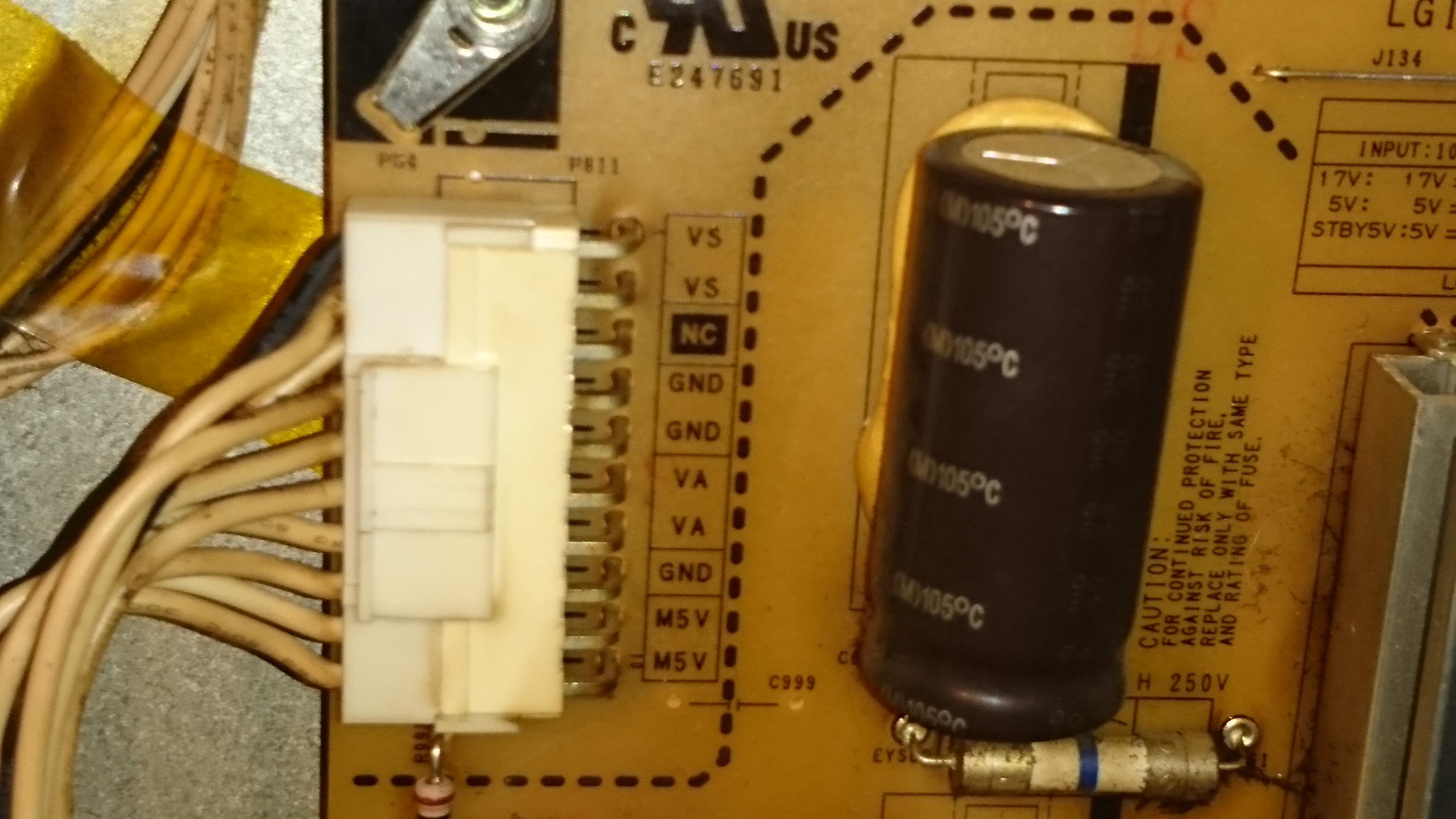

    On the pin marked 17V, do you measure 17V approx?

      Re: LG 42PJ150. Clicking Clicking Clicking
      I dont see that pin, where should i look?
        What pins do you have? Provide a picture of the legend please.

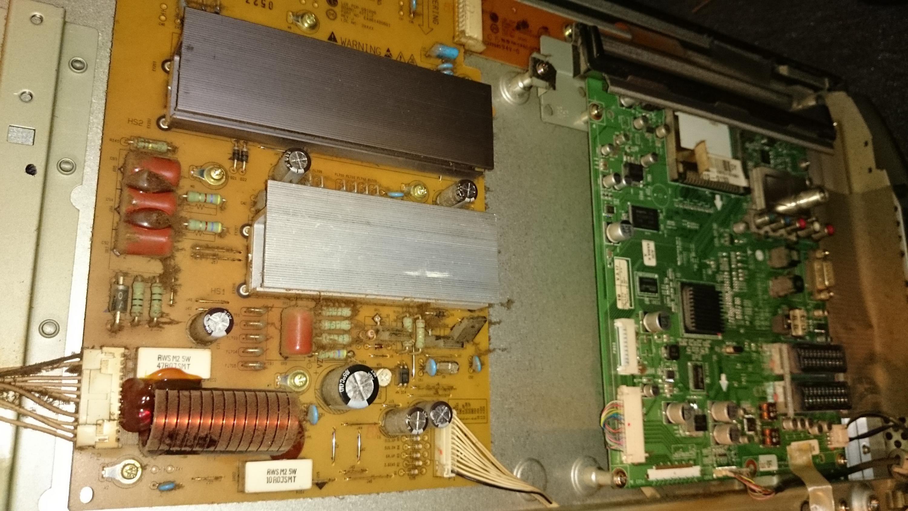

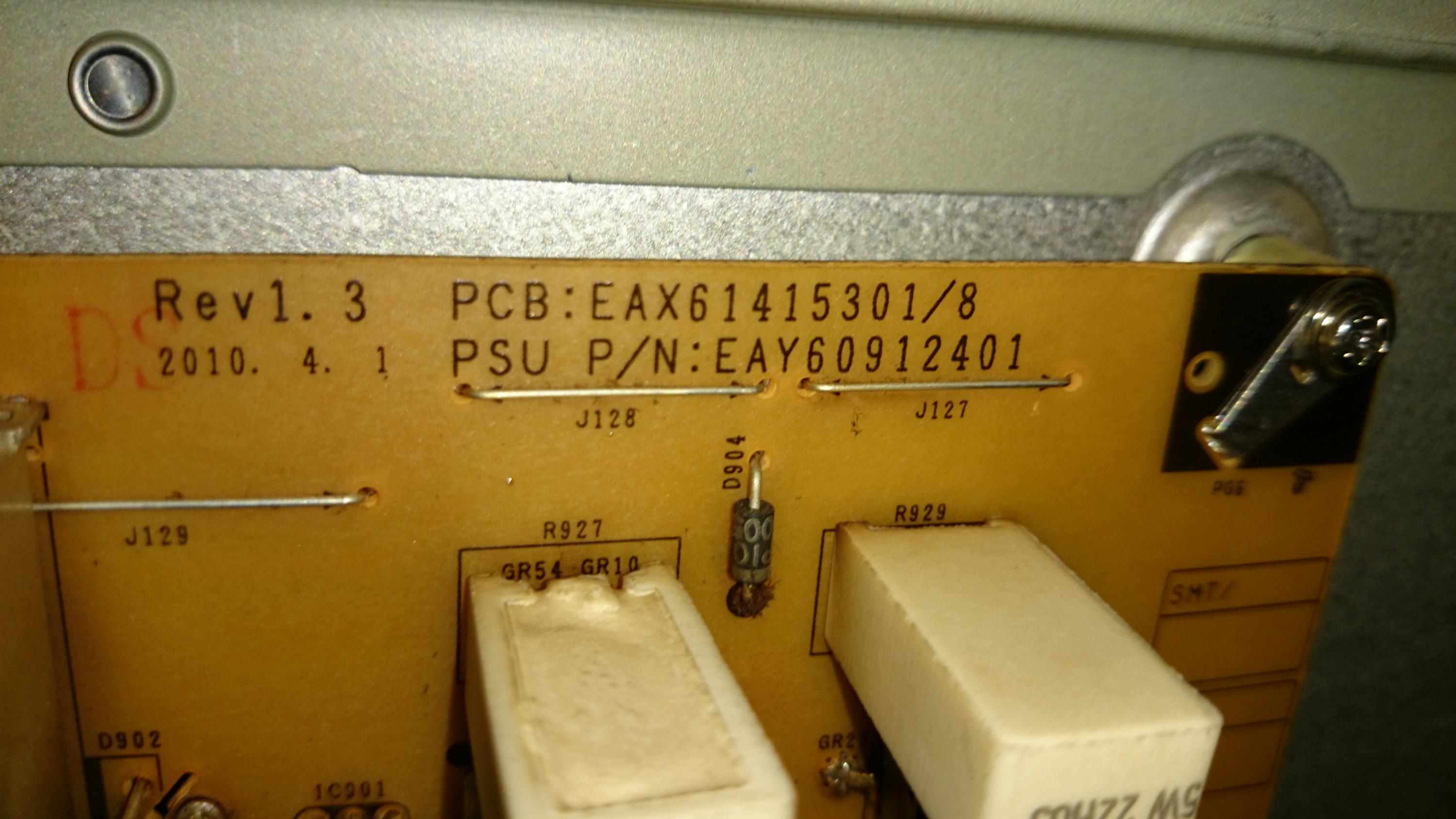

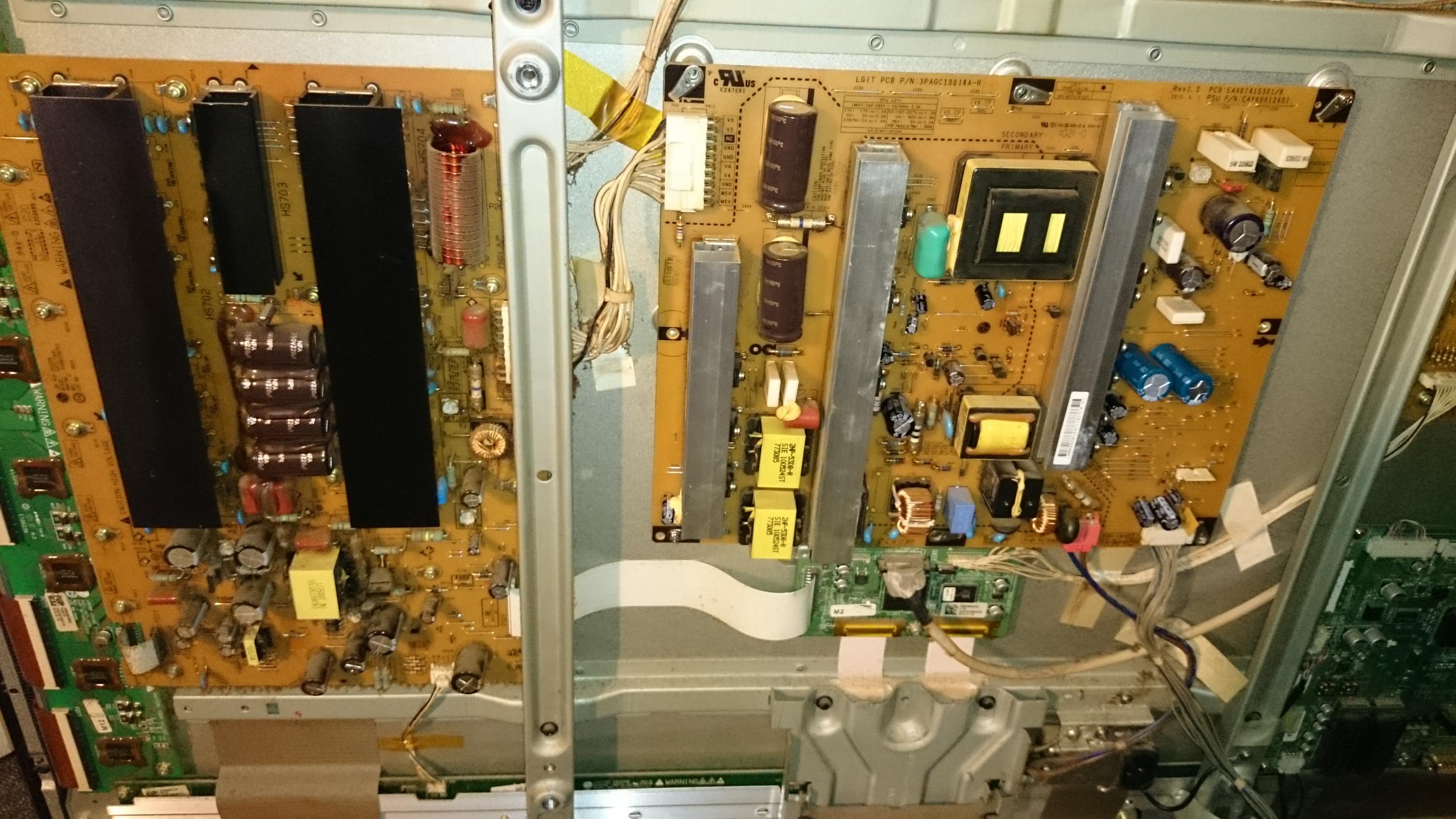

          So this is the set, bought it from people who smoke alot as you can see haha.
          The cable on the left of the PS going to the board on the let has 0v on all pins.
          The cable on the PS righthand side is going to the maonboard and has 4v and 5v. ( 2 pins next to eachother)

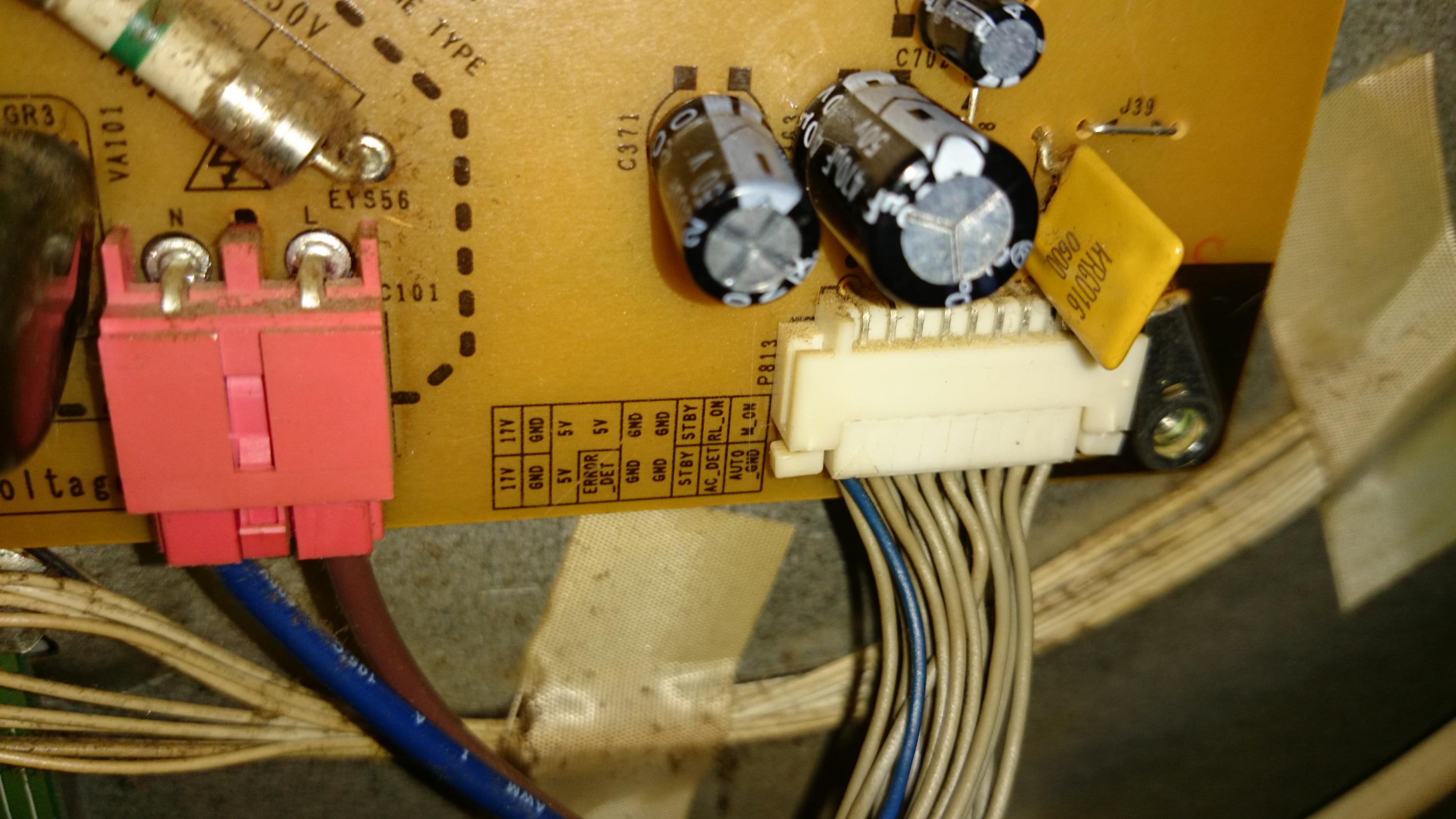

            This is the cable going to mainboard
              Need a picture of the connector label of which goes to the main board.
                The last picture is the cable going to the mainboard.
                  Ok, I see it now, the two outer pins marked 17V test those with AUTO GND connected to GND.
