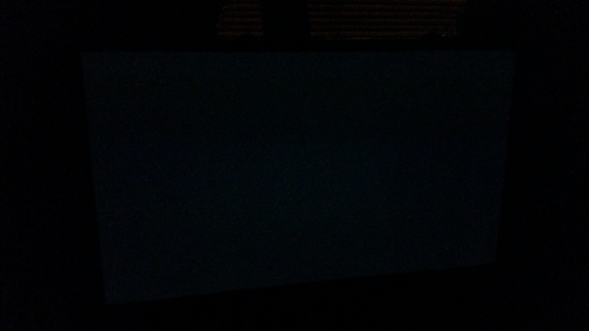

    I've got an LG 60PK790 tv which has lost its picture and sound. When you turn the tv on everything acts as normal, the red standby light turns to blue, the screen flickers 'very dim' but looks like it's about to come on but that's it! If you press any button on the remote the blue led light responds as normal. If you turn all the lights off you can see the screen very dimly lit.

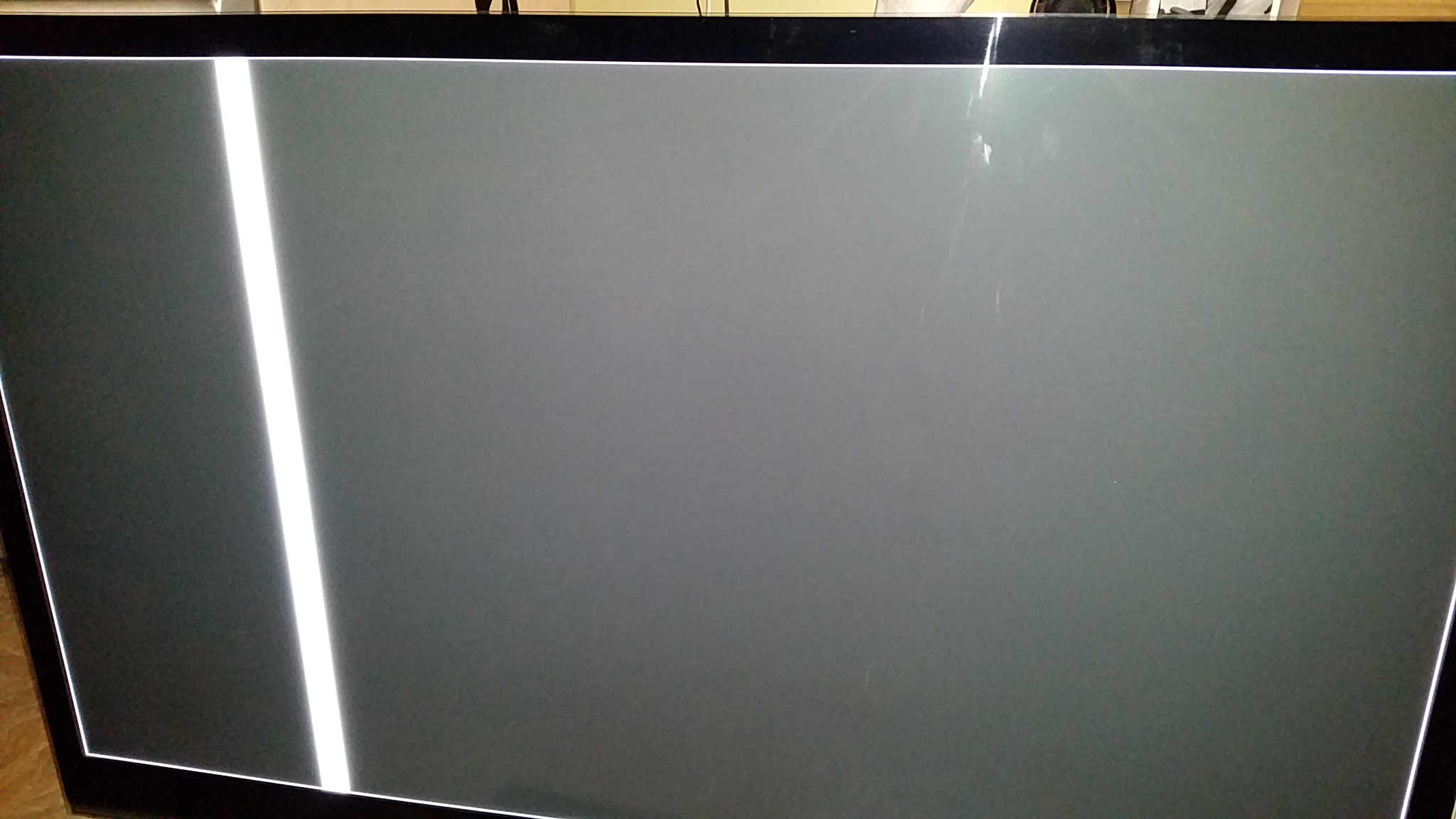

      Tried to take a picture but wasn't very good.
      The TV is a constant dull white not fuzzy, that's just what the camera picked up. It's also the full screen without any black patches.

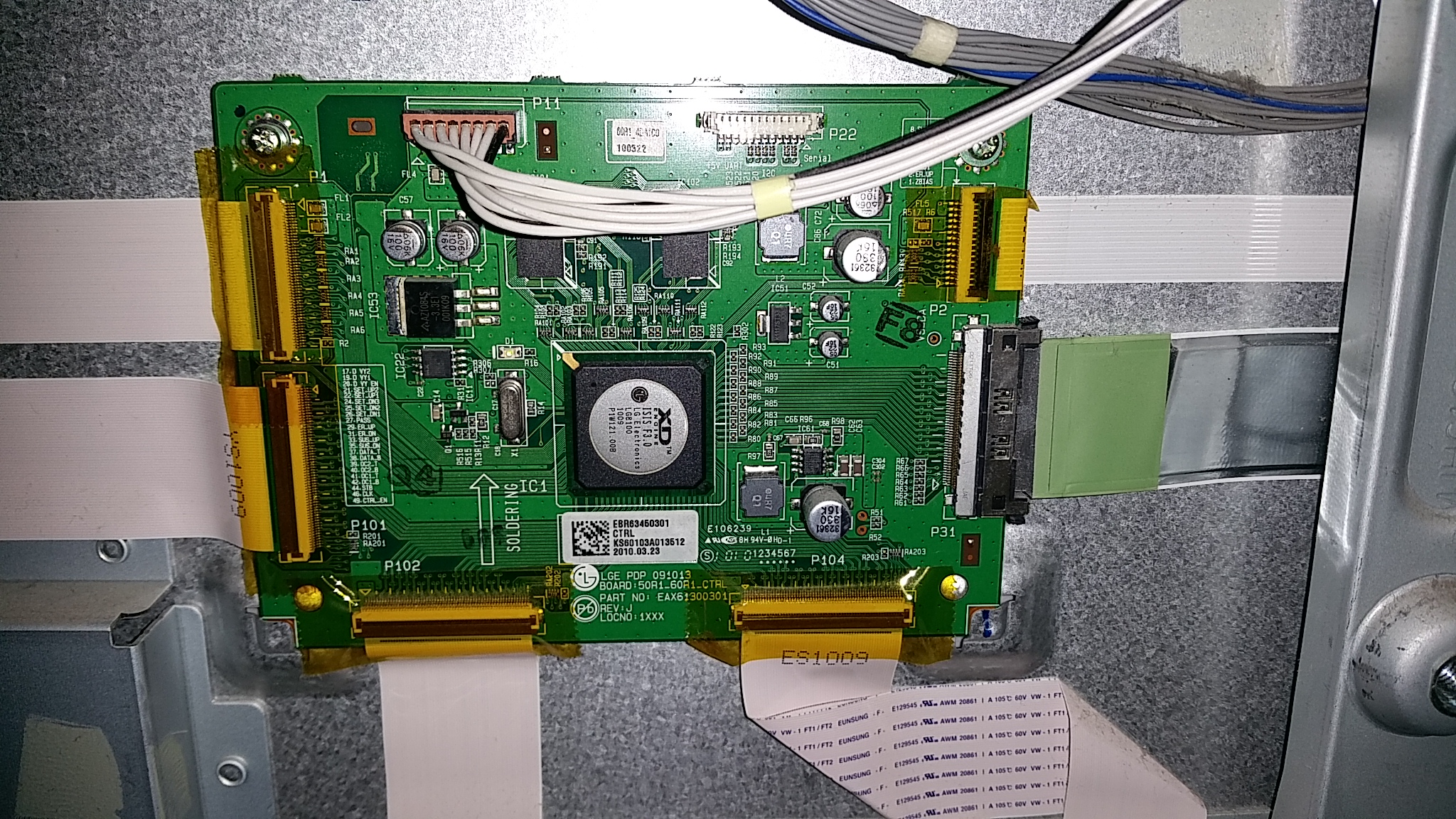

        Re: Lg 60pk790 no picture
        Ok, right in the middle of the TV there's a smaller green board. This is the control board. It will connect most of the other boards in the set together, including the A/V board (has HDMI ports on it)
        Can you get a photo of this board... it needs to be of your board.
          This is the board fitted Tom.

            Was there a reason you wanted to see it?
              Yes...
              Bottom right corner of the board, there are two points, next to R51 and R52 and a silver capacitor

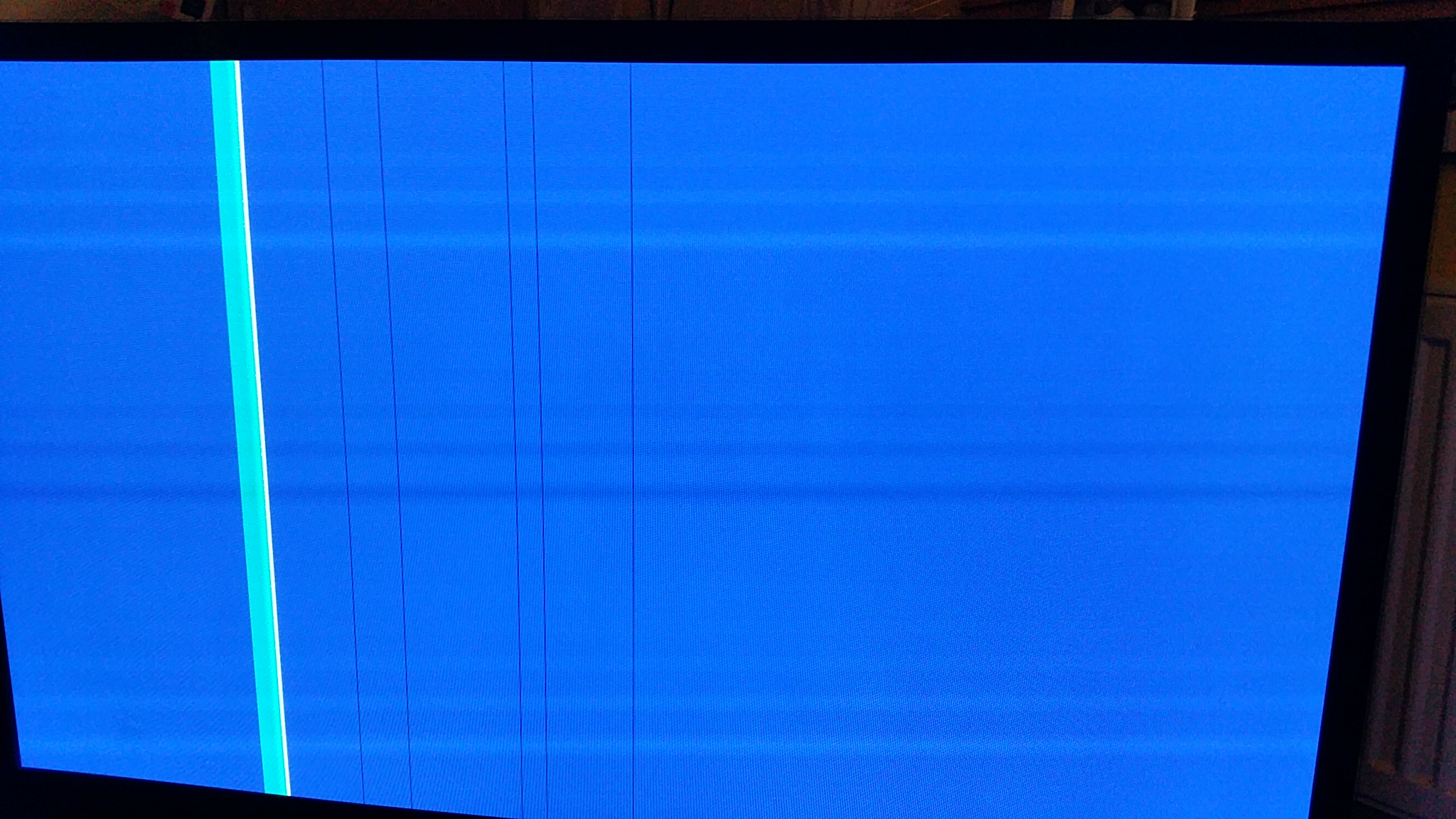

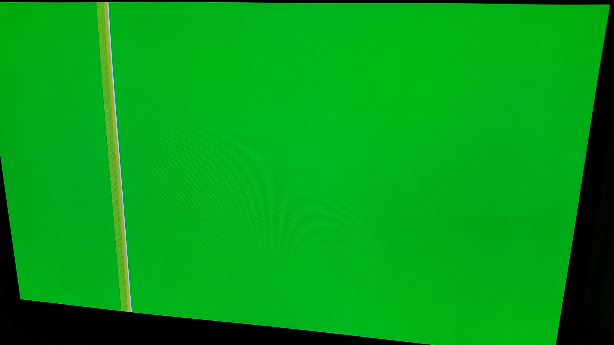

                Here's the results. Few lines but they go, however the solid line stays. What does this mean Tom?
                Cheers for replying.
                  Bad plasma panel I'm afraid.... it's dead
